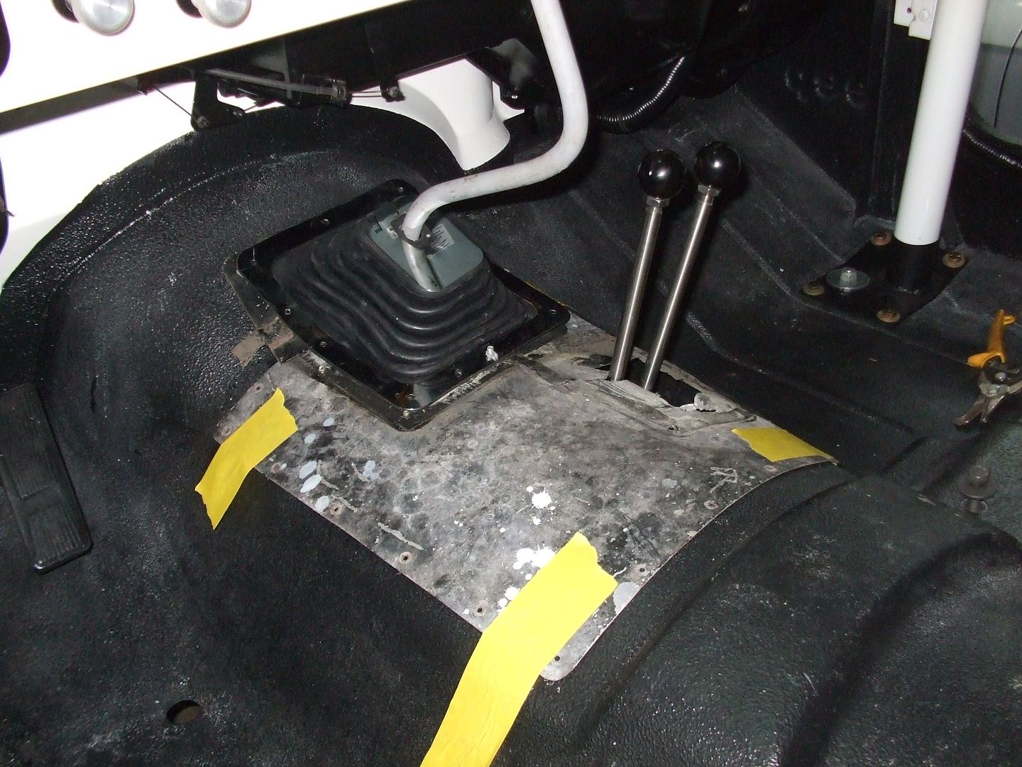

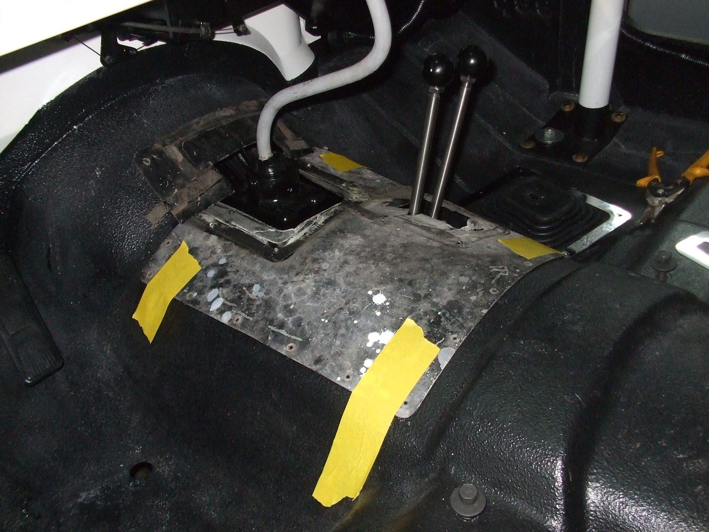

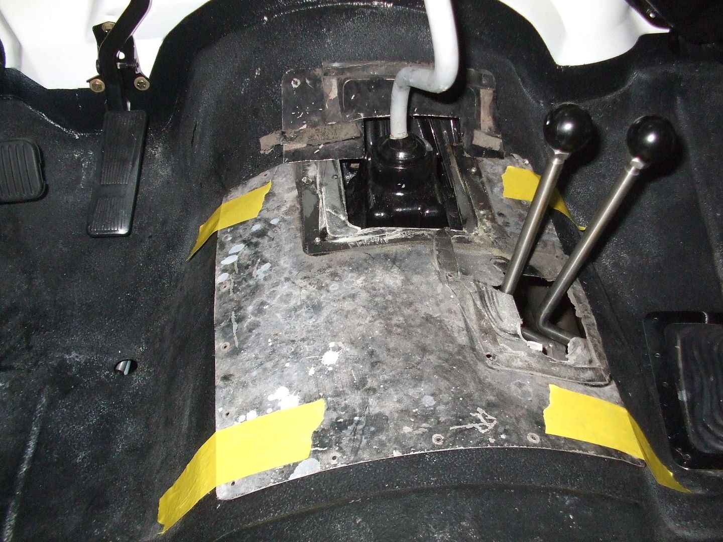

I went to every place around here that I could think of and they all went from 16 right to 26 gauge. Of course as I typed that I just thought about the Hotrod Shop. Maybe I'll work on something else today and see what I come up with.
The 26 gauge does dent pretty easily but I figured covering both sides with Raptor would stiffen it up quite a bit. I do need it to be a little flexible. I had one main piece that covered the main hump. Then I needed to have a separate piece that went up toward the firewall. I can't make it out of one piece because it just can't make the multiple bends. I will still have the pieces attached to the tub with rivets or screws, although I'll probably use less of them, because I will want it to be removable. The part I was considering welding is where the two pieces meet each other. I could potentially bond them together with some seam sealer or even just lay a bead of silicone across the seam, most of it is hidden by the shifter boot anyway. In hind sight I should have made the opening in the floor at the front smaller but it's too late for that now. This is the best picture I have of what I had made before which might give you an idea of what I am talking about.
Mike
Coiz is offline
post #1221 of 1943 Old 02-26-2011, 12:24 PM Thread Starter
Coiz
1979 CJ7
Location: Northern, IL
Posts: 4,226
Here are a couple pictures of the old one tapped into place. Notice how worked over it looks as compared to before I started the rebuild. Goes to show anything in the garage was subject to torture for the first two years of this rebuild. You can see how the two short legs of the top piece went under the main one. You can also see the old weatherstrip I had used which actually worked pretty good.
So I'm basically thinking of making the same basic thing but this time make the legs on the top piece longer so they will catch the rivets/screws that hold on the trans shifter boot.
I think it will look fine once covered in Raptor.
Mike

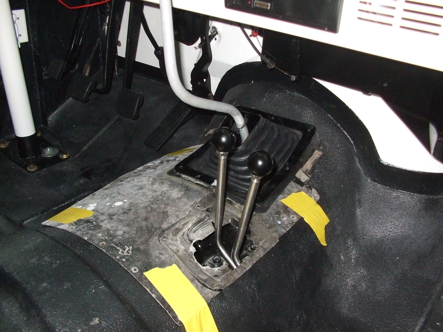

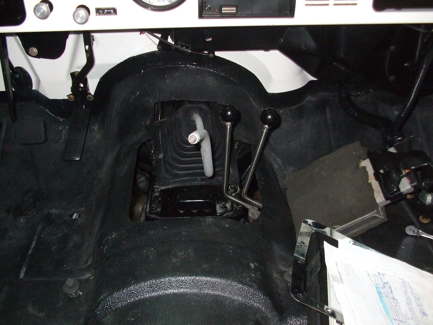

post #1228 of 1943 Old 02-27-2011, 02:57 PM Thread Starter
Coiz
1979 CJ7
Posts: 4,226
Originally Posted by Jim1611 View Post
Mike are you going to bend the transfer case shifters over towards the driver?
I did bend them over just a little bit but there is not a lot of room. Here you can see how close they are with the transmission in reverse. It looks like the passenger's side shifter could come over just a little more but in all actuality I need that gap there so I don't rake my knuckles on it while controlling the left shifter.
Mike
