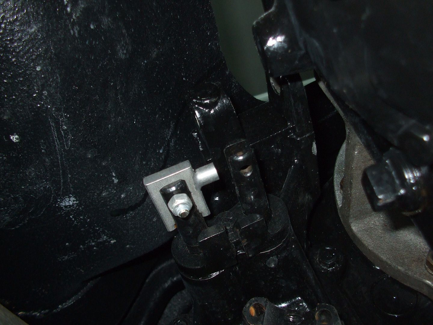

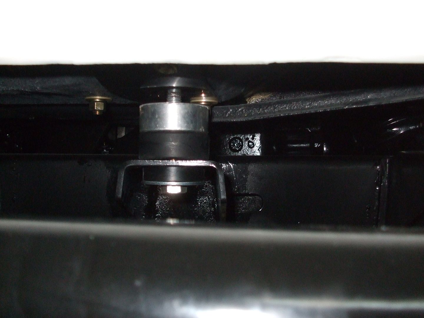

Having to lift the body back up was not that big of a deal, just something I didn't really want to do. I thought about dropping the skid plate but remembered how I had a little trouble the first time getting the holes lined back up and didn't want to fight with that again. I removed the bolts from the roll bar that attached it to the frame on the passenger's side and loosened all the body mount bolts on that side to where they were still threaded but almost ready to fall out. I placed a 2x4 on my jack and lifted the body the least amount as possible to where the bolt would clear the body. You can see how it only took about 3/4 of an inch. I might have been able to lower the skid plate enough to clear the body without having to remove the bolts but by this point it was too late.
I installed the first shift rod actuator on the front axle shift rod.

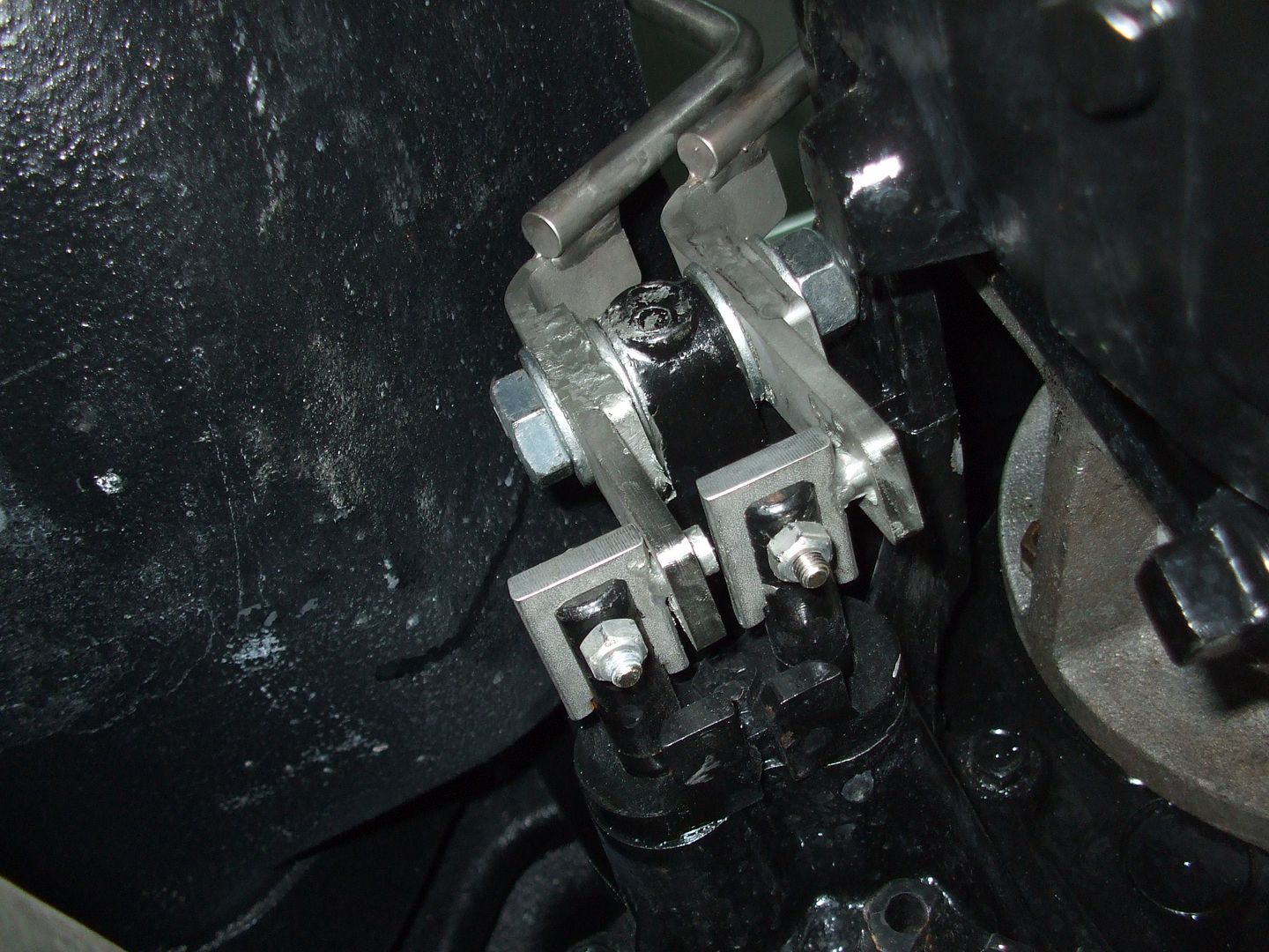

Got the front axle shifter in the correct location with a washer on each side and a generous amount of anti-seize.

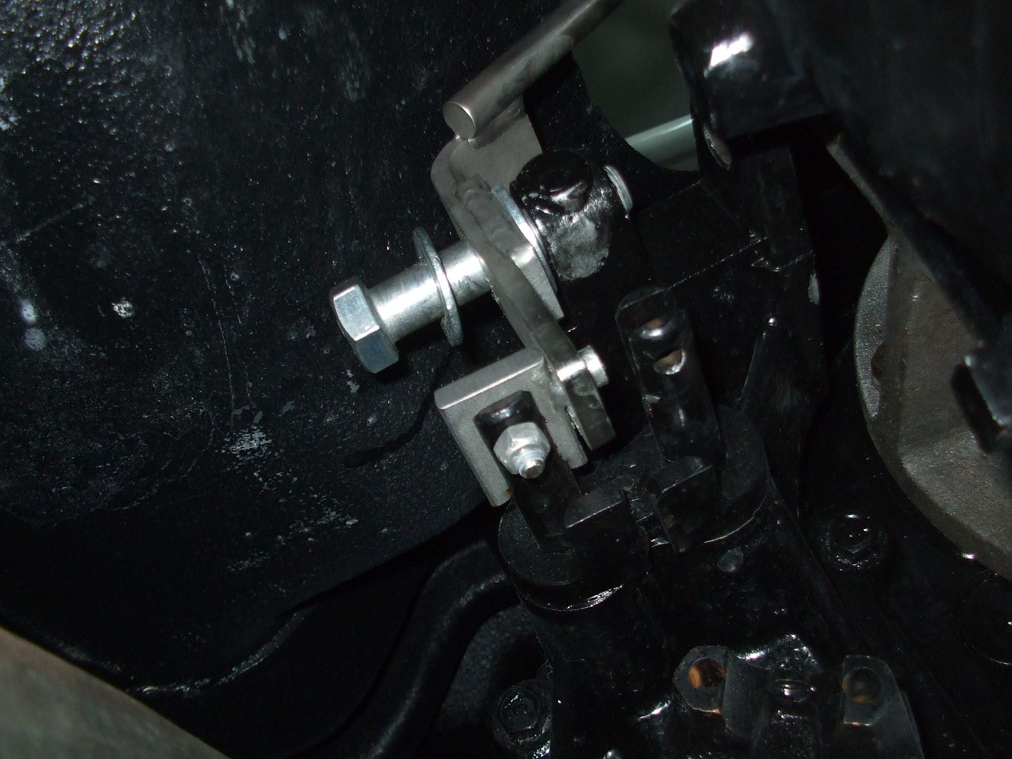

Installed the shift rod actuator on the rear axle shift rod.

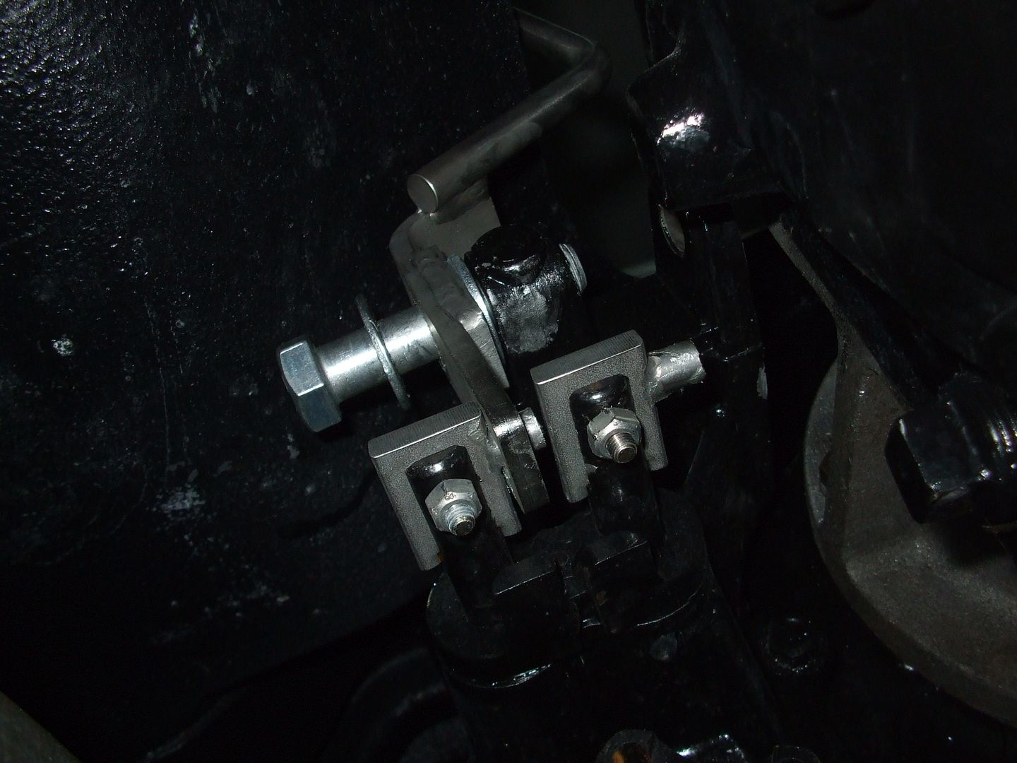

Install the shifter on the rear axle shift rod.

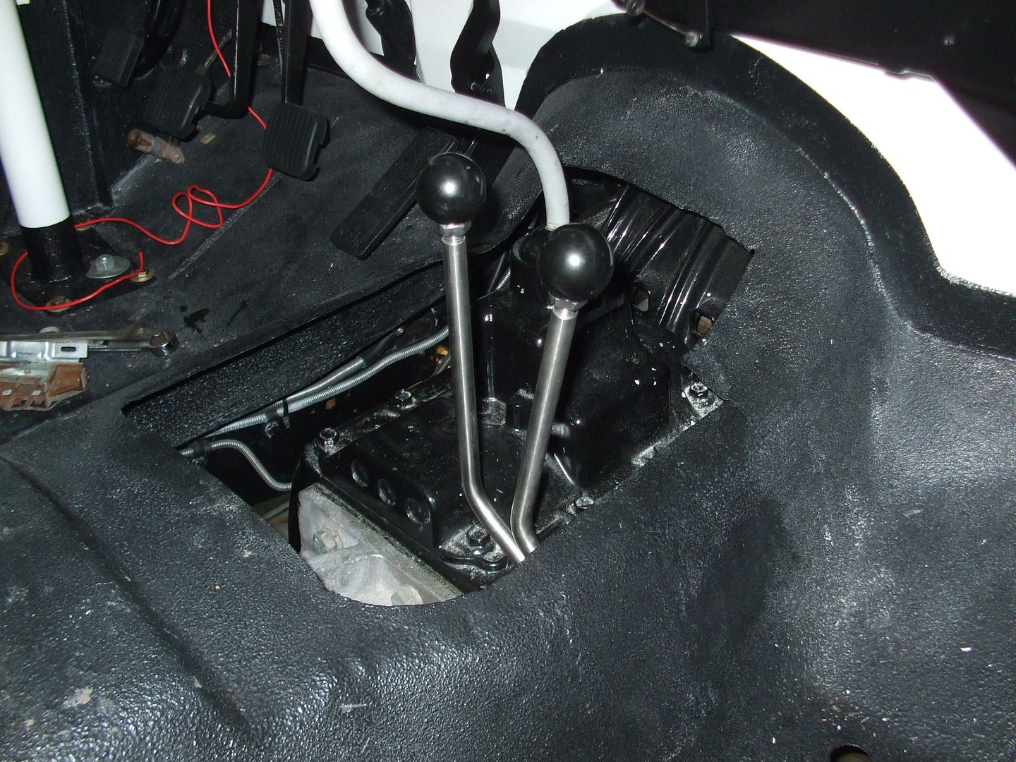

Ready to fab a new trans tunnel cover.
I also bought the billet aluminum shifter knobs but will wait to take those out of the package until I am basically done working on the interior. I'd have to say I am very pleased with the quality of the JB Fab setup and would recommend them to anyone.
I waited to paint the transmission shifter because I might have to heat and bend it to fit better. In 1st it is fairly close to the dash and in reverse it is really close to the center console. I wasn't sure how much that was going to change with the 1" body lift so I'll heat and bend it as needed to fit once the seats and console are installed.
