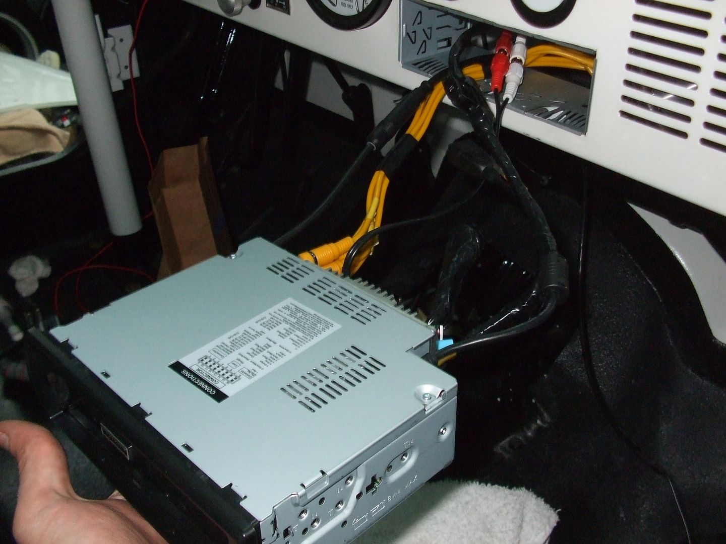

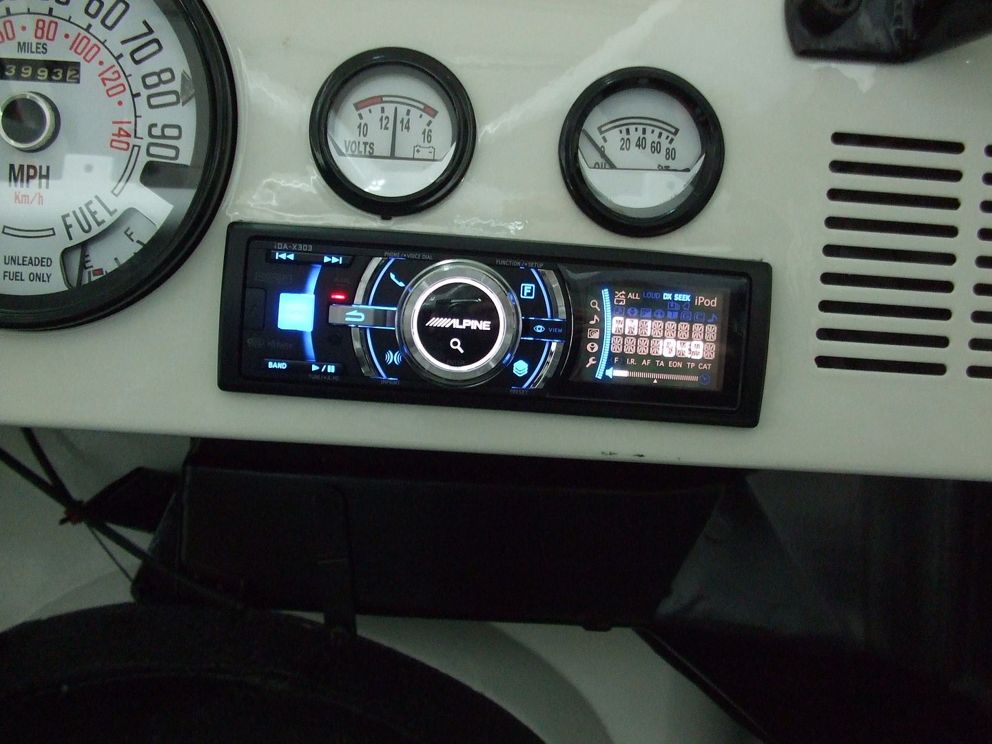

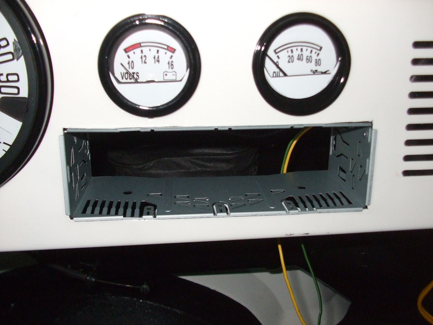

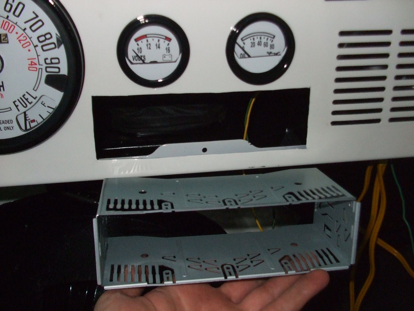

I figured I better give some of you guys an update before you disown me. With all this talk about the radio I decided that there wasn't any reason not to install my Alpine head unit. The cage was a pretty simple step since it was brand new.
It slid right into place and I only pulled down on a couple securing tangs to initially hold it in place. I want to make sure everything works and fits with all those wires before I bend them into place.

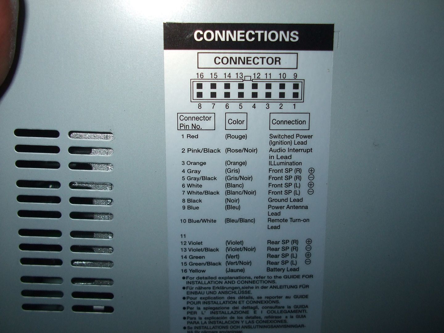

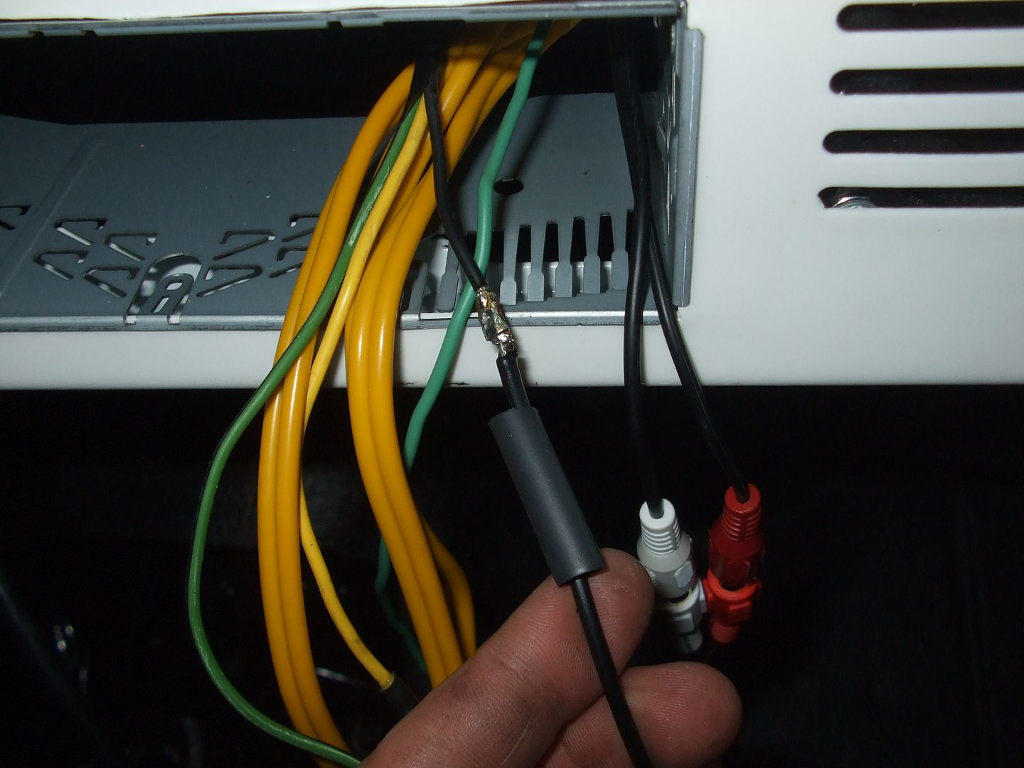

Pretty simple on the hook ups. I am going to use the Red, Yellow, Blue and Black wires. I might hook up the Orange if the stereo illumination is too bright at night. The rest of the connections will be through RCA.
I already had my wires pre-ran, here is a shot of the ground connection.

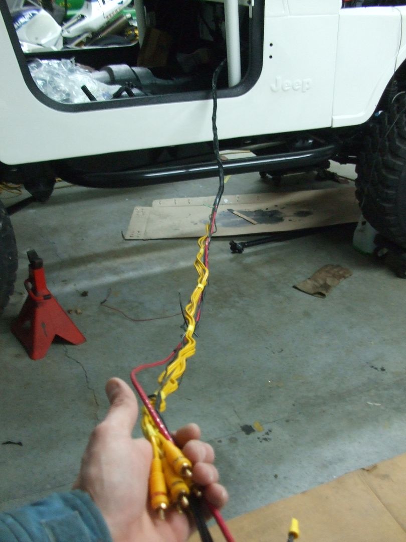

I had already shown where I ran the radio antenna wire. Just need to get it secured with good 3M tape.
As you can see that quickly turns into a fairly large bundle of wires behind the head unit.

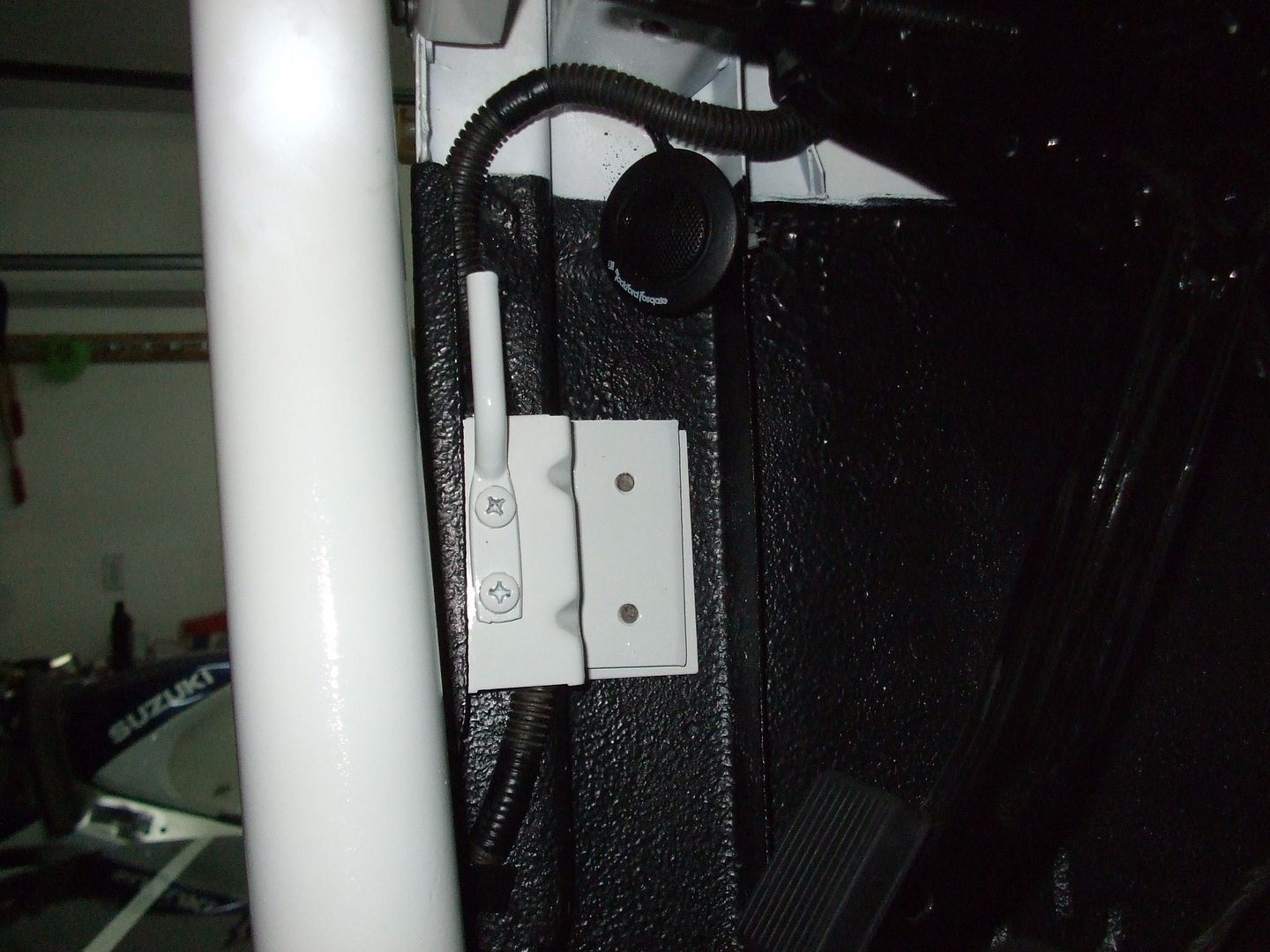

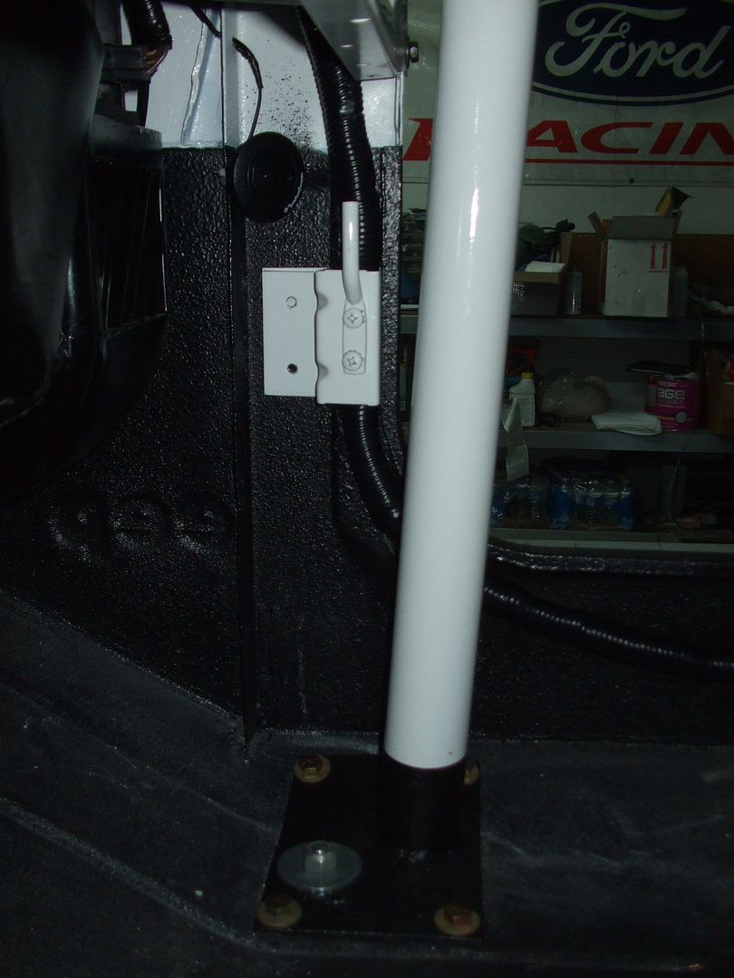

I ran all the wires going to the amps up over the glove box and down the passenger's side A-pillar to ultimately have them end behind the front seats. I added some convolute and tape to the first half of the harness. Note there are three sets of RCA, 2 pair of front speaker wires, Aux input wire, amp remote on wire, a 6 gauge power wire and an 8 gauge ground wire. (Please don't start preaching about how I should have ran battery cables to my amps. The two amps fuses total 40A and 6 gauge wire at an 8 foot run can handle 65A and that's considering all the gains and volumes maxed out, which they never will be.)
This is the general idea to route the harness. I'll just need to secure it up under that lip. Also notice where I ended up installing the tweeter. I know they are supposed to be kind of in your face but that was the best thing I could come up with without cutting holes in my painted dash or trying to run the wires up the roll bar. I figure they are out of sight, out of mind, and out of the elements.
Here is the driver's side. I will end up running that harness up over the parking brake mount. I still need to run the interior lighting wires through that harness so I will move it at the same time.
The head unit turned right on and works as expected.

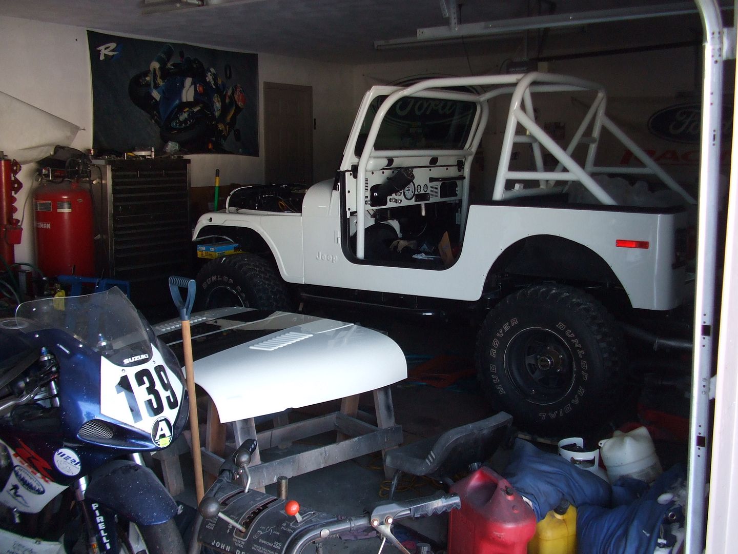

Thanks guys. I have been working on the hood off and on for a few weeks now. Shouldn't be too much longer before I'll be ready to install it. I had more issues with the clear coat that got sanded and cleared again. I did take pictures but not sure if they are worth posting. End result is about five coats worth of clear for me to be able to sand out the imperfections and buff to the finish I am expecting. I'll probably detail that a bit better as I get closer to being finished with it. I basically need it to be warmer than 55 degrees in my garage to be able to effectively polish it with the 3M products. There might be a few solvent pop issues I might not be able to work around but at this point I am sick of dealing with it. We'll just have to wait and see how it turns out. Here is how the garage currently sits.

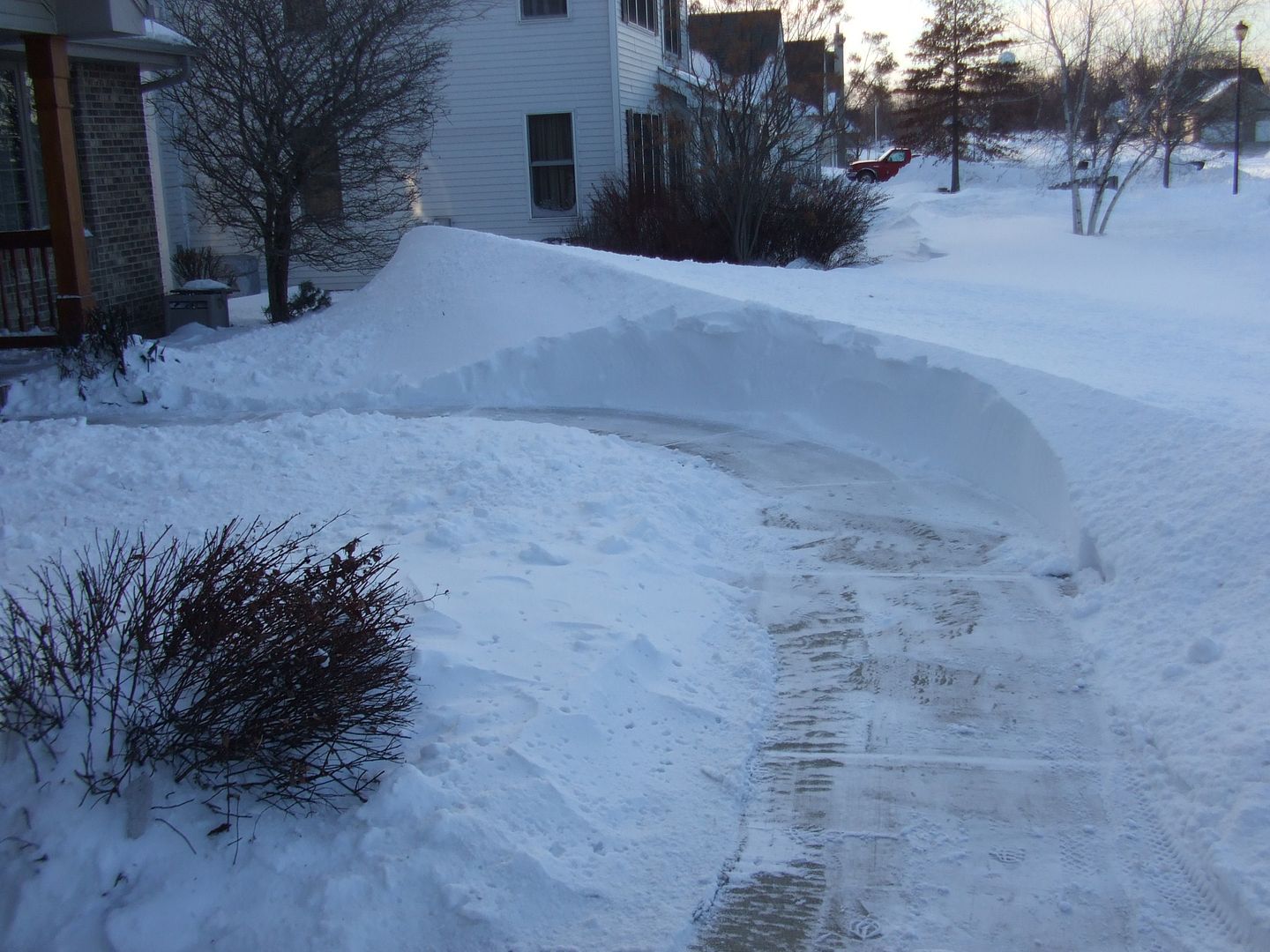

I figured I might as well post a few snow pictures since I just spent the last 2 hours shoveling out my driveway. Here was my back door at about 11 o'clock last night.
The walk leading to the front door. That drift is just a couple inches short of four feet at its' highest point.
The sidewalk is right at three feet.
The front yard.
Taller than the mail box.
This pile is over six feet because it is taller than I am and probably taller than the Super Duty if I backed it down the drive.

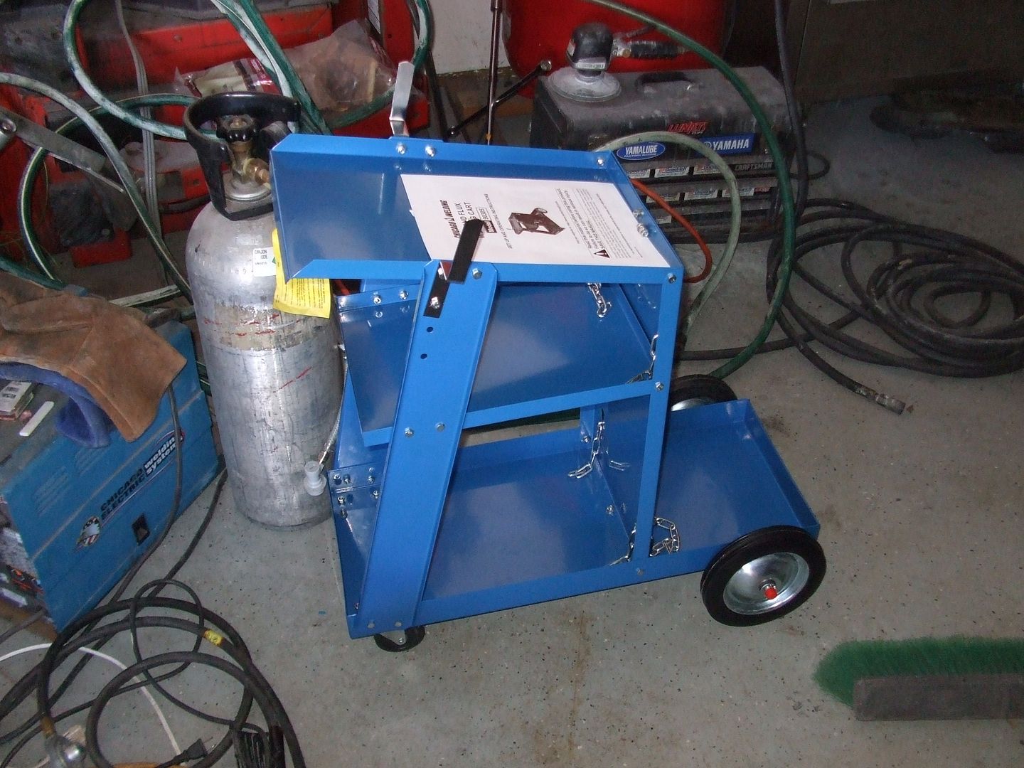

Here is at least one thing remotely Jeep related. I finally broke down and bought the HF welding cart. I intended to make my own but for the price with the 20% off, I couldn't pass it up. I really should have bought one of these two years ago. Lugging that welder and CO2 tank around the garage during all the tub work was a pain.
Mike
