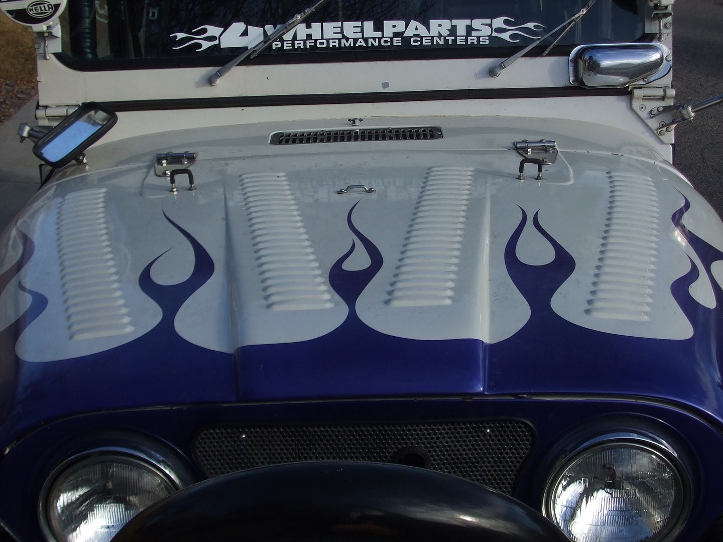

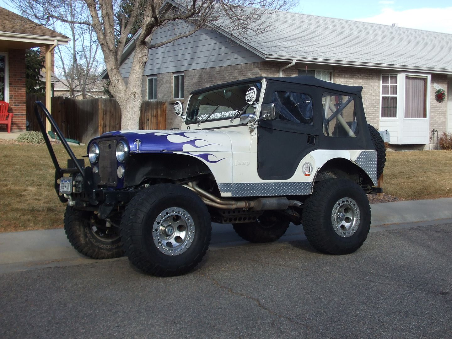

When I got back to Denver I took a little trip around the neighborhood to check out my old stomping grounds. I drove past one of my friends old house and what was parked out front, this CJ with flames and louvers in the hood.
If this happens to be your Jeep, hit me up. You're living in one of my best friends old house and only a block from my parents.
Then just down the street from my parent's house, which happens to be next door to my sister's house, I see a nice CJ5 parked outside. The guy that lives there is the same one as when I grew up on the street. He was a volunteer fire fighter for almost 30 years.
As I'm checking out the CJ5 the garage door opens and what's inside, a 1957 Willys. I caught him as he was going to take his dog for a walk. We ended up talking about Jeeps for the next hour and a half. He just finished restoring it this summer. It's got a 289 with a Warn OD. He said the insurance told him it was worth $6,000. He insured it for replacement value of $20,000. He said someone offered him $12,500 for it last weekend in a shopping center parking lot and he flat turned him down.
Mike
He set it up nice, but I prefer yours over his. Too many louvers for my taste.

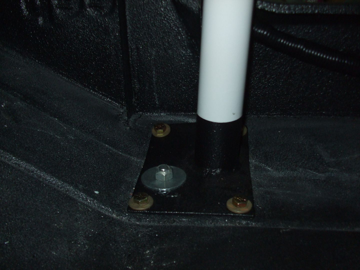

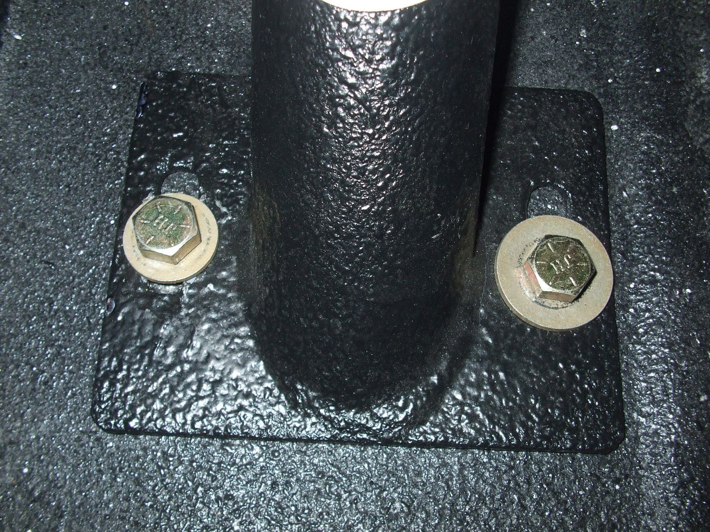

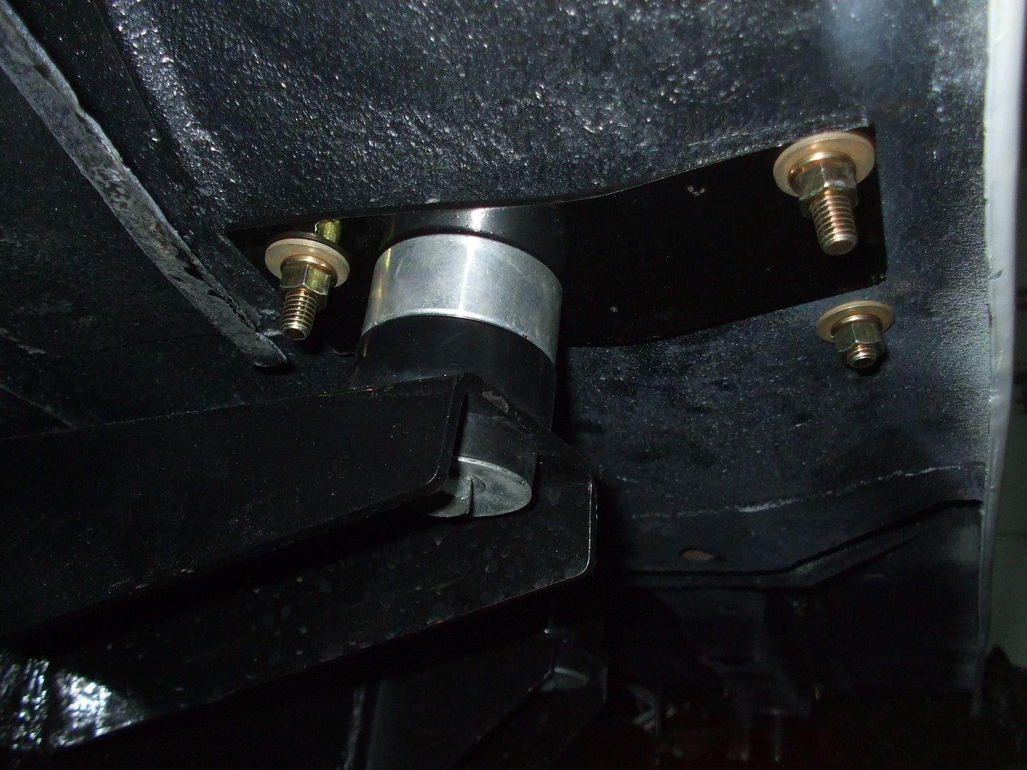

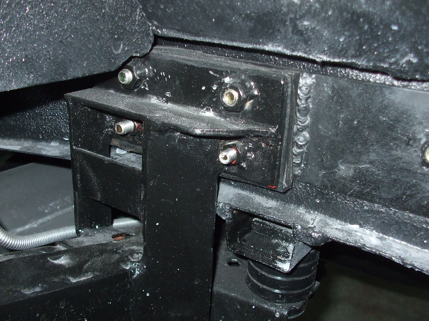

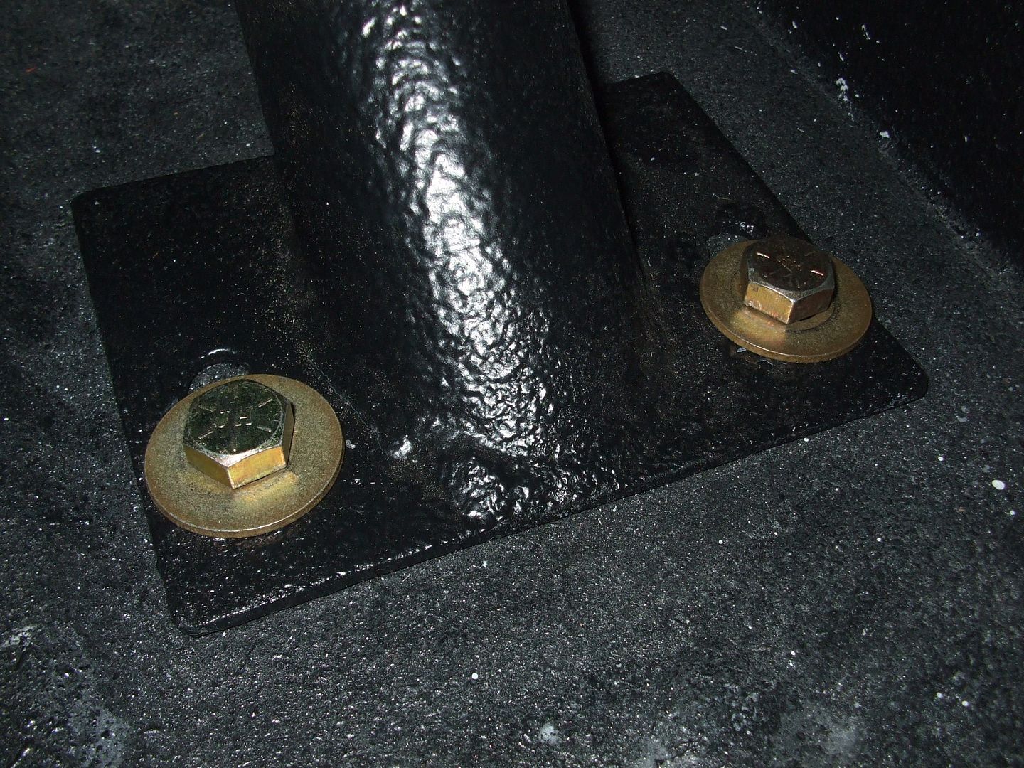

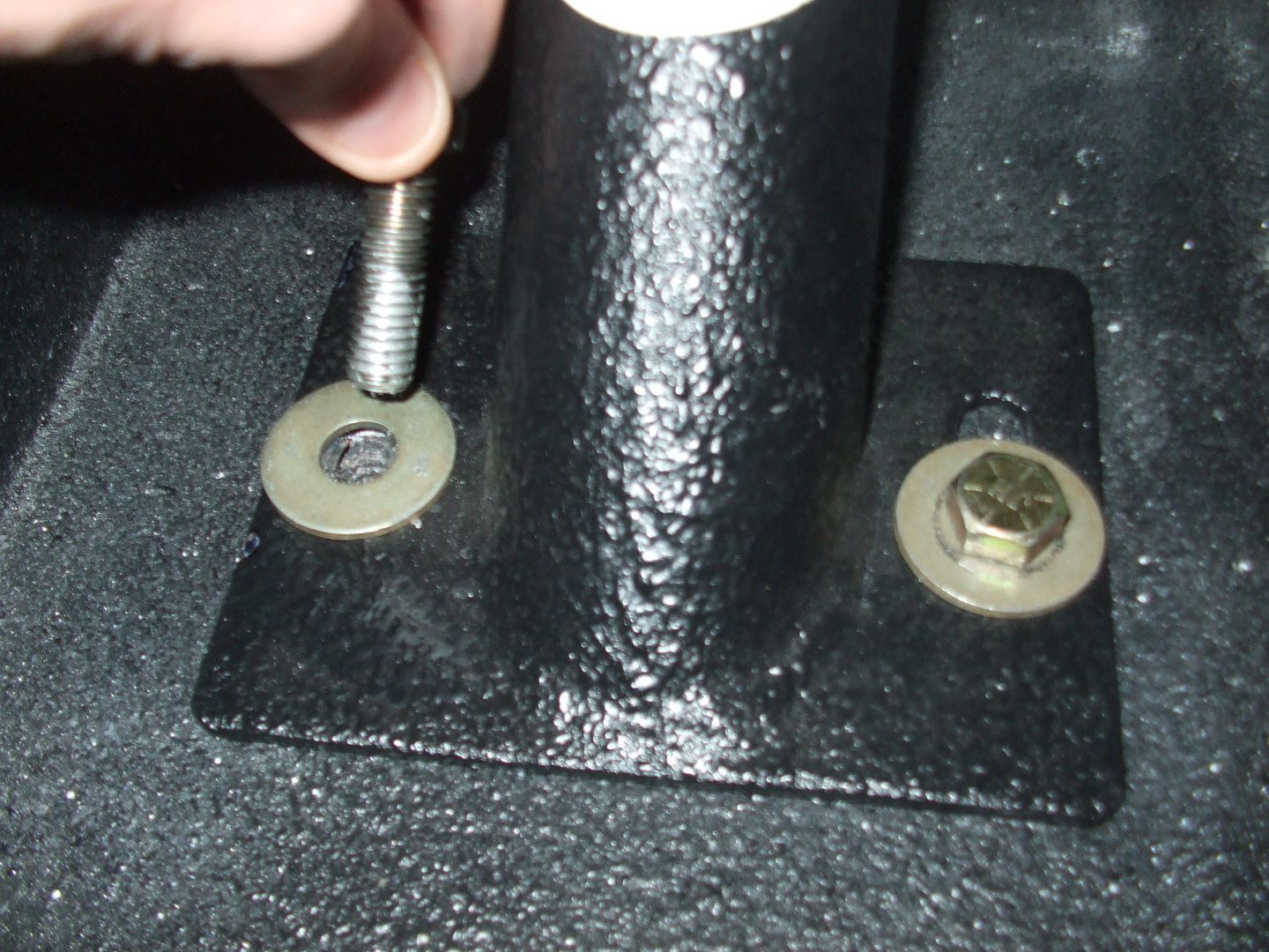

Roll Bar Mounting
One of the things I got done before I left was to get the roll bar completely mounted to the body and frame. On the main mounting points on the floor behind the seats I had originally used the stock sized 5/16" bolts all the way around. After the fact I had gone back and upgraded the top two bolts to the next larger size which would be 3/8".

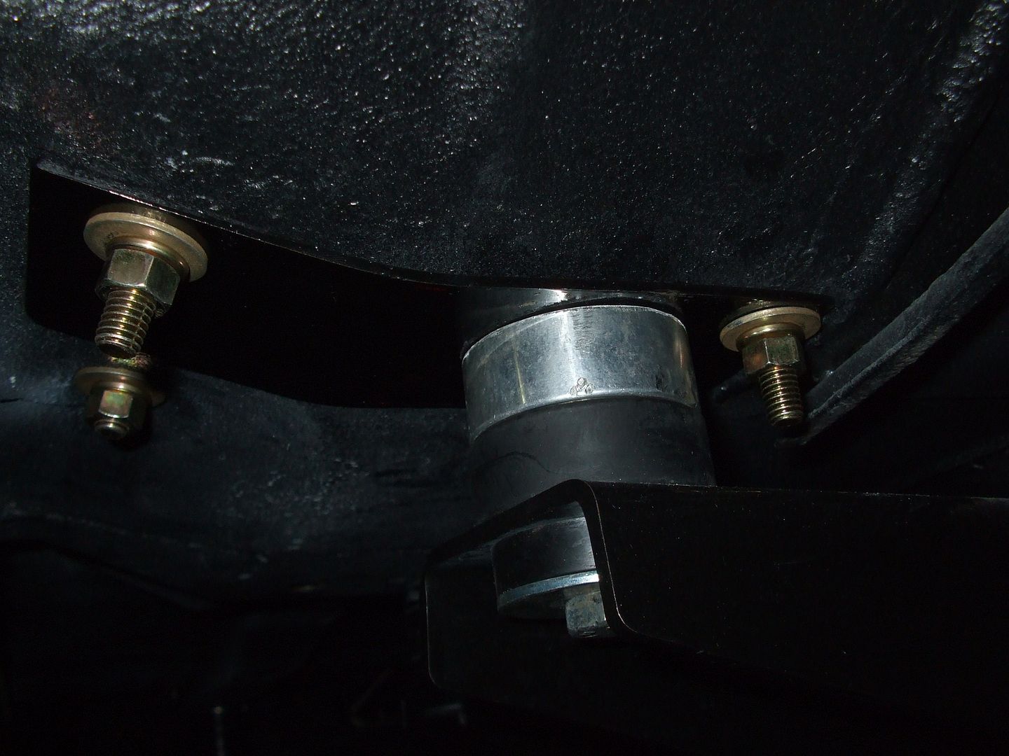

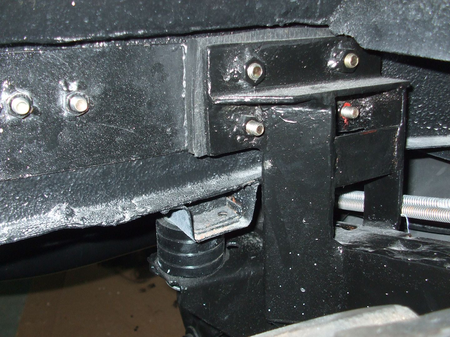

Here is the back side of the mount where it is tied into the frame.
The driver's side is the same way and you can see how the plate on each side extends out to the seat belt mounting point. This basically helps reinforce the seat belt mounts to the frame as well.
I also decided to cut off the nuts at the rear tie in and upgraded them from 5/16" to 3/8" as well. When I originally installed the bolts I had used the smaller sized washers so I decided to go back and change them out the next larger size to distribute the clamping force. This is just showing the difference in the size of the washers.
I swapped them all out to the larger washers and of course you can't forget the anti-seize.

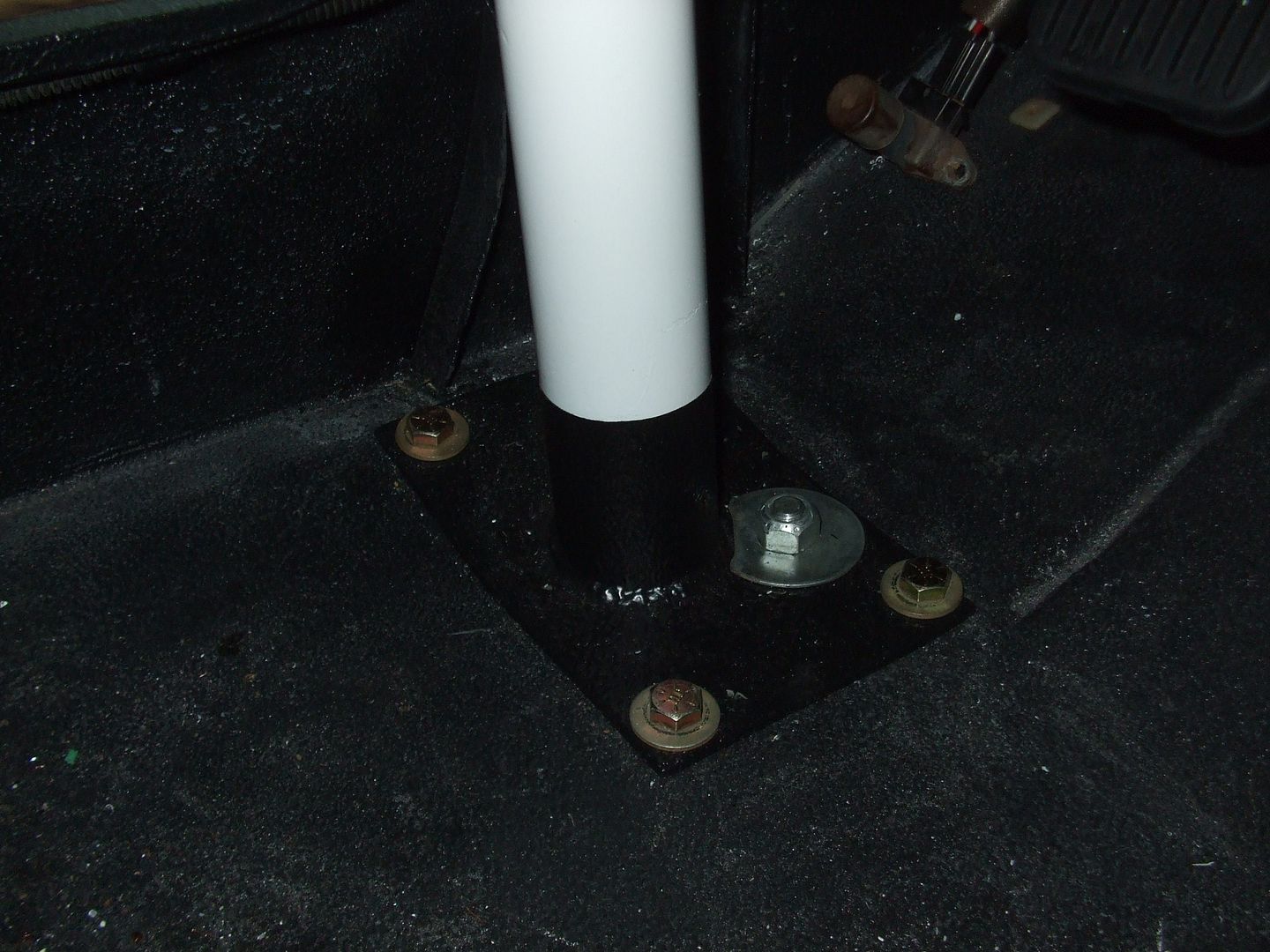

Here is a picture of the passenger's side.
The driver's side front is obviously bolted to the floor and I also stepped those up to the 3/8" bolts. The large center bolt is what ties it into the MORE frame tie-in kit. I had to trim the fender washer to fit around the post. Also notice the "mystery button" I still need to clean and mount.

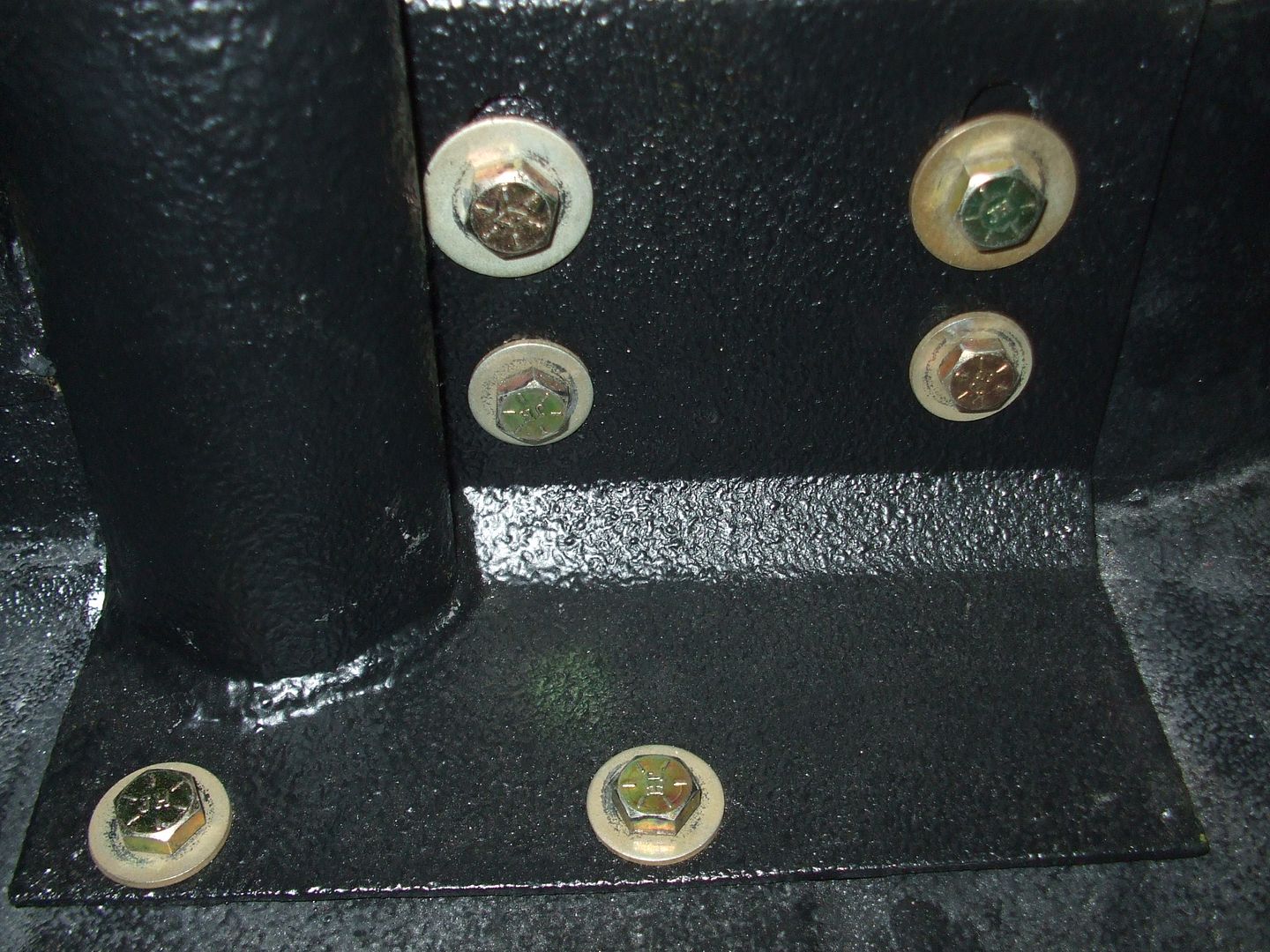

Here is a picture from the bottom. You can see the plate I installed to help distribute the load to the floor pan. You can also see the two 1.5" bolts that I'll change over to 1.25" so there isn't so much thread sticking out.
The passenger's side lined up better so I didn’t have to trim the fender washer. The PO did a fair job of installing the front hoop but it is not symmetrical from side to side. It's close enough to where I didn't need or want to mess with it.
Here is the tie-in for the front passenger's mount. I had to shave the MORE aluminum spacer about a 1/16" to get it to fit. Again, I'll change out those longer bolts to eliminate the extra threads.
The roll bar is rock solid and it's kind of fun being able to climb around on the Jeep like it's a jungle gym. I can't wait to get it out in the spring and give it a good wash to get all the layers of dust off of everything.
