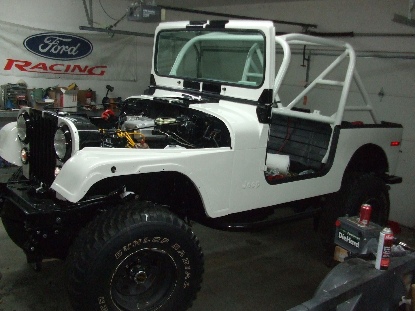

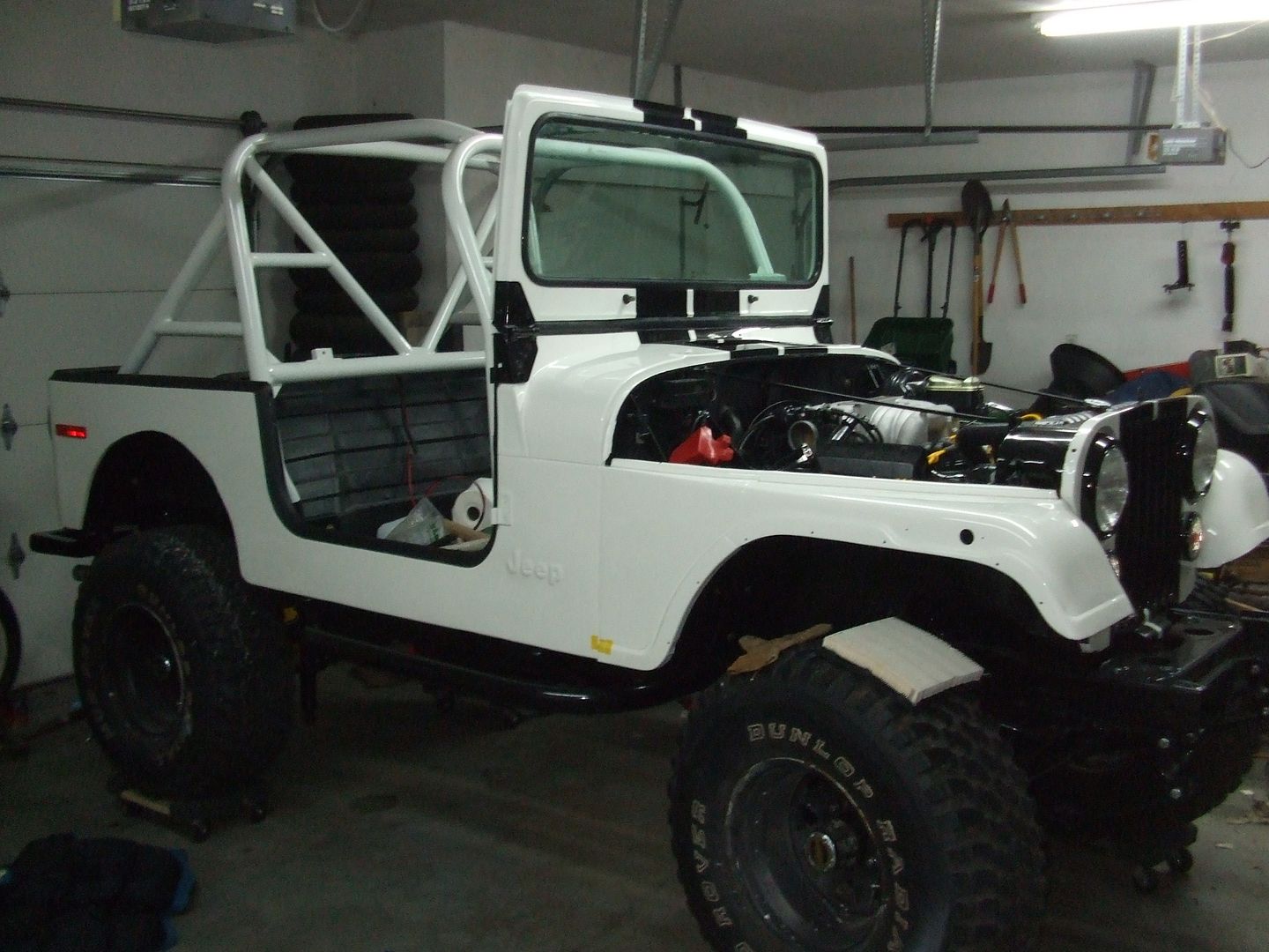

The main cowl seal is dry and so the windshield is ready to be folded back into place. I got some friends who stopped by to help me get the roll bar into the Jeep. This should help me line up the windshield angle, I'll also use the doors.
Time to bolt that sucker in and finish off the windshield. It is definitely starting to look like a Jeep again.

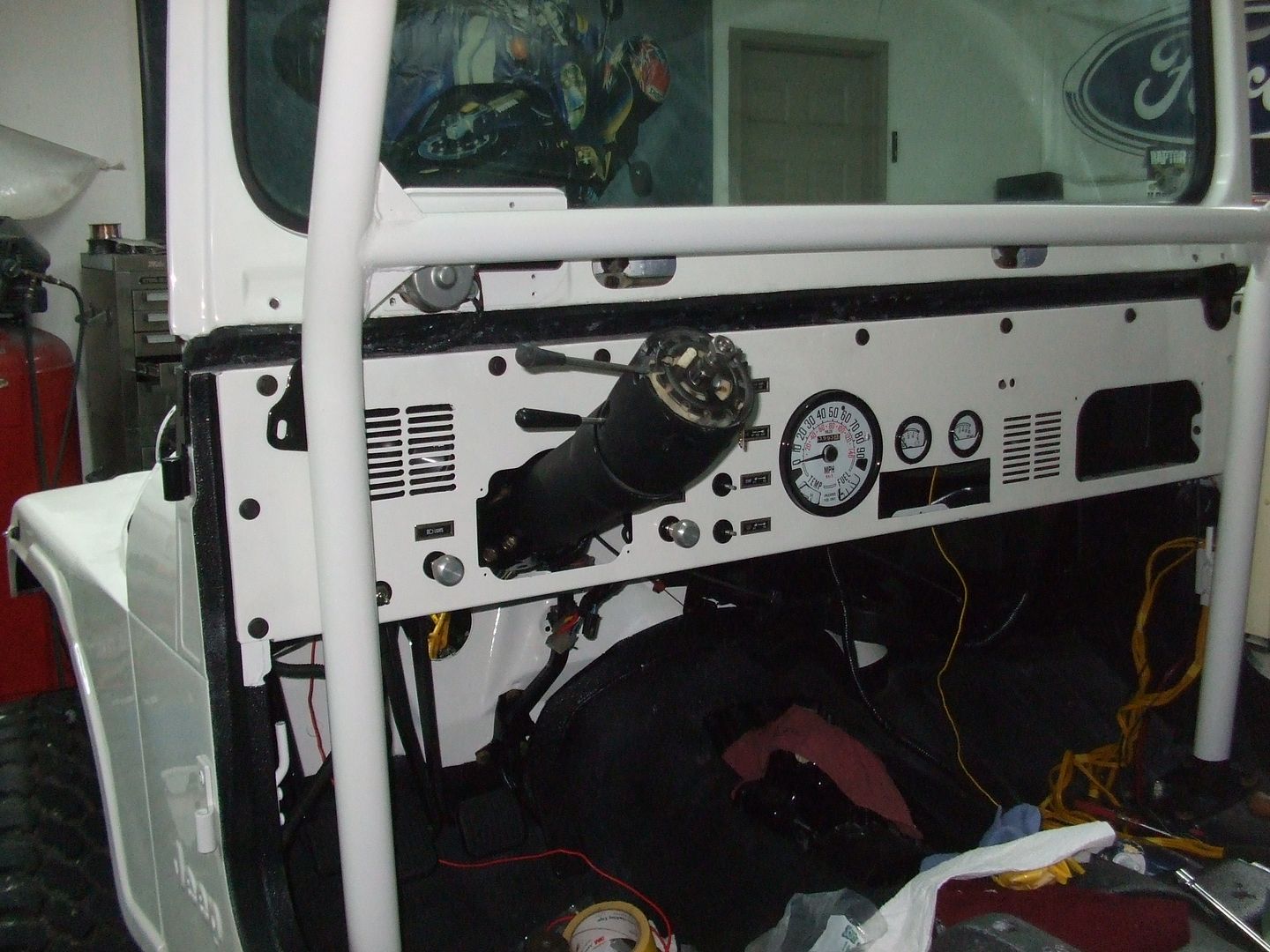

Steering Column
Thanks guys. You should see the stupid smile I get on my face every time I walk into the garage. I've got the next couple days off so I should have some Jeep time and will probably brew again.

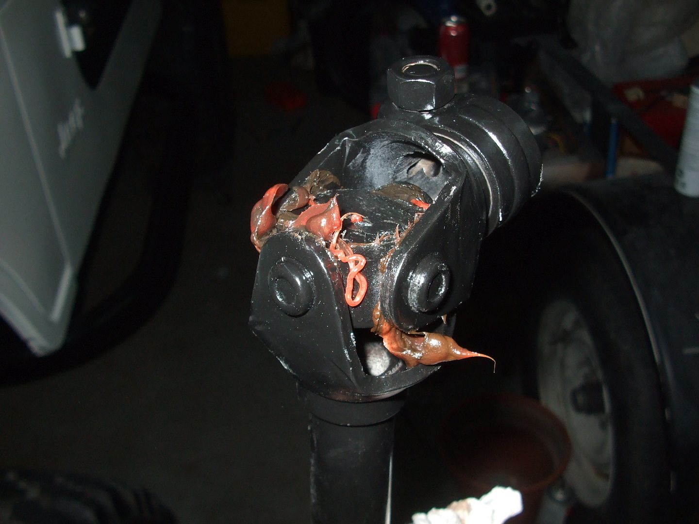

I had thoughts of saving my original steering column but decided against it. This was originally for an automatic while I have a manual trans. It was also loose at the tilt section and I just didn't want to mess with it. I figured this was one thing I would just get a complete remanufactured unit and call it a day.
So I bought a reman unit off eBay with a two year warranty. The third one was a keeper.

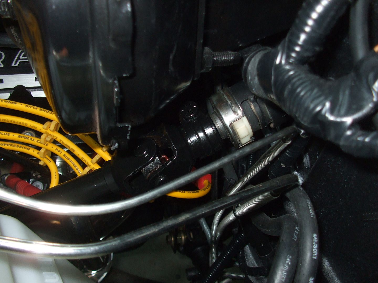

I took the intermediate steering shaft and greased the upper joint. There is a small hole right in the middle for a needle grease gun. Out with the old, in with the new.
I worked it around back and forth then hit it with the grease gun again. I did this a couple times until I felt satisfied it was full of mostly new grease.
The intermediate shaft looks good at the main coupling. You can see a little shot of grease coming out of the hole where you fill it.

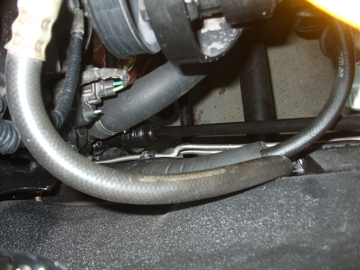

Plenty of room at the brake, steering and coolant lines.

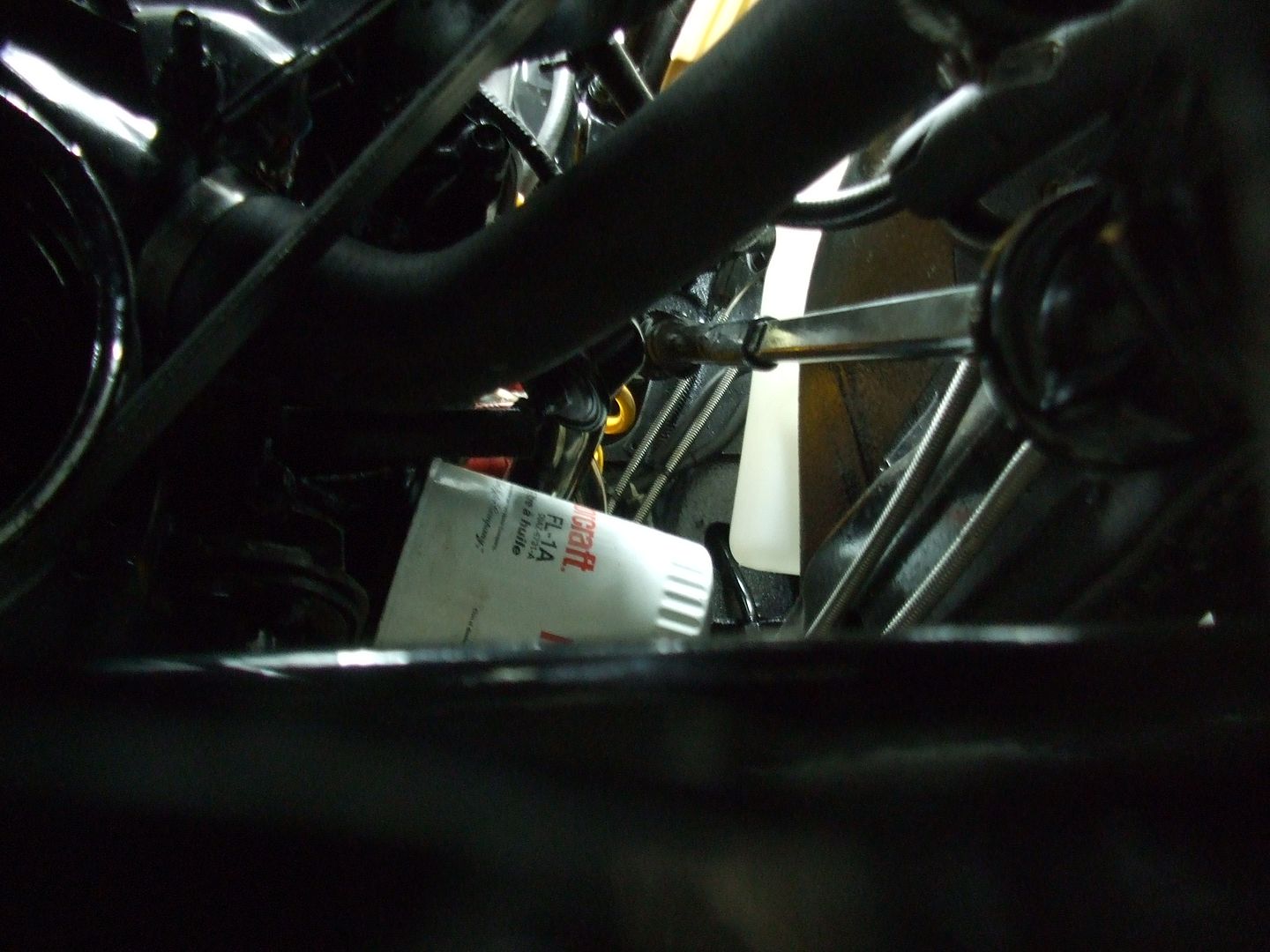

Here is one from the bottom to show how much room there is for the steering shaft. I took it without a flash because it was clearer. You should be able to make out the coupling between the upper and lower intermediate shafts. It had to be extended 1 1/4" to compensate for my 1" body lift.
