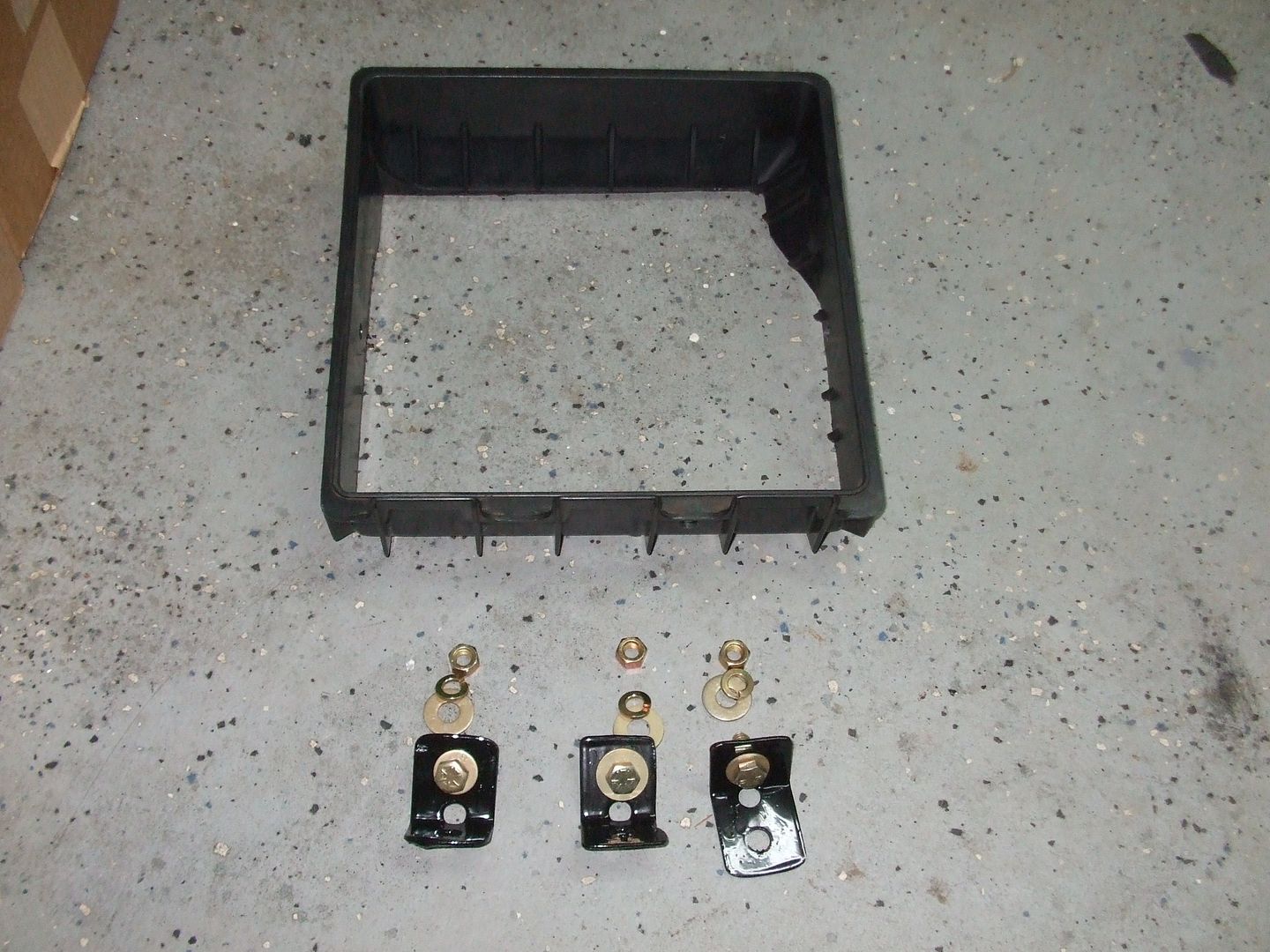

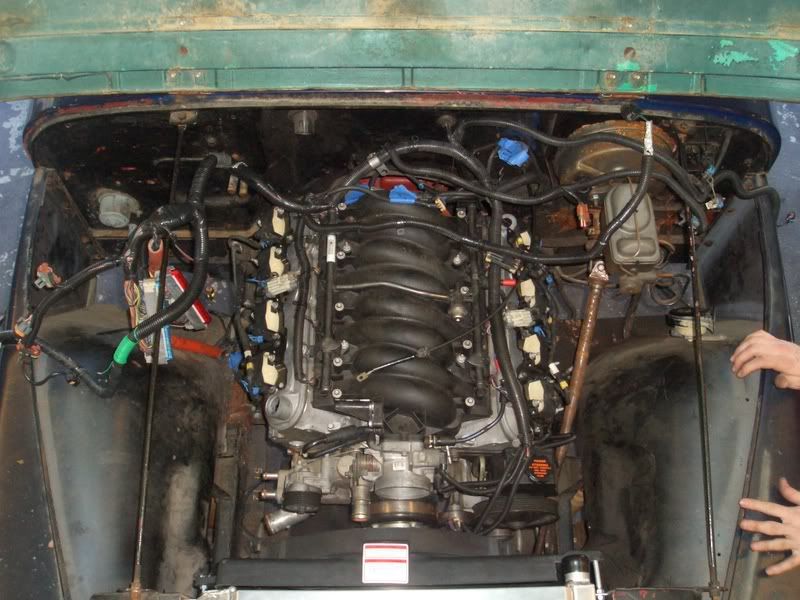

Air Cleaner Mod

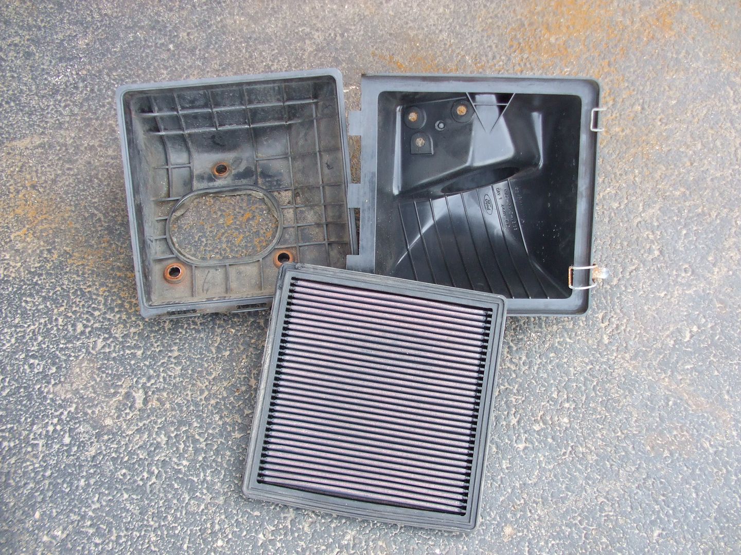

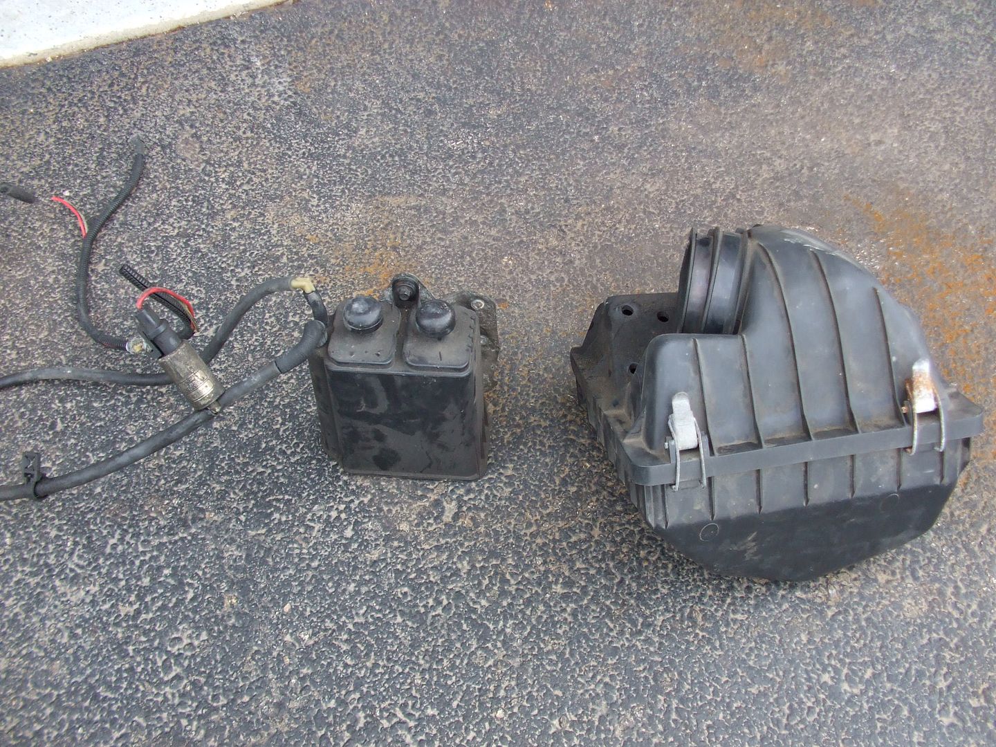

I originally had a snub cone K&N filter on the 5.0L because it was the cheap and easy thing to do at the time of the original engine swap. Having been in my business for the last 15 years and seeing a lot of different tests in regards to K&N filters compared to OEM originals, I wanted to get rid of the K&N and go back to an OEM dry filter. I don't want to get into a K&N debate, they have their place but I have decided filtering the air for my 5.0L is not one of them. So I went to the local salvage yard and hunted around for a possible replacement. I ended up with an air filter housing from a 1992 Ford Thunderbird Super Coupe. This air box is used for both the 3.8L and the 5.0L engines.
They had two of these air boxes and one of them happened to have a K&N filter in it. So I took the one with the K&N figuring I could eBay it to recoup some costs. I bought the air box and charcoal canister pictured above for $5-10. The used K&N is averaging ~$30 on eBay completed listings, not a bad investment. This box already has the perfect mounting holes for the MAF sensor.

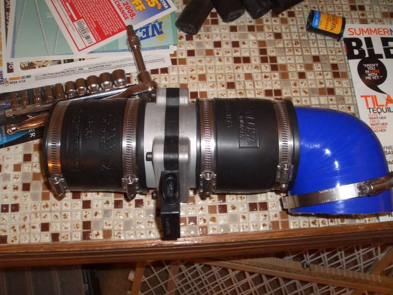

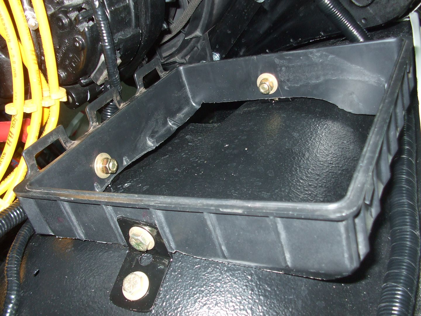

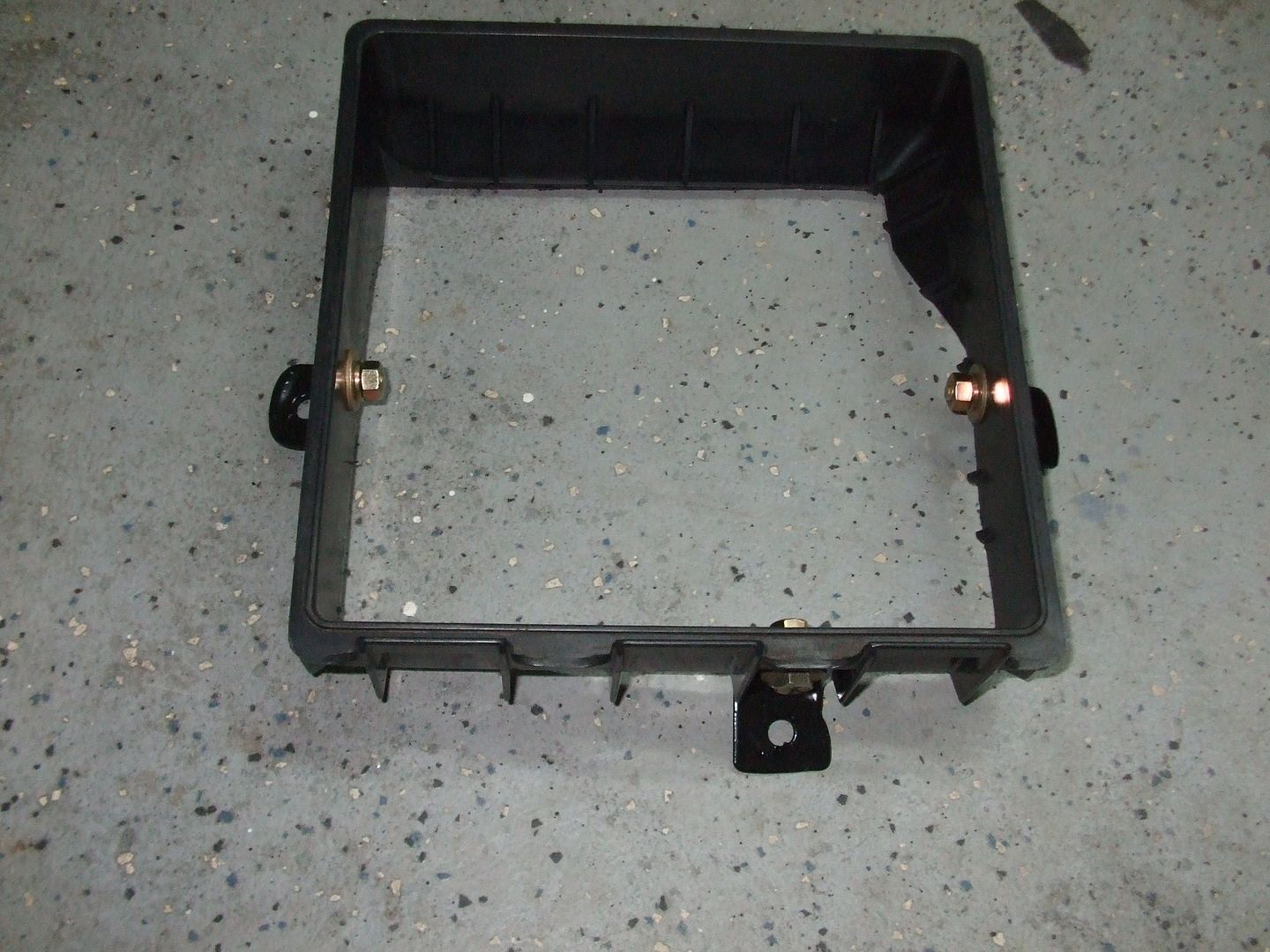

I mounted the MAF sensor and attached it to the throttle body to see where the box was naturally going to rest on the fender. I took off the lower section and trimmed it to fit the contour of the inner fender. Next I bought a section of 1/8" thick plumbers tape and cut and bent the leg mounts to attach it to the fender. Of course I painted the feet with POR/Blackcote.
Here it is with the feet installed. Three was enough to hold it solid.
So here is the inner fenderwell ready for the air filter housing.
When I painted the feet I actually went back and touched up any bare metal where I had to drill holes to mount stuff. Call me anal, OCD or whatever, I just don't want it to rust.

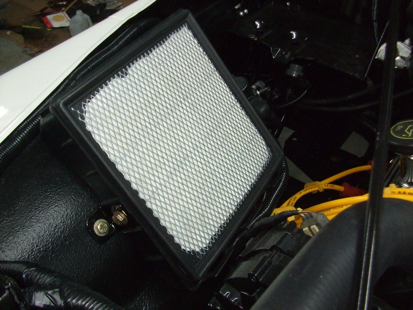

Here it is securely mounted to the fender. Three grade 8's should be enough to hold it.

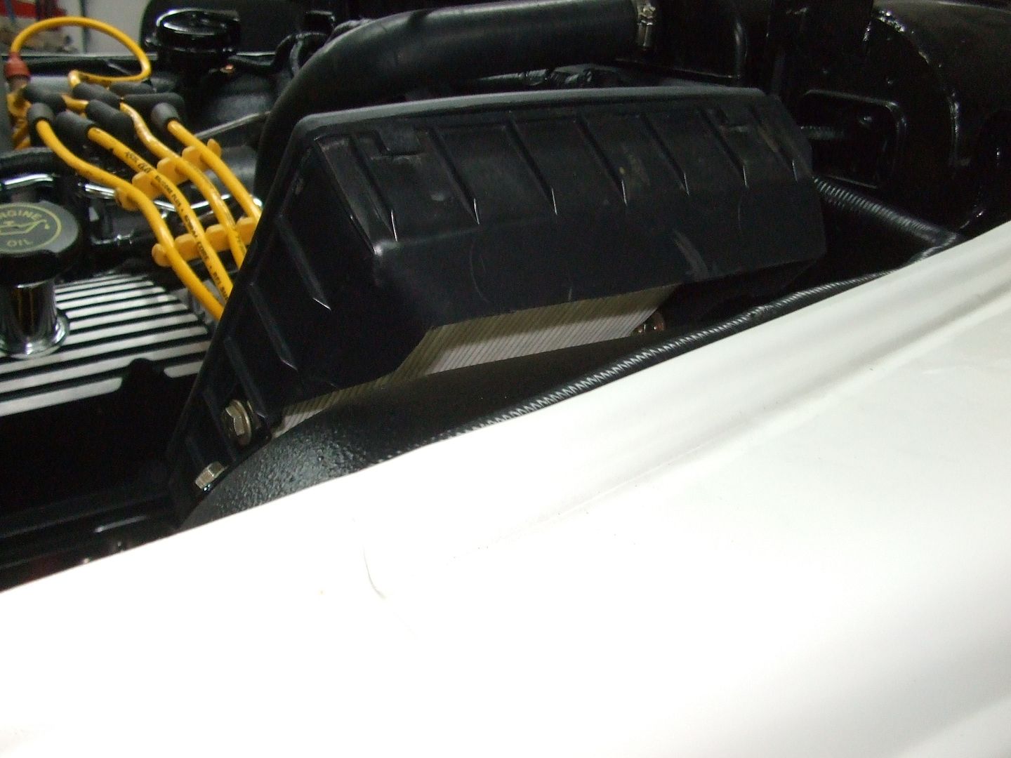

Here is my OEM Motorcraft filter.
There should be zero intake restriction and the inner fender will act as a splash guard to keep it dry.

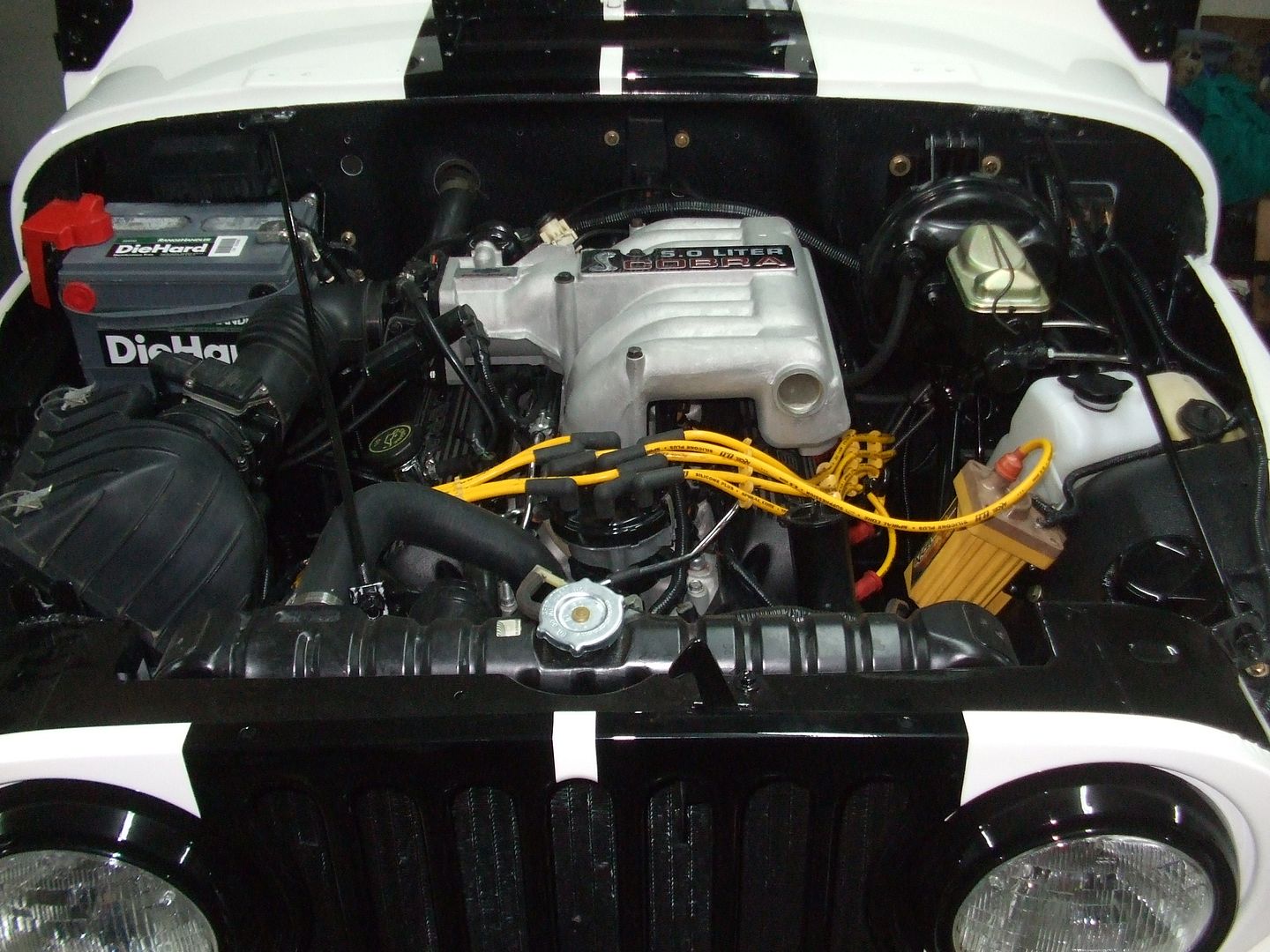

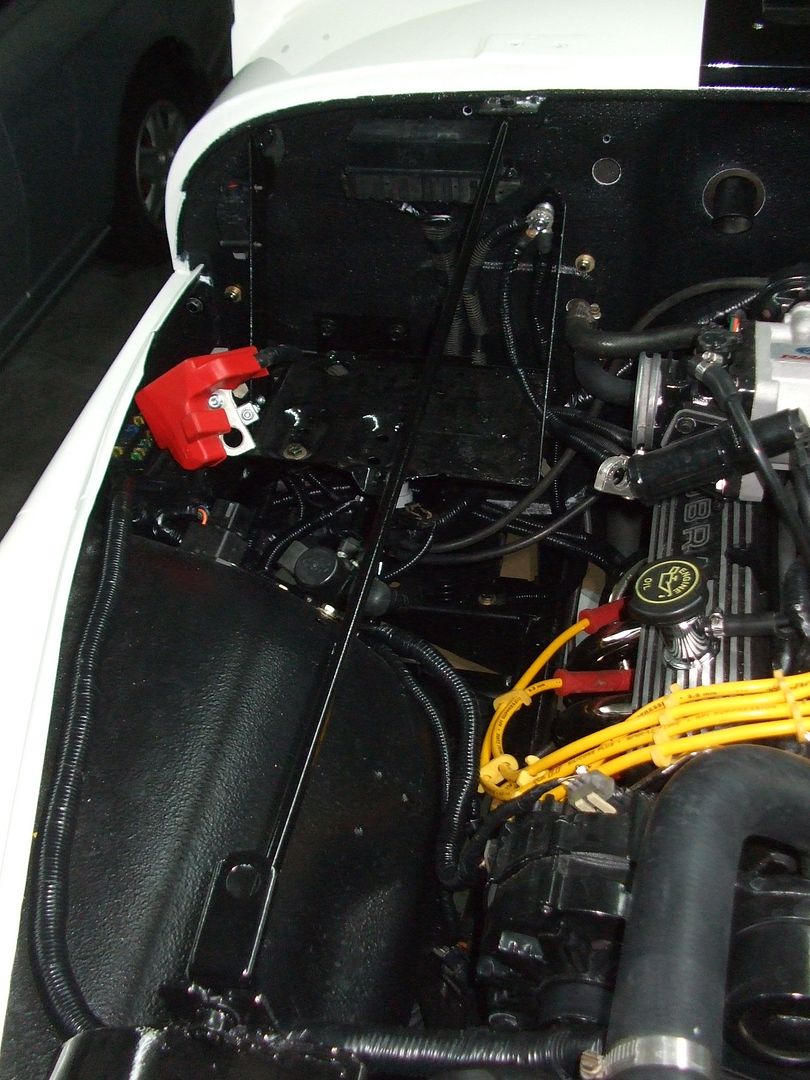

So the engine compartment is mostly finished. I just need to secure a couple harnesses and get the grill support rods tightened down once I get the hood on and make sure everything lines up.
For reference, here is what it looked like before.

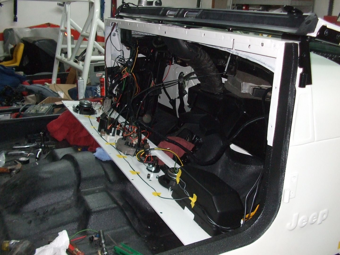

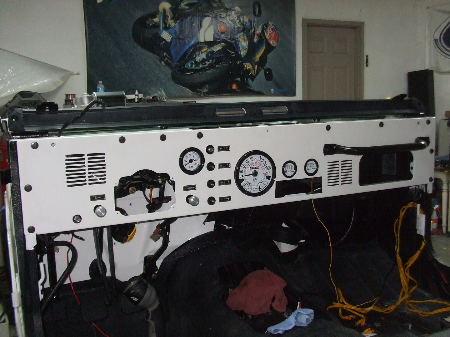

Since I got the windshield frame mounted I could now get the dash installed before installing and sealing the cowl seal. Here it is laid out and mostly assembled.
I did some minor rerouting of some wires and put it into place. I decided to install the dash using the black phosphate coated body bolts. I painted the original dash bolts white but the paint chips off the second you try to tighten them. Since these were manufactured black, no painting or touch up required. I also put a small seam of sealer all the way around the edge of the dash to help keep any water away that might try to run down the back side if it makes it past the cowl seal.
