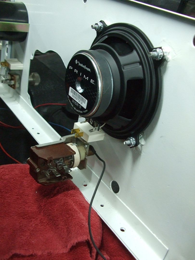

Here is a comparison of the Alpine speakers I pulled out and the new Rockford Fosgate 5.25" front speakers. Here is the back side.
Here is a picture of the fronts. I also have the 1" tweeter for these which I never had with the Alpine's. These should be decent and cost me under $100.
For the rear speakers I am either going with 6.5" components or 6x9's but I need to get my roll bar in before I decide what I'm buying and where I am going to mount them. The Kickers worked good but they were nothing special. The Boss subs have larger magnets and seemed to bump pretty good when I tested them in my living room, they sounded better than the fifteen year old Kickers.

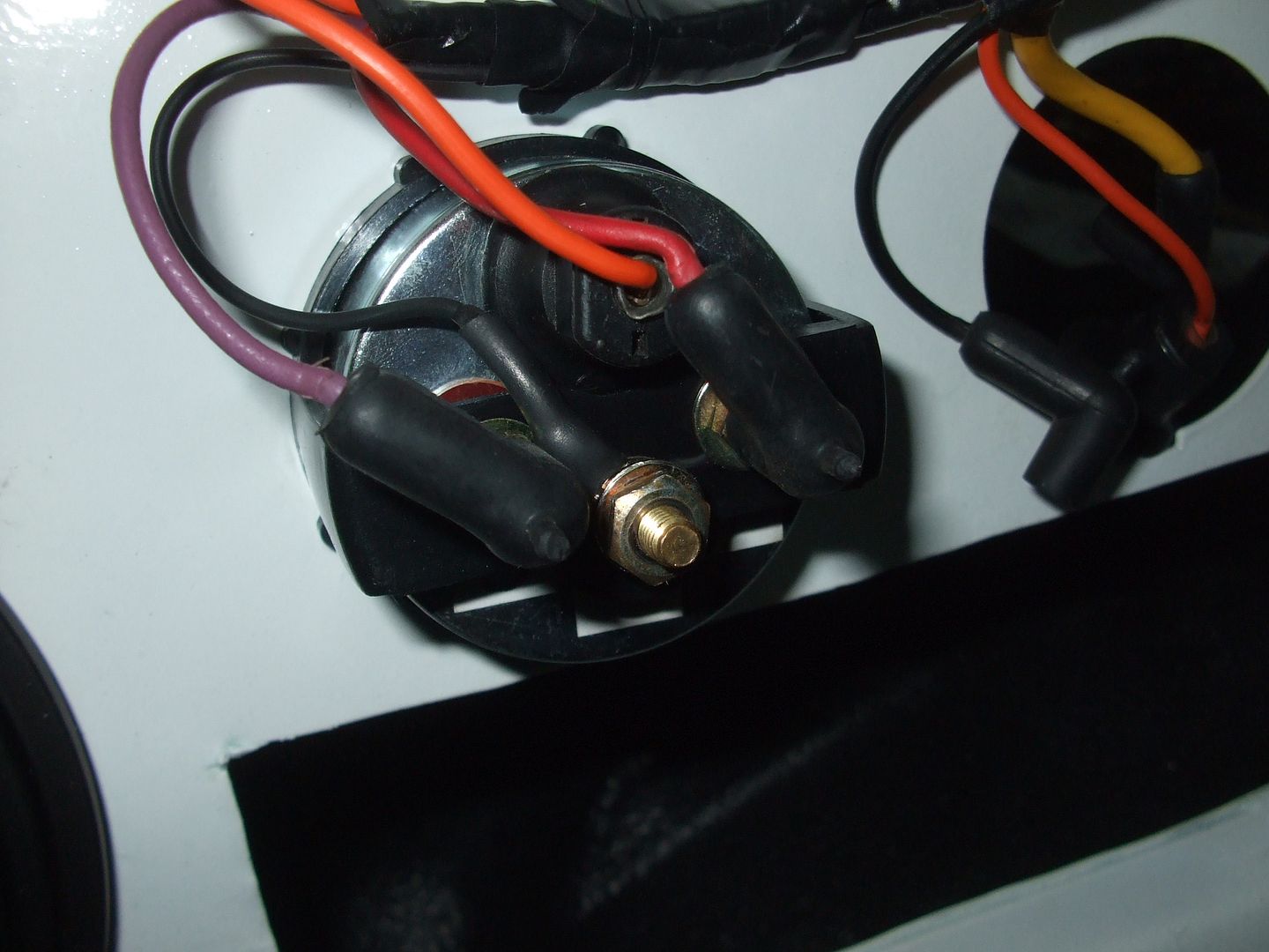

I wanted to show a couple small details I finished off on the wiring. I have a dedicated ground going to the oil pressure and volt gauge.

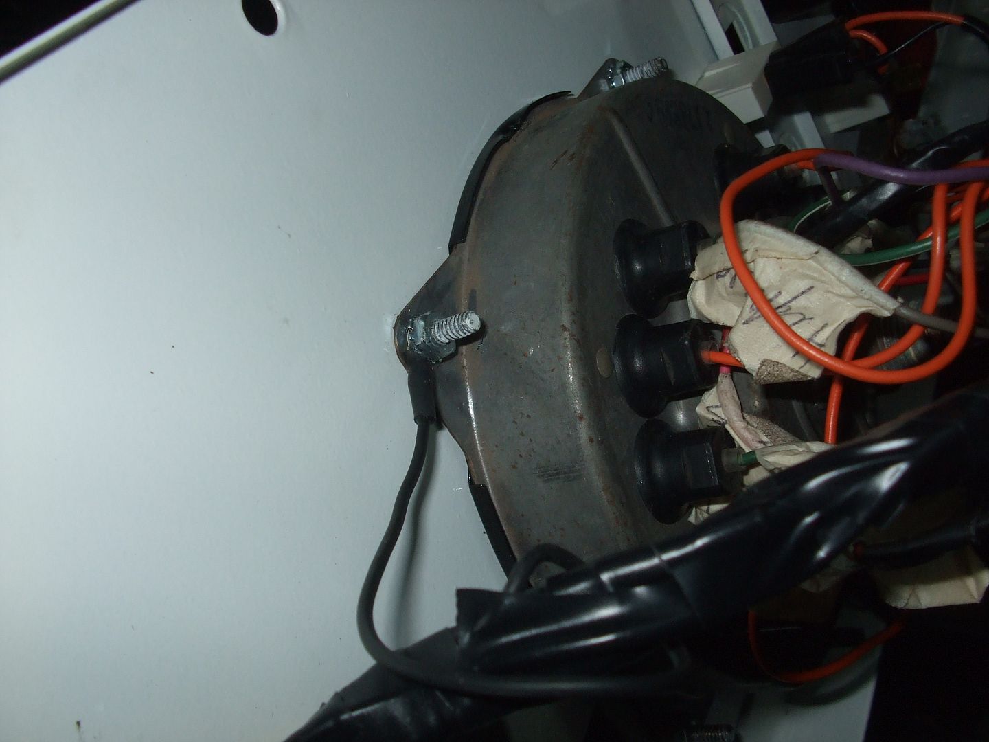

Here is another dedicated ground for the dash panel and the speedometer housing.

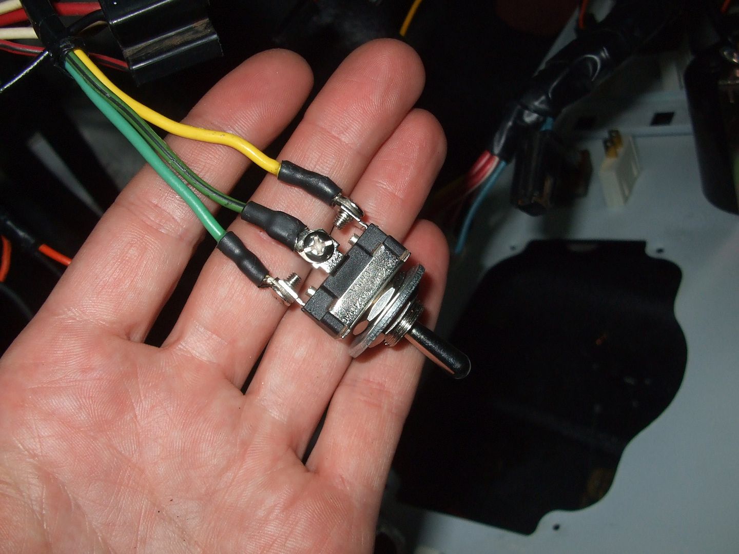

Here are wires for the cooling fan switch on the dash.
Here they are all finished up. This is what gives me on/off/auto for my cooling fans.

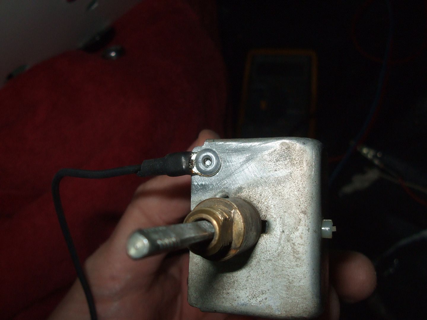

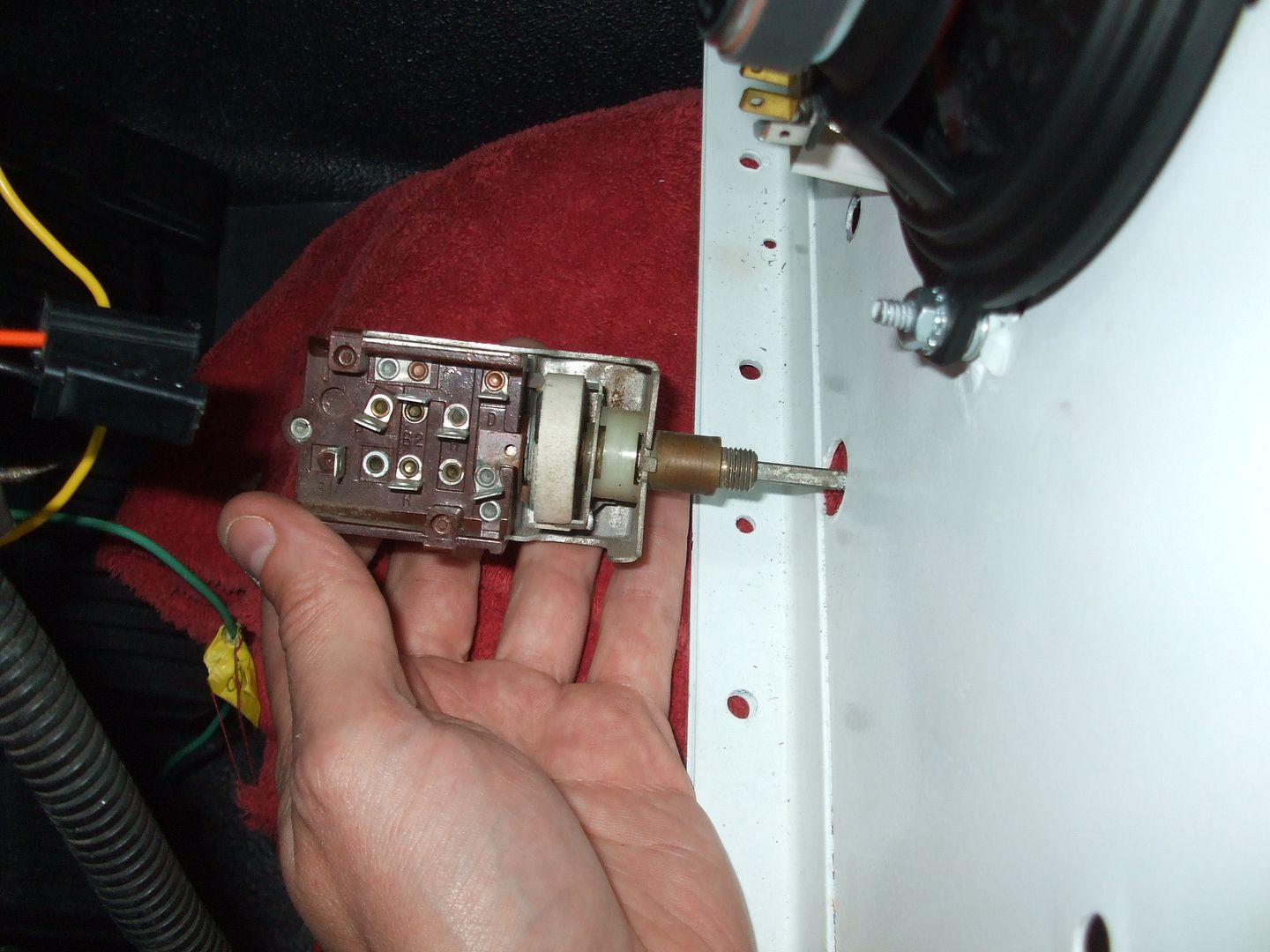

Another thing that needed a ground was the headlight switch. When you turn the knob all the way until it clicks to turn on the interior lights, it is turning on the lights by grounding them through the switches body. In my case there was no ground to the switch because of all the paint. Rather than scraping off fresh paint, I decided to run a ground wire.
Cleaned up an area and drilled a hole.
I decided to just rivet the wire to the housing. It's holding it tight.
That gets grounded at the post on my parking brake mount.

The main reason for the switch is so I can turn them off when treading water or any other time I don't want them to run. Most of the time I will just leave it on auto so the fans will be controlled by the thermistor input. Lastly, if for some reason I ever need to override the thermal input, I can manually turn them on.
