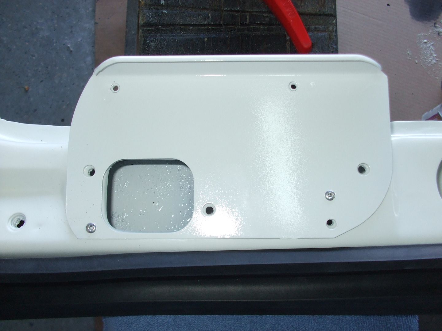

I made a trip to ACE and picked up some different o-rings and sealers.
The o-rings looked like they might have worked but when not compressed they raise the hinge off the frame enough to where the bolt holes don't line up with the threads. On a flat piece it would be fine but with the 90* bend it is just too far off. I didn't want to go using a bolt stuffed in there at an angle and start turning and prying to see if I could get it to thread straight and suck down the o-rings, so I went to plan B with the sealer which actually recommends it gets applied to painted surfaces. Here you can see everything I used. Rubbing alcohol to clean the hinge and frame, anti-seize for the bolt threads and the clear sealant for the hinge.
Apply some sealer to the hinge making sure to surround the bolt holes.
Stick it in place and bolt it down with some anti-seize on the bolt threads.
A picture of the other side. You can see the silicone coming out around the bolt head so there should be no issues with water getting in that way.
I smoothed out the excess with my finger then followed up with a damp paper towel.
I am going to wait to seal the cowl seal until I get it mounted on the CJ. I guess I am going to just go ahead and seal around the actual windshield seal since I already have the sealant. I guess I'll do that now so it can cure while I'm working on other things.

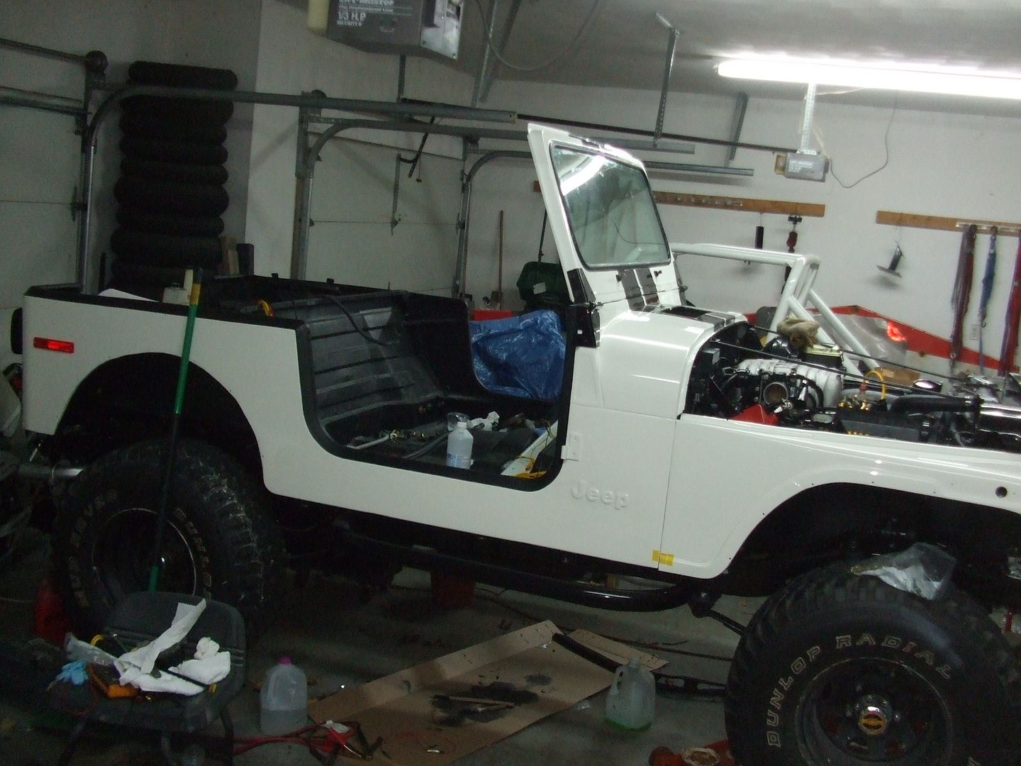

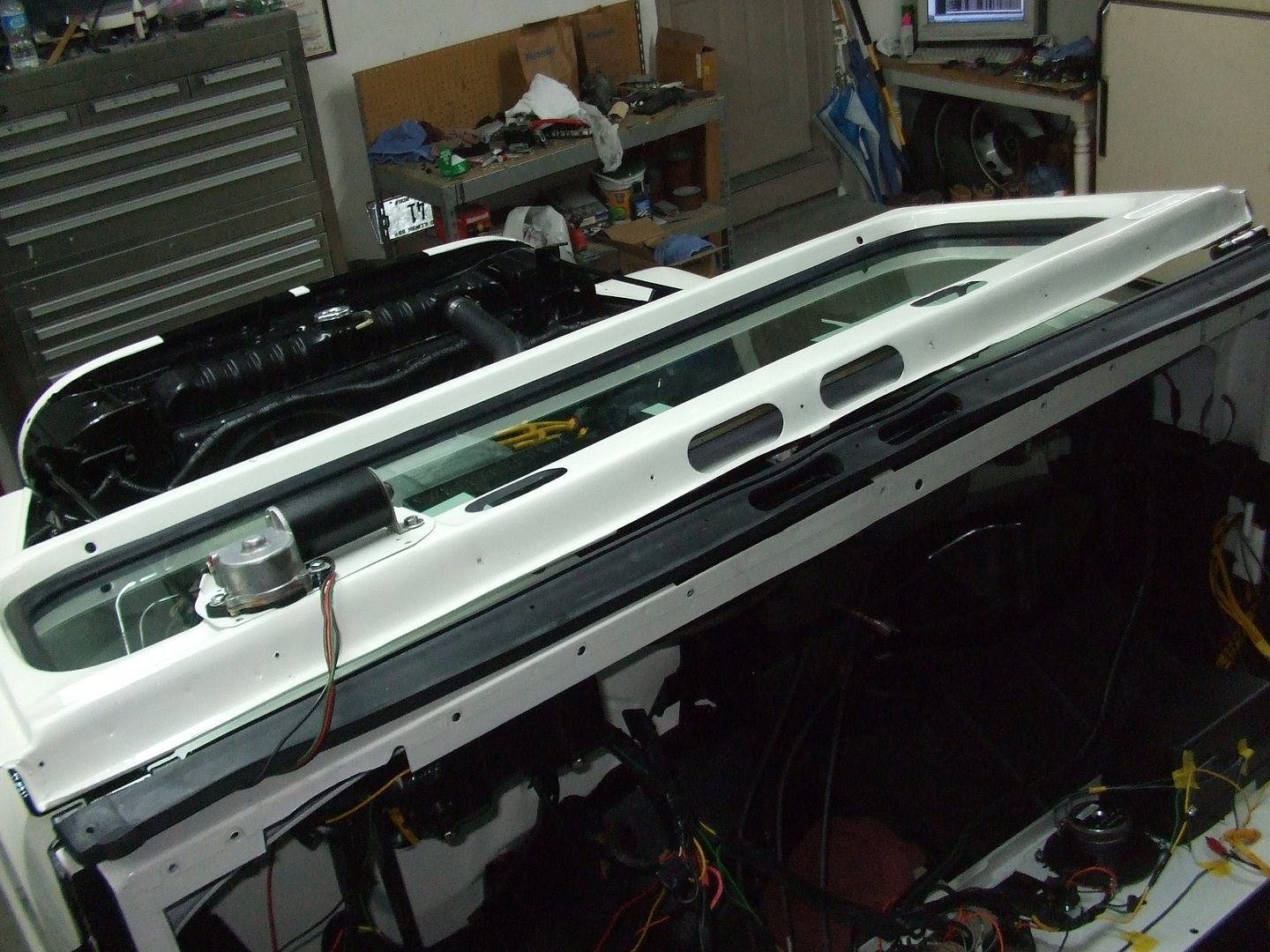

I'll do my best on the cowl seal. I have never done one before but I think I have a solid plan of attack. I'm basically going to attach the seal to the bottom of the windshield frame and let it completely cure. While that is curing I will install the dash and I think I am going to seal around the edges of the dash too. The next day I'll fold the windshield up and seal it to the tub.
I had to get the wiper motor installed so I could get the wires ran through the tub and under the cowl seal. I had originally installed the wiper motor cover with rivets but by the time I was done moving it around when apply sealer they were already loose so I just pulled it back off.
Notice the dedicated ground wire to the motor body mount.

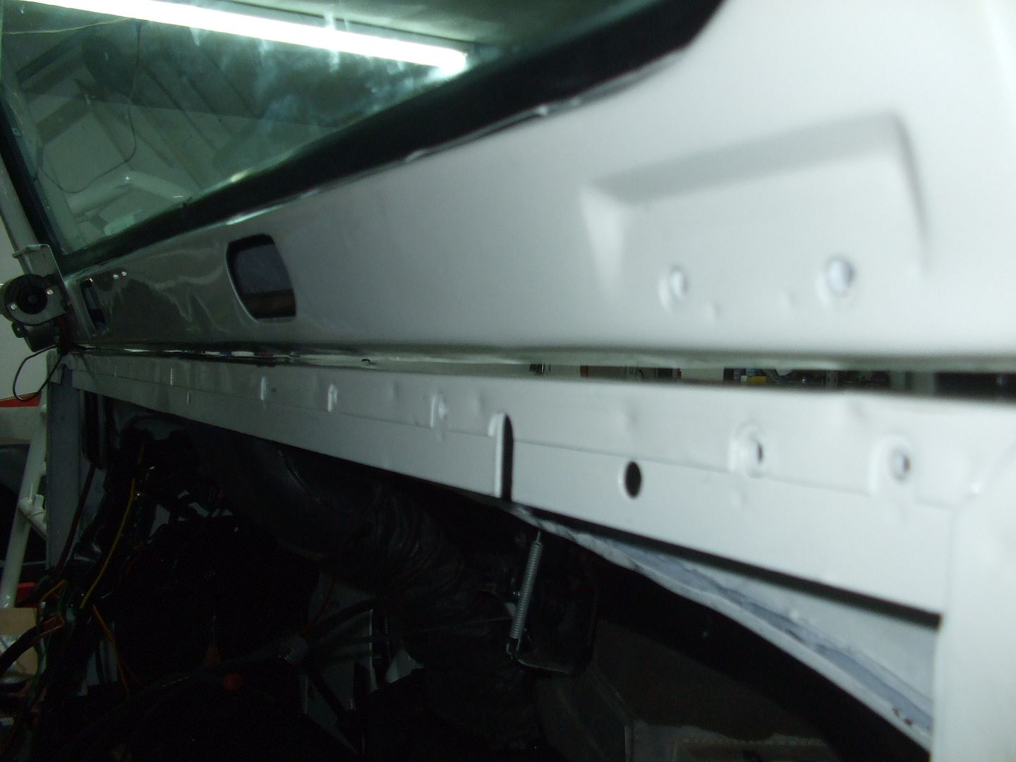

Here is the frame installed with the cowl seal laying in place. I installed the lower hinges the same way as the top ones, anti-seize on the bolts and silicone on the hinge.
I've got at least one thing I am going to have to deal with. Notice the fairly consistent gap between the bottom of the frame and the tub, you want that there.
On the driver's side it hangs a little low in one area, that will have to be pounded up so there is at least a small gap. Good thing that entire area is hidden by the seal.
It definitely makes the entire CJ seem bigger!
