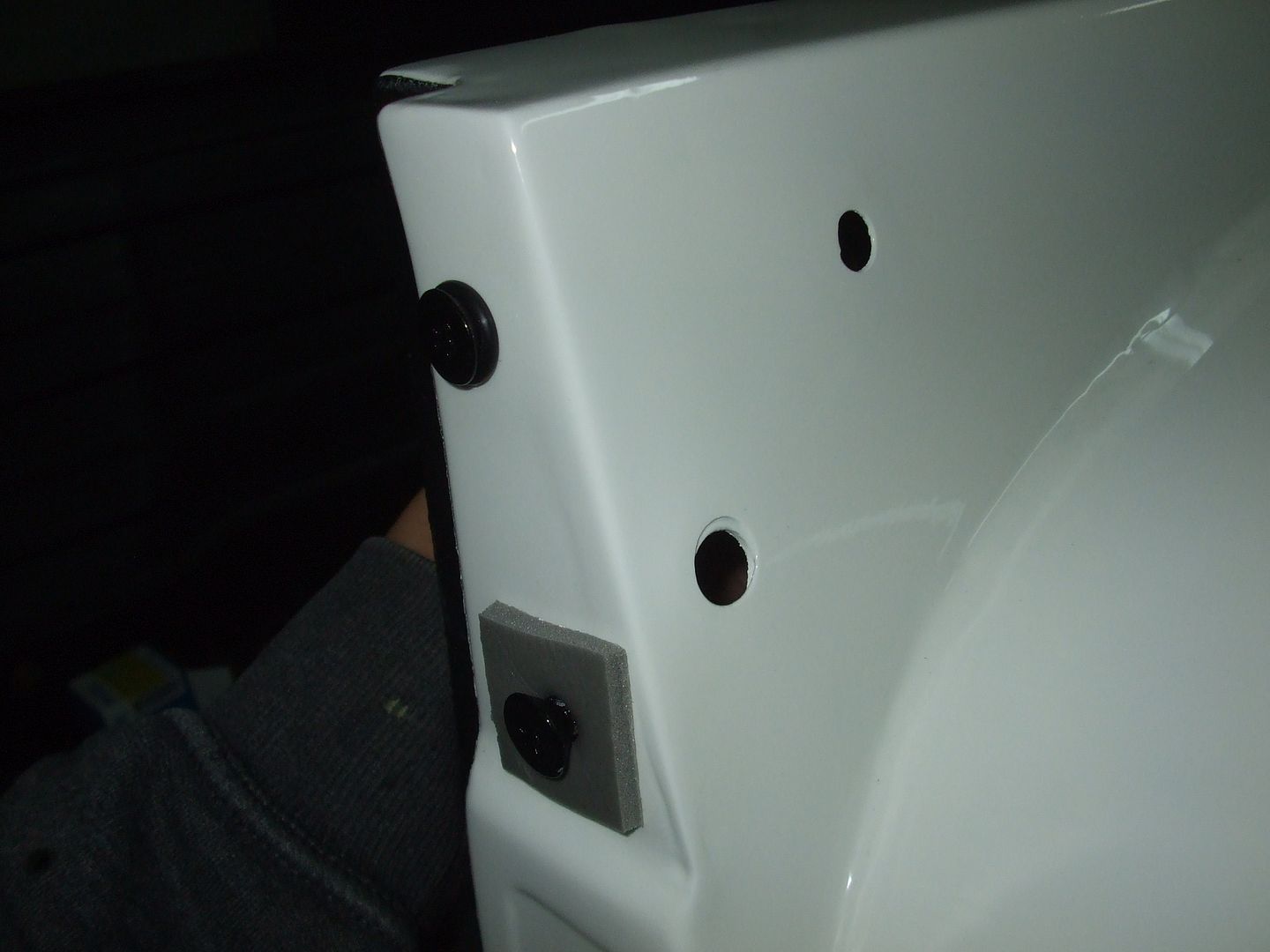

I'm still trying to figure out what to use to seal up the windshield hinges. I am not so concerned with water getting between the windshield/tub and the hinge itself, I want to seal around the holes in the tub so when water does get in there it will just flow out the bottom rather than into the holes and inside the cab.
My initial thoughts were to use that thin single sided foam weatherstripping that you would use between a camper shell and a truck bed. It is thin and compresses easily and should keep the water out. My only concern is that the foam might actually hold moisture. My other thought was to use a softer style o-ring that would compress and seal around the hole so any water should just run right around it. The last option would be to seal the whole thing tight with some sort of silicone but I know that most types can react with paint and cause premature corrosion.
This shows my weatherstrip and o-ring ideas.
Does anyone have an ingenious way to seal those off?

I think the O-ring would be a great idea, I would be a bit concerned with the screw backing out over time with the o-ring in between it and the surface though.
Otherwise I think it's the far superior option

I'd try the O-ring idea, the foam I think would hold moisture and make things worse.

Mike I like the o ring best. That won't stop moisture from getting under the bolt head and into the threads comepletely though. The silicone would be great if you could get something that's not going to attack the paint. You could even use that to seal under the bolt head. I'm thinking a call to one of the manufacturers might be a good step.
Just a thought, but does the same sealer they use around a windshield mess up paint? Haven't noticed but was wondering if that would work.

What about using clear automotive seam sealer?

I'd go the non-corrosive silicone route, form a gasket style.

My entire old windshield seal, the cowl seal and the hinges were all covered with silicone. I might run to Napa and see if they might have either of these. The technical data sheets for both of these products state they are ok to use on painted surfaces. This would definitely be the better option at sealing the hinges as well as the cowl seal on the bottom and the lip that runs along the bottom of the windshield frame. I just want to make sure I'm not going to use something that will be corrosive to the paint.

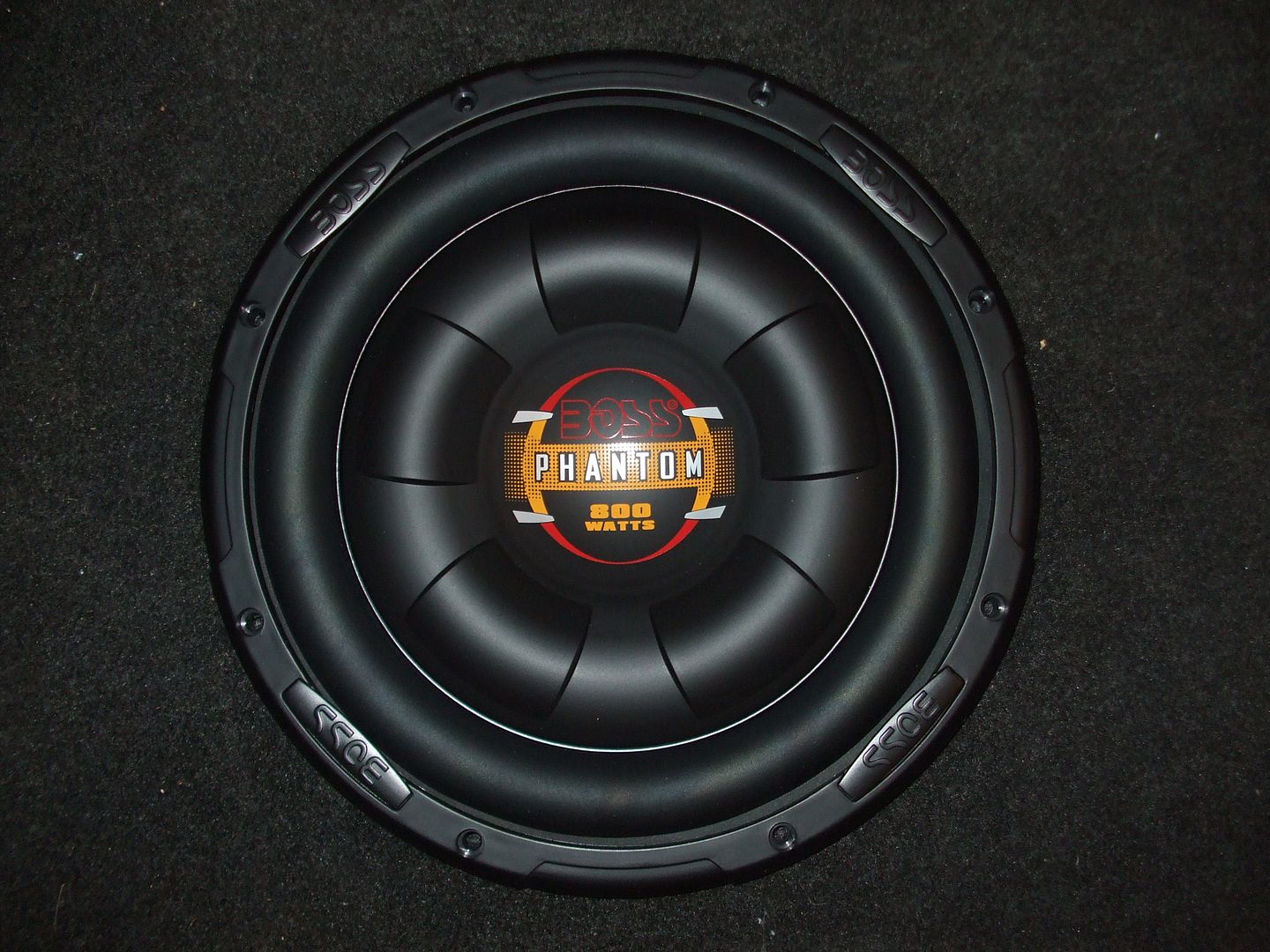

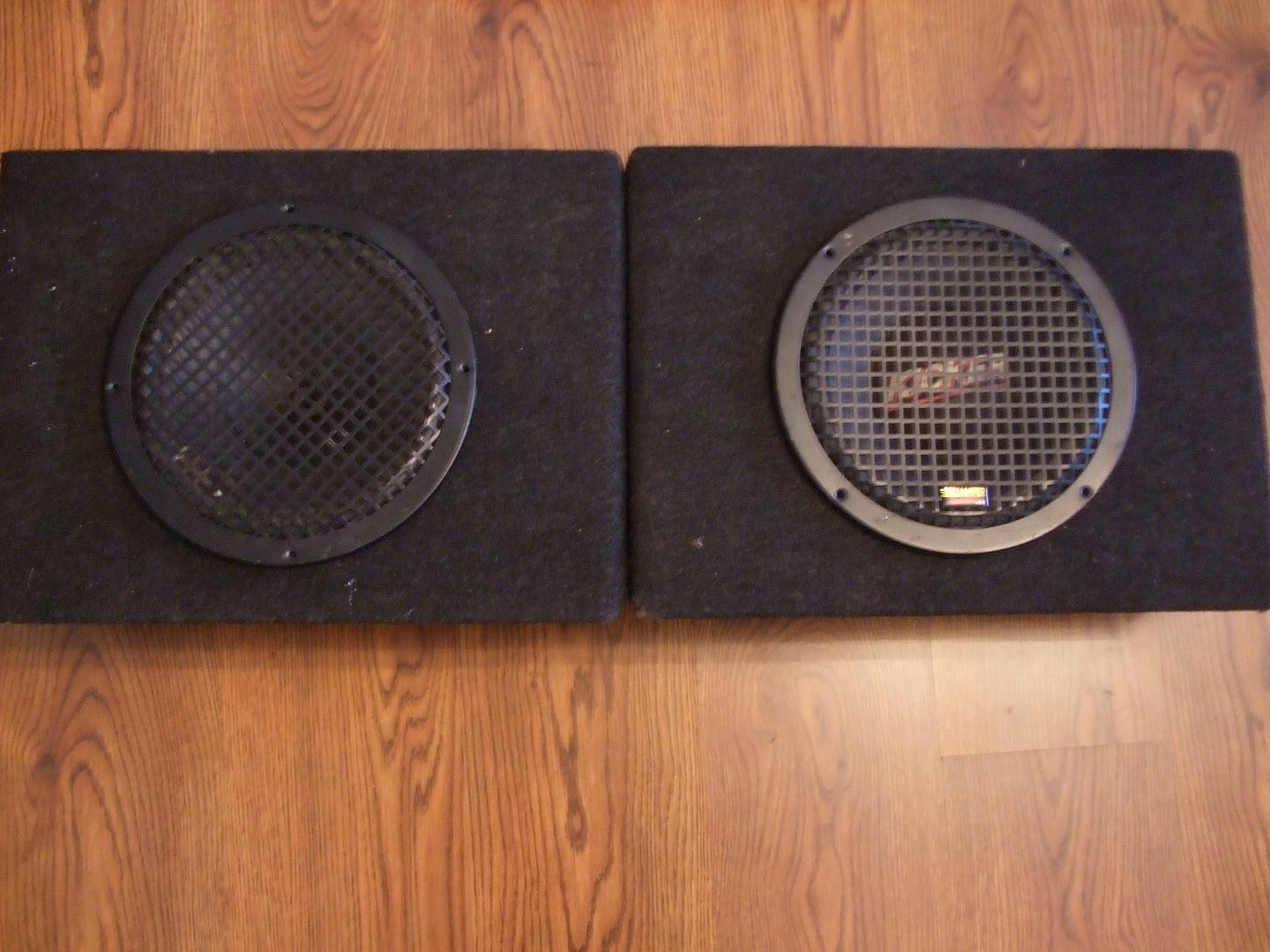

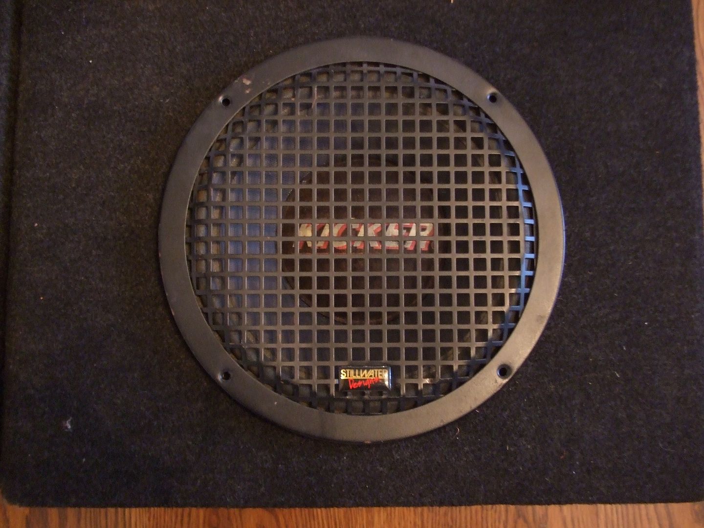

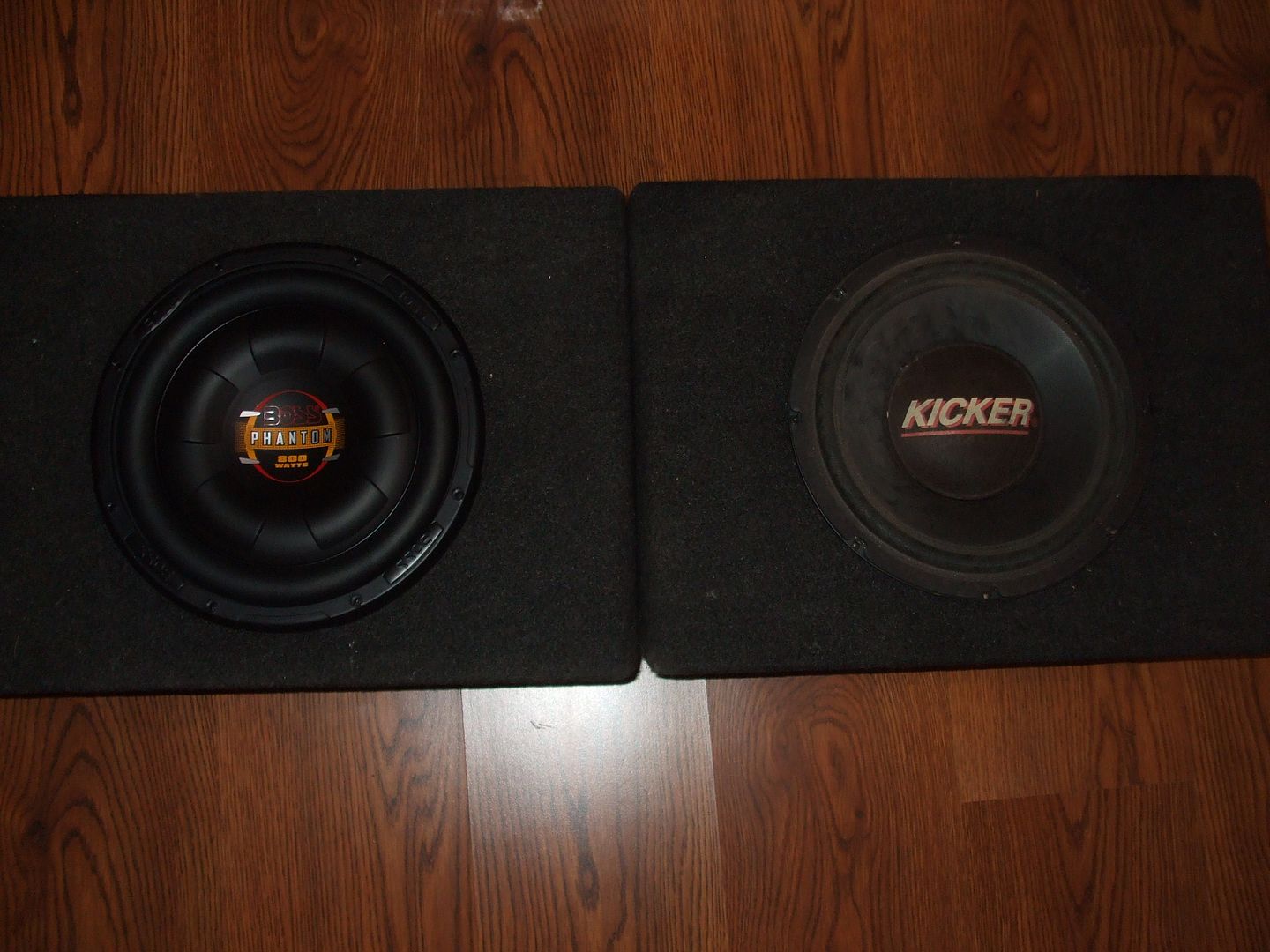

I got some new stereo components. I had some dual 10" Stillwater Kickers from back in the day.
They use to hit pretty hard with a true 60Wx2 amp. The amp no longer works so that is getting replaced. The subs still work but they are getting replaced too. One is missing the cone and both are just old and dusty.

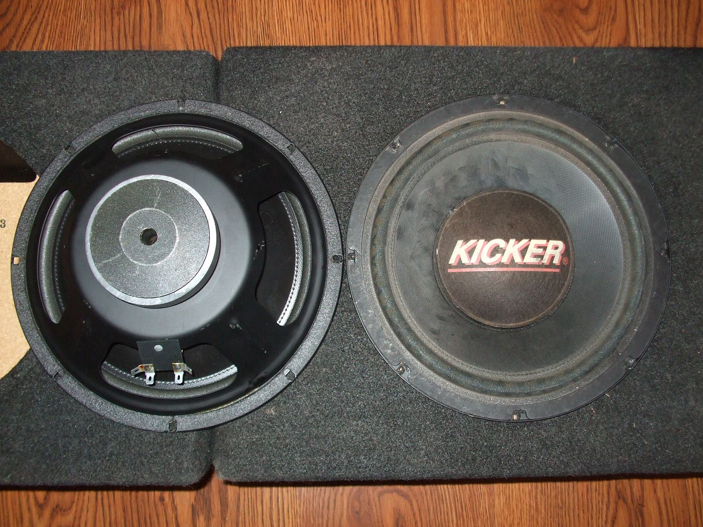

Once I pulled them apart you can see how massive the magnets are.

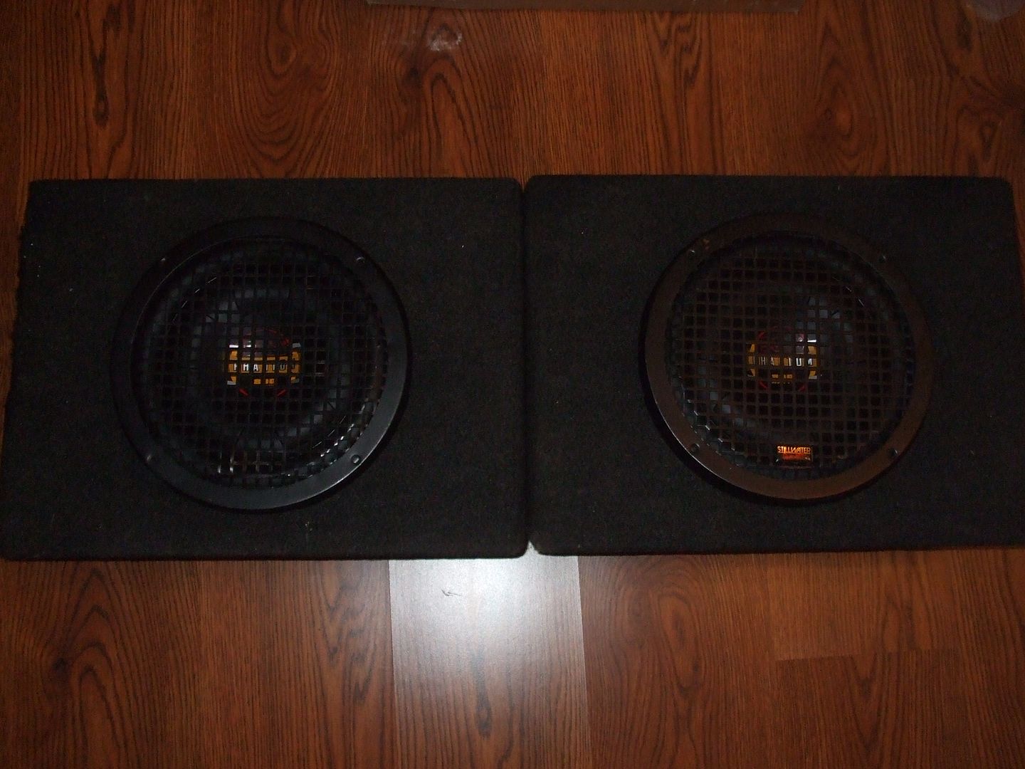

So I picked up a couple new subs on the cheap from Amazon. They were only $40 a piece. I had to get the short or flat subwoofers to fit inside my truck boxes.
Notice the slight difference in the size of the magnets.
Comparing the new to the old.
I think they look pretty good. I know they are not truly 800W subs but I think they will work great for the ~80W each I plan to run them with.
I plan on, and should be able to, reuse the kicker grill covers.
