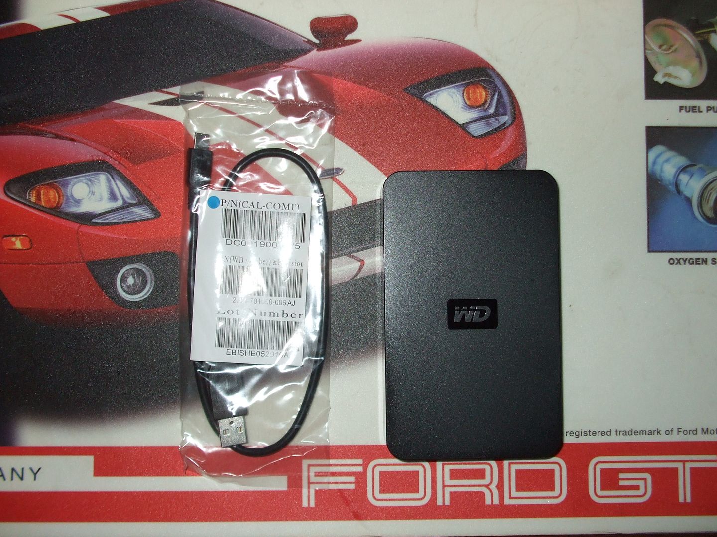

Check out this find. I picked up a 120GB WD USB2 external hard drive for $19.99 with free shipping from Newegg.
I've already loaded on my 28 Gig worth of music, that's 8,102 songs recorded at 192kbs. I might have to reorganize the folder structure to make the Alpine happy but that shouldn't be too difficult. With this I can control the music through the Alpine deck but I can also still control my Zune in the center console if I want to. Best of both worlds and great for only $20.
With how small it is I'm thinking about securing it to the top of the glove box. I could even put it right on top of the Alpine. Out of sight out of mind.

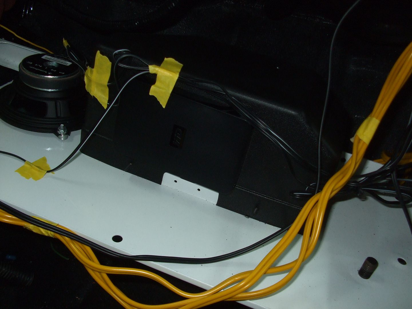

I've finally got my volt gauge fixed so the dash is ready to go in once I get my speaker and stereo wires sorted out. I would like to get the windshield installed before I install the dash because it is so much easier to get to the lower hinge nuts. A couple friends are stopping by later so I hope to rope them into helping me install the windshield into the frame.

Ohhh don't shake it too hard or tap it. The drive is probably turning at 7200 rpm and the read/write heads are on a super small cushion of air. This is the primary reason, besides manufacturer's defects, for failure. That is why notebook drives fail more than destop drives- they just get handled too often.

JeepsterJC is right. The drive is probably 7200rpm and they do not like being handled/moved around much. Might want to find something to dampen the vibration. If the drive does end up failing I would look into a solid state drive. Costs more but you would have no problems with vibration.

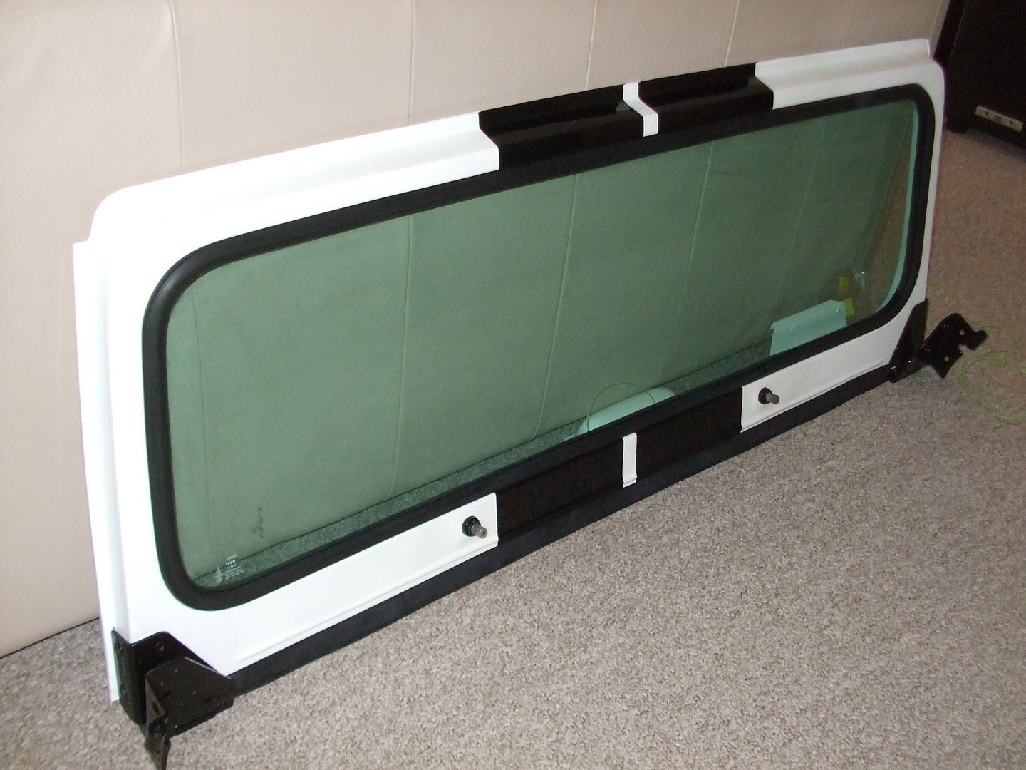

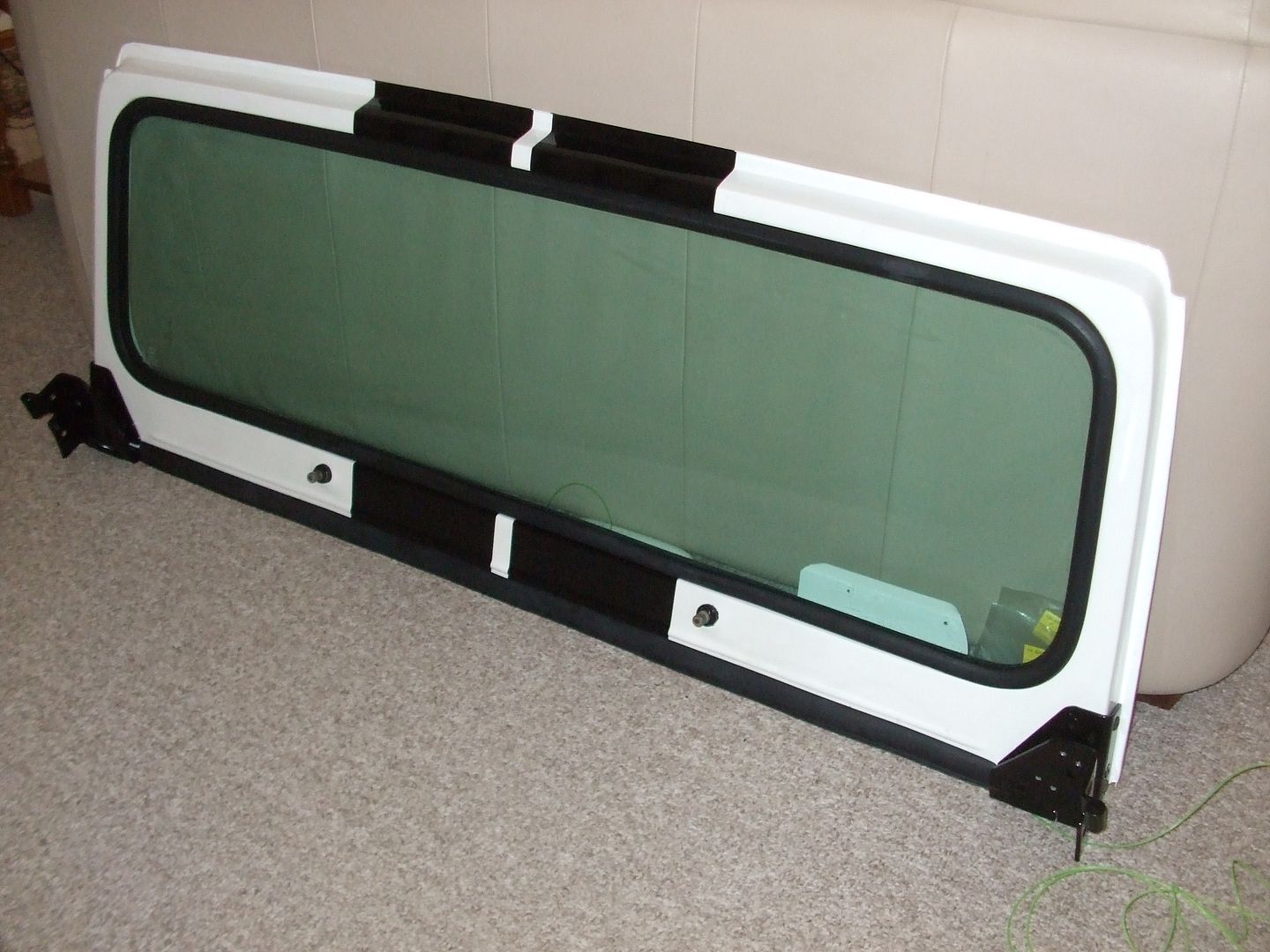

I had some friends help with installing the windshield into the frame. I had never done that before and can tell you that is was a lot of work. All three of us were sweating by the time we were done and it took almost an hour to do. Sorry I didn't take any pictures of the process but we were more focused on getting it done and not letting the seal pop out of place.
We used the trimmer string method to get the lip of the seal over the run. A couple things we learned. Start pulling the seal over the lip in the center of the windshield, don't start in the corner. When pulling the trimmer string, you don't have to press on the outside of the windshield as hard as you think, it is actually pretty light. Once the seal is over the lip and you can lay the windshield frame flat on the floor, that's when the real fun begins. At that point we used a lot of glass cleaner as lubricant and my bondo scrapers to work around the outside of the seal and glass assembly to get it to fall into place.
Now I can install the frame onto the tub.
Once that's bolted on I can install the dash, roll bar, steering column and then a seat for a test drive. This thing will be going together fast but I still have a lot of things to do. I still need to install the stereo components, interior lighting, shackle hangers, front and rear bumpers, D300 twin sticks and fender flares. I also need to modify my winch mounting plate so I can install and wire the winch. I also need to fabricate my trans tunnel cover, center console and a few other small parts. The hood needs to get finished up and I still need to wet sand and buff the front fenders.
