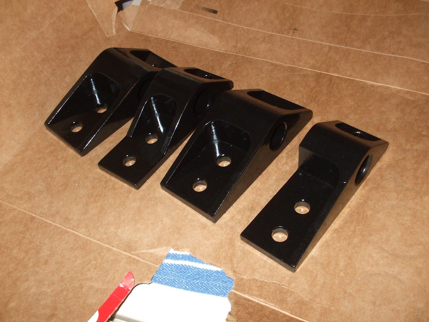

I got a coat of POR on the hangers Jim. I actually just put on the second coat. I will be hitting them with the Blackcote in an hour or so. I was using up the last of a quart jar and must of had some dirt in the lid groove or something. There are small specs of dirt throughout the paint that I'm hoping the Blackcote will help cover up. Either way they are looking good.

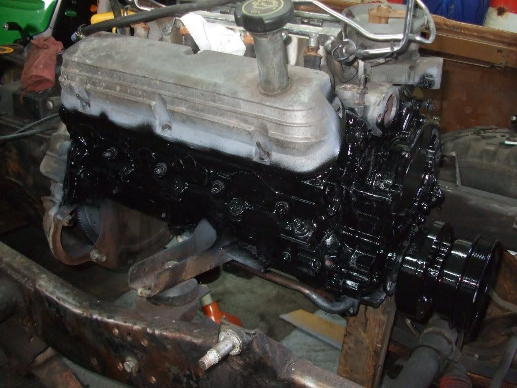

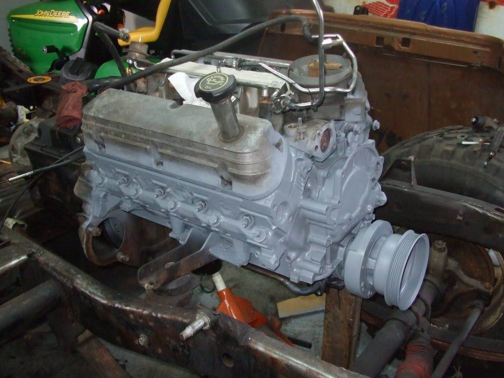

Going as fast as mine? In February it will be three years since I started on this. I'm just at the good part where it all goes together pretty quickly.
Not sure what you mean about the engine. I bought and installed that in 1996. I put on the GT40 heads and Cobra roller rockers in 1997. During this rebuild is when I added the Cobra upper and lower intakes with the valve covers. Every picture in here is of my engine.
Forged pistons.
Stage 8 locking header bolts.
I also just got my air cleaner box mounts made up. Need to get some paint on those. Most of the engine compartment detail work is done.

You have the hangers looking great Mike. I sure can't tell that you brushed the POR on, you're gettin pretty good at this.
Looking forward to seeing the install and even more updates!!

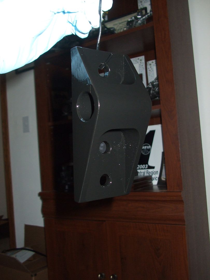

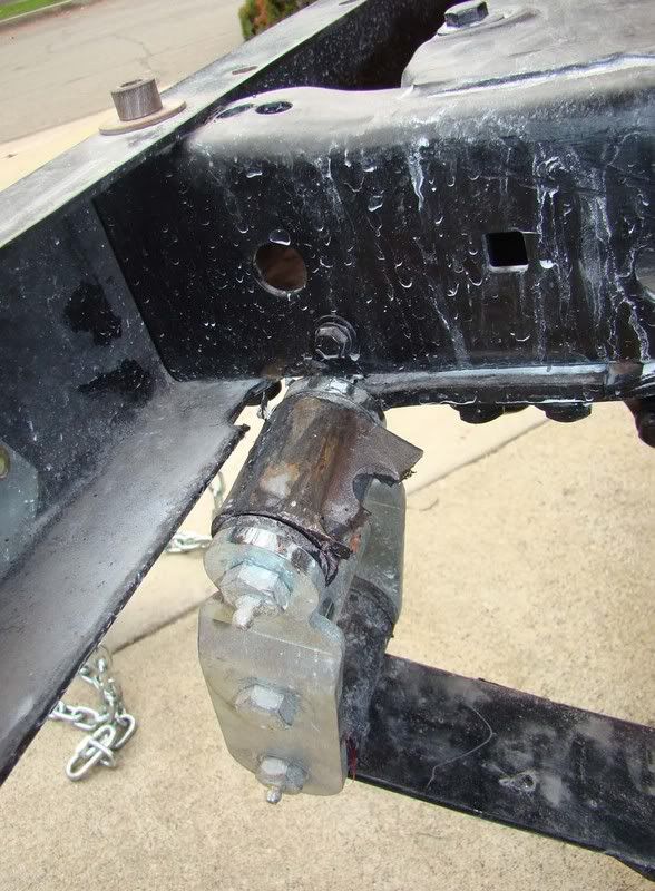

Also.. I am kind of new to Jeeps since I recently got mine, what are these hangers used for?
They are the main attachment point of the suspension to the frame. These are the spring shackle hangers that bolt to the bottom of the frame at all four corners. The top of the shackle rides on a bushing in the center hole. Of course the other end of the shackle is attached to the end of the leaf spring. Here is a picture of a stock one, they are known to break or have the loop "unwind" allowing slop in the bushing.
Here is a picture of a broken one courtesy of CopperCJ7.
Here is the Slickrock Fab design. Better than stock but they want $115 just for the front pair.
You can get a front pair for $70 from Jim or all four for only $145. Not only do you get an awesome set of hangers you're also supporting a JF Vendor and all around nice guy.
