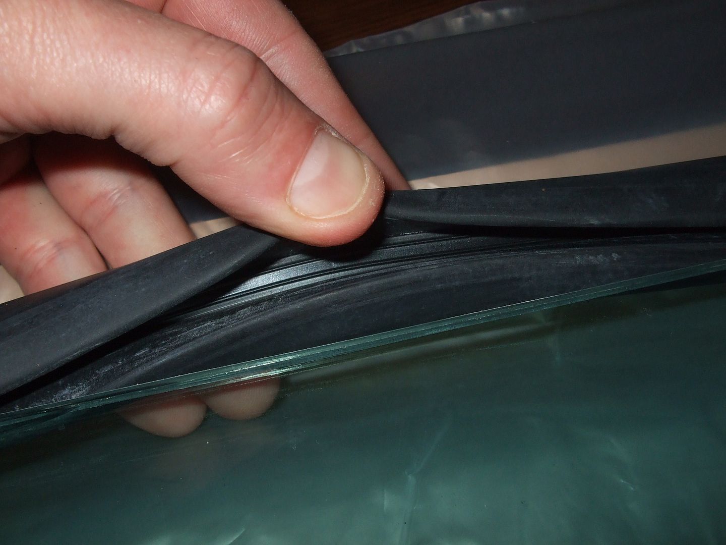

You made me go back and look. I peeled the seal away from the edge of the glass and used a new razor blade cutting at an angle to see if something would cut or peel up, all glass. Jeff said his looks green too and I think the gray material behind it makes it look darker than it really is. When you hold it up and look through it, it is not nearly as noticeable.

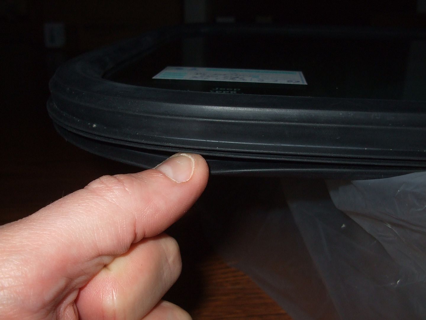

I would say you got the wrong seal. Here is a picture of me holding the single groove for the actual glass open. You can see little ribs down inside the groove but there is only one main slit for the glass to sit in.
Here is a picture of the outside of the seal. My thumb is holding open the groove that will sit in the windshield frame channel run. The two small lips above my fingernail are not another deep groove just small lips which help to block the water from the outside. Hope that helps.

Jeff,
Thanks Mike,
You really helped to clear that up. I was in contact with Morris today and they are going to check with the manufacturer.(I lost the bag the seal came in)

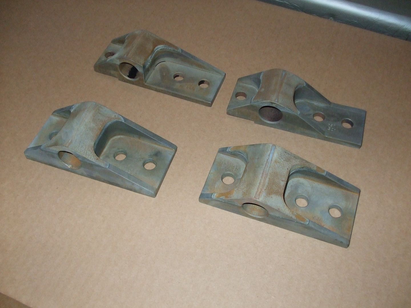

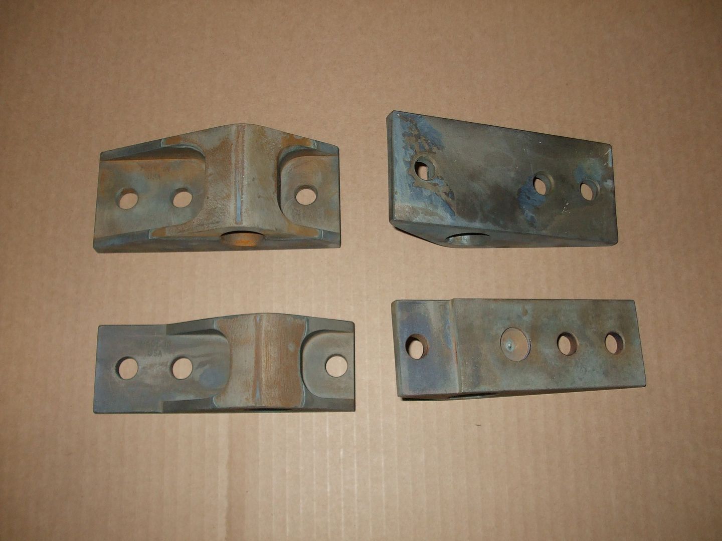

I got my spring shackle hangers cleaned with Marine Clean.
Then I soaked them in a bucket of Metal Ready for about 45 minutes.
They weren't quite submerged so I had to flip them over and let them sit another 45 minutes to make sure they were 100% covered in the Metal Ready.
Since I only have a few pieces to paint I will likely brush on the POR15 then also brush on the Blackcoat.
Mike

The hangers look good. I just welded some heavy plate hangers onto my old Jeep that I had sold a year ago or so. The new owner tore off a front hanger and most of the other front one, too... I sold it to a friend so I still get to visit it and work on it!
