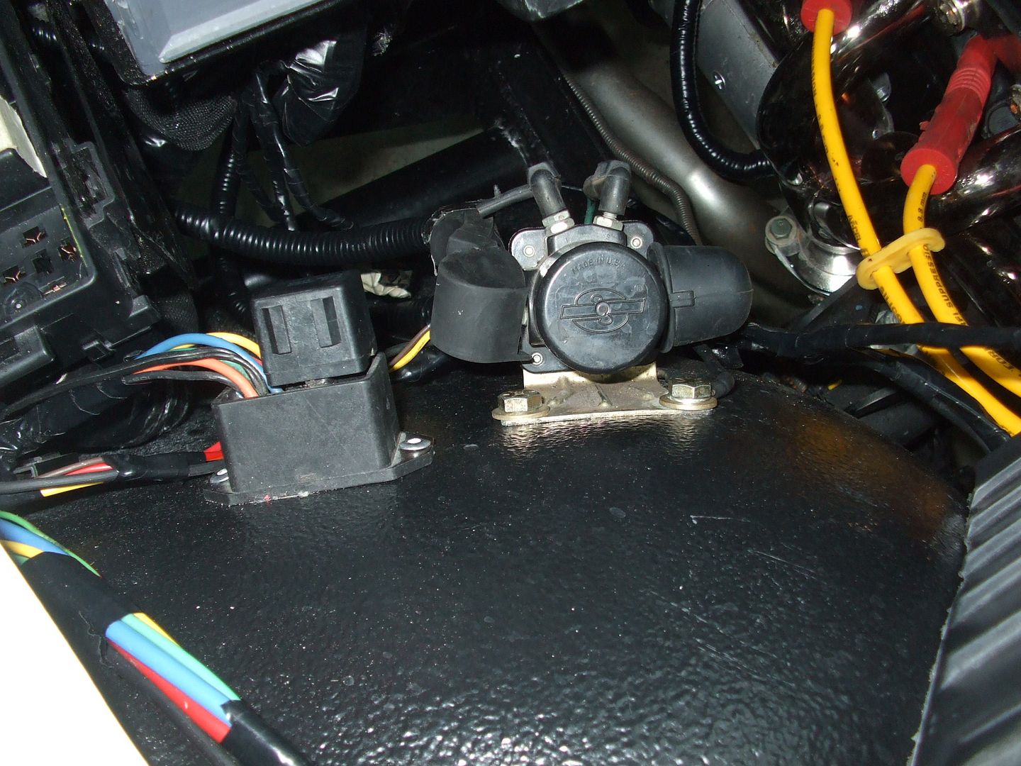

Starter Solenoid and Fan Temp Controller
I've got the cooling fan temperature controller mounted, I decided to attach it with SS rivets. I also mounted the starter solenoid in place. I ran the wire leads to the MAF and HEGO sensors along the same route below the solenoid. I 'T'ed off a lead from the grounding post to ground the starter solenoid body at the right side bolt. From there another wire continues down to the frame at the same connection point as the 4 gauge wire from the cylinder head. Just one more addition to the ground loop.

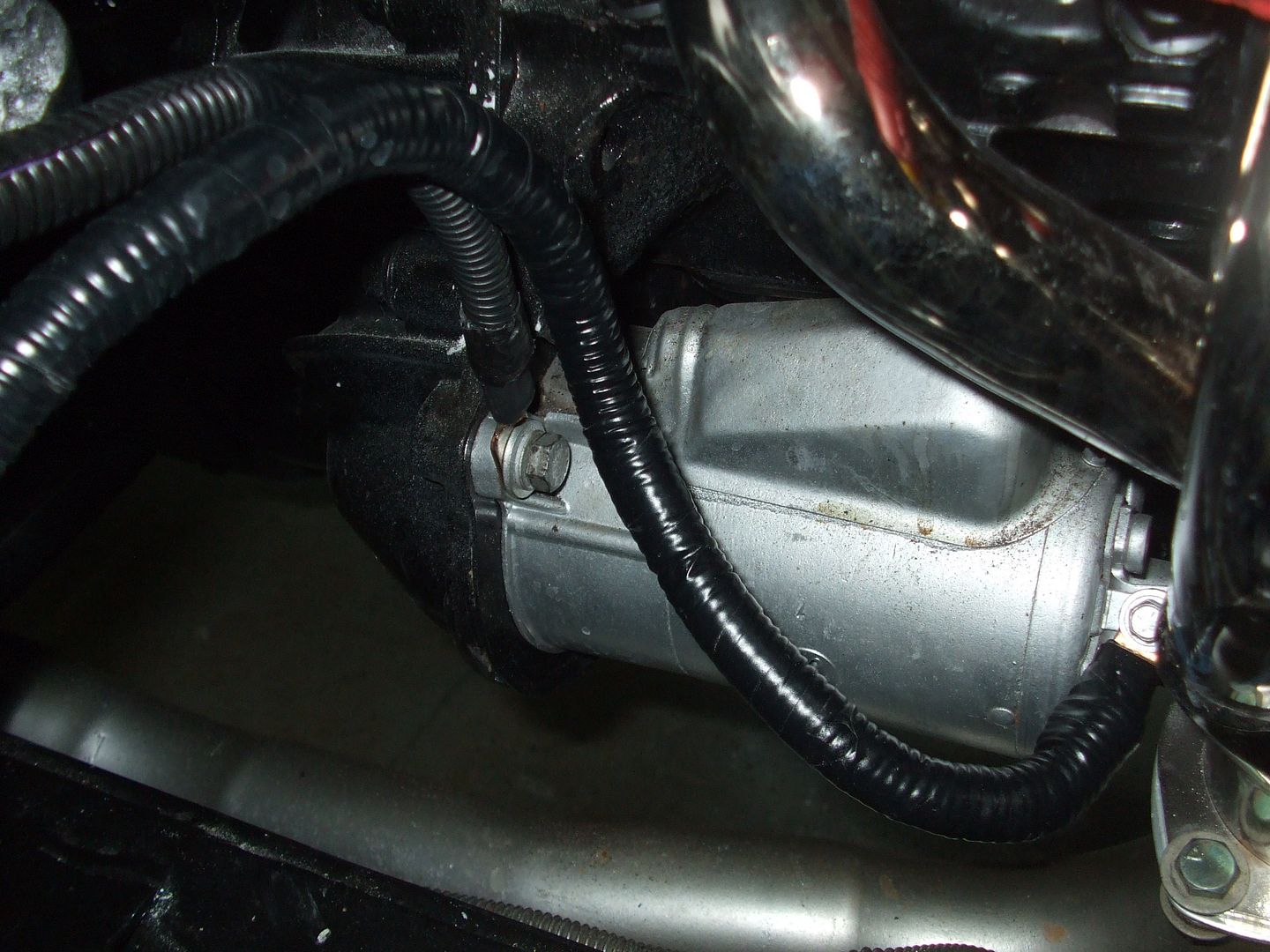

Here you can see the 4 gauge wires to the starter. The one on the left is the ground going directly to the battery negative post. The one on the right is the power feed from the solenoid.

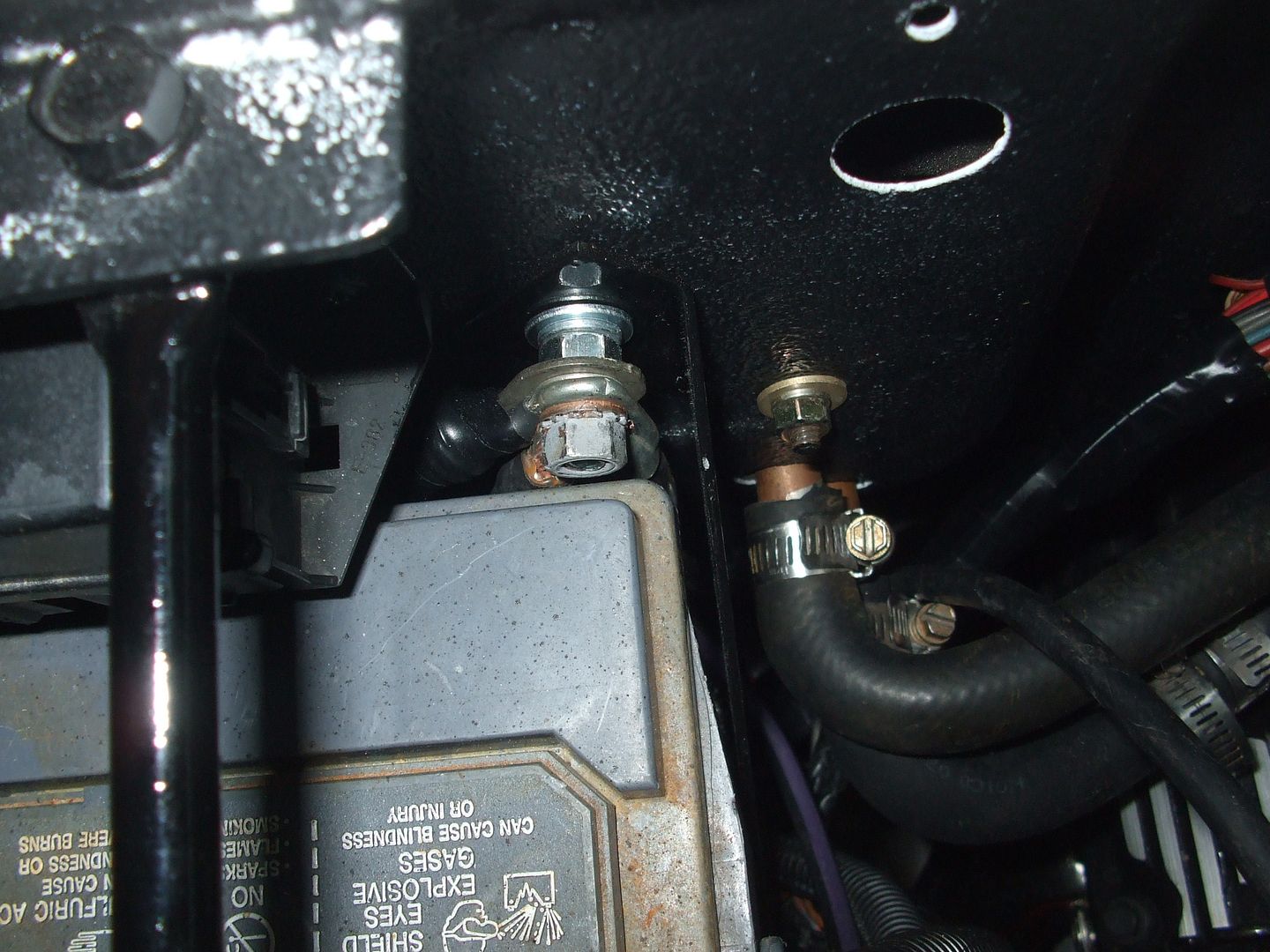

Here is a shot of the grounding post showing how much room there is to the battery. I've got the battery pushed back as far as it will go and all the wires I need connected are on there. I'll watch for witness marks after driving it around and remove one of the washers if I have to. I don't think it is going to be a problem.
I've got one main 4 gauge ground wire coming off that post that still needs to be connected at the frame but that shouldn't keep me from being able to start it. I need to pull the battery back out so I can get to that wire to properly crimp on the terminal end.

Hey do you think the headers are going to put off too much heat on the starter?

It was always that close before and I never had a problem. I'll have to admit that I did price out a few mini-starters but think I would probably try some sort of heat shield before I bucked up for one of those if I did have a problem.
How close do you like it?

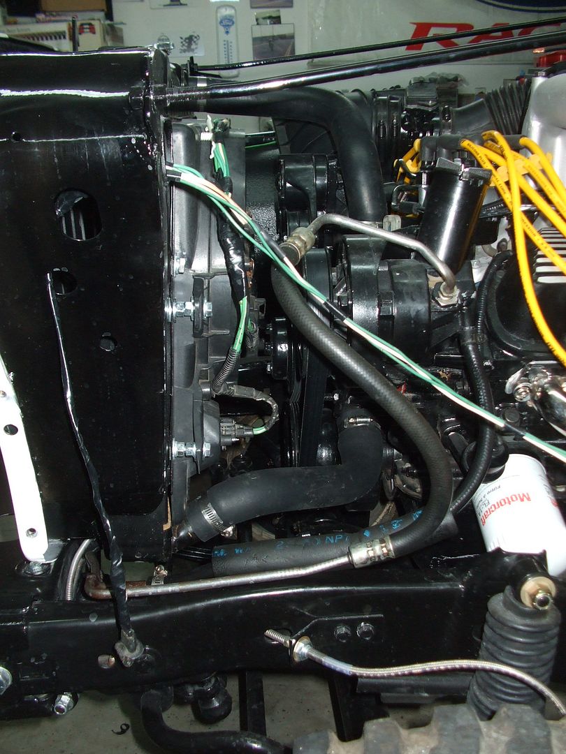

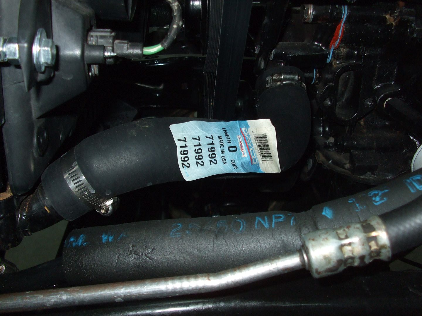

I've got the coolant hoses installed with new SS hose clamps. You can see the part numbers I used in the pictures and how well they fit. I bought them from Autozone and did not have to trim either one. Keep in mind this is also with a 1" body lift. I think the top hose would work with just about any 5.0L conversion. These did not come with the internal wound springs so I did take the springs out of my old hoses and installed them into the new ones. The spring keeps the hose from collapsing, incase you didn't know.
The bottom hose was just a little off from perfect and tried to kink a little bit without the wound spring installed. With the spring it actually fits pretty nice.
Here you get a picture of both of them.
It's got right at 3 gallons of 50/50 coolant/distilled water in it. Time to test fit the dash and start filling in the fuse box to test some things out.
