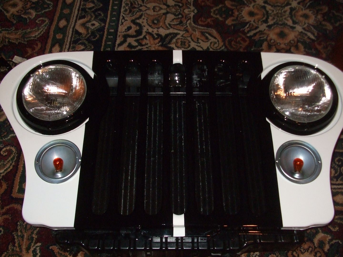

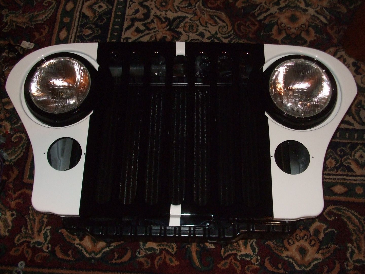

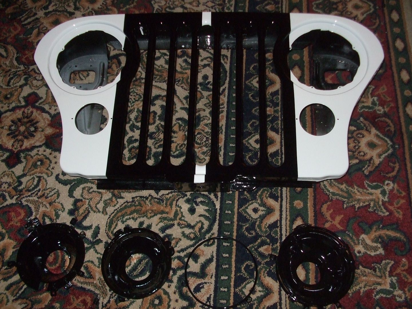

Grill Assembly

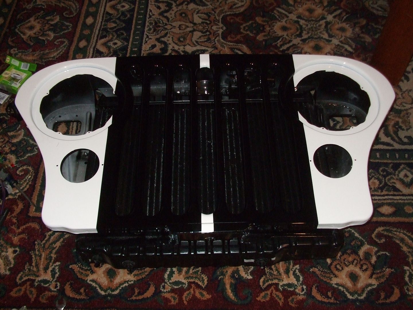

I got most of the grill assembled. Here are all the parts laid out in the living room.

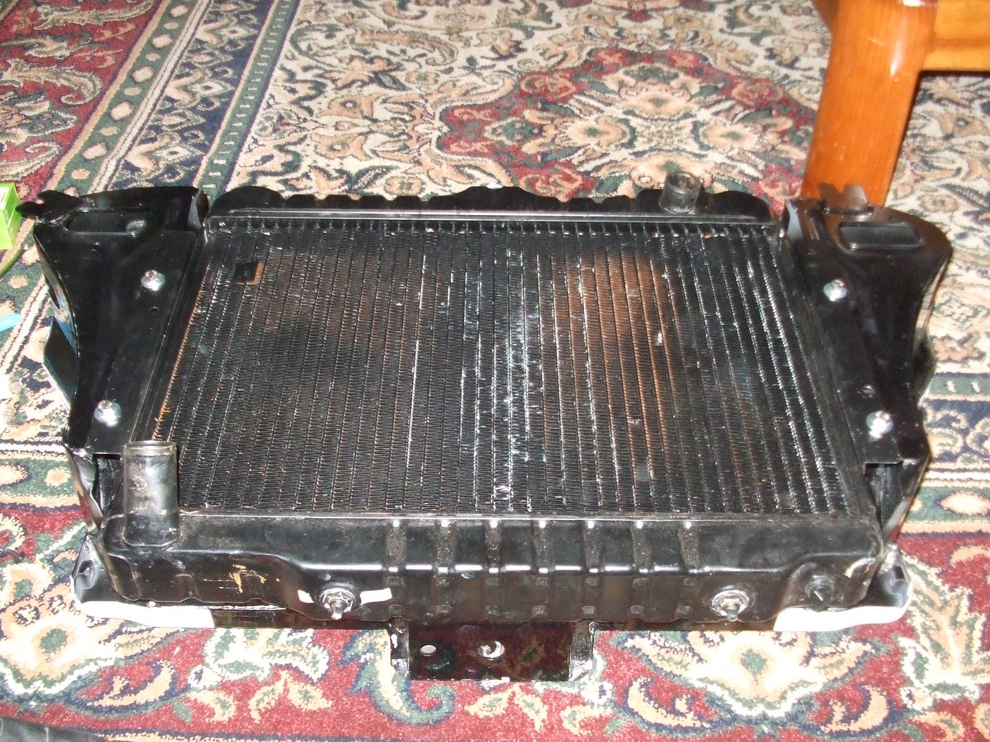

Got my 3 core radiator installed. I didn't realize there was that much surface rust on the fins until I saw the pictures with the flash. I should have washed it better and maybe added a coat of paint but I'm not really worried about it.
Same thing with my Contour cooling fans. I thought I had cleaned them better than that but I guess not. The flash really brings out the dirt. I'll get it cleaned up and touch up the rusty metal spots around the motors with some paint at some point in the near future.
Front side of grill with radiator installed. I was thinking of adding a screen to the front of the radiator to help with protection from rocks. I still might do that at some point but that can be a separate write up later.
Got all the headlight parts and bezels installed. I love the black headlight bezels. I'll have to admit that for some reason I thought the bezel covered up more of the opening when I was painting the parts. Seeing how much of the recessed opening is visible I would have taken more time to make sure my stripe lines in that area were cleaner and straighter. It's not too bad but I would have done better knowing what I know now. Too late to do anything about it now, live and learn.
The front marker lights were the last to go on. I made some modifications to those which I will detail in the next post. I'll have to pull the headlights back off when it comes time to wire them.
Mike

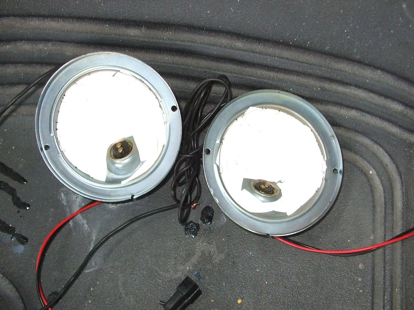

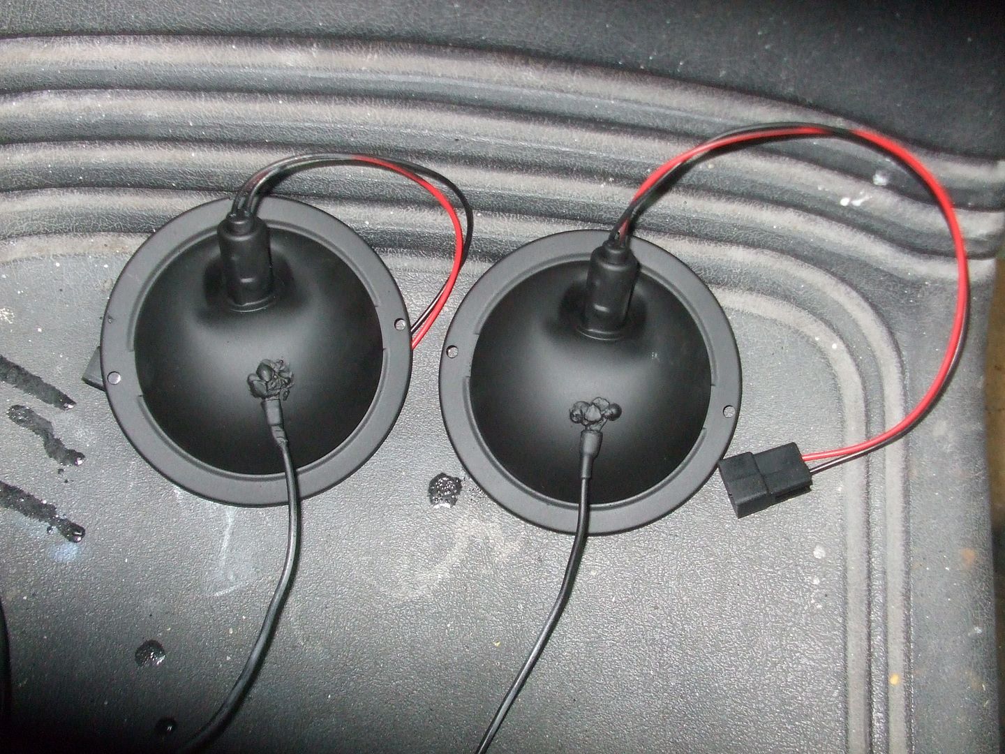

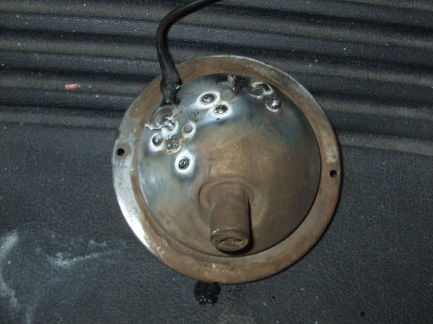

Front Marker Lights

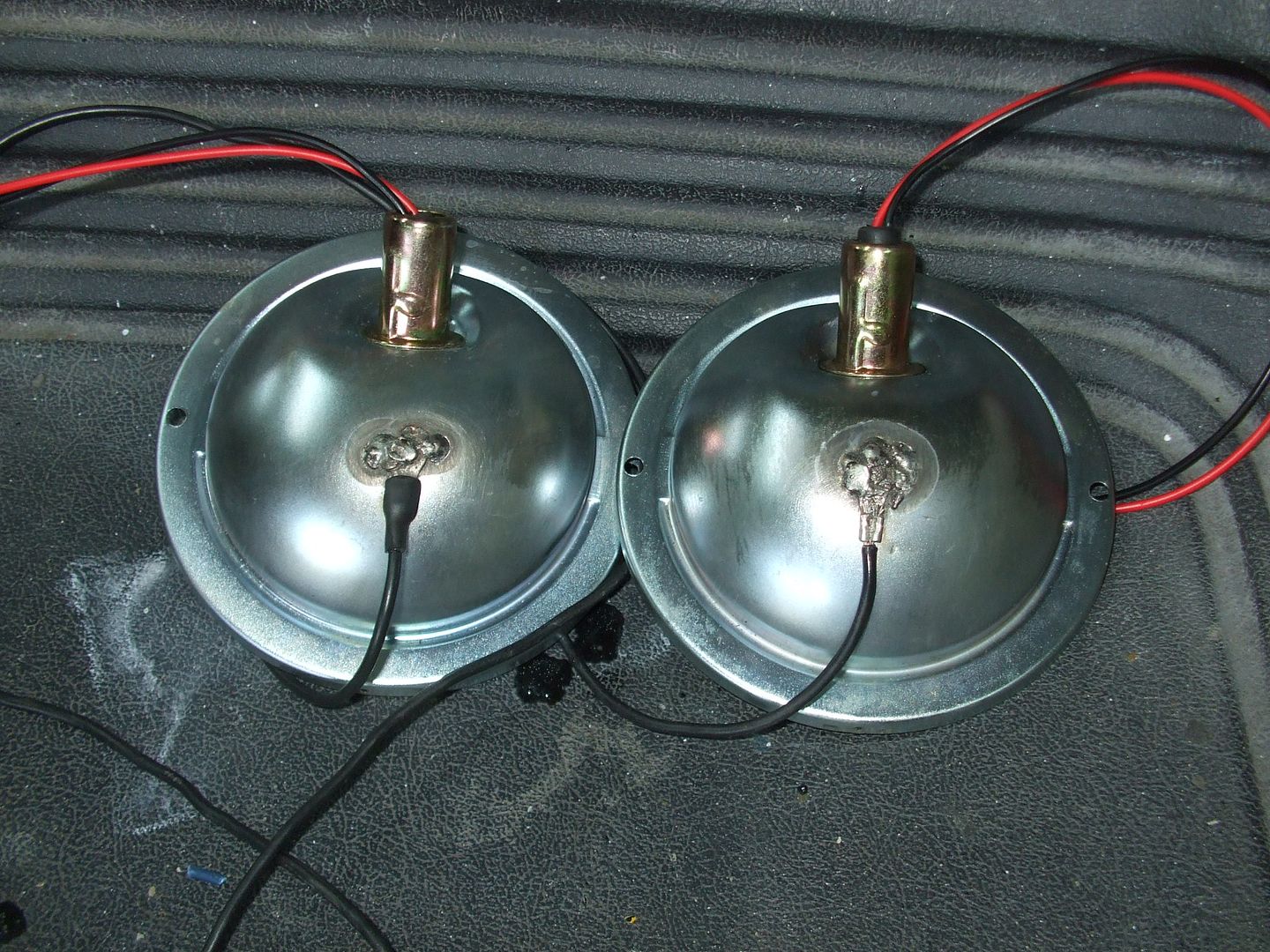

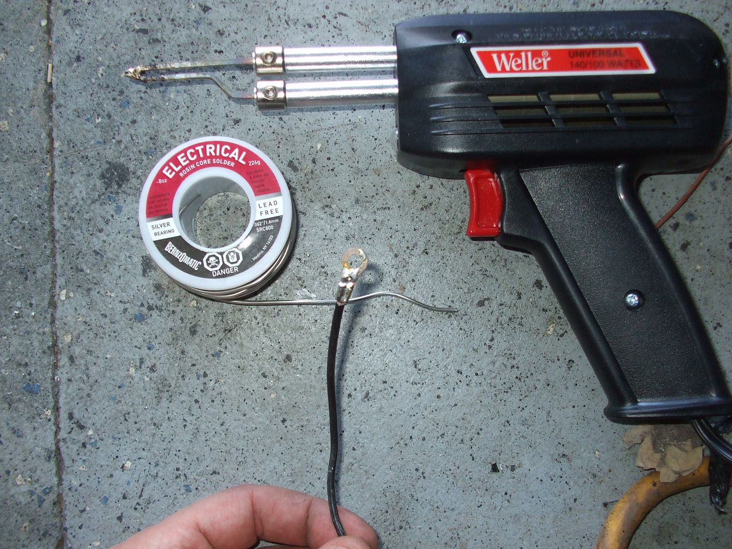

As you know, well at least if you don't you should, the front marker lights ground through their own case. This is normally done via the two mounting screws to the metal of the grill. Since mine has so many nice layers of paint I wasn't confident the two screws were going to get enough contact for a good ground and I wasn't keen on the idea of grinding off any of my shiny paint. So I decided to add a dedicated ground wire to both of the light housings. I took an old one and started making some practice welds to get the welder dialed in and to make sure the terminal end wasn't going to just melt off. So I welded on an old piece of scrap wire and terminal to make sure it was going to work alright.
The welding appeared to work well so I started with a small holed terminal and soldered it on to the wire.
Here I have one welded on and the other resting in place.
Here they are both welded on and I just need to add a piece of heat shrink to the one on the right.

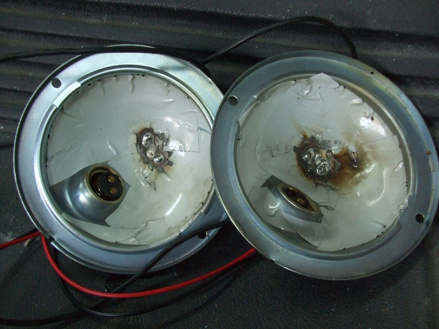

Here is a picture of the front sides so you can see the penetration of the welds.
Here I've got my Fluke meters checking the resistance or Ohms between the wire and the light's case. The lower the better and theoretically 0 is perfect. I think this is close enough.

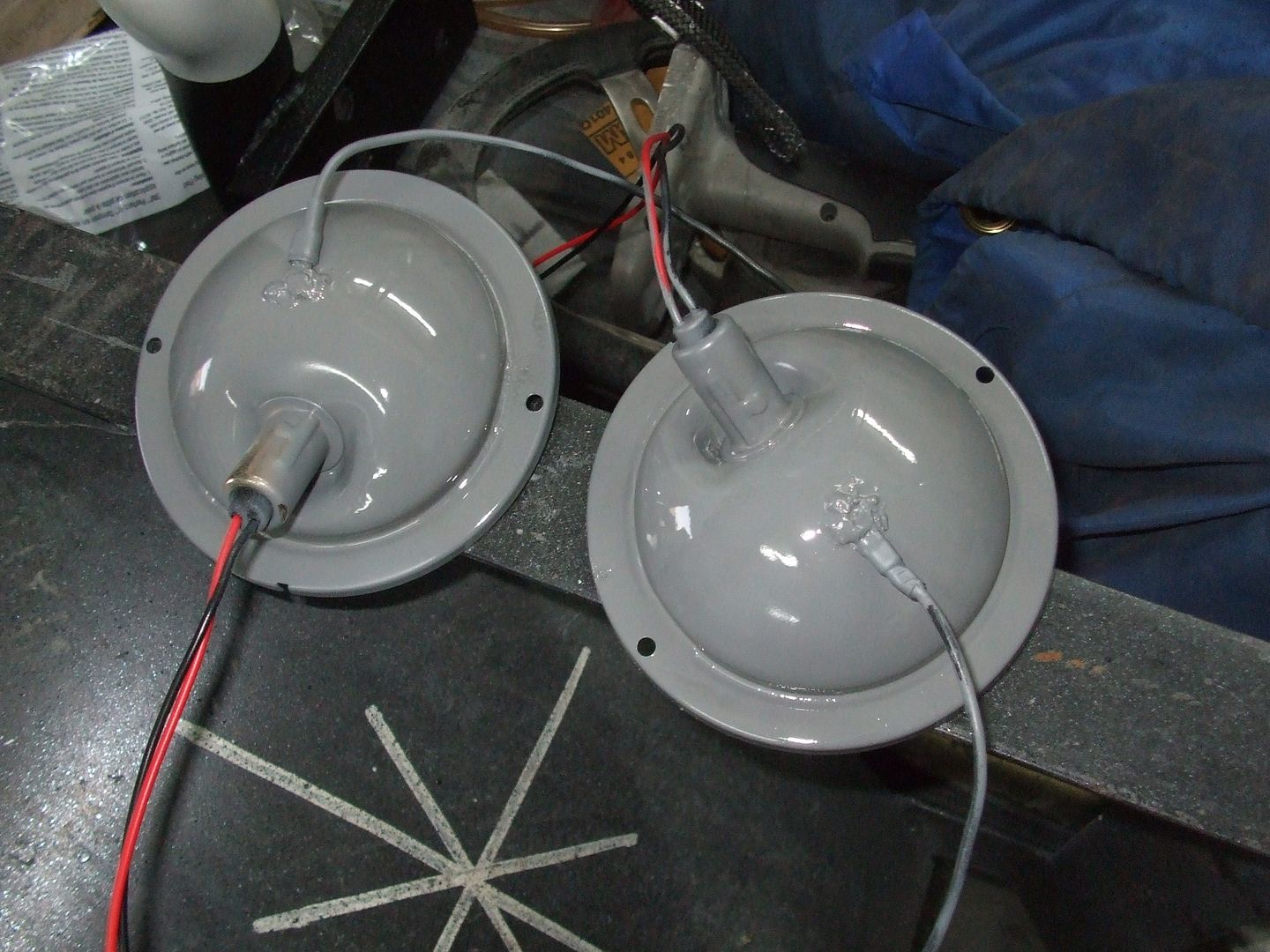

I touched up my reflective tape that got burned up by the welder.
Since the welder burned off the light zinc coating on the marker light housing I figured I needed to get some paint on them otherwise the welds would want to rust quicker.
I just used the first can of black Rustoleum I found on the shelf to add color and help keep the rust away. The ground wires will be tied into the headlight grounds.
