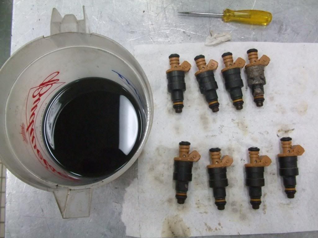

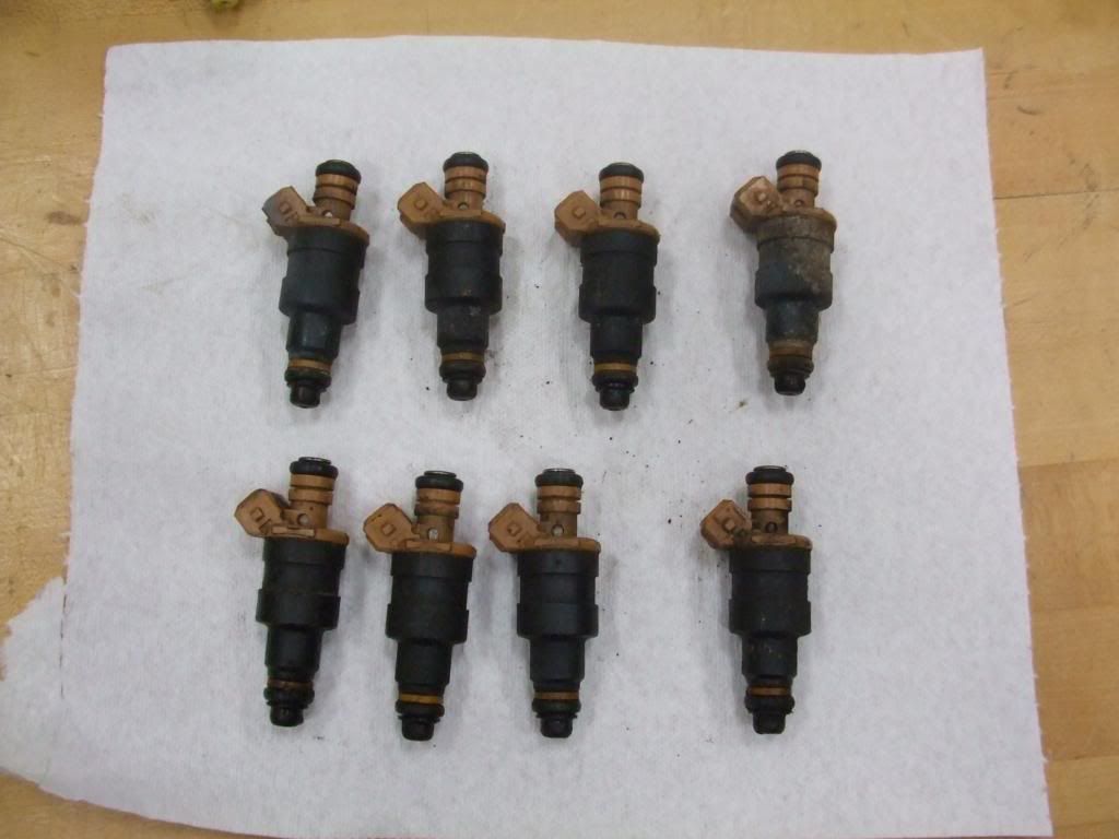

So my Jeep had basically sat for 9 years and the fall before I started into this rebuild, I pulled the tank and drained the fuel. The gas looked exactly like iced tea with flakes floating around and it smelled a lot like turpentine. I drained the tank and flushed it out. I added some antifreeze and a few feet of linked chain inside of the tank. I shook it around so the chain links would scrub and clean the inside of the tank walls, which worked quite nicely. I replaced the sending unit and pick up sock then put in 5 gallons of fresh fuel. I drove it around the neighborhood a couple of times and let it run for a while. The Jeep always fired right up as I started it randomly over the next six months while the urge was building to work on it.
So I figured the fuel sitting in the lines and injectors all those years must have built up a nice tarnish. I pulled all the injectors from the old lower intake and got them ready to clean. After this picture I gave them a once over on the outsides with a wire brush and xylene.

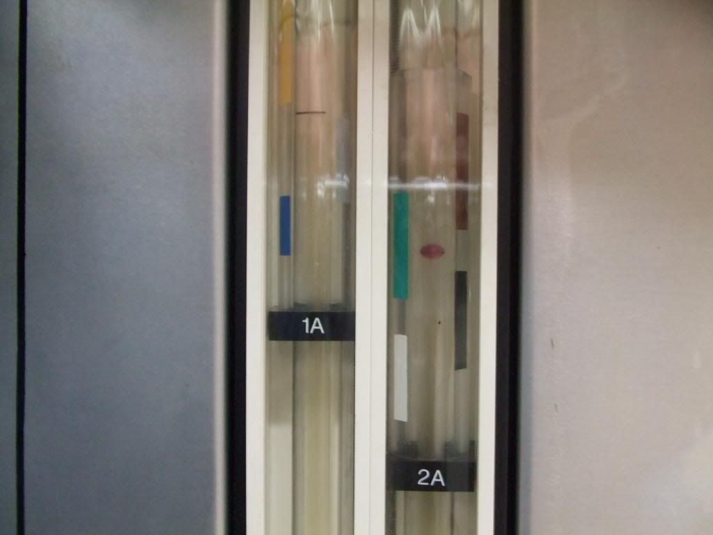

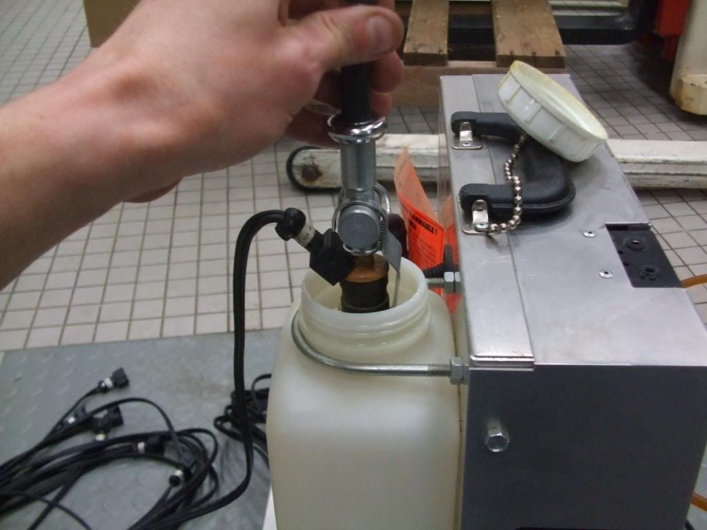

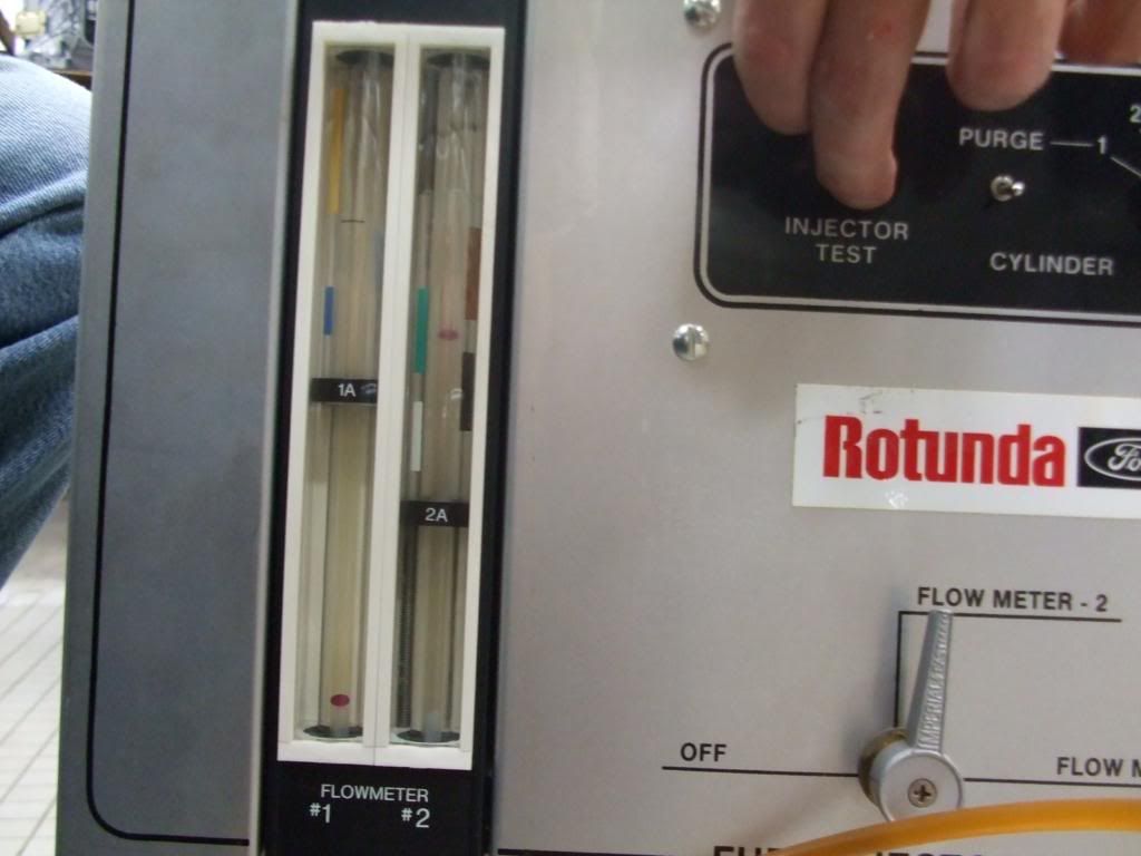

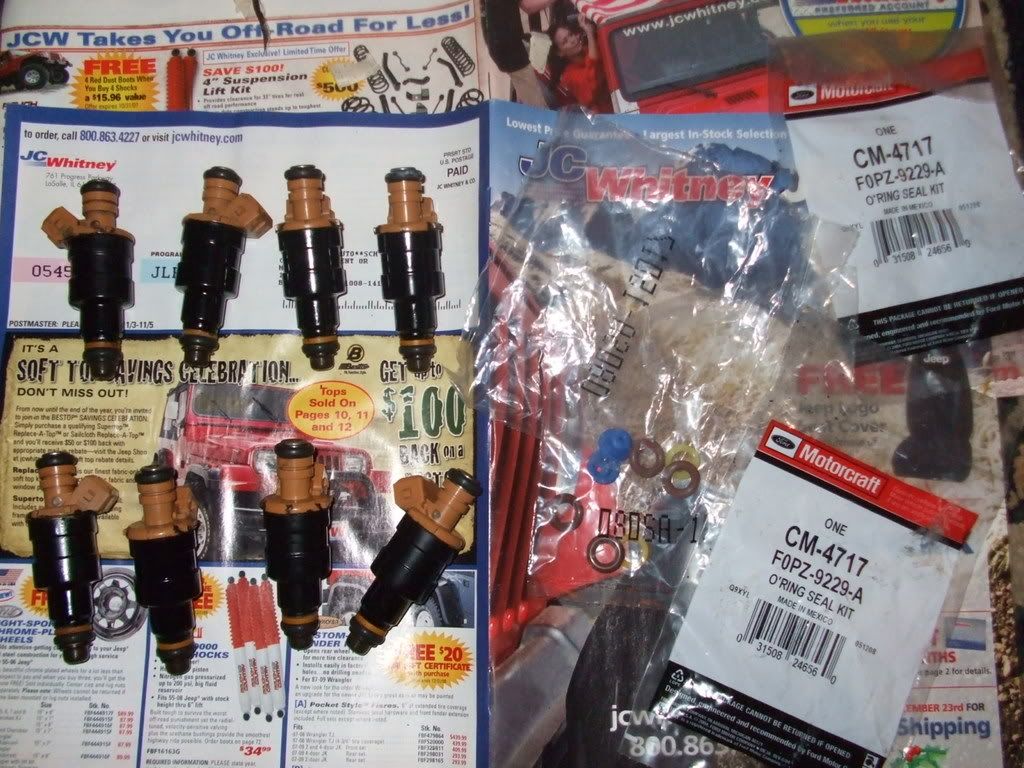

I had access to a fuel injector cleaner one afternoon so I took them in to give them a good cleaning:
We didn't hook up the calibration injectors so I didn't calibrate the flow meter so the injectors would read in the correct color. I was more concerned with the cleaning but I did want to check their relative flows so I set the flow line on the first injector and compared the rest to that flow rate. Six of the injectors flowed exactly on the line, one was about 3% high and another was about 2% low. All in all the flow rate comparison was not too bad and well within acceptable limits. The spray patterns on the injectors all looked the same.
I started with 16 oz of injector cleaner. This stuff was crystal clear with maybe just a tint of green. You can see the color in the flow tube above. I purged each injector at 100% for 30 seconds then pulse fired them for another 2 minutes. I recycled the cleaner directly back to the supply tank:
By the time I was done the cleaner wasn't clear anymore. Goes to show just how much crap was cleaned out of the injectors.

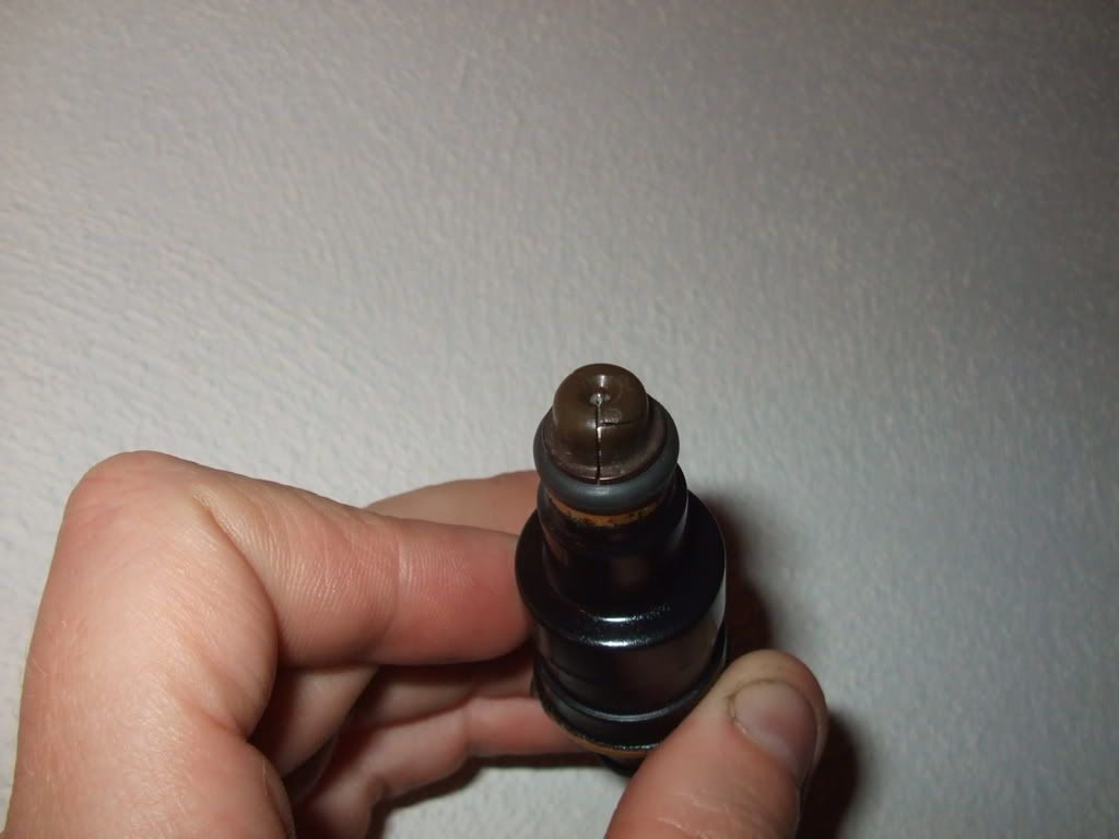

Two of the injector pintle caps were cracked. I'm not sure if they were always like this or if they cracked while trying to get them out of the old intake. Some of them pulled right out while others took a bit of persuasion.
This is after I painted the injector bodies and getting ready to replace the o-rings and the two cracked caps.

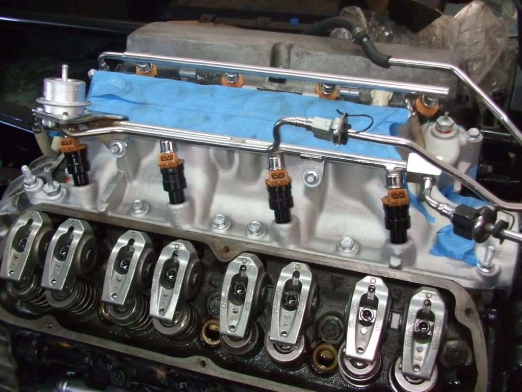

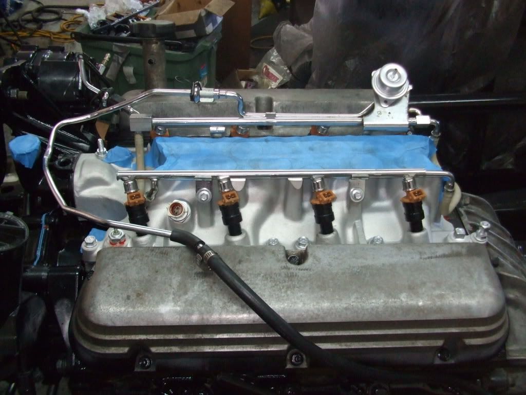

I cleaned up the fuel rails, painted the fuel pressure regulator, IAT, ECT and fuel rail mounting bolts.
Good picture of the injectors, fuel rails and roller rockers. Crane Cams made the Cobra 1.72 roller rockers for Ford. You can see Crane and the Ford oval in the castings.

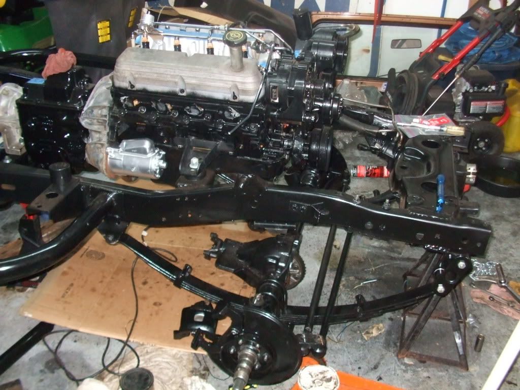

I also installed the front axles, spindles, brake backing plates, sway bar mounts, axle bump stops, steering gear box, steering lines and rods.
Next up is going to be the brake lines, fuel lines and maybe install the gas tank. I also need to take a look at my exhaust system because at this point I would like to reuse what I have. The Dana 300 clean and re-seal is also on the short list of things to do. I'll probably do something with that bell housing or at least the dust shield. I want to get a lot of this done before I start in on the body but I can really do it at any time as I go. The transfer case and a few of the other parts need a little paint so I am also waiting a bit on the weather. A few things need a little touch up paint after being installed but nothing major.

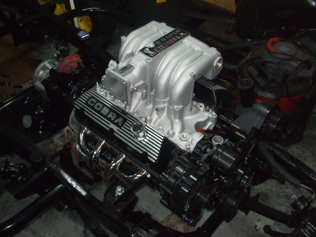

^^^ 1992 5.0L Mustang GT bottom end with the forged pistons, GT40 heads with the Cobra Roller rockers, Cobra upper and lower intakes with shorty block hugger headers. It is basically a Cobra motor except for the cam, which only has a marginal lift and duration difference, which I don't really want because it is made for even more top end power that the Jeep just doesn't need. The Cobra's also came with 24# injectors while the GT's are 19#. The 19# injectors are good to 310 HP so I don't think they'll have a problem keeping up. I'm guesstimating this thing has around 275-285 HP. I do know it runs like a beast!
Once it's running I'll pull a few WOT runs while watching the 02 sensors to make sure they go rich and stay that way. I don't think I'll have a problem but if the engine leans out at WOT, I'll likely buy an adjustable fuel pressure regulator and bump up the pressure until it stays rich. If it only takes 5-10 psi, I'll just keep it that way. If it takes more than an extra 10 psi, I'll buy a set of 24# injectors and the MAF to go with them. It ran fine and stayed rich before the build and all I have done is add the upper and lower intakes so I really don't think there will be a problem, especially now that the injectors are clean. I've had to clean drool off of my new valve covers.

Sounds like a healthy small block and sure looks good. I built basically a GT40 motor for my buddies shelby cobra kit car and we used the same intake and valve covers as you. I hope you run flowmasters cause those built 5.0L motors sound great through them.

^^^ Dual Flowmasters ran through 2.25" pipes. It does sound good!
