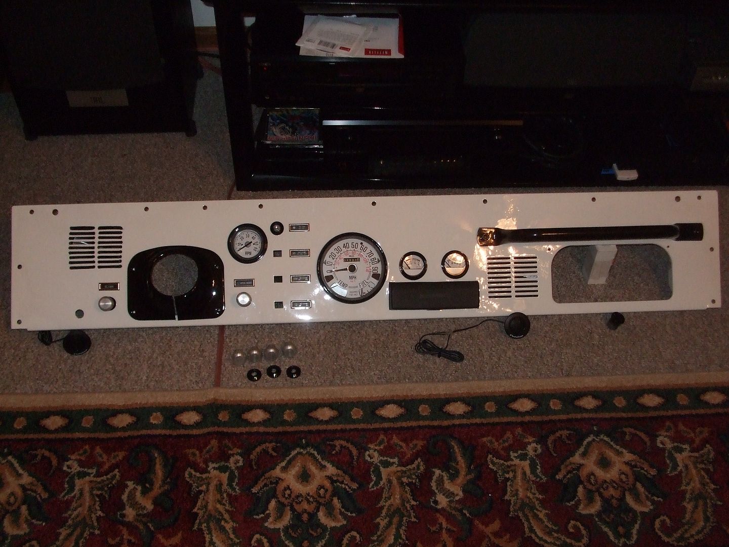

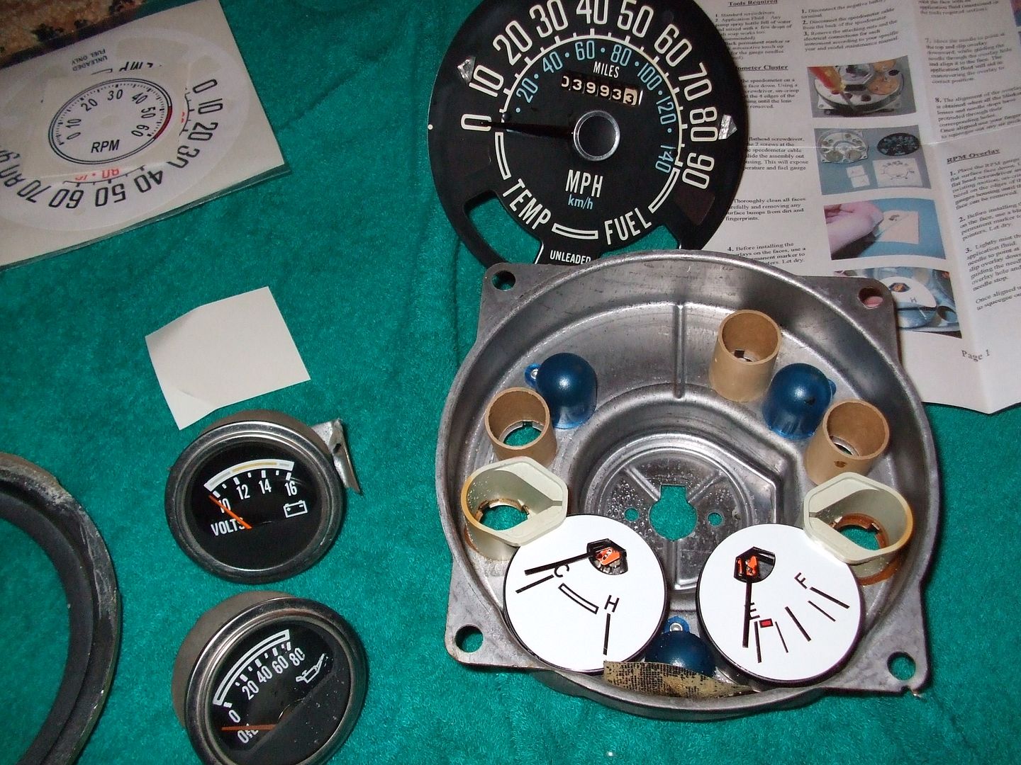

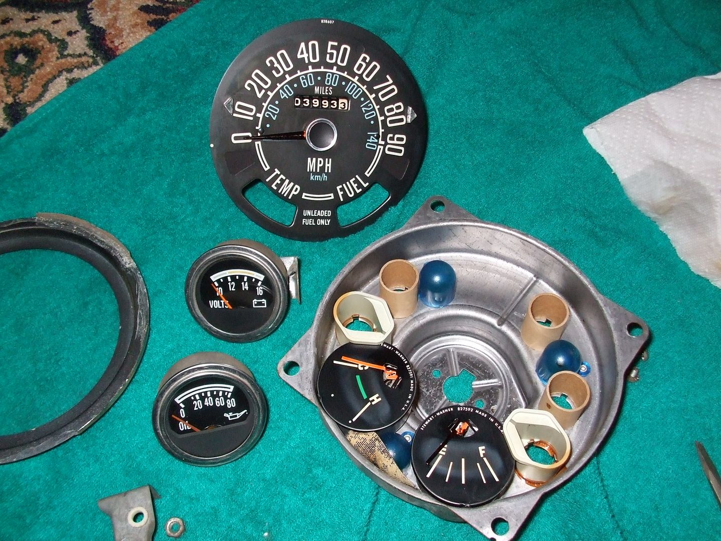

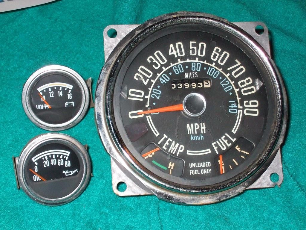

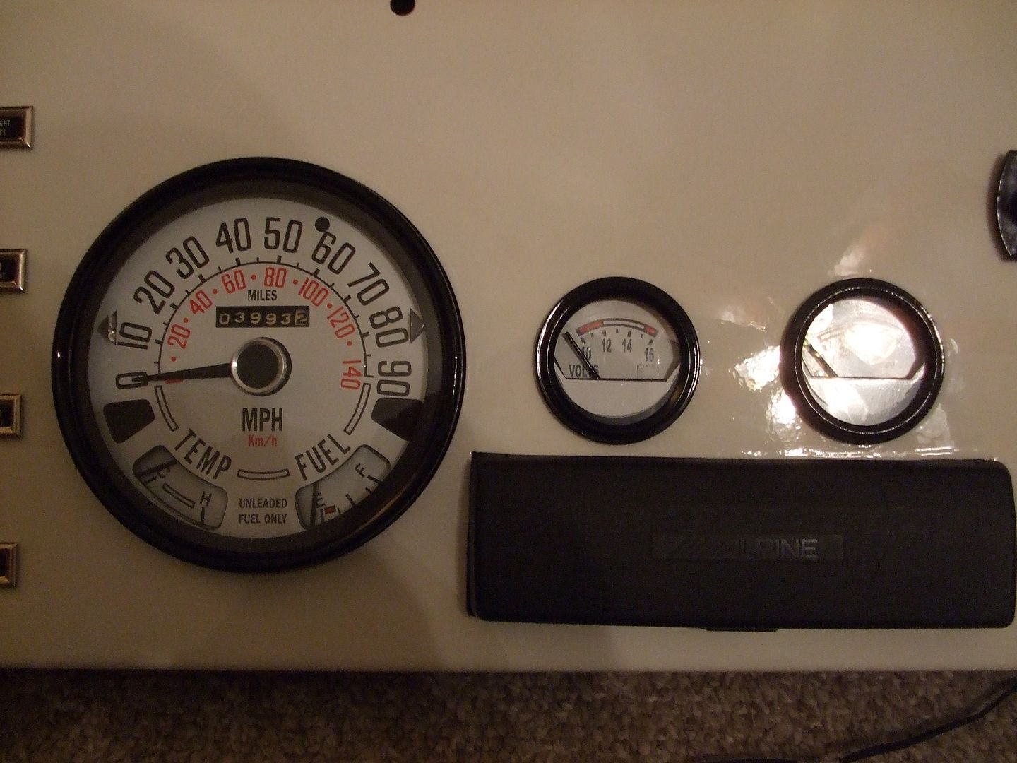

White Face Gauges
One of the first things I bought after deciding to tear my CJ apart was a set of white face gauge vinyl overlays from a place called Pedal-2D-Metal.com. I actually put these on in April of 2008. Here is a picture of the gauges in stock condition.
I pulled the bezel and glass off and disassembled the main speedometer. I started painting the needles black. Notice the sun fading on the fuel and temp gauges.
You can see the start of the overlays. It is best to use a little water with a drop of soap added to the sticky side so you can position the sticker where you want before you press it on hard and let it dry.

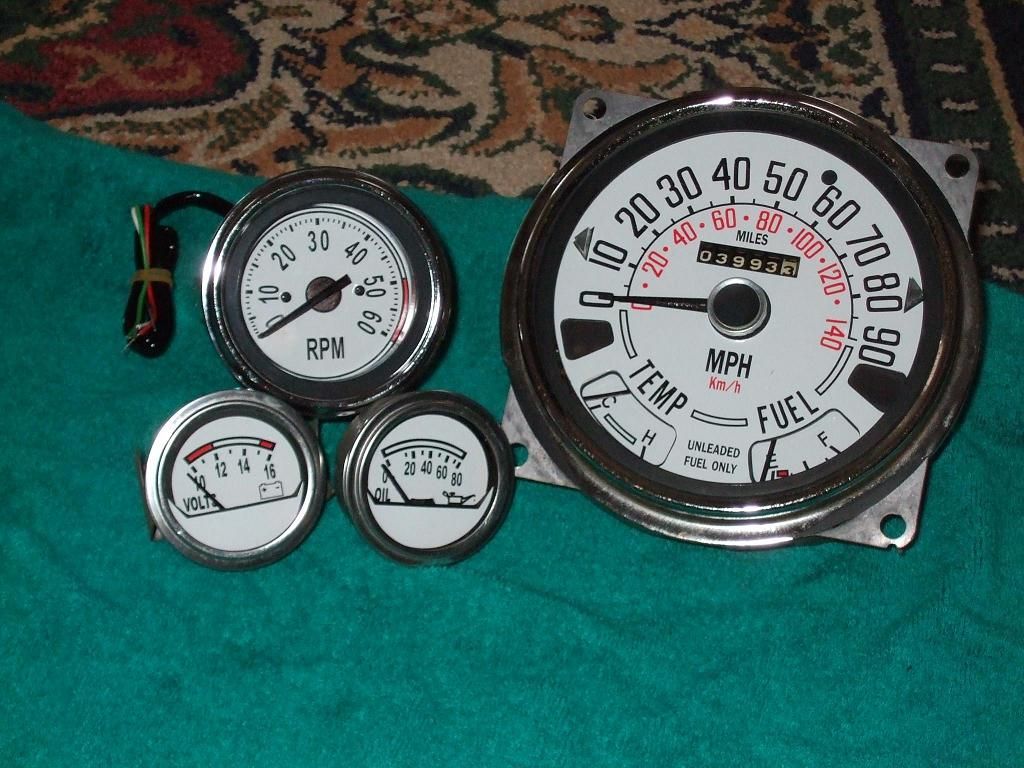

The main speedometer overlay in place.
Here are all of the gauges converted over to the white. I took the silver bezels off and had them powder coated black back when I had my tub media blasted.
I just put all the black bezels on and installed them into the dash. Sorry for the crappy picture but the lighting was bad and the flash was too much.
Here is the entire dash. The aluminum pull knobs I made myself in the college metal lab back in 1997. The pull handle bezels and steering column cover were all covered with black and clear coat.

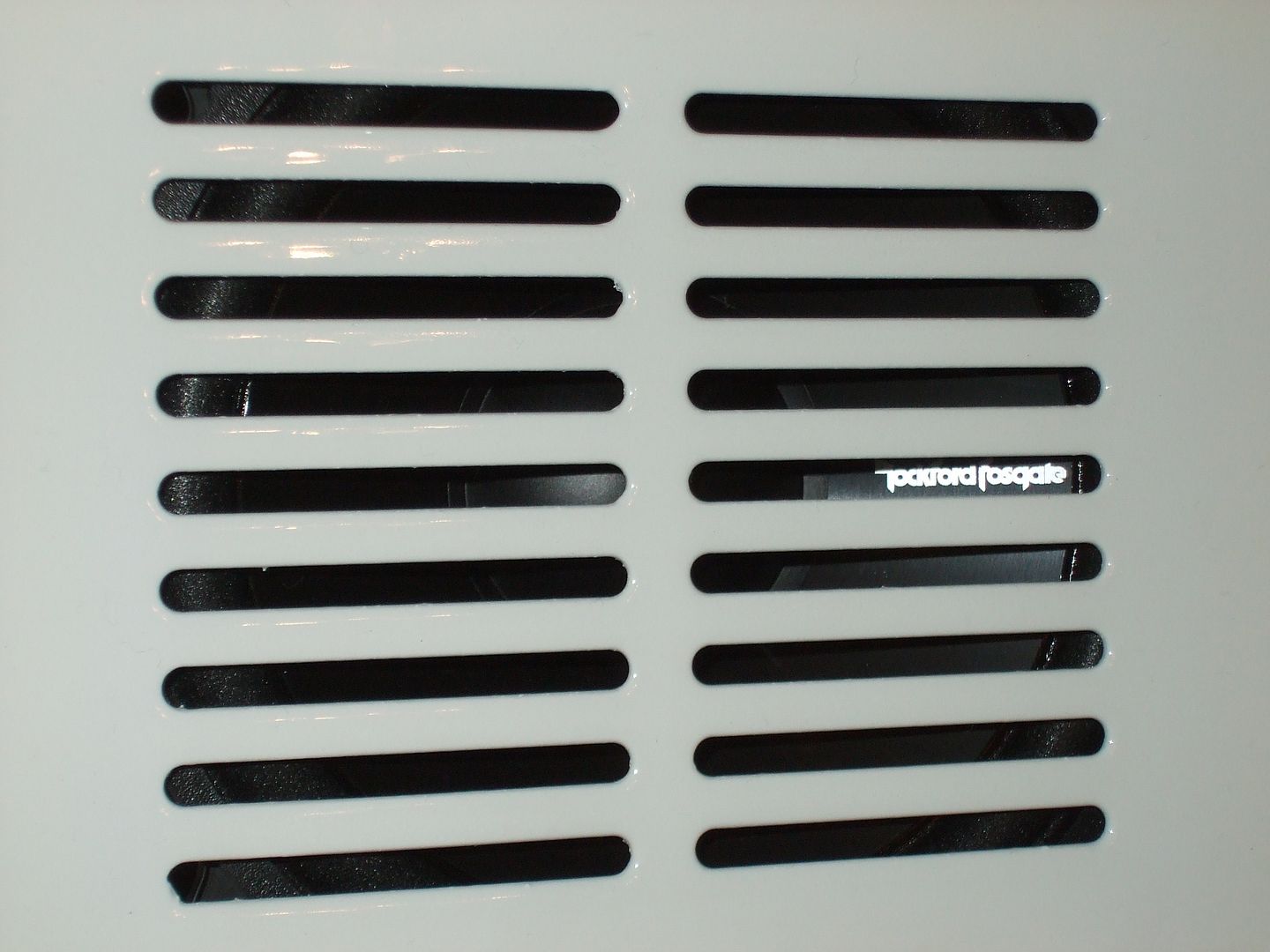

I even went as far to install my new 5.25" speakers.

You have pioneered more stuff... at least since I became a member! I really, really like the instrumentation. I didn't think I would until I saw it installed. Great insight, Mike. I wish I had some...
