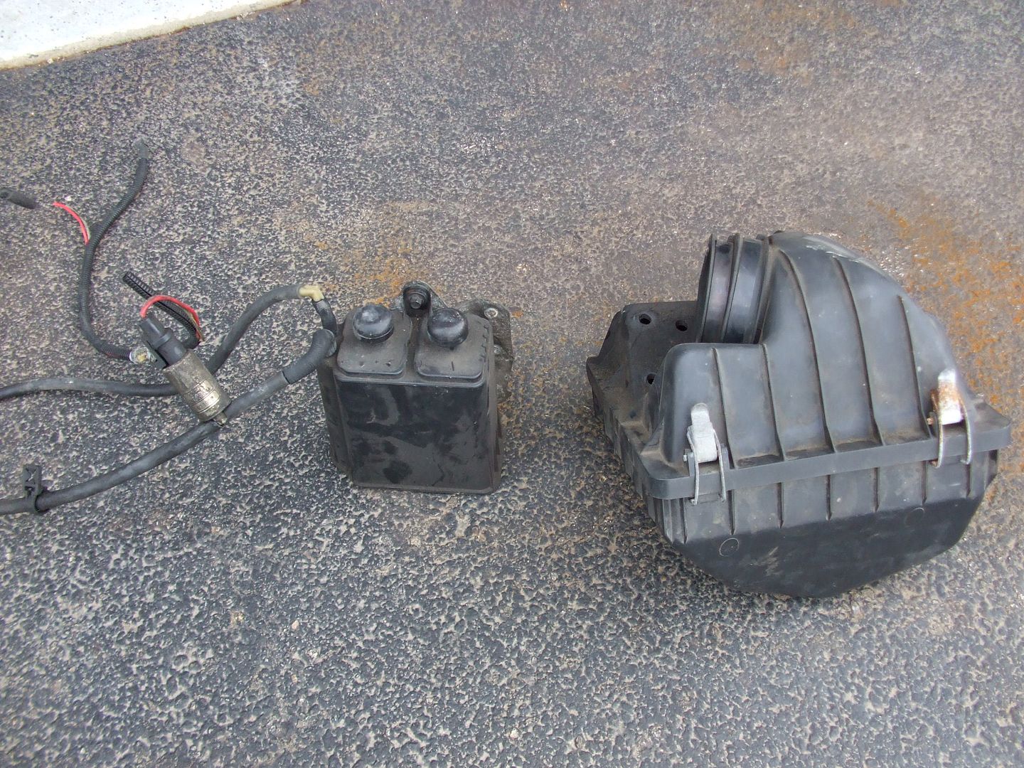

I decided to mount my charcoal canister in the same location as the stock jeep canister. My CJ had never had the emissions system hooked up since I have owned it. Luckily I still had the liquid check valve in the fender well but the rollover valve had a broken nipple(replaced with the DeLorean Part) and the charcoal canister was missing. I picked up a canister out of an early ninety's Mustang and also picked up the canister purge solenoid. Got them both for $5 at the local salvage yard.

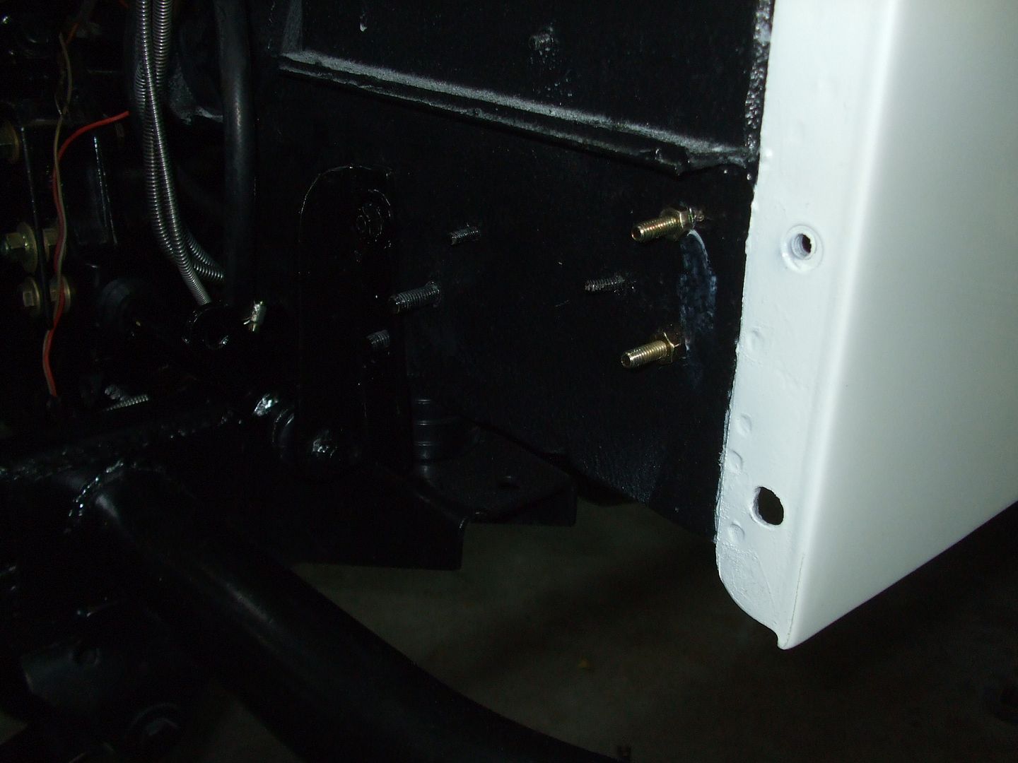

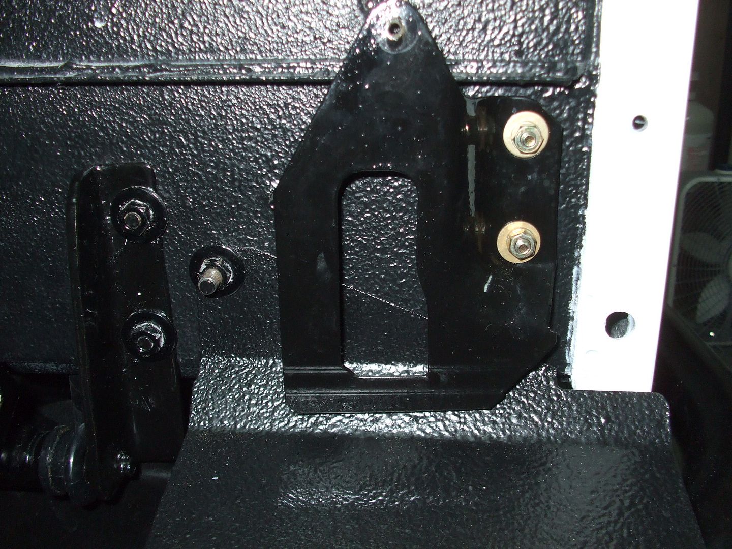

It came with this perfect little mounting bracket I had to attach to the firewall with two bolts. I couldn't mount it flush because the top would hit the lip for the floorboard so I added a couple nuts to the bolts to basically turn them into studs and to help space the mounting bracket out a little.
I mounted up the lower fender rock guard and placed the bracket in place to make sure everything was going to fit.

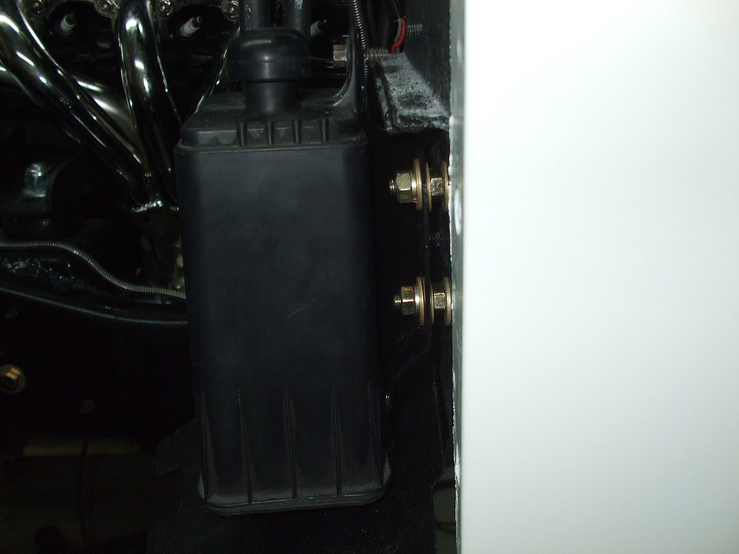

All bolted up, it is mounted pretty solid.
You can see how I spaced it out just a bit farther with a couple washers. They also distribute the load on the mount a little better. The canister has a lip on the bottom where it slides into the mount then locks in with a single bolt on top.
I got rid of the stock green plastic tubing and connected it to the 1/4" steel vapor line from the valves in the rear with standard fuel injection hose. I zip tied the canister purge valve to the brake lines. I'm not overly pleased with that spot but it appears it will work fine and should not cause any problems. The line from the manifold to the valve is also connected. I'll get the wiring sorted out when I get to that later.

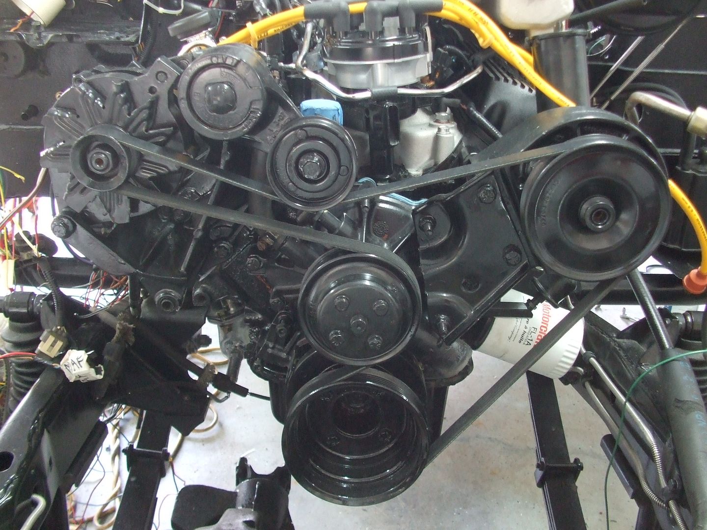

Mine was out of an early 90's Mustang. I don't have A/C but I remember having to buy the A/C eliminator kit to clean it up and provide an easier belt routing. I see all of the other 5.0L on here with a different belt routing than mine. They all have the long run between the crank and the alternator. I routed it so the long run, which is shorter overall, is between the power steering and the crank. I am pretty sure my overall belt length is considerably shorter than theirs. Mine is a 6k703, so six rib 703 cm long. I don't have any type of idler in the area you described.

Since Mike does not have A/C, here is a couple shots of mine... Hope they help...

^^^ That is the belt routing of the stock 4L 6 cylinder.

Thanks for the picture. That front end of your will certainly clear both of my upper control arm mounts on the axle. Shopping time for me now

OK, thanks very much. i just read your build thread and suddenly fee very tired! Awesome. I think I have an extra interference issue with my hybrid frame coil towers... Oh well- I'll sort it out. Thanks again for the pics.
