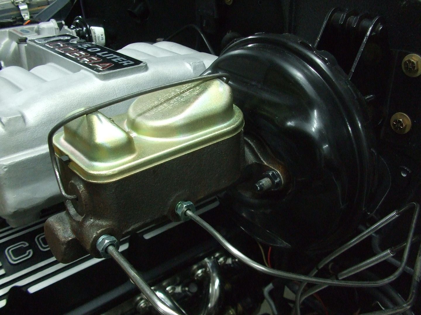

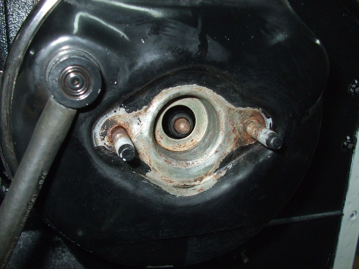

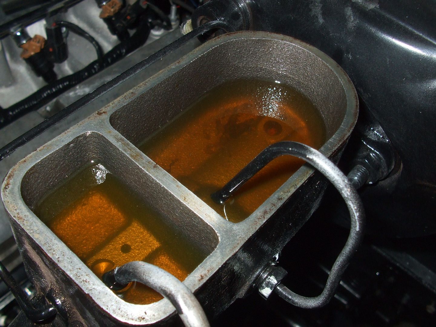

Brakes

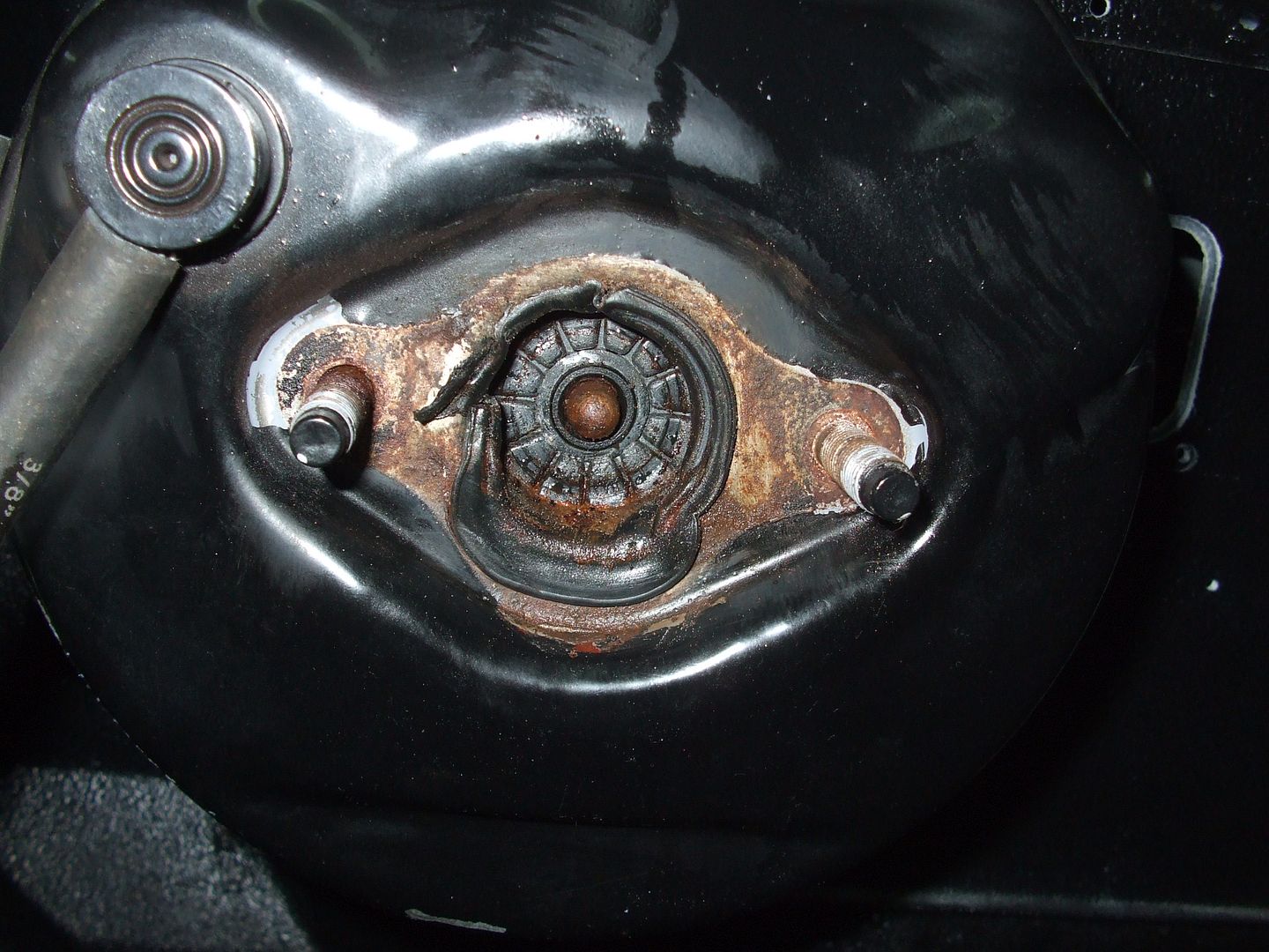

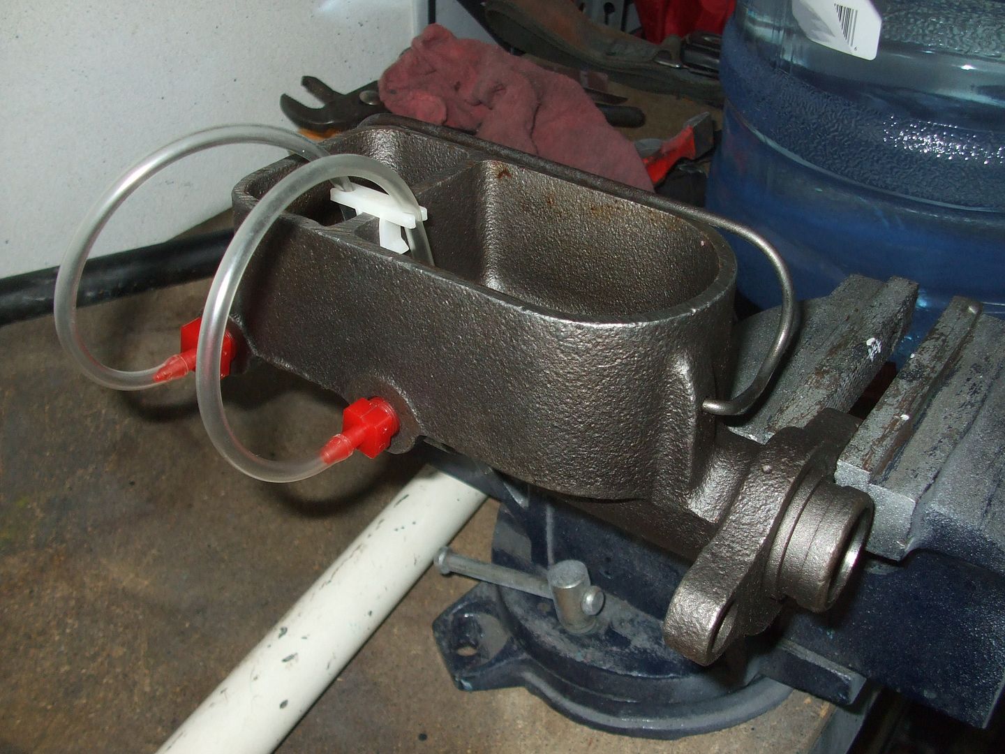

I tried to bench bleed my master cylinder and did not have much luck. I know I had replaced this at one point since I've owned it but I must have pumped this thing 200 times and was still getting air out of the back hole. I even had it angled pretty far down for a while. At one point I thought I could hear air slowly sucking into the MC while listening from underneath. So I eventually gave up and ordered a new one. What's another $20 right? Everything else in the braking system, except for the proportioning valve, is new.
Here is what the mounting point at the brake booster looked like. I was able to clean up the seal pretty good.
I got it just a little bit cleaner than this and put a dab of anti-seize on the end of the push rod.

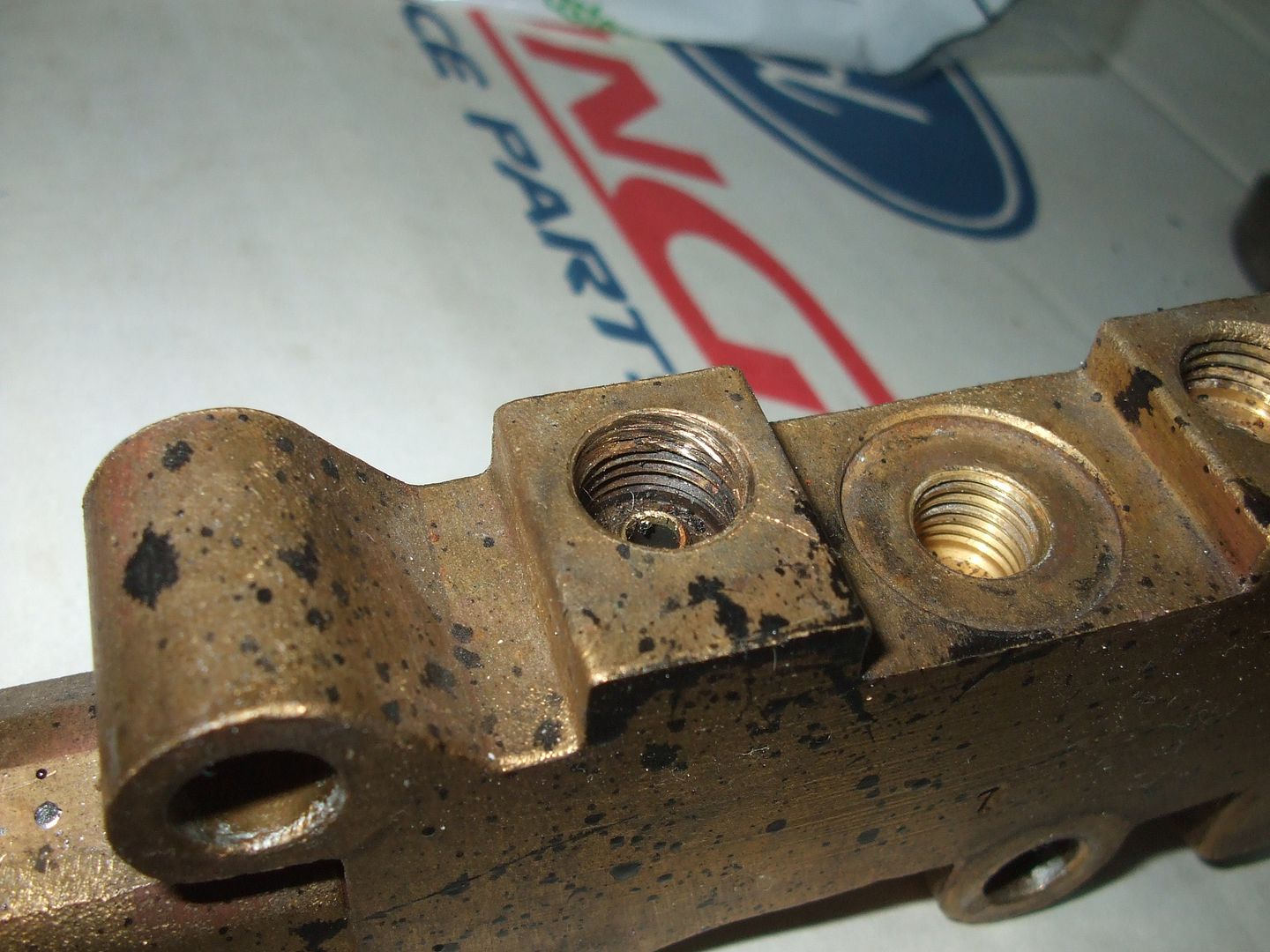

I got the new master cylinder and performed the same bench bleeding procedure. I had to pump it about 15-20 times before the bubbles disappeared. The walls of the master cylinder are visually thinner than the one I took off. The sealing surface of the new one is also in much worse shape. I would say there is a very good chance it is going to weep out of the lid.
After the master cylinder was fully bled, I left it on the bench with the ports plugged while installing the down lines to the frame. I thought I had started the rear line with my fingers for a couple full turns before it got hard. I started using the wrench and it seemed to be turning with minimal resistance for over another full turn, then it got hard. I could tell something was not right so I crawled underneath to get a side angle view and the entire line was leaning toward the front. Apparently it had cross threaded but I could not tell.
The first thought that popped into my engineering mind was "bottom tap, I can fix this" but I knew I was best off buying a new one. Brass is so soft and it was 31 years old so I figure it was just as well it got damaged enough to make me want to replace it. I had previously tried to take the valve out of the end to clean it and was using gorilla force but it wasn't budging. So who knows if it was functioning properly anyway. I had to cut off and replace the fitting on the brake line at the cost of 53 cents and drop another Benjamin on this.
At least now I can say the entire braking system is new. A friend came over and helped me bleed the brakes. We used a Mityvac and started at the right rear only pulling about 5" of vacuum until I got fluid. Then moved to the left rear, right front then left front. I started at the right rear again and bled it manually until I saw no more air, this was maybe 4-6 times average per wheel. Then I went back around one last time with three more bleeds per wheel even though I was no longer getting air. I just wanted to be sure since I was starting with empty lines. I'll be sure to bleed them again after the first 100 miles. The pedal feels solid and you can hear all the components moving. I'll likely brush on a coat of POR and Chassis Black when I open the cans to paint my bumper.

Great pics, Mike. Thanks. I agree that your new MC may weep. Several folks have complained about that. It's kind of late now but you might want to use a big file and level the sealing surface. Don't know how you'd keep the shavings out of the bowl, though. But I know you ain't gonna be happy with a weepy MC in a brand new Jeep! Paint it before you get oil all over it!
Kerrdog
Go Fish! <*////><
Skerr is offline
post #489 of 1947 Old 08-28-2010, 09:44 AM
Jim1611
Jim1611's Avatar
Posts: 7,360
New brake stuff all around is a good idea. I wonder if that old MC could be rebuilt? Too bad they didn't take the time to machine the top better.

Where did u get the master cylinder at? I got a whole new assembly about 8 years ago and now mine is REALLY leaking (not weeping) from the top.
FYI I got the one 8 years ago at o'reilys. I was looking to get one from advanced auto this time (there are no o'rielys where I'm now stationed)

Thanks for the comments guys, I'm not disappointed I had to replace the last of the brake parts. Minimal cost for piece of mind knowing that everything is new.
I bought the MC at AutoZone for $19.99 for the remanufactured unit. I believe the new unit was $54. Unfortunately it is not a part that they stock so I didn't get the chance to pick from several parts. They special ordered it so I pretty much got what I got. I was dumping used oil in the back while he was doing the core exchange. I could see him through the opening in the racks and he looked in the box three times, probably wondering if I was returning the new part because it was nicely painted.

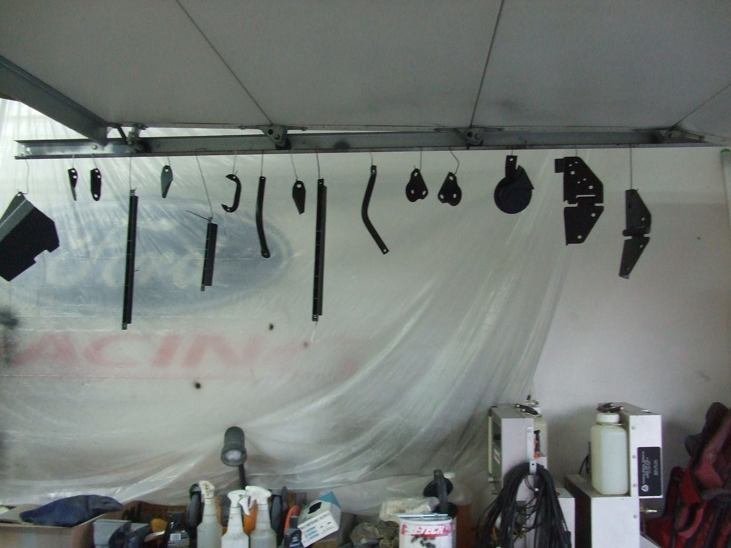

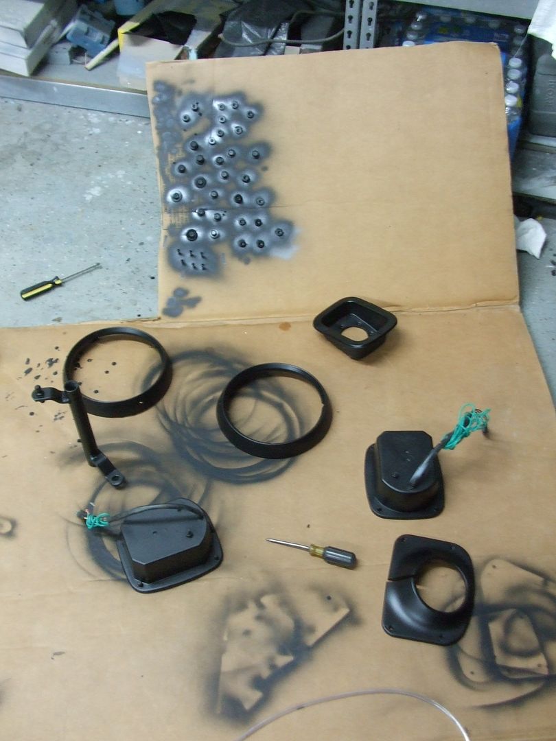

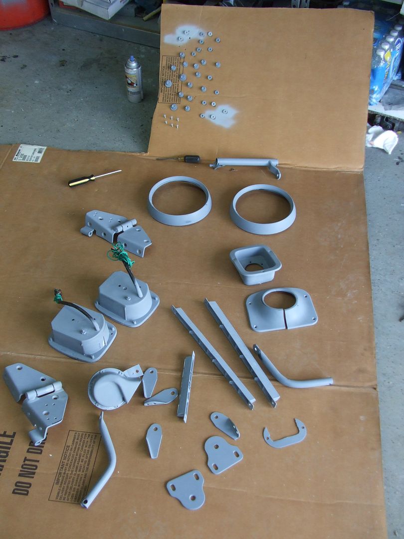

Small Black Accessories

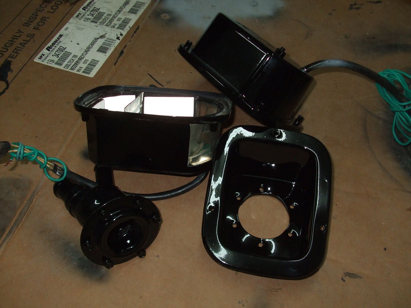

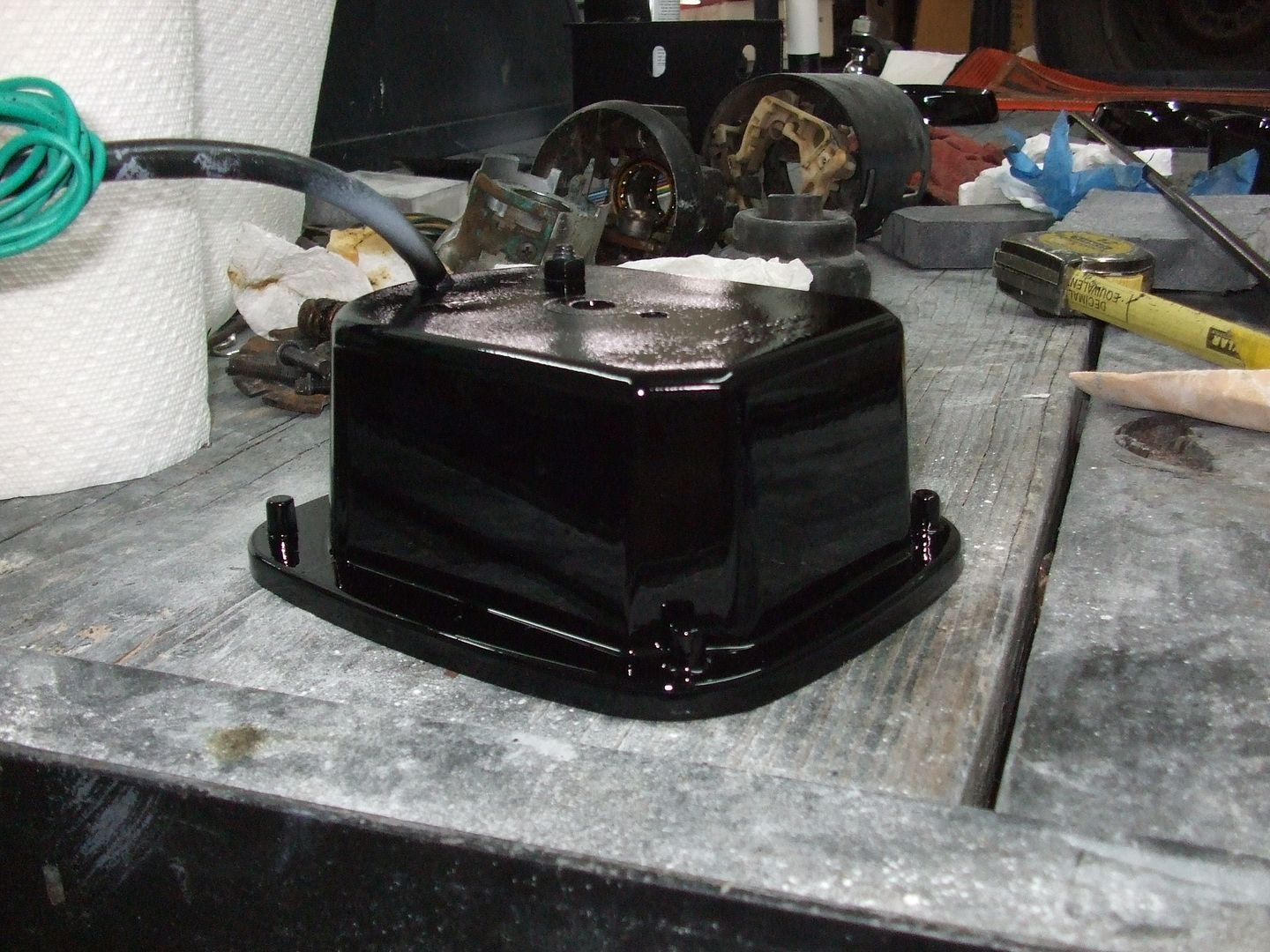

I got most of my smaller black accessory parts painted. These were all primed with the 2K100 except for those couple of bolt heads that got the rattle can. Here they are all primered, sanded and washed ready for paint.
I ended up painting them black with an air brush. Took longer but was kind of fun.
Hanging out to dry. The piece on the far left is actually Raptor'ed and goes beneath the charcoal canister.

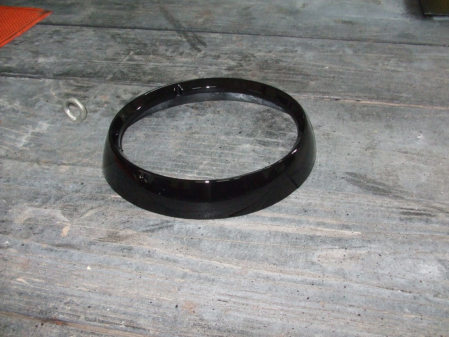

Here is a shot of one of the brake light housings after a round of clear coat.
Headlight bezel after some clear coat.
Time to install a few small parts. I have no intention of sanding or buffing theses.
