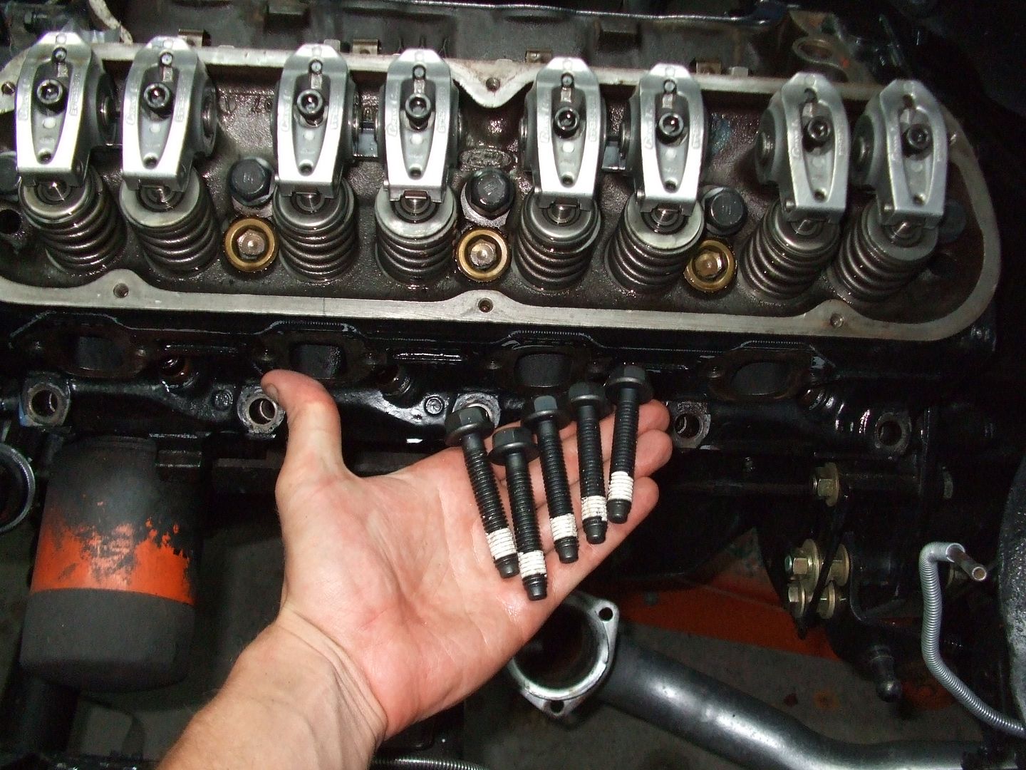

Thanks guys. I am glad I took a half a day to pull the heads and clean the pistons and cylinder walls.
As far as emblems, I am going to have some pinstripe made up that will have "5.0 HO" placed below the Jeep stamp in the tub.
I got the cylinder heads put back on with some new torque to yield head bolts. They come with the sealant on the bolts that are in contact with the water jackets.

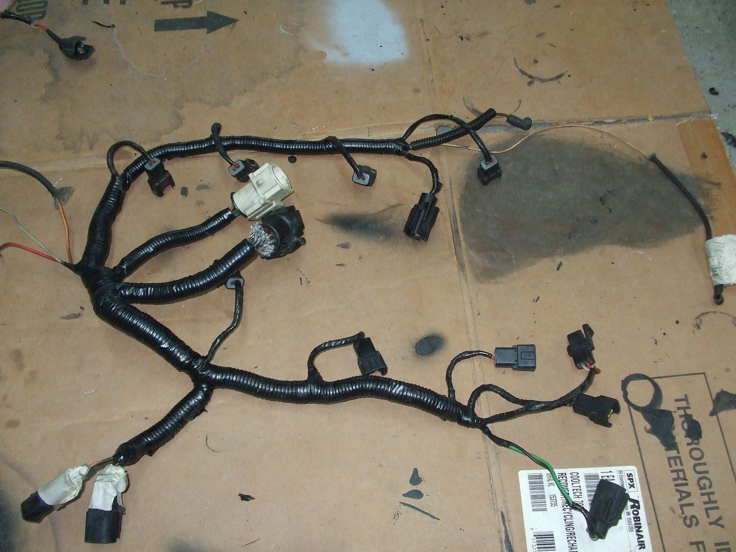

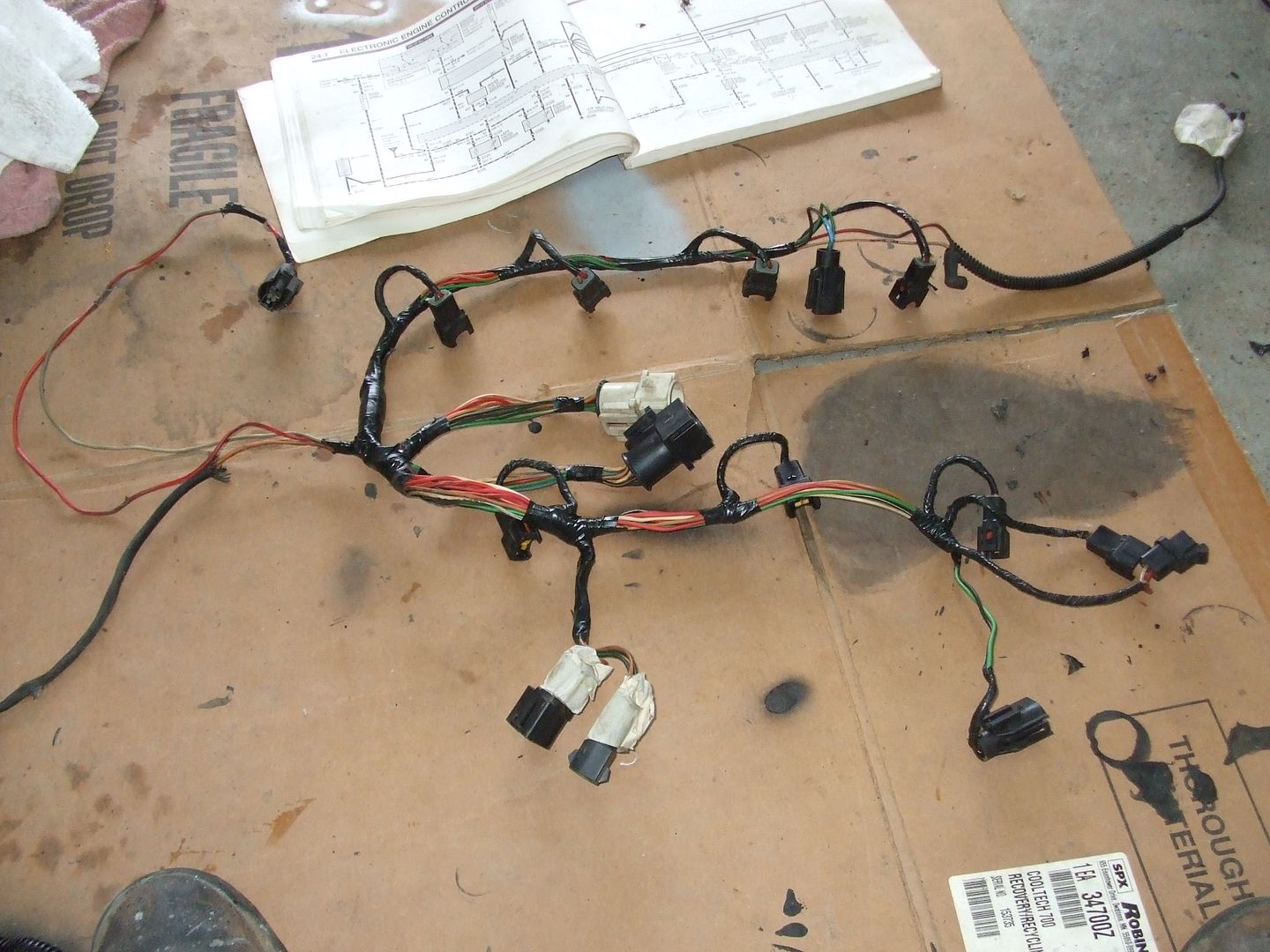

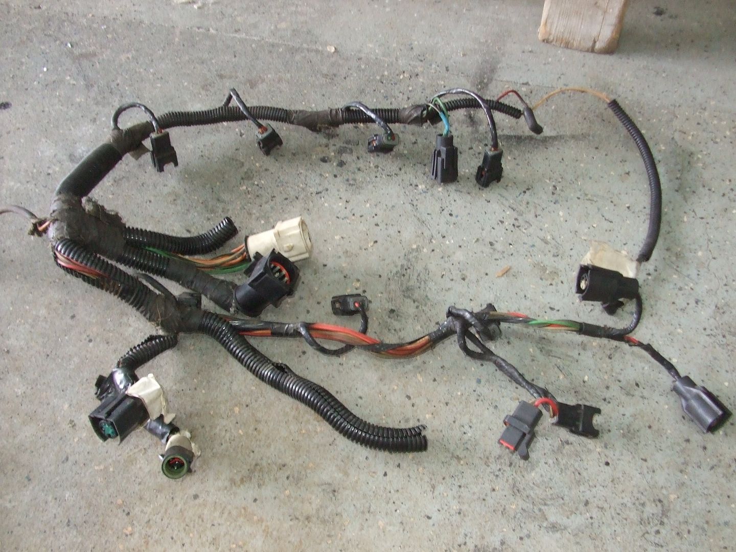

Engine wiring harness
I got the engine wiring harness cleaned up. Here is how it came out of the box I put it in 2.5 years ago.
Here is the harness all stripped down. I needed to keep all the wires but I had to move the canister purge solenoid to a different location. You can see it go from the bottom right of the photo to the far left.
Here it is all taped up with new conduit. Still missing just a few short runs at the ends but I can finish that off once it's on the engine.
Mike

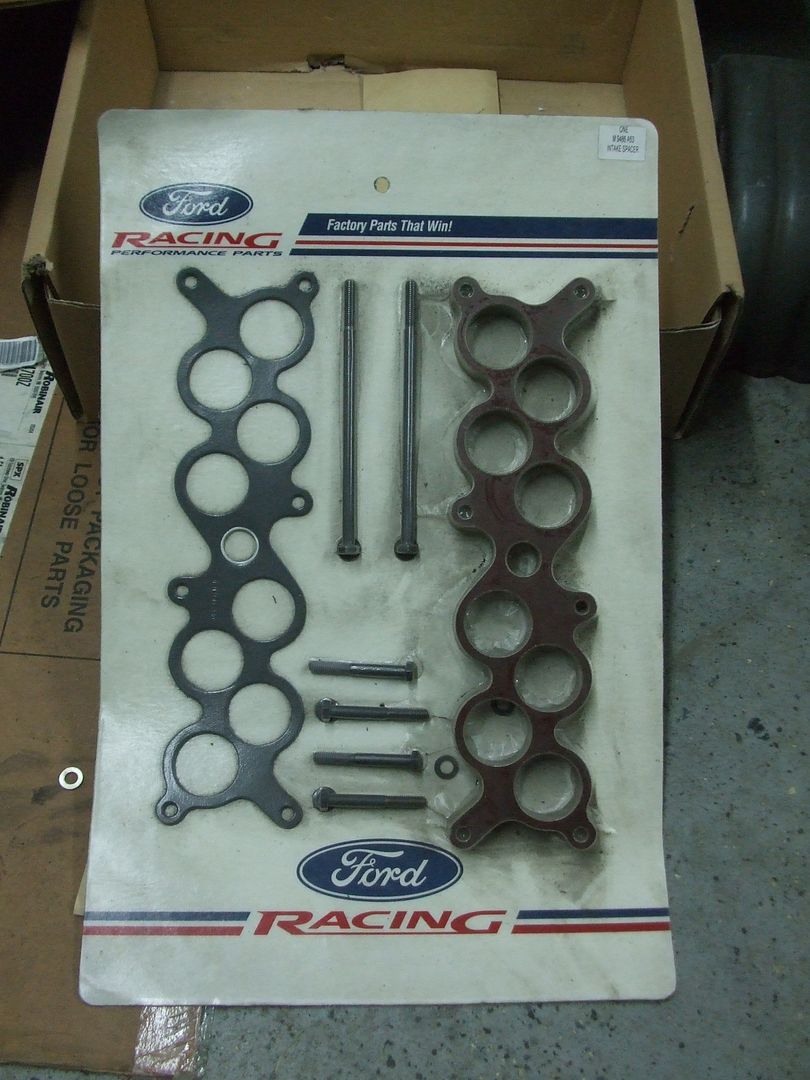

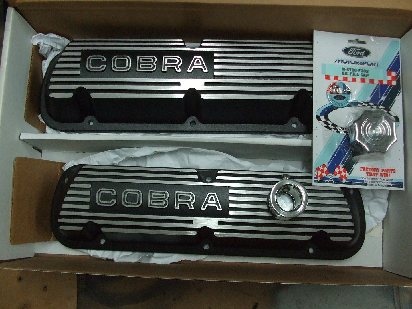

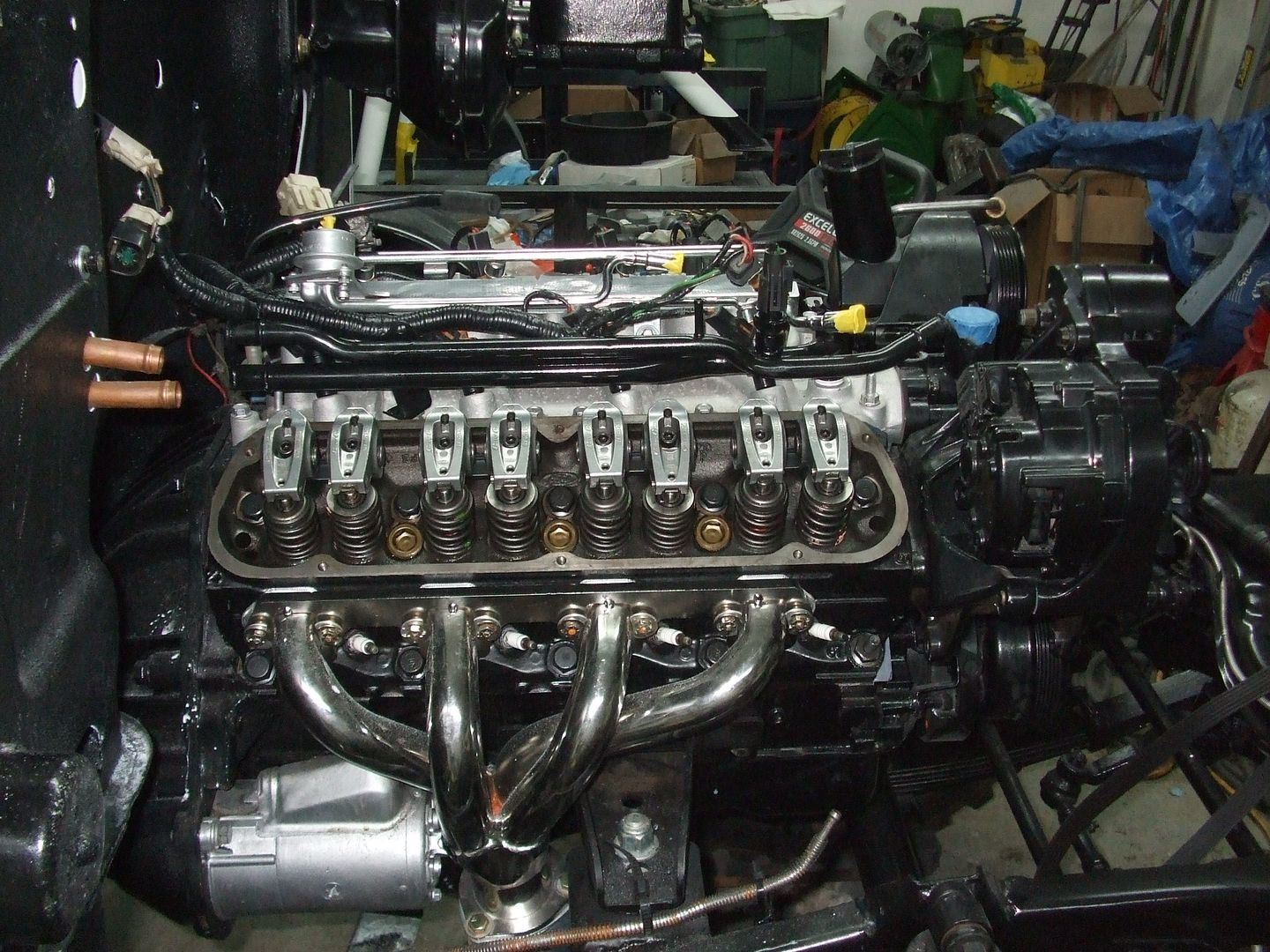

Mike, have you put on a valve cover and made sure the roller rockers clear okay? Reason for asking, I bought the same valve cover in aluminum (not black) and my roller rockers where touching. I ended up going with a set of Canton aluminum which are little taller than stock but still clear the Cobra intake without adding the spacer plate... You may be okay but just a thought....
On the passenger's side stock valve cover I had to use a hammer and punch to "modify" the baffle for the oil fill to clear the rocker. The new valve covers are 3/4-1" taller and are supposed to clear the larger rocker arms. With the original valve covers I could use the stock throttle linkage. With the new valve covers being taller, I have to either use the intake spacer or modify the throttle linkage. I decided to just go with the spacer since I could get it cheap, I know a guy , and because I've got plenty of room between the hood and top of the engine.

I bought the 1/2" spacer as well and did not use. Although, you are correct, the throttle cable is barely clearing the top of the valve cover. I may add it if I pulled the top off anytime in the future... The spacer is a good way to go and give you some clearance.....

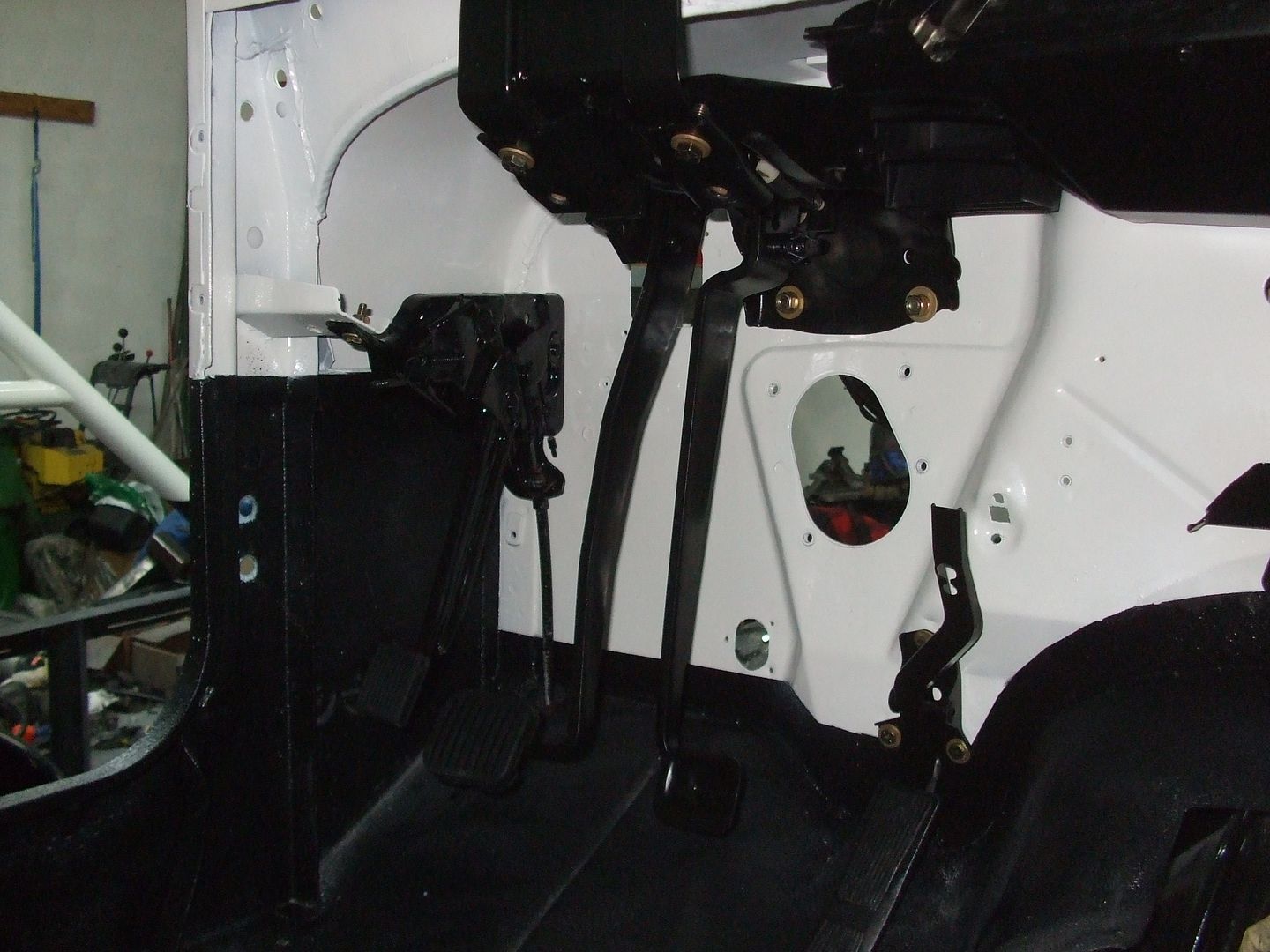

I got my control pedals and main brake components installed.

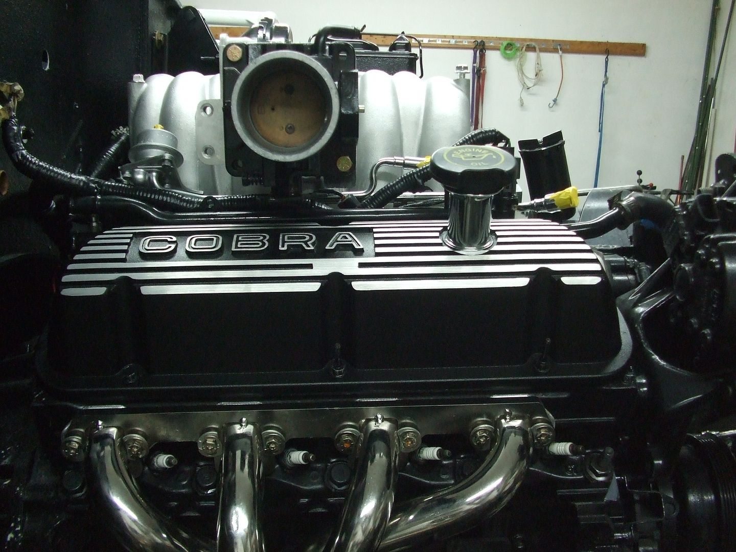

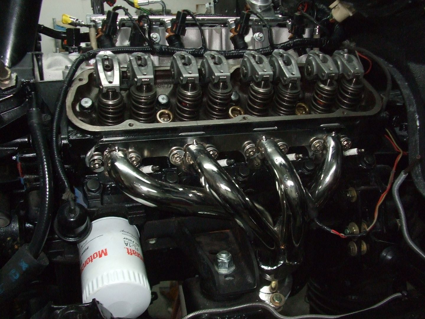

More work on the engine

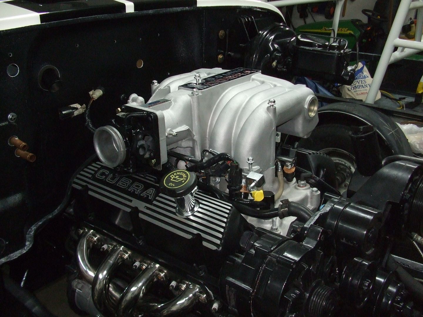

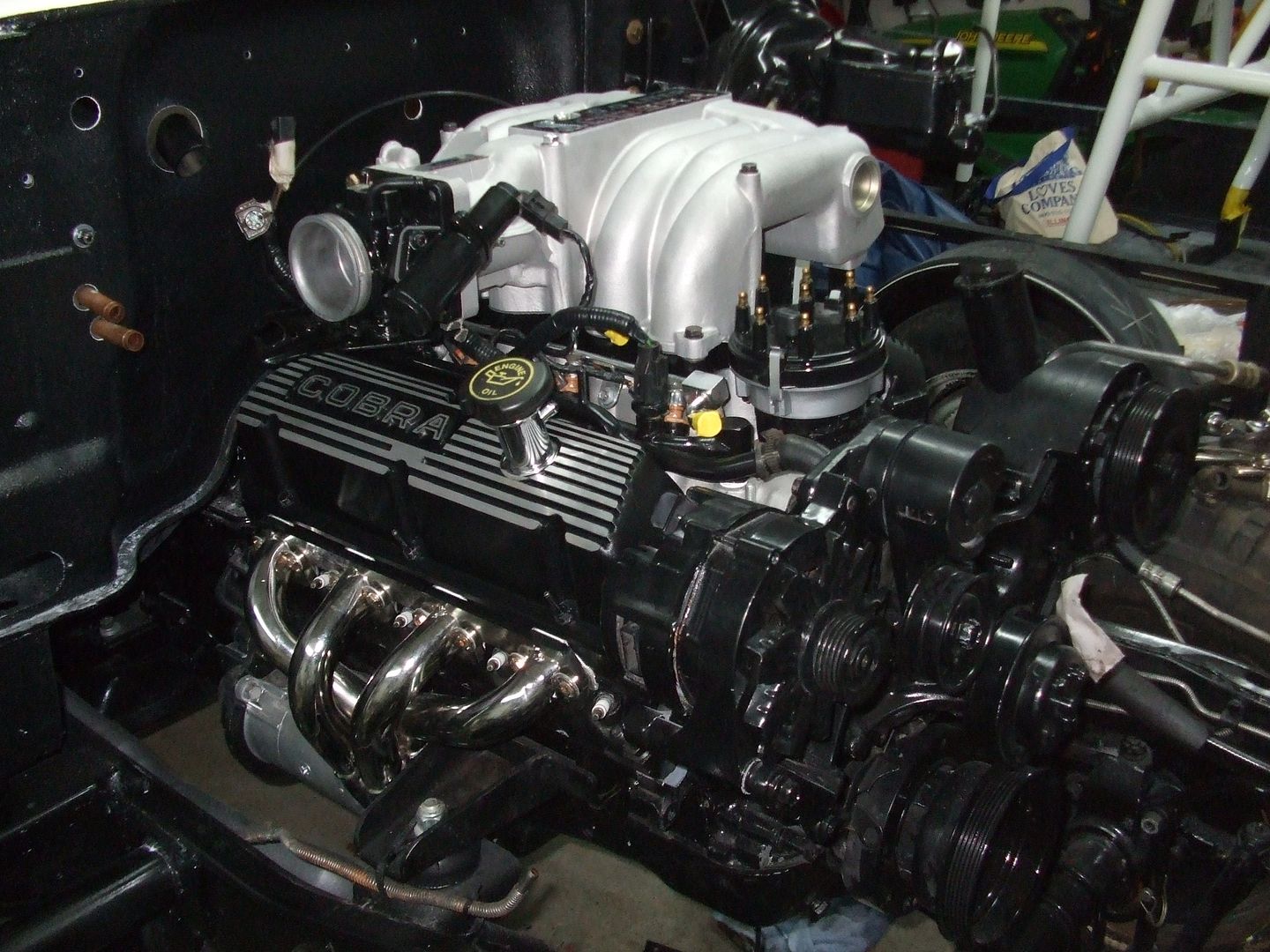

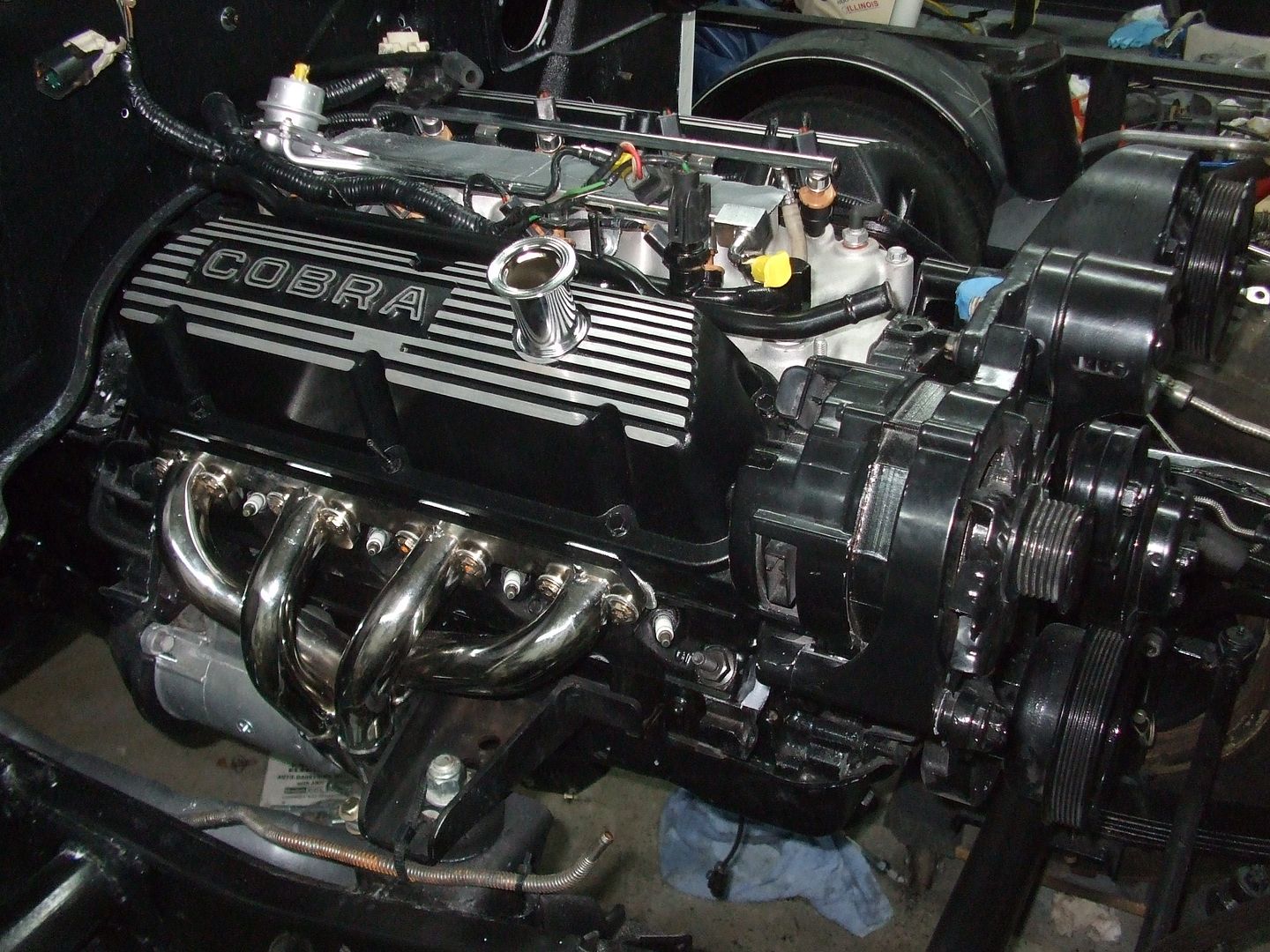

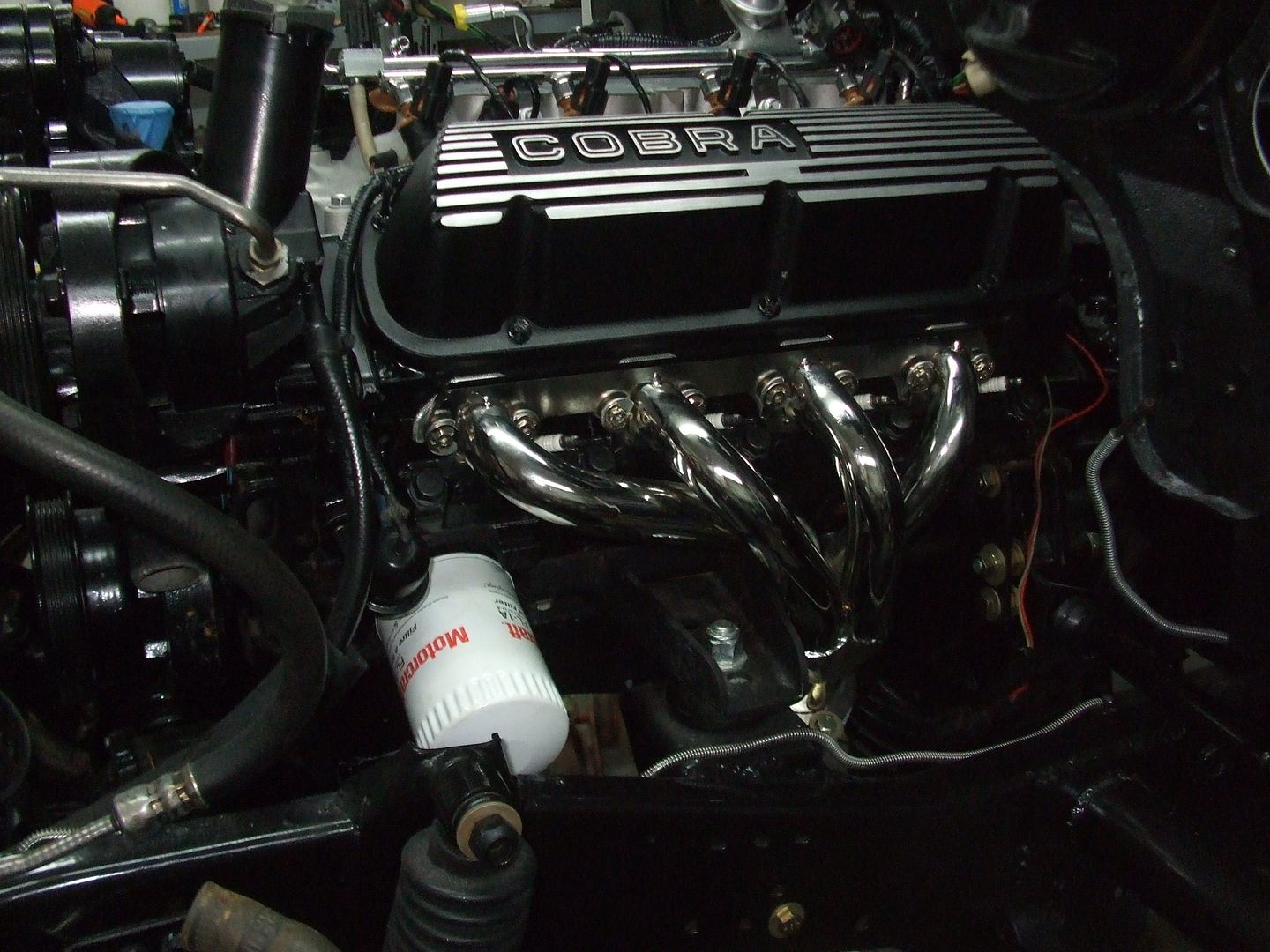

I got the headers, exhaust, alternator and power steering mounted back up. I also got the engine harness installed.
A picture of the driver's side. I finally decided it was time to install a quality oil filter.
Valve covers are on. I wasn't very happy about the bolts for the valve covers so I picked up some new black headed bolts from Fastenal. They are not on in this picture though.
Driver's side. The wires you see hanging in the back are off the engine harness and will go to my canister purge valve.
Here is a picture of the intake with no spacer installed.
Notice how close it is to the valve cover. I could not install my throttle linkage because the bottom corner needed an extra 1/4" to clear the valve cover.

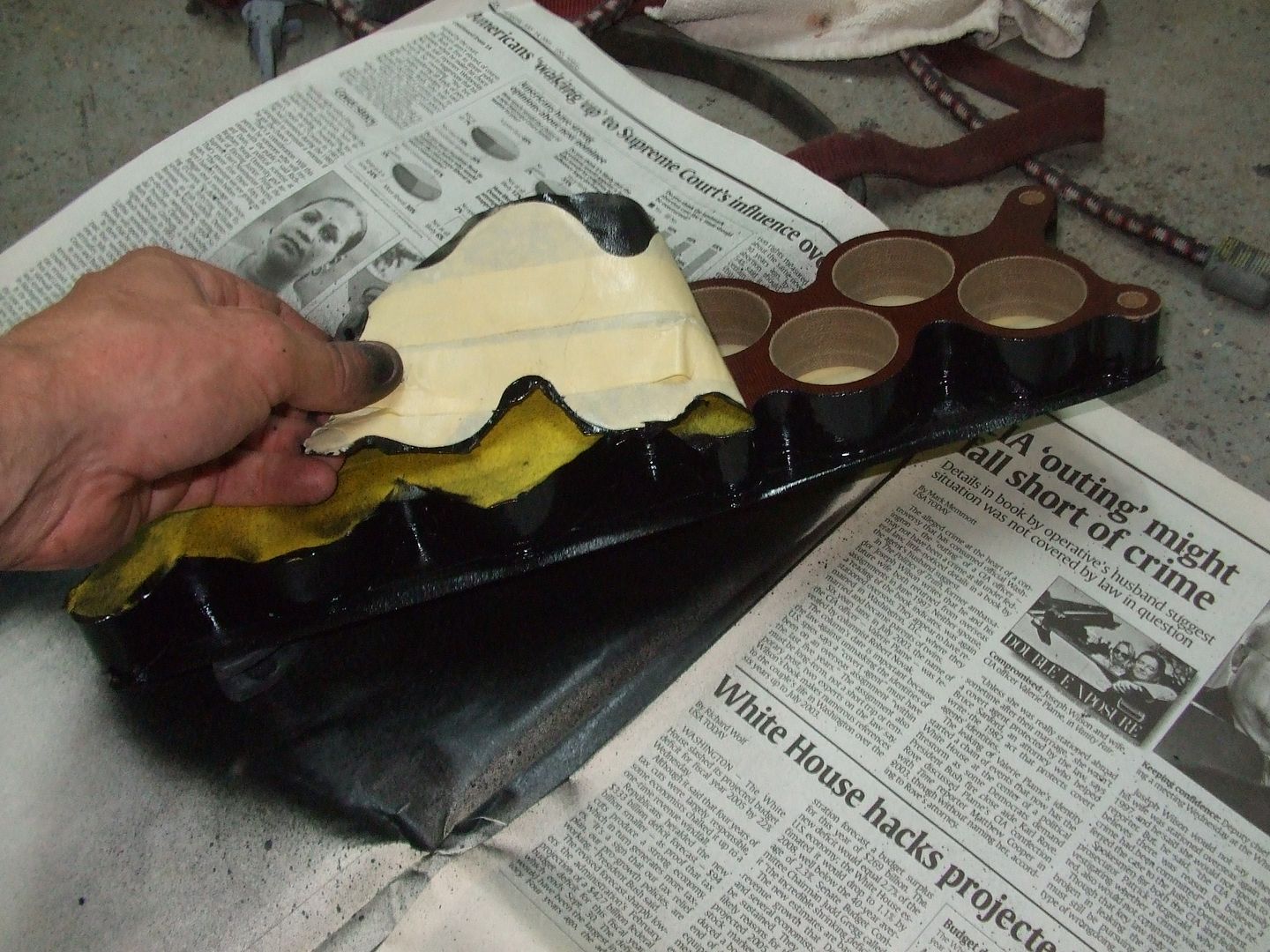

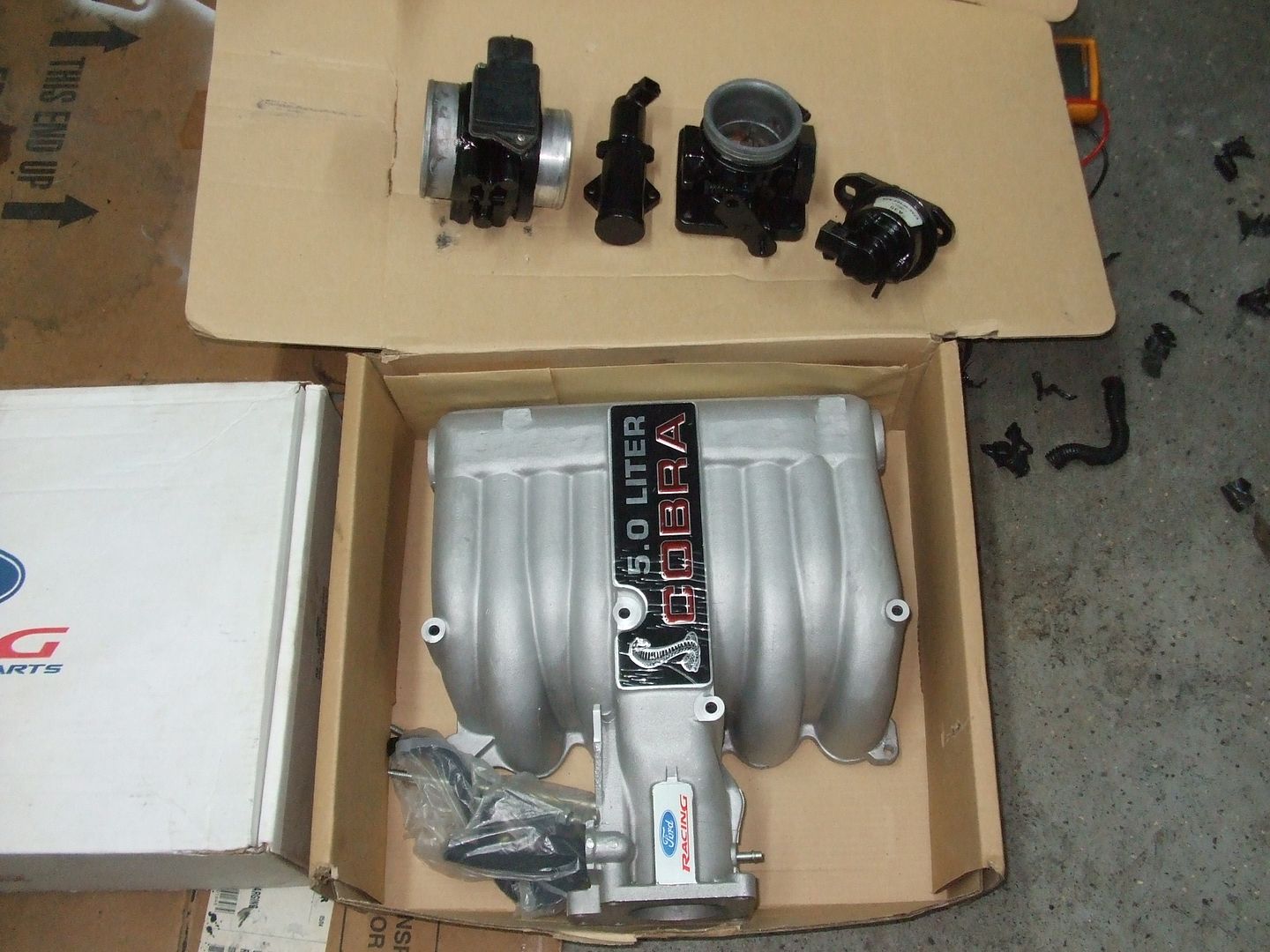

A picture of the Ford Motorsport intake spacer. It is supposed to keep the intake cooler and increases the runner length. I needed it solely to have the clearance so my throttle linkage would not hit the valve cover.
Of course I had to paint it black to match.
Here it is with the spacer installed. Notice I also got my distributor cleaned and painted.
I had to pick up some more bolts from Fastenal to finish installing the intake, throttle body and EGR valve.
