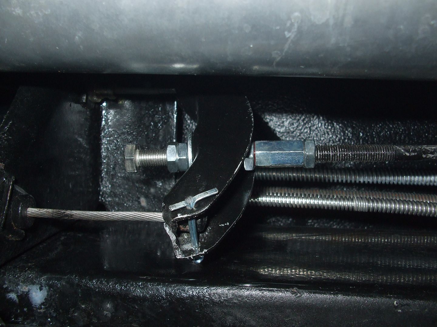

Parking Brake Cable

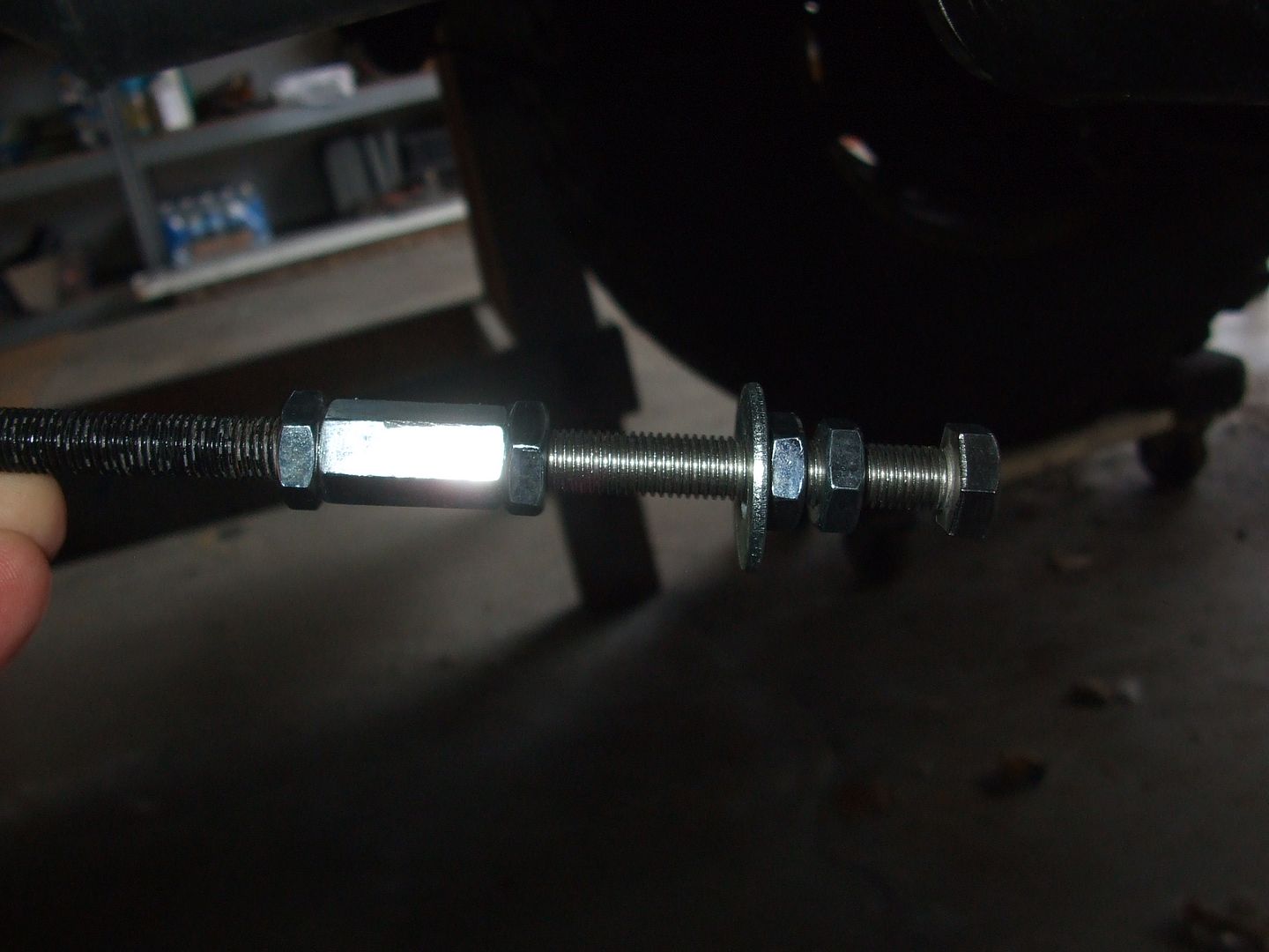

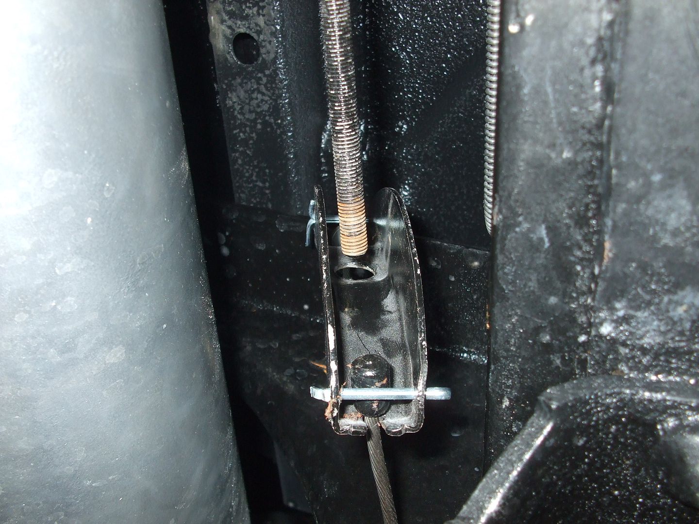

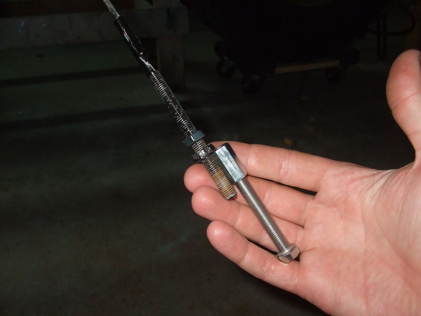

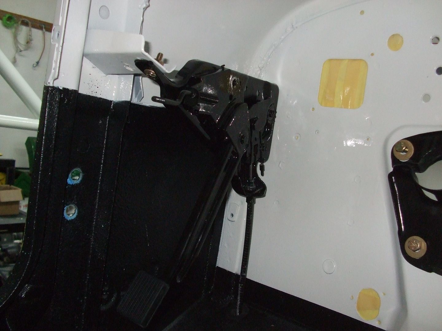

My parking brake cable came up short due to my 1" body lift.
In order to extend the adjuster I had to cut about 1" off the original threads. I cut the threads even with the center of the coupler. This is 5/16"x24 fine thread.
Next I used a stainless steel bolt as an adjuster to screw into the coupler with another jam nut and used two more stainless nuts to actually adjust the parking brake tension.
Here is it all connected.
The parking brake actuator is mounted. Notice how the front is moved to the right of its' normal mounting point. I did that in an attempt to give me better access to the pedal due to my 6 point roll cage, the front arm runs right in front of the pedal. I use to just contort my foot in there to apply the brake but I moved it out to see if that will help. If it gets in the way of the clutch I will just move it back to the stock location and fab up something for the pedal.

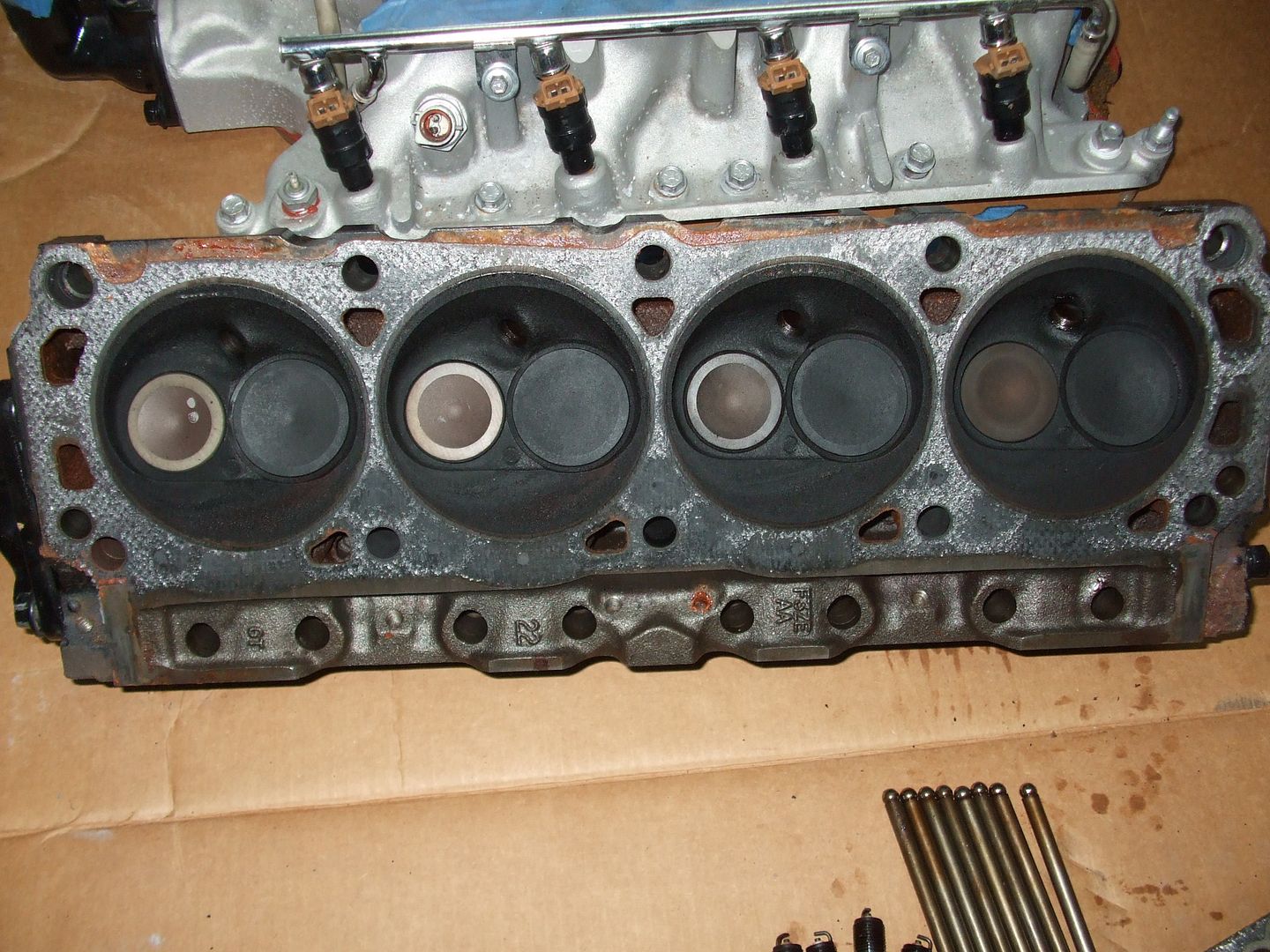

A Little Engine Work

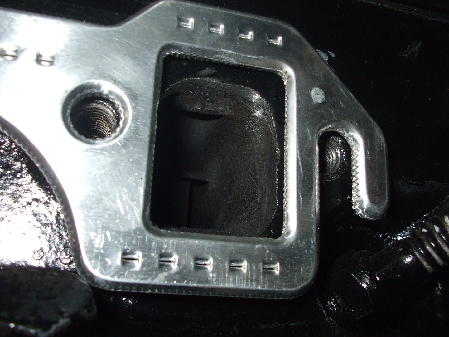

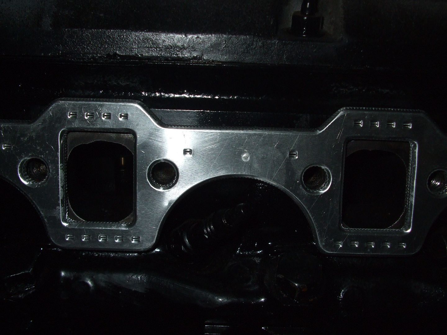

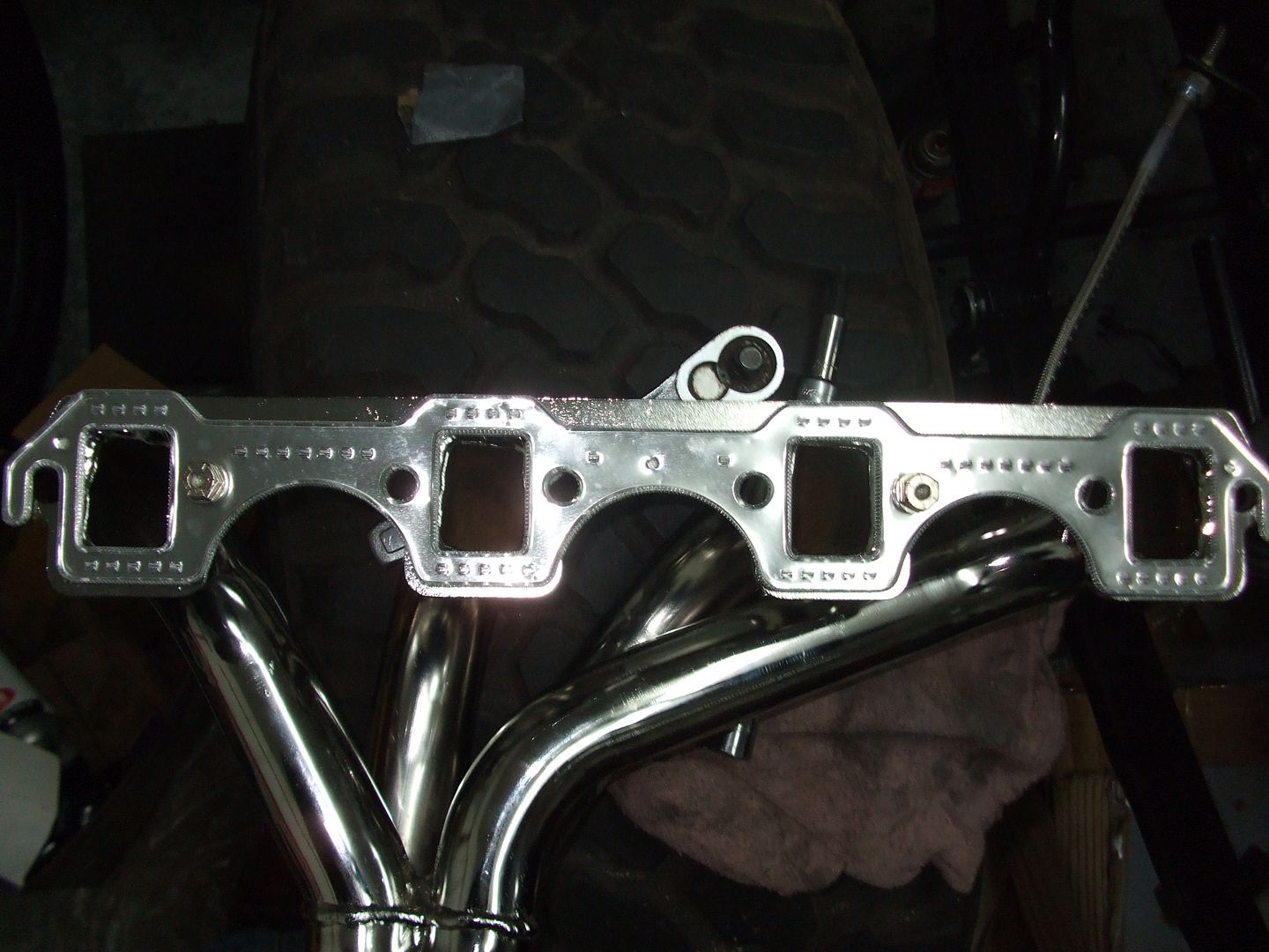

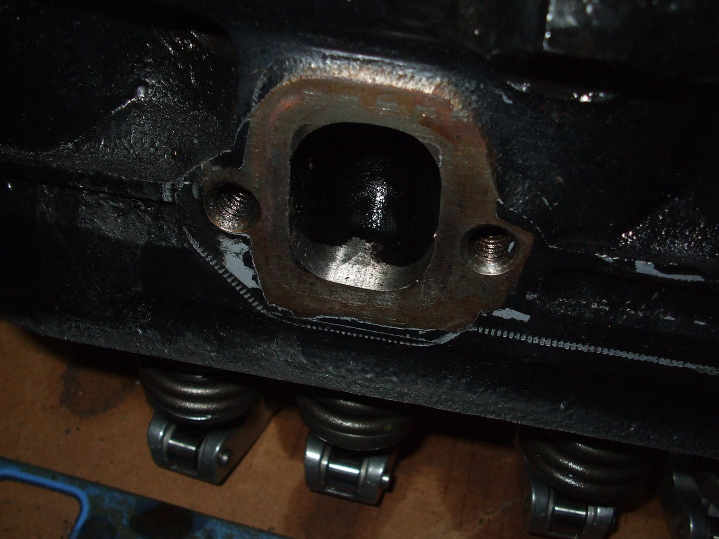

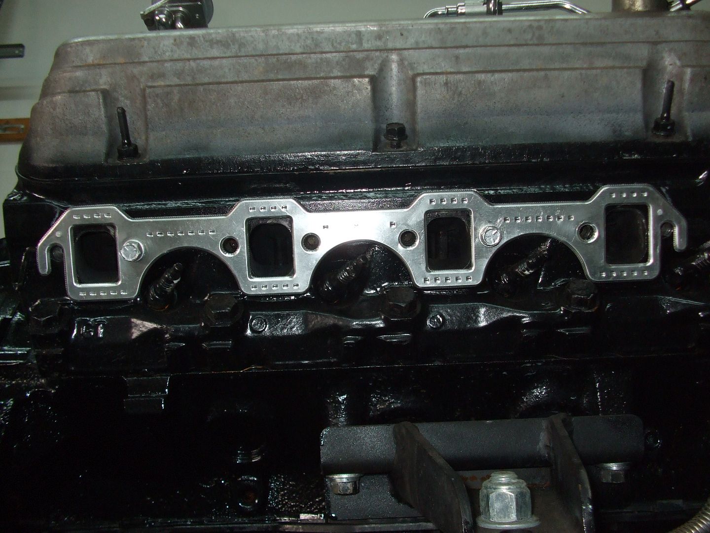

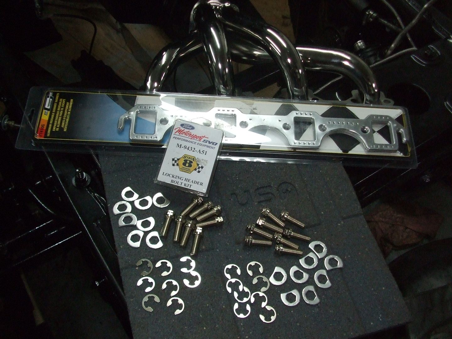

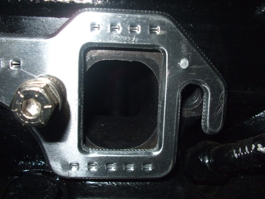

I'm going to have to take a step back before I can move forward. About six months ago when I was originally installing my new Advanced Adapter block hugger headers with my Stage 8 locking header bolts and the reusable 6 ply aluminum gaskets(MrGasket #7410G),

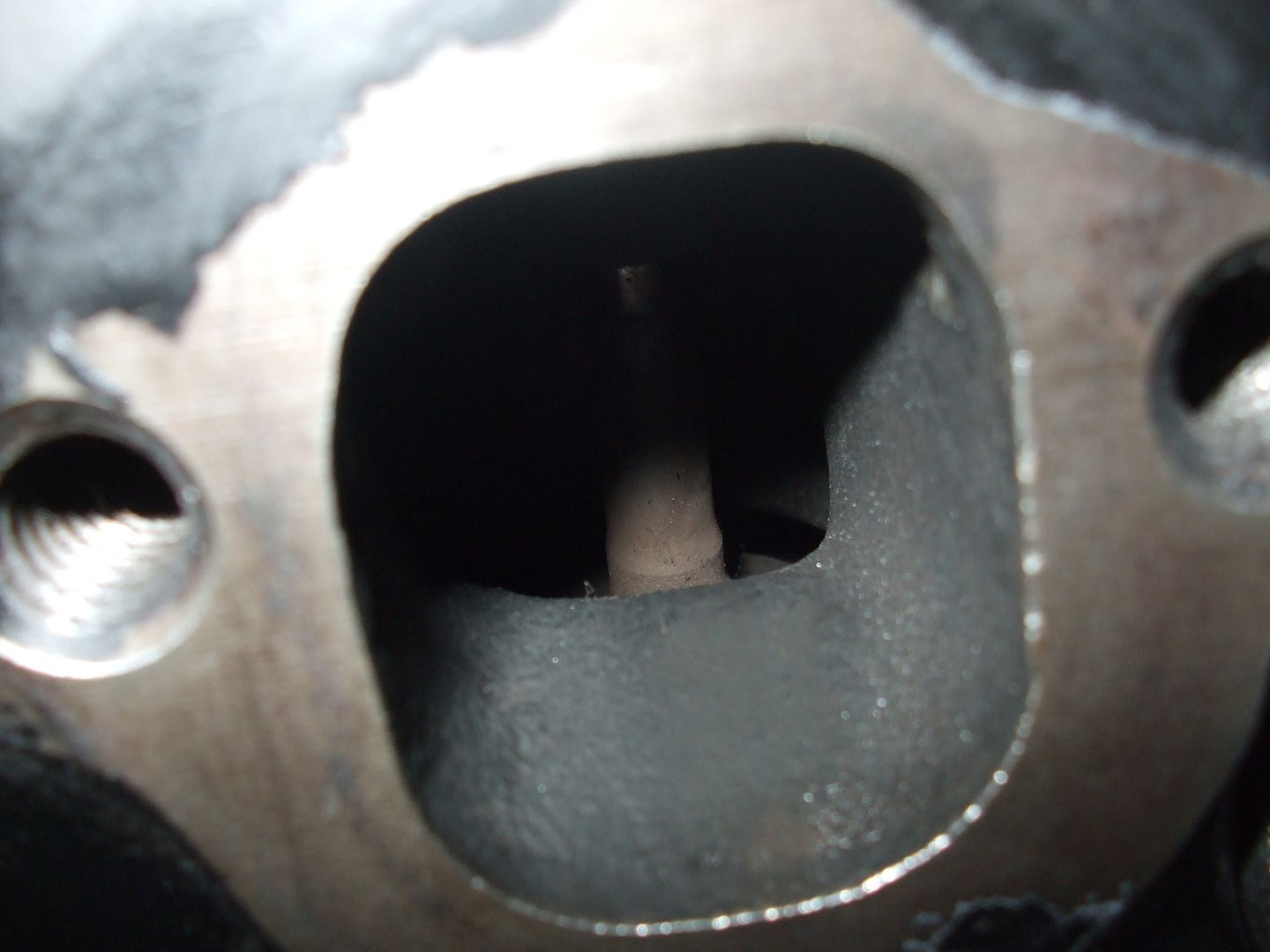

I noticed the poor casting on the outer edge of the exhaust ports.The one on the left is really bad.
If you look closely you can see the black outline from the stock exhaust gaskets. When you stuck your finger in the port there was a considerable lip right at the top outer edge. It seemed like I could grind an easy 1/8" lip off the opening and make it even with that stock gasket mark. Keep in mind by no means was I trying to "port the head".
You can see how much better the gasket matches the headers than it does the head.
I had seen this done several times in college and helped a friend do it on his Corvette. I wasn't nearly as aggressive as any of my previous experiences. Like I said, I wasn't trying to port the head, I was only trying to clean up obvious casting flaws at the ends of the ports.
Here they are all cleaned up.
I basically did the same thing to both heads. Now here is the kicker. While grinding these lips with a stone tipped air powered die grinder, I made sure the valves were shut and had my shop vac at point blank on the work zone. After a couple of them I started stuffing the exhaust ports with paper towels before grinding while vacuuming. Afterwards, I cleaned every port as well as I could. I was pretty sure I had got most of the shavings but ultimately it would sometimes keep me up at night wondering if any of those shavings made it into the engine. Notice the micro sized reflective bits?
Nightmares of having to rebuild my engine 2000 miles after finishing my restoration got the best of me. Fast forward to now, six months later I finally priced out some head gaskets and bolts for $60 and figured that was cheap insurance to make sure the engine was clean. Time to start disassembling the engine to get the cylinder heads off.

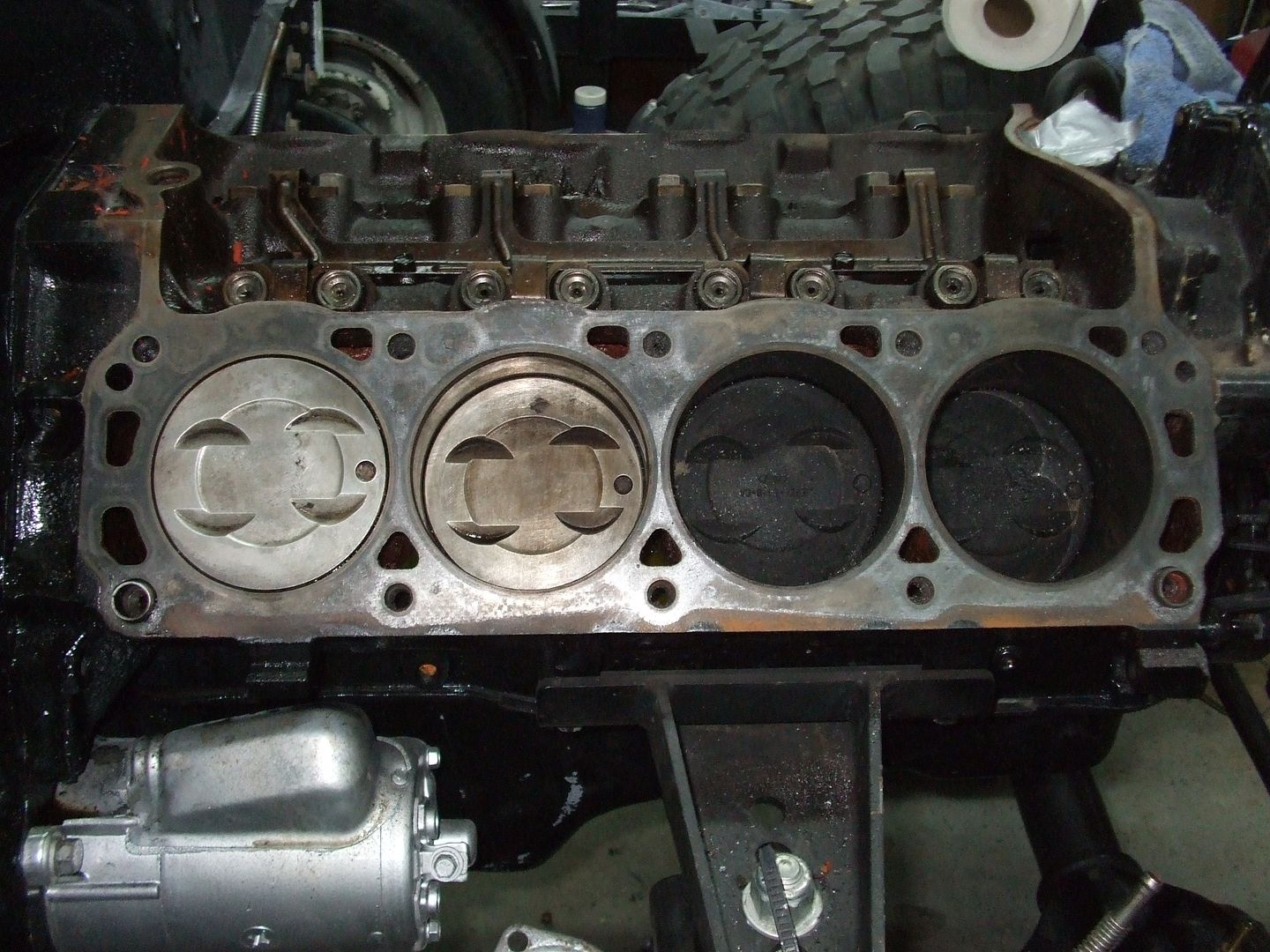

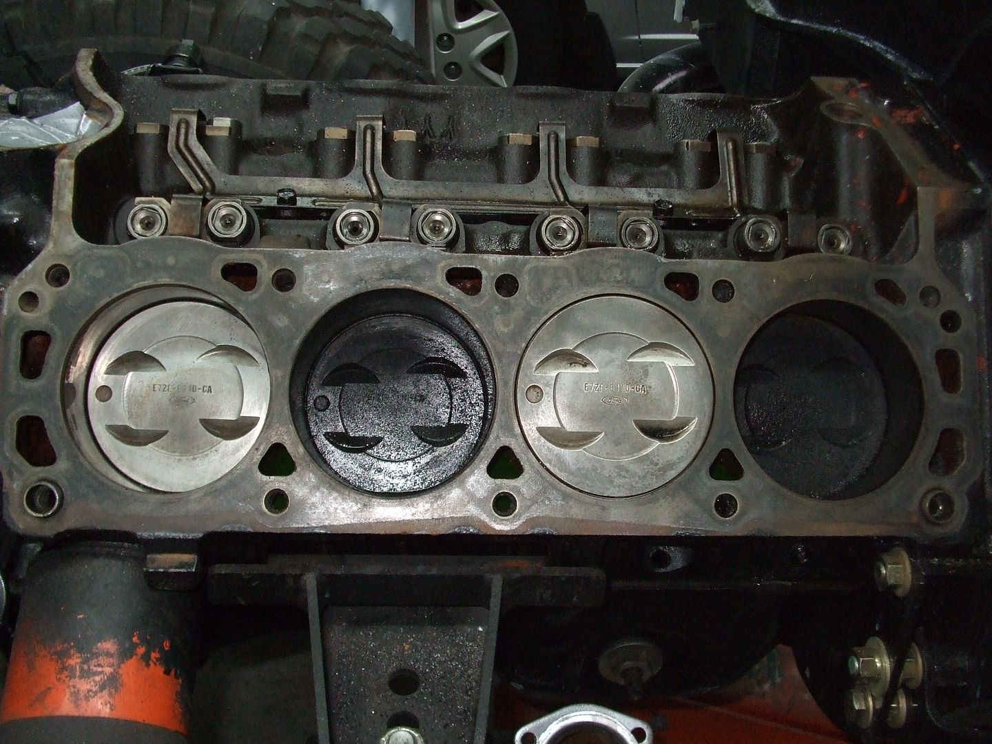

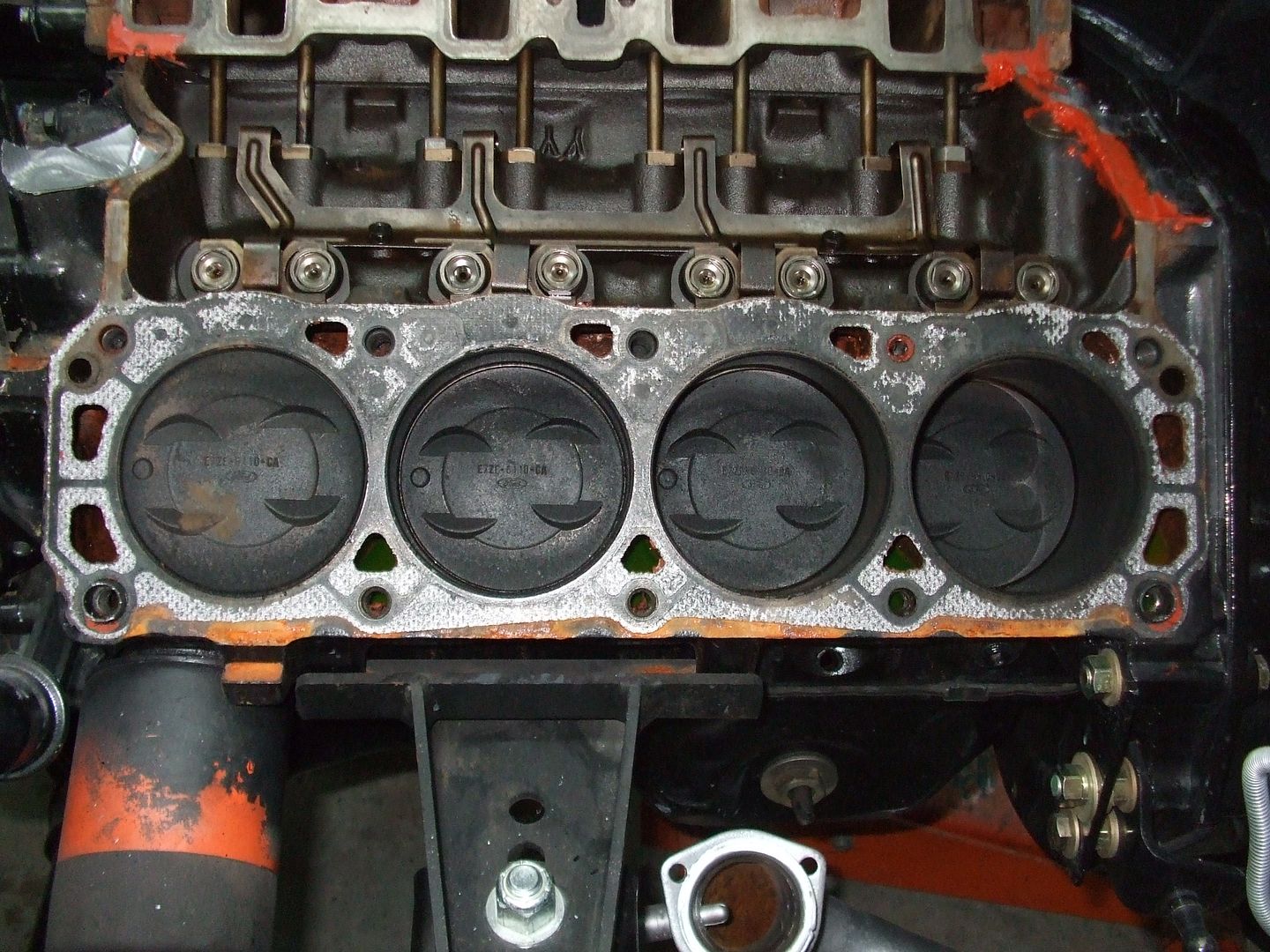

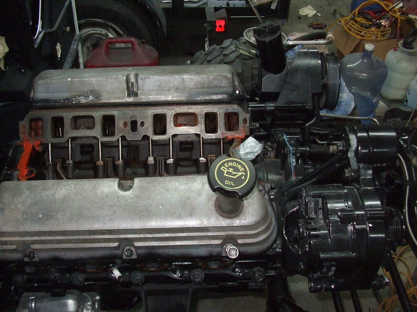

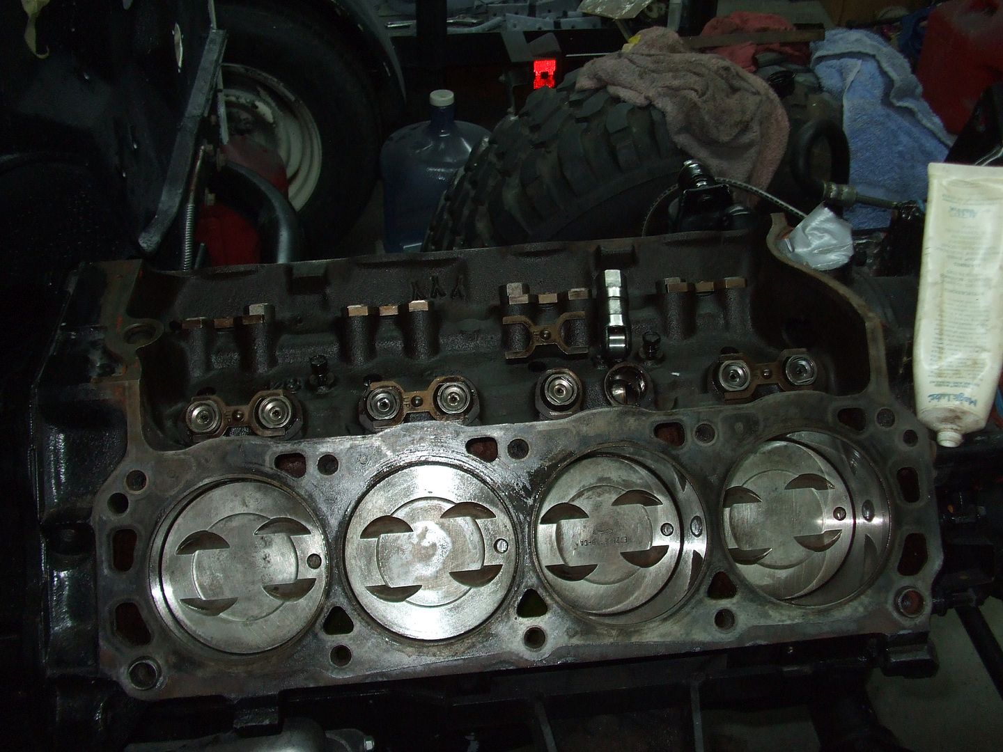

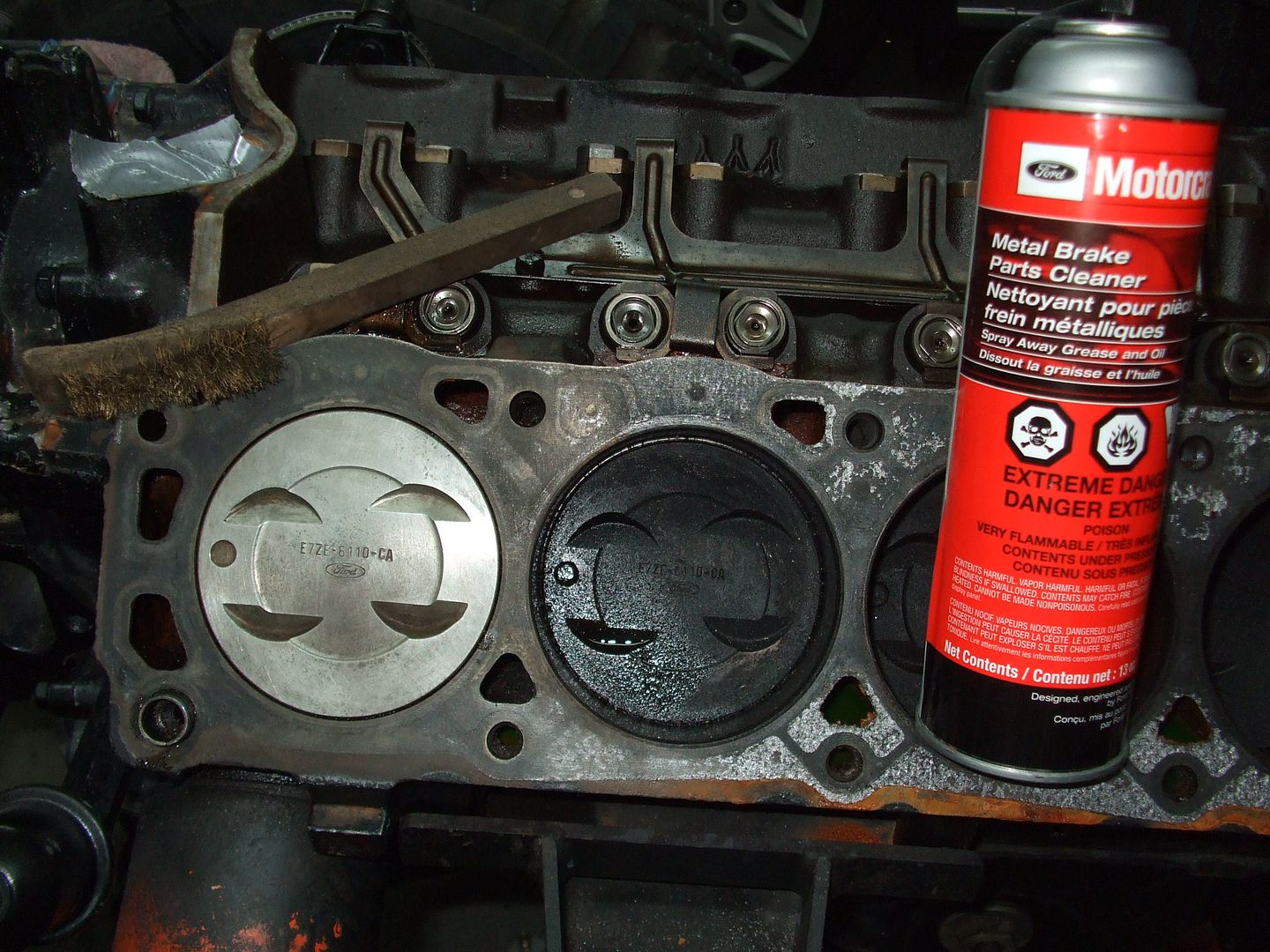

To remove the cylinder heads I had to start with the lower intake manifold, headers, alternator, power steering and valve covers.
The driver's side cylinder head removed revealing the bank of pistons.

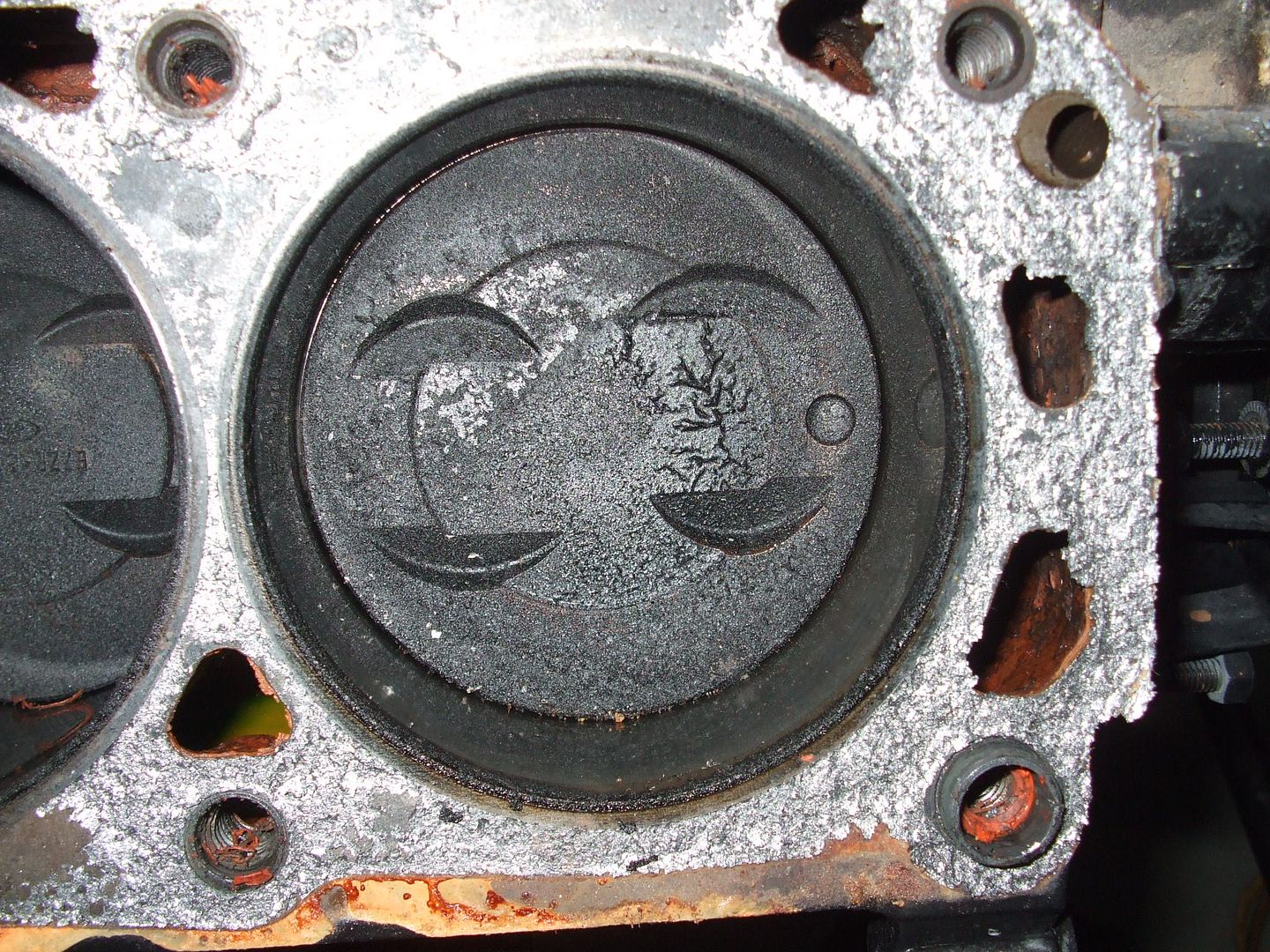

Close up of cylinder #1. Notice the carbon ring ridge and other small debris in the cylinder. The wrinkle in the carbon is likely from the metal parts cleaner I was spraying on the valves while trying to clean them off.

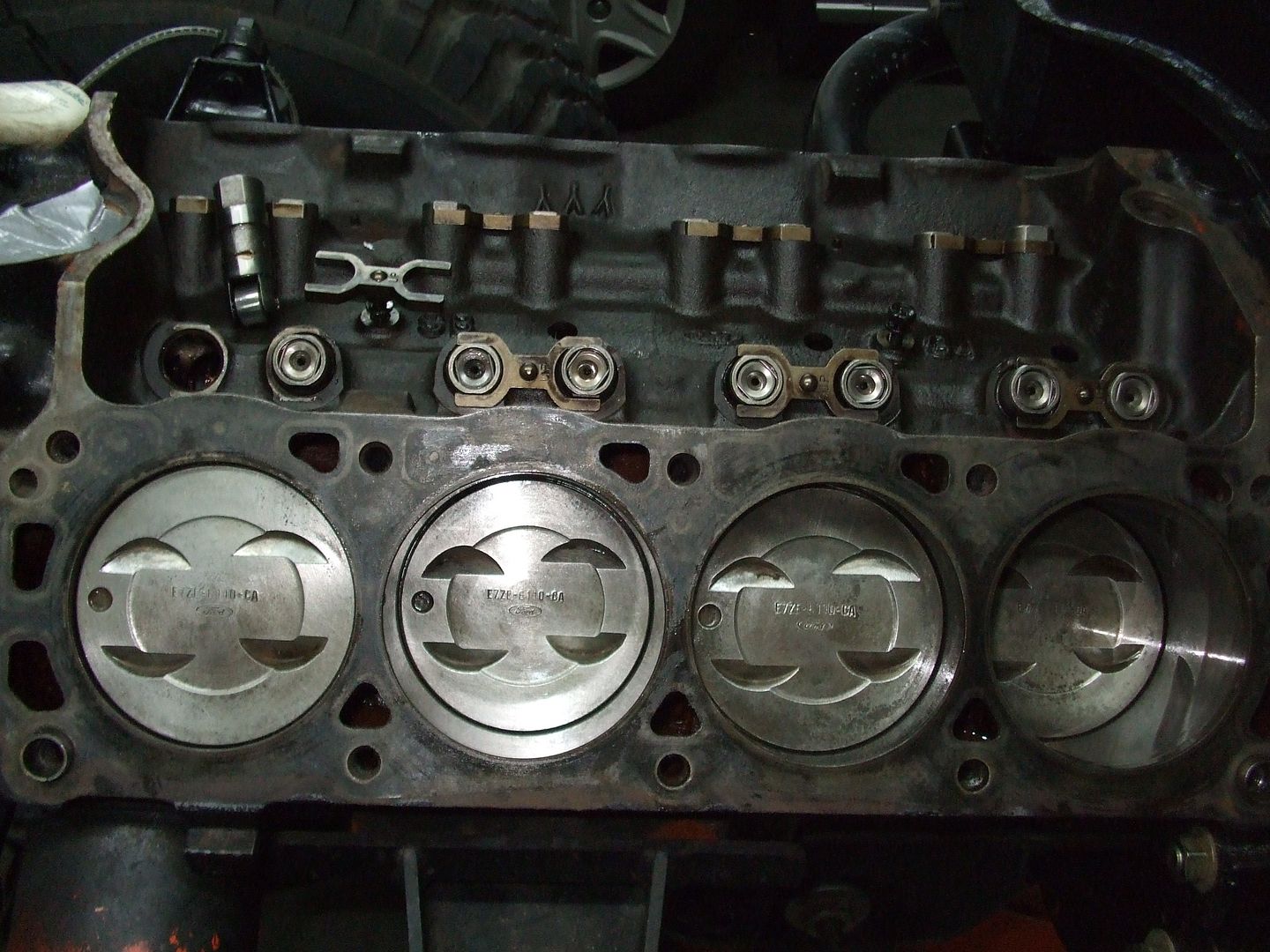

This took me literally 60 seconds with a brass brush and metal parts cleaner.
A few minutes later the deck is mostly clean and two of the four pistons.
This was somewhere around 10-15 minutes of total scrubbing.

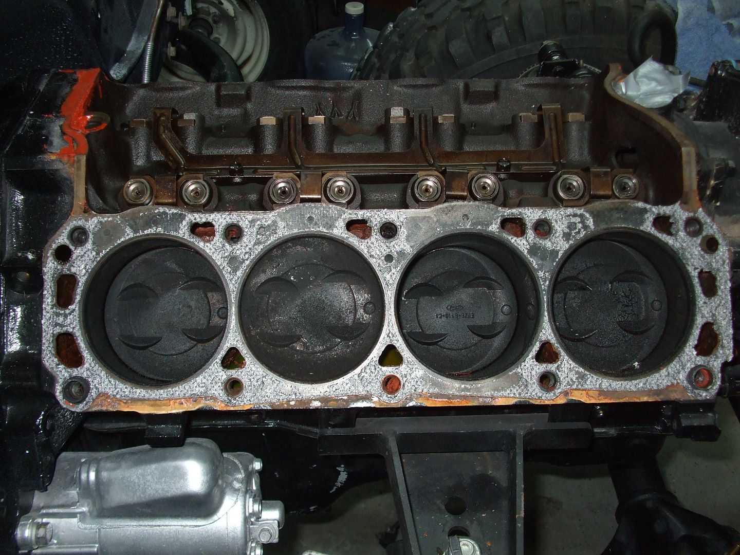

The passenger's side bank 1 looked the same with carbon build up.
Clean away with the brass brush and metal cleaner.
The entire side clean. I also pulled out all of the lifters and cleaned them off as well as the cam lobes. I even wiped a dab of assembly lube on them before I put them back in. I also cleaned out the valley really well.
After spraying out most of the dirt between the piston and the compression ring, I ended up coating a lint free cloth liberally in oil and washed all of the cylinders. Then I would crank the engine over by hand and wipe off all the dirt in the oil that was left in the top of the cylinder by the top piston ring when it moves from top to bottom. There was quite a bit of debris the first several times but quickly lessened. I did this probably 15-20 times per cylinder before there was no more contaminates being left behind in the fresh oil film. I feel an awful lot better about the inside of my engine now.
Mike

As far as the porting, there is a lot more to it than just going to town with a grinder and making everything look shiny. There is a lot of theory behind port and bowl design and without a flow bench I'm not sure I would want to tackle that right now. I don't think lack of HP is going to be one of my concerns.
Mike

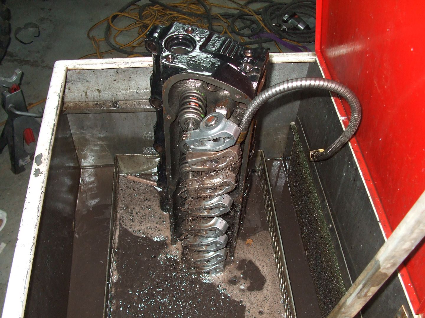

Next I had to get the cylinder heads cleaned up.
Luckily I just scored a parts washer. I wish I would have had this two years ago.
Clean enough and drying off.

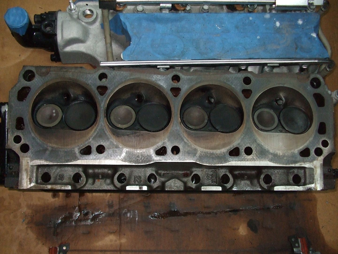

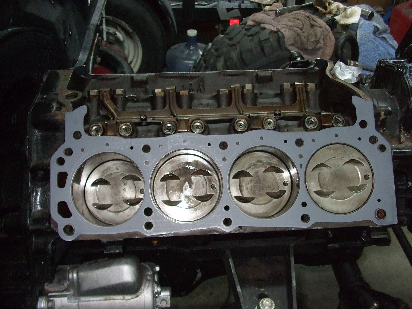

Here is a good shot at the grinding that caused me to have to do this. This should help give you an idea of how much material was removed.
The top lip of another port.
Time to start putting it back together. Right after I wipe off the top of that piston.
