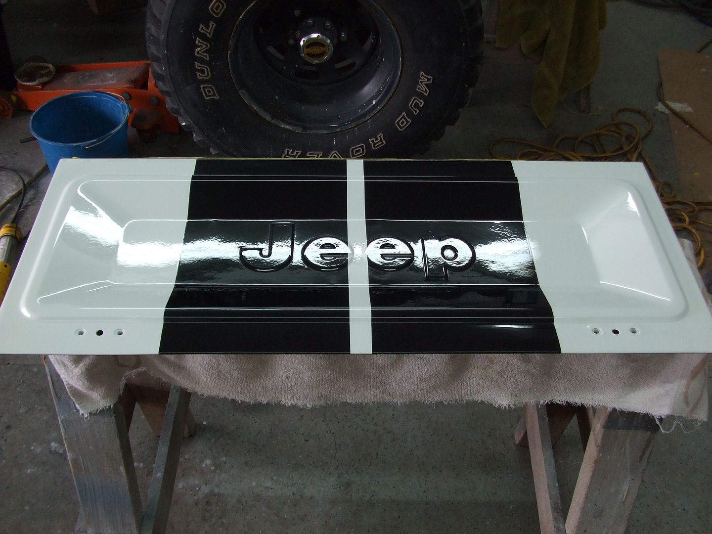

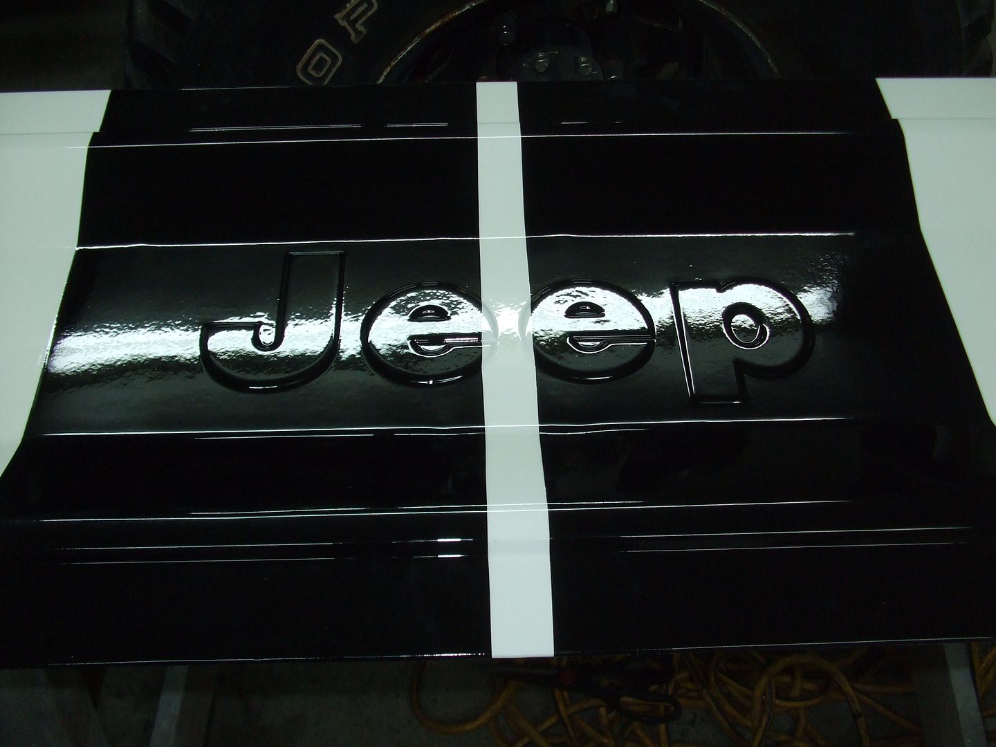

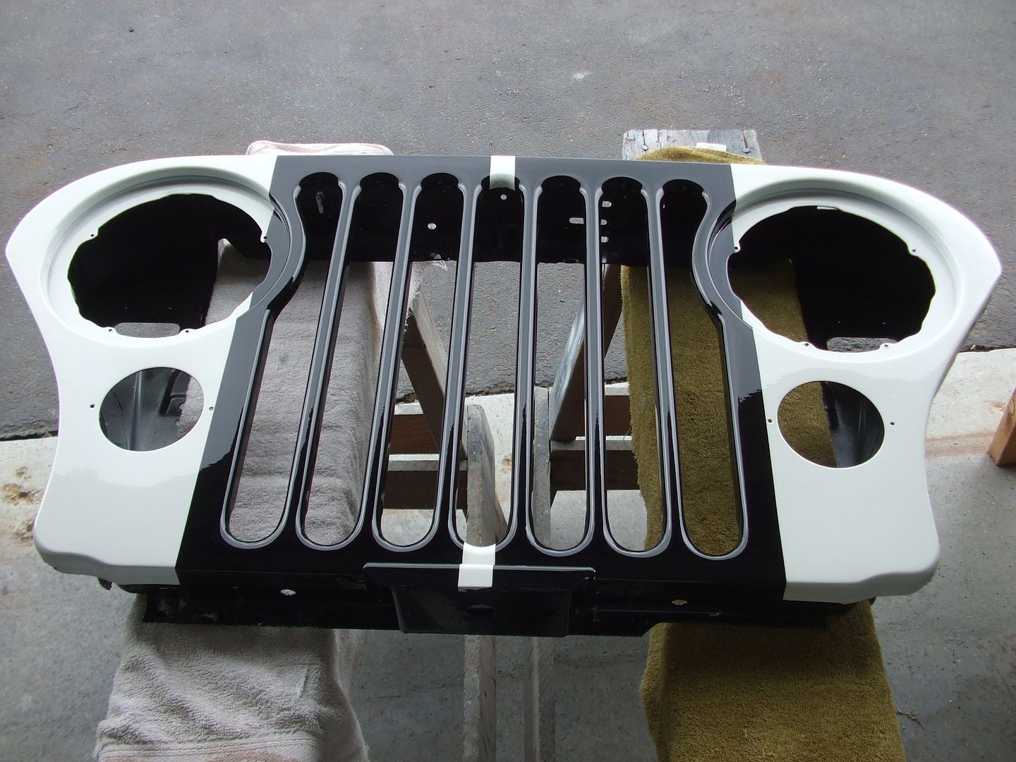

More Buffing
^^^ Thank you for your comments and feedback. Responses like yours are what makes it worth taking all the time to document and post my progress.

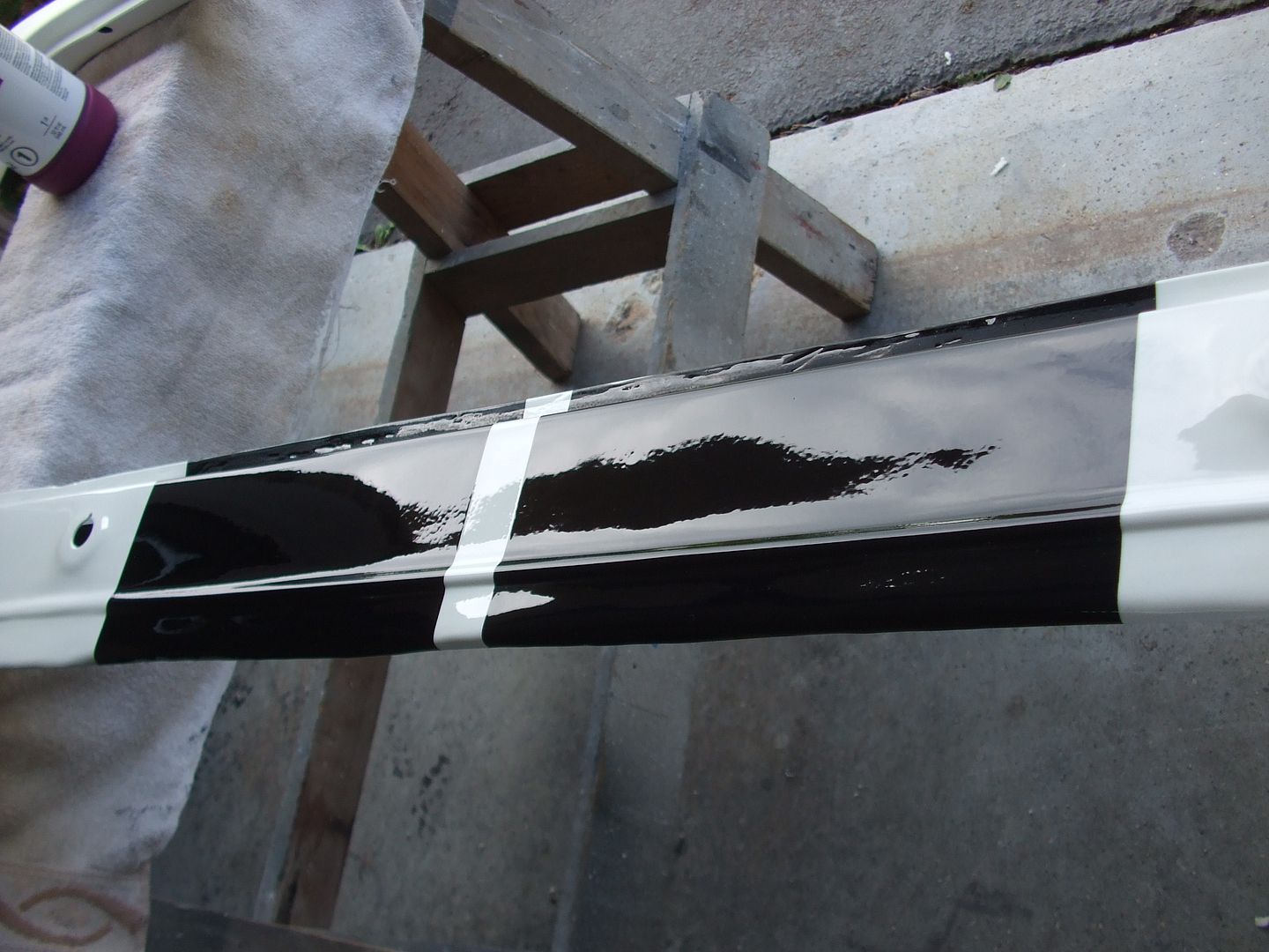

More Buffing

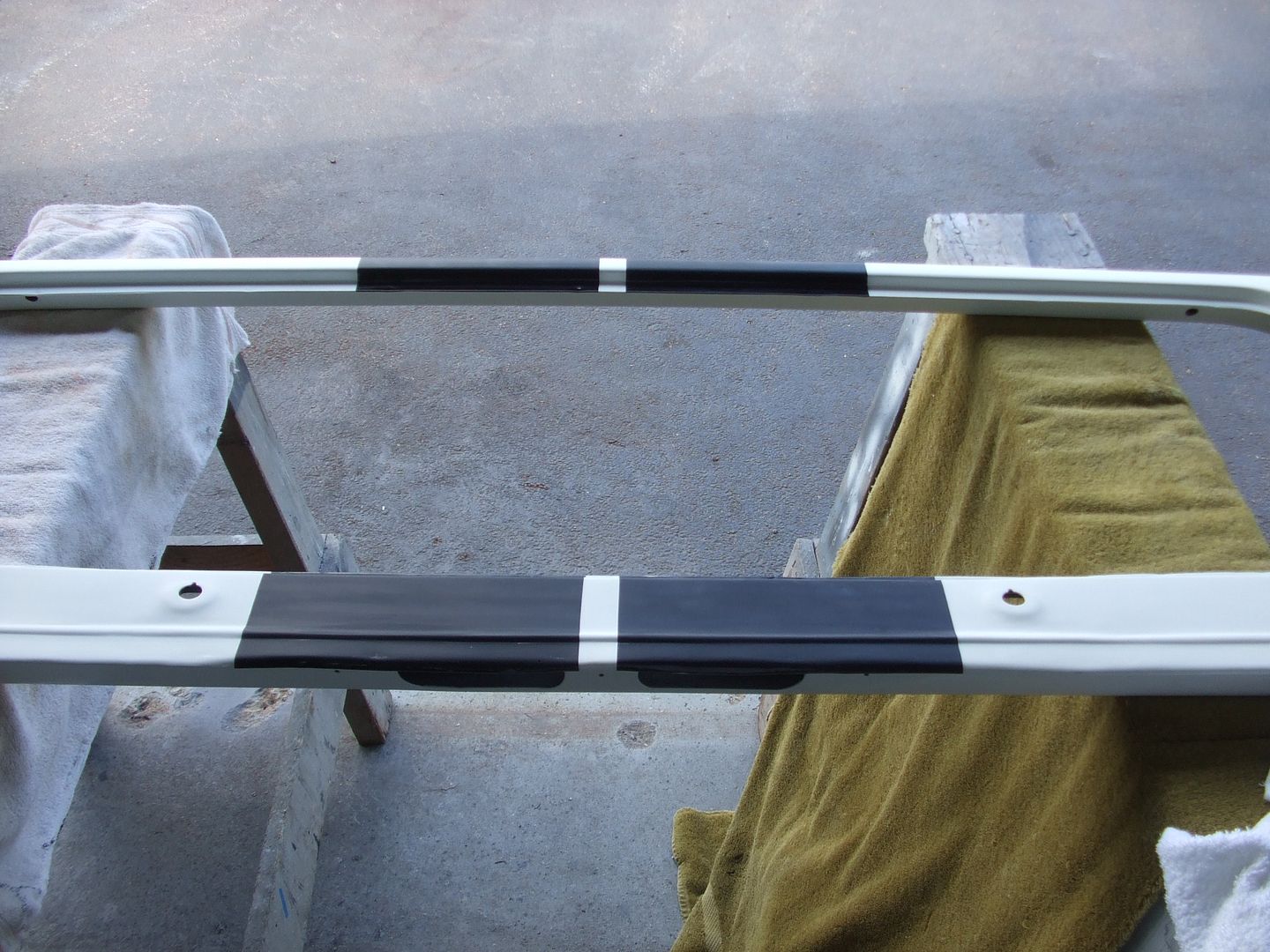

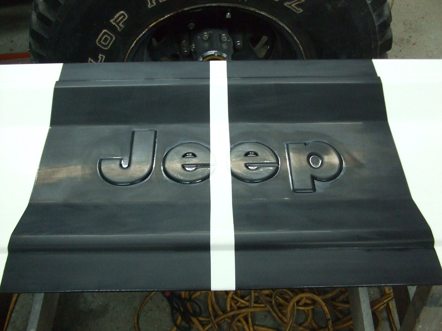

I know you guys have been patiently waiting to see some results from the sanding and buffing so I will go through and give you some before, during and after of all the pieces. Here is the tailgate with the untouched clear coat. You should be able to pick out a little bit of the over spray speckle.
If I was trying to remove a lot of the orange peel from the panel, I would start with 1000-1200 grit sand paper then step up to 1500 and then again to 2000 grit before buffing. If there was not a lot of orange peel and the over spray speckles were my main concern, I would start out with the 1500 or 2000 grit paper. So here is a picture of the tailgate after a once over with 1200 grit sand paper. You can see how it brings out the low spots in the clear coat.

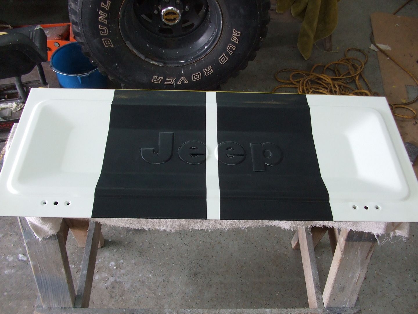

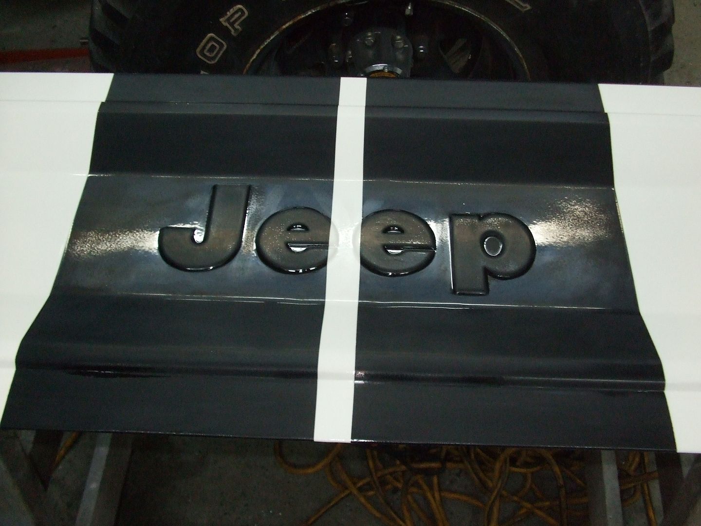

Here it is after a bit more sanding with the 1500 grit. Notice how it is a more consistent flat black now.
The entire piece sanded all the way down with 2000 grit. Notice how dull even the white looks.
Here it is after about 15 minutes with the rubbing compound.
One final picture after being polished with all three stages. This is the final product.

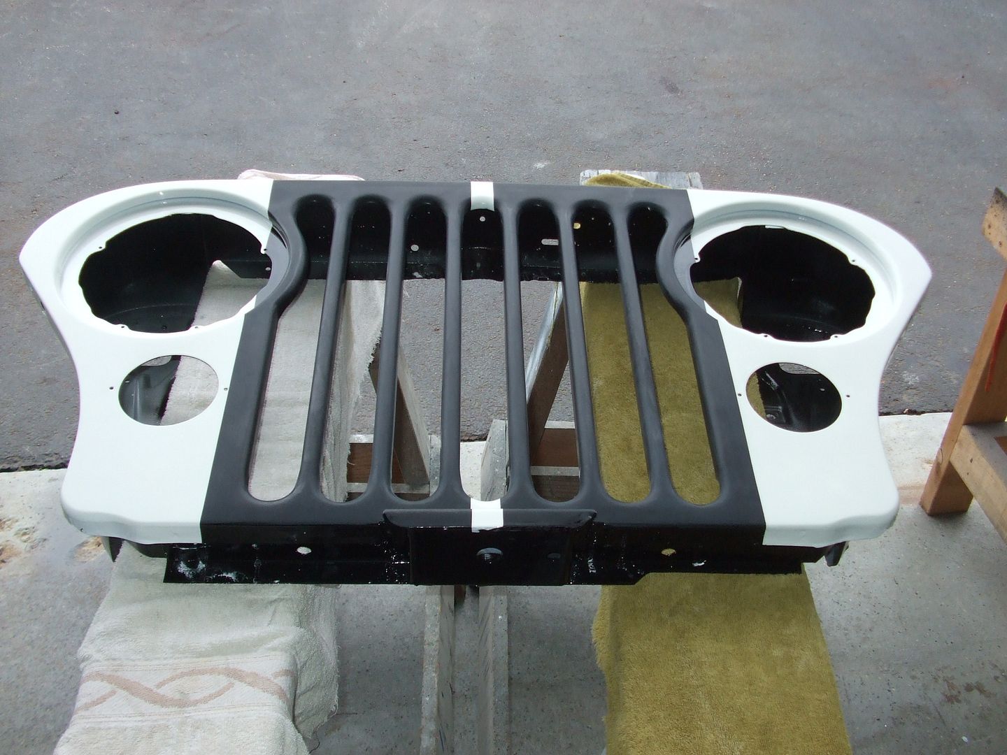

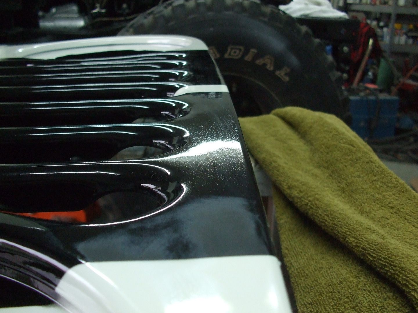

In this picture of the grill you can really see the over spray speckles that I'm having to remove by wet sanding. I almost forgot to take pictures, you can see where I had already started to sand with the 1500 grit.
Here is the entire grill sanded down to 2000 grit.
Here is how it looks after a couple rounds of polishing. No more over spray speckles on that piece.

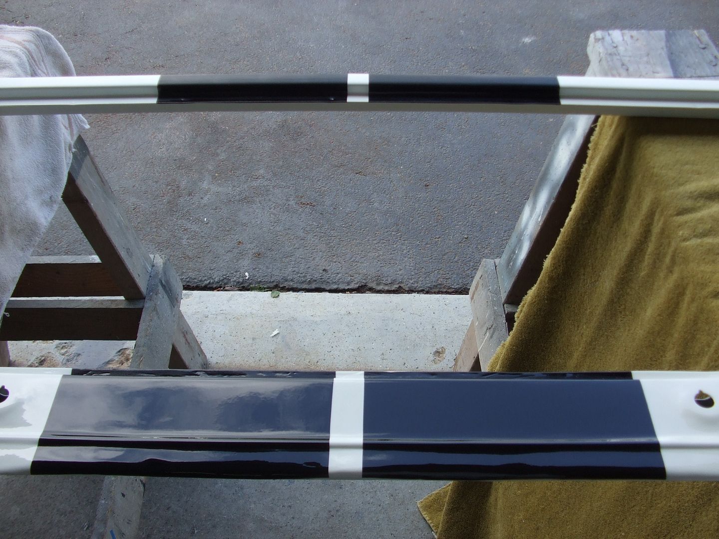

A picture of the windshield frame after sanding was completed.
This is with the lower half polished and the top half still sanded dull.
A close up on the stripes so you can see the lines and how much orange peel is left even after sanding. It was not my goal to remove all the orange peel. My goal was to remove the excessive orange peel and over spray speckle to make it look as good as possible without risking having to repaint it again.
Mike

Good lesson about finishes. I have painted and had orange peel and speckles before, but never knew how to fix it. Thanks for the detailed pics, Mike. I hope you spend your time blowing away GTs from stop-light to stop-light, and never take this thing off-road! It's gonna break my heart if it gets scratched!

Getting rid of the speckle is easy and in turn knocks down a considerable amount of the orange peel. If you ever want something show car glass smooth, plan on sanding it down and reapplying clear coat a couple times over. You have to pace yourself when sanding, the last thing you want to do is break through the clear.

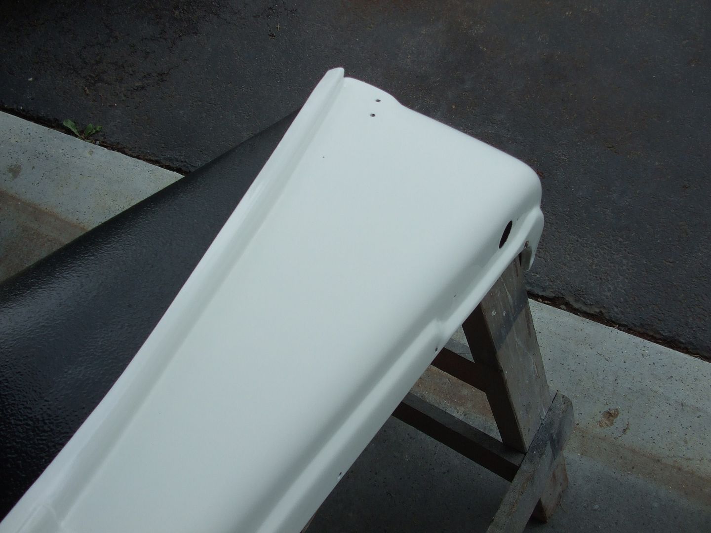

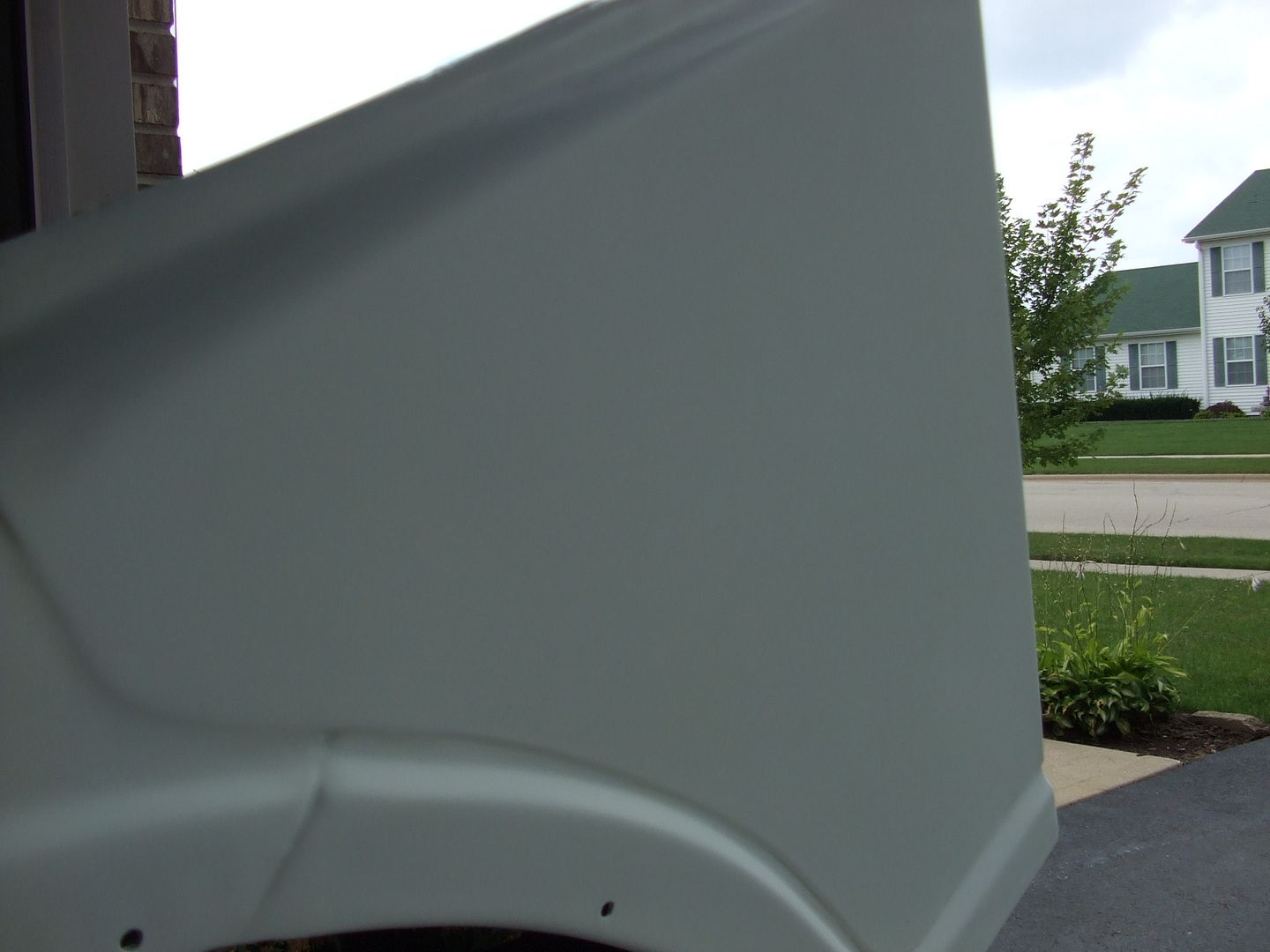

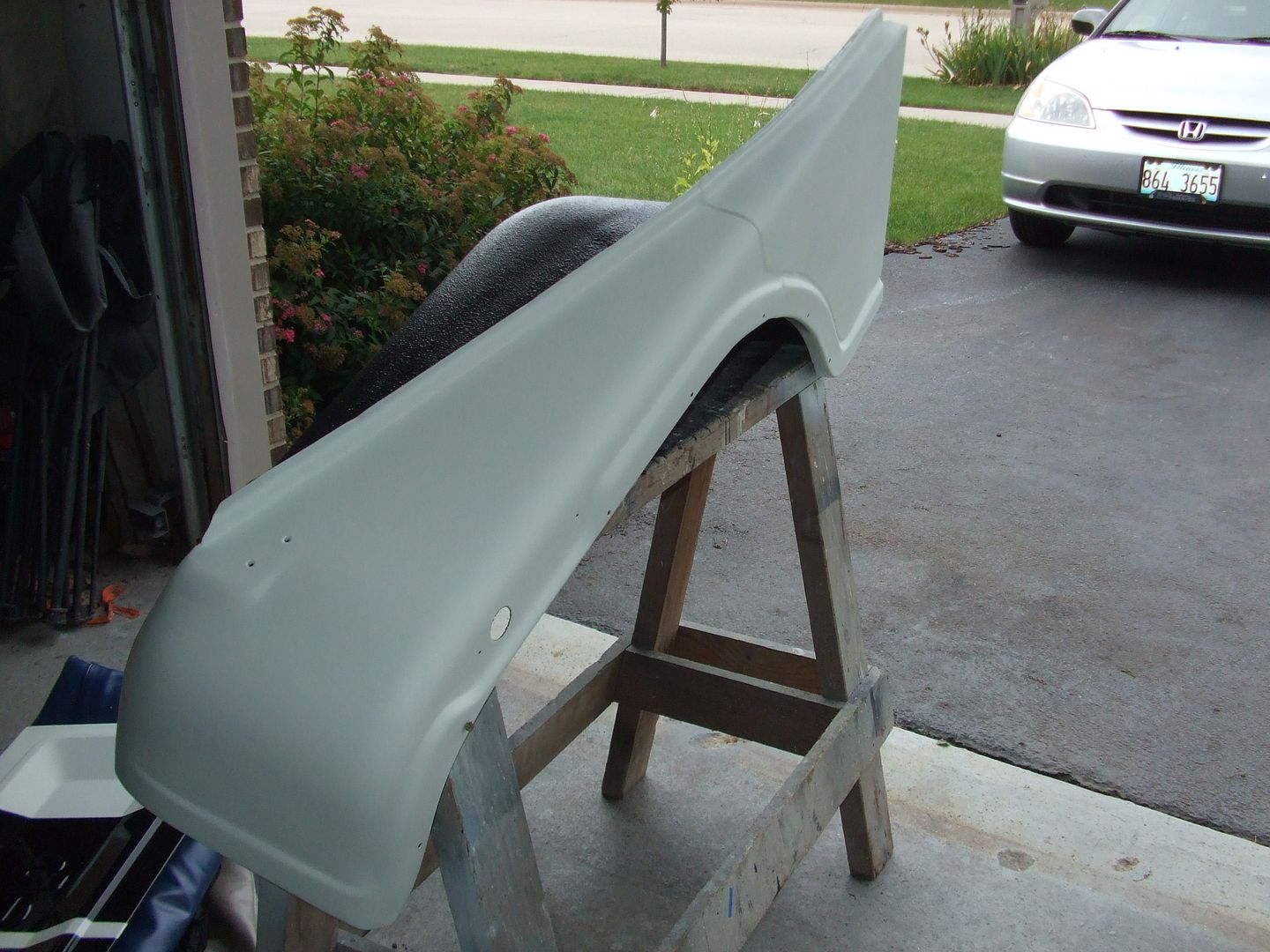

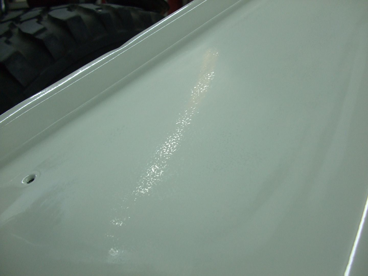

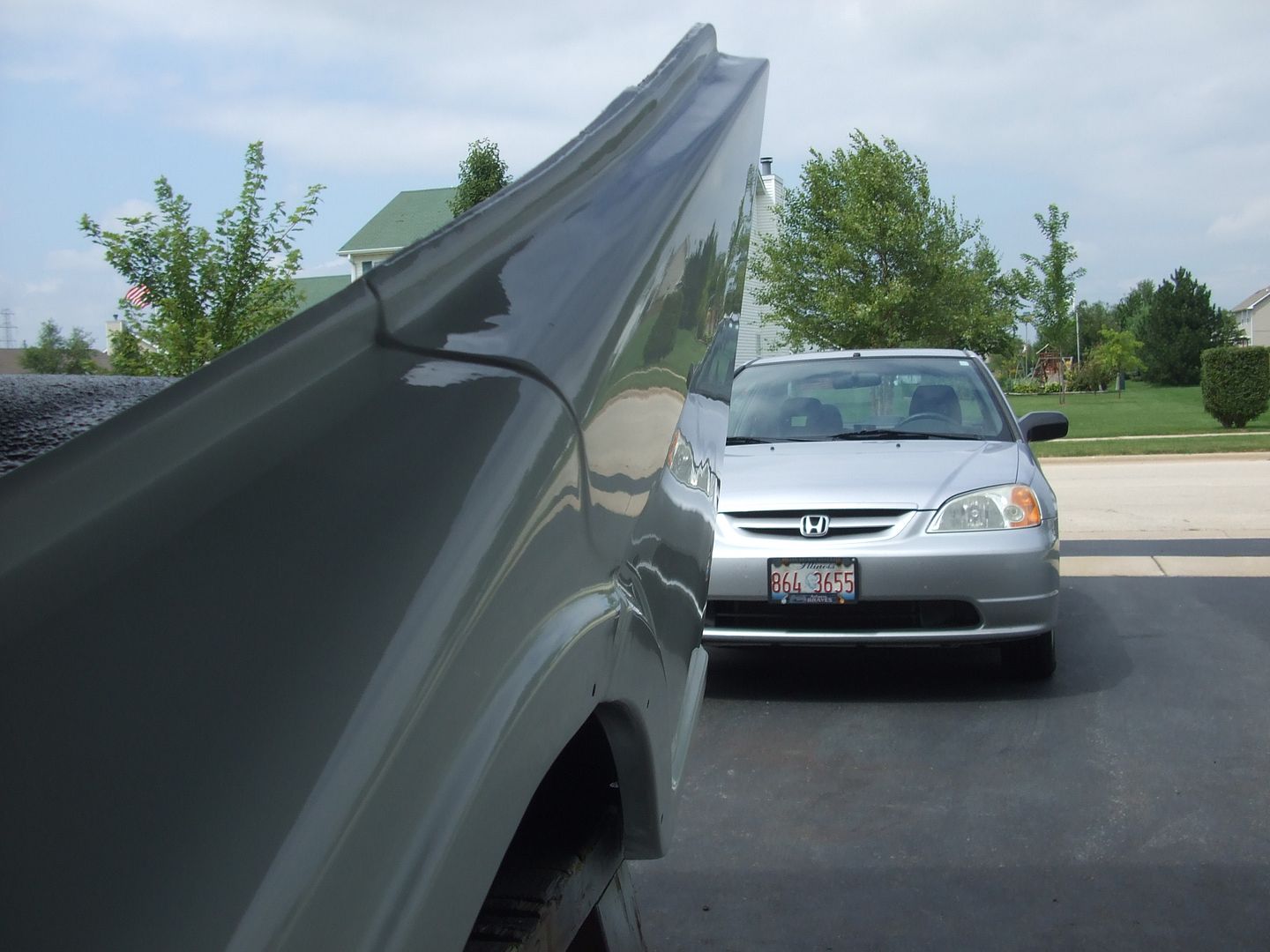

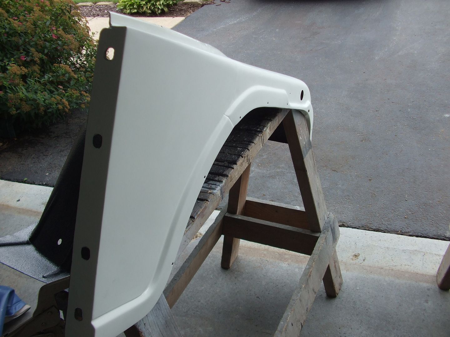

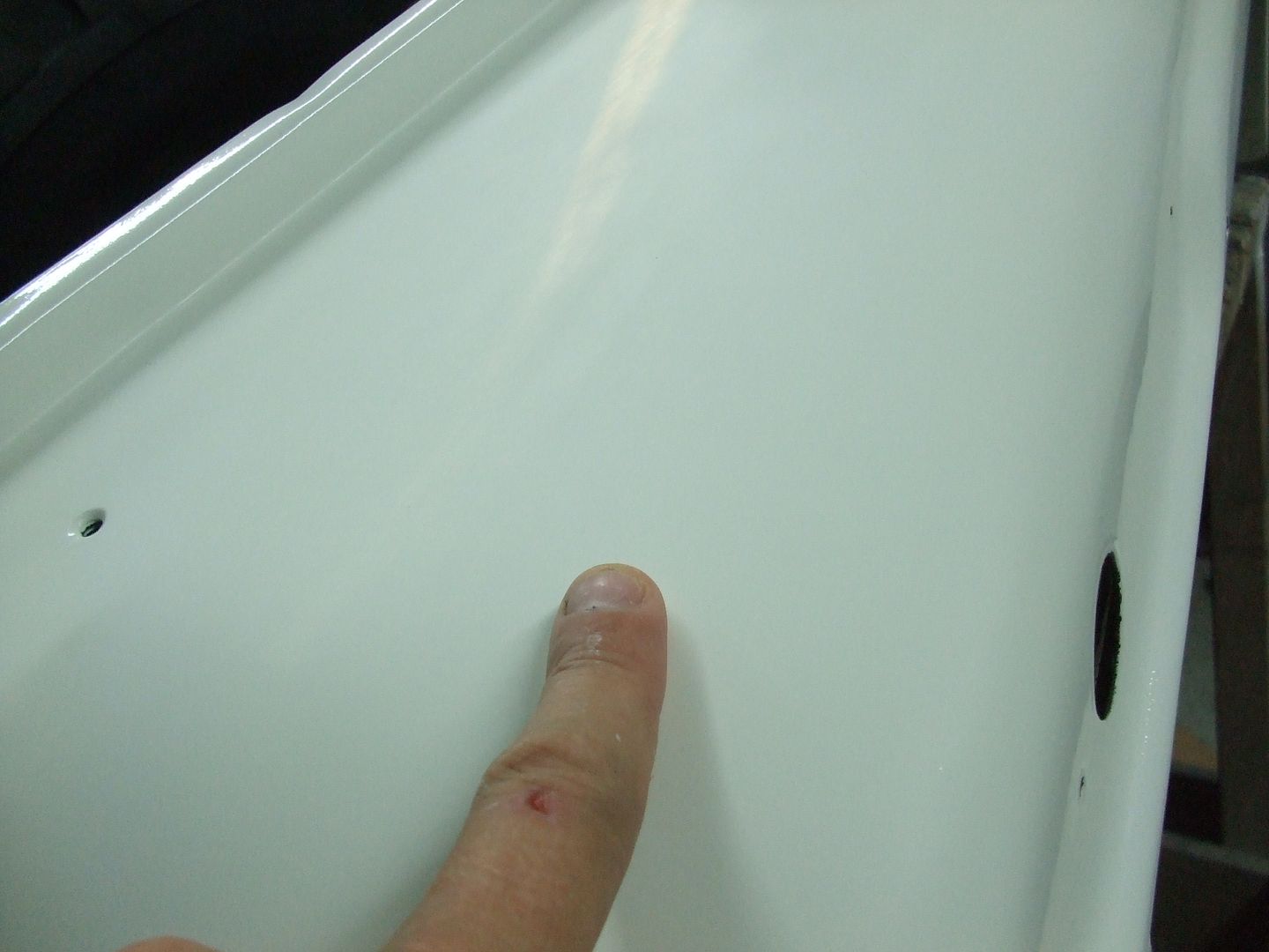

Front Fenders

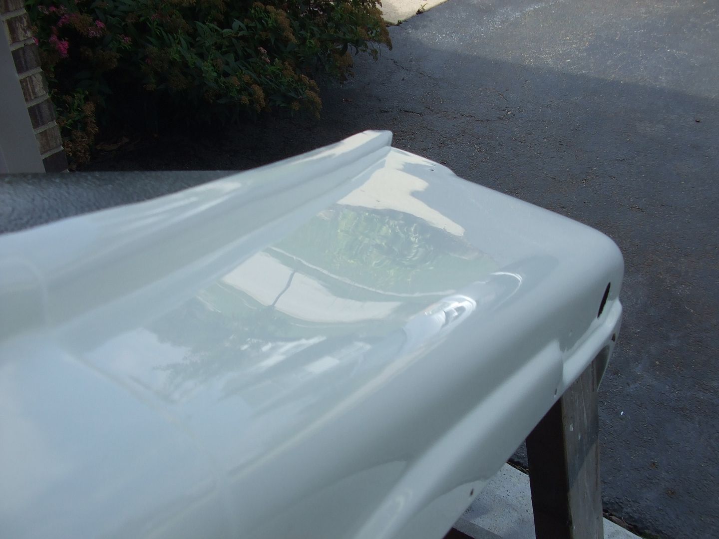

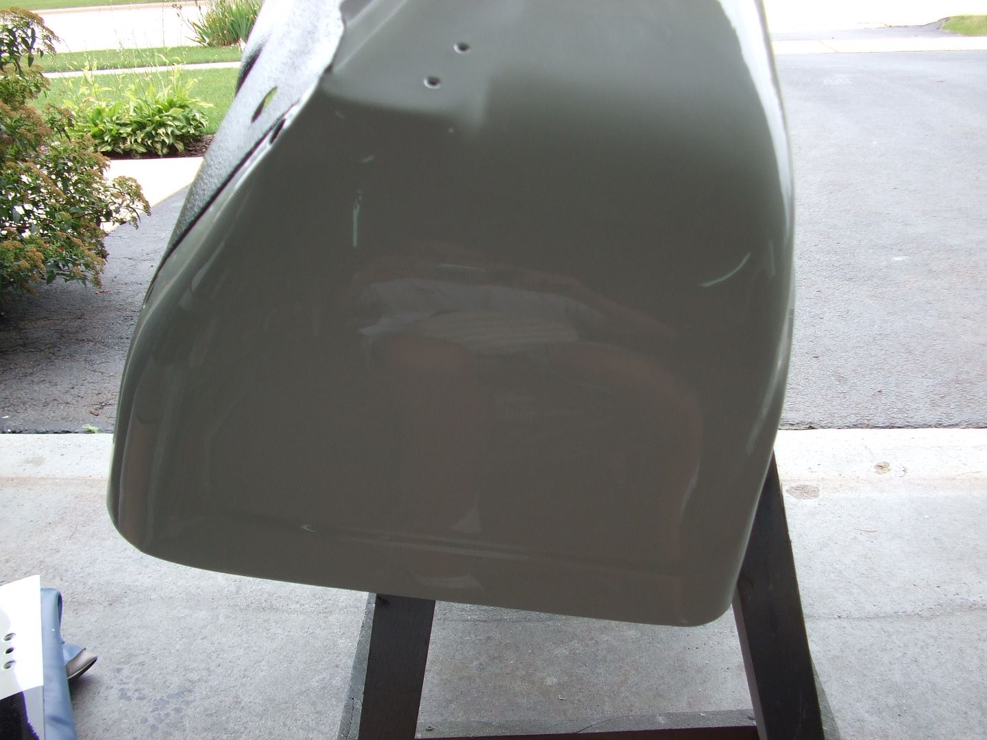

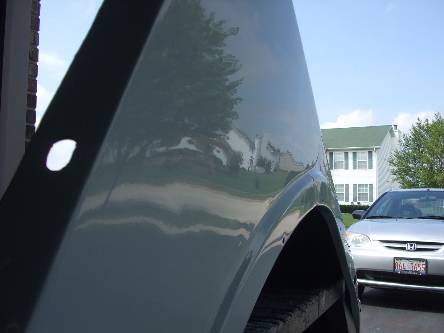

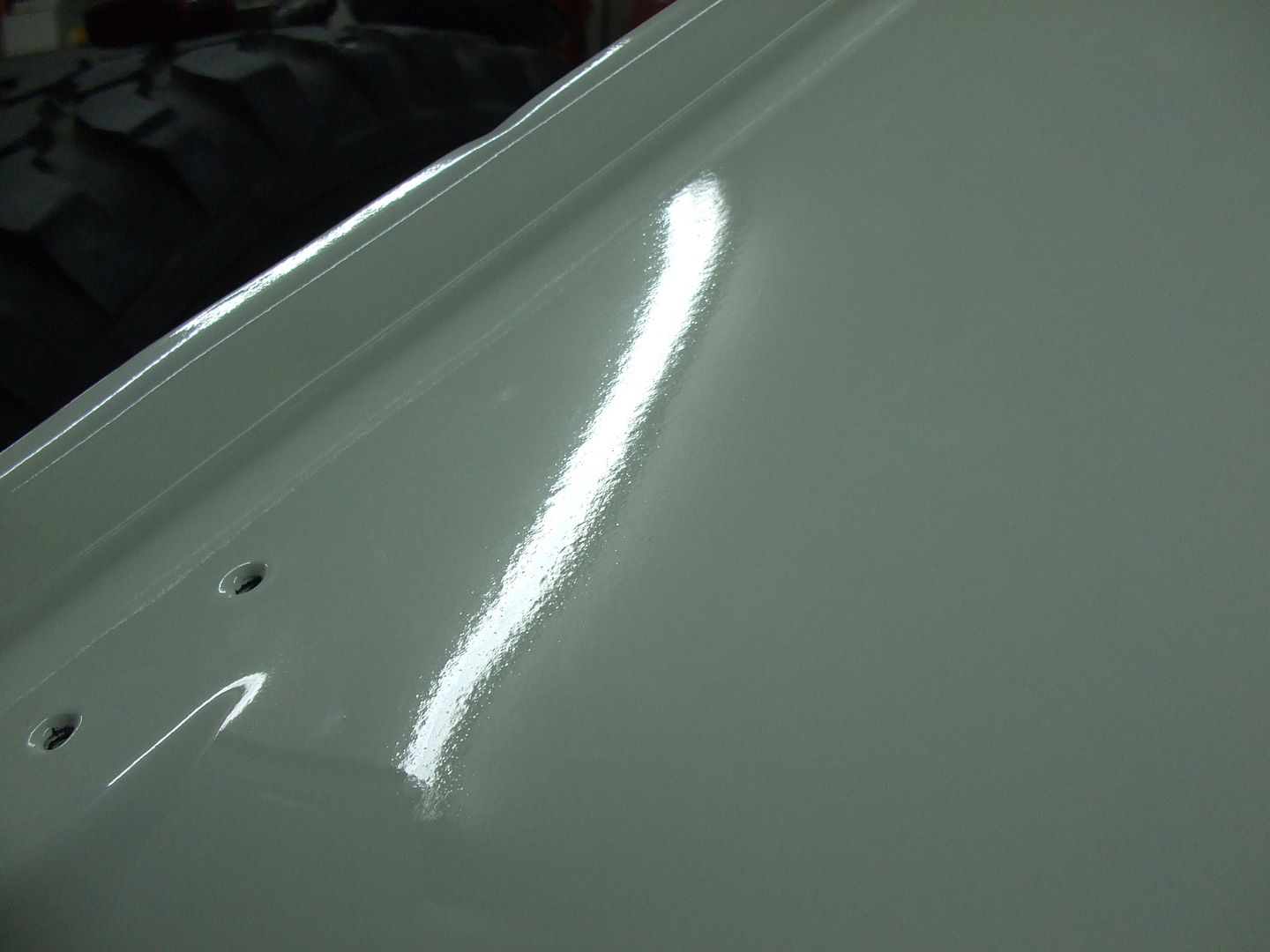

Here are some before and after of the front fenders. Here is a picture of the driver's side clear coat finish. As you can see, even painting inside a booth will not eliminate the orange peel, over spray and dirt. They are all just greatly reduced.
Sanded with 1500 grit you can still pick out a lot of low spots in the orange peel.
Sanded down to 2000 grit has a consistent dull.
It looks like it's never been sprayed with clear coat.
One more showing zero reflection is left.
Here it is after a bit of buffing. Can you pick out the skinny white guy holding a camera with a polisher in his lap?
I haven't finished buffing the fenders with all three stages so they are not quite as shiny as the rest but you can already see the difference after buffing.
One last picture of the top surface, you can really see the difference in how smooth it is as compared to the first photo.

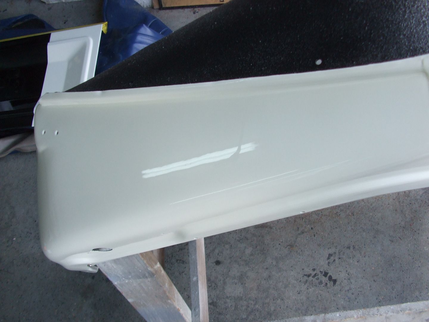

Here is the passengers side sanded down.
One more showing the top of the fender.
Another one after some buffing.
You can see this section doesn't quite have the level of gloss as the rest so it still needs a little more work.
I only hit the fenders with the rubbing compound and will hit them with the final two stages once I get closer to putting them on. I'm just trying to space out some of the tedious work when I can. I think the pictures of the tub will reveal the true testament of the 3M three stage Perfect-It System. I'll try to post them up in a bit. Time to dough in on 12.5 gallons of American Wheat.
Mike

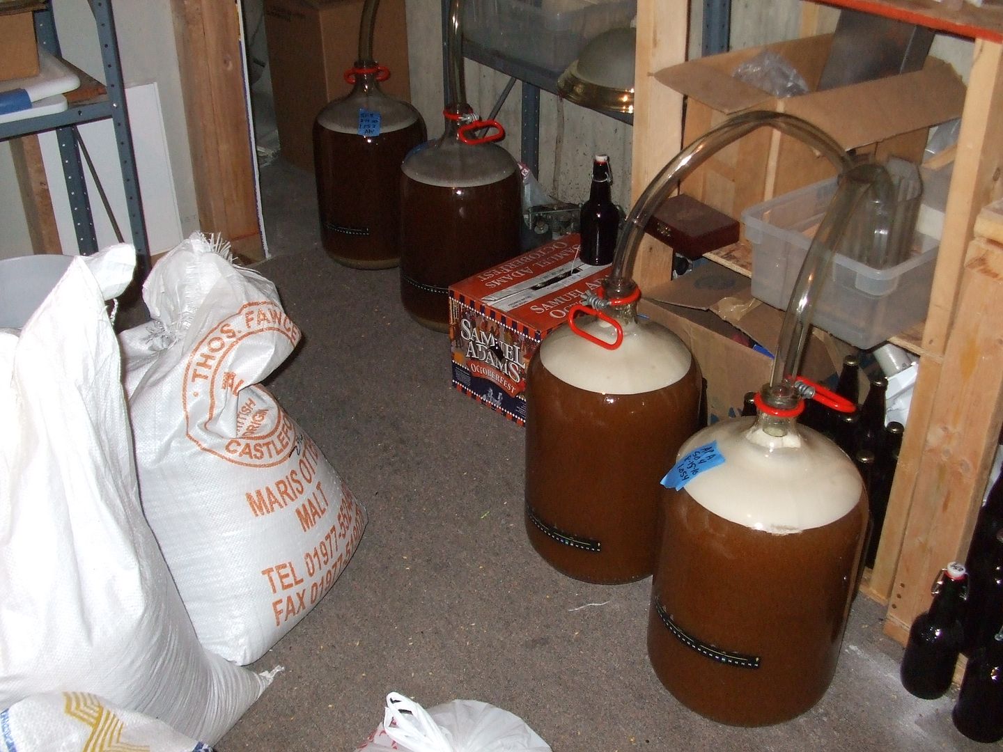

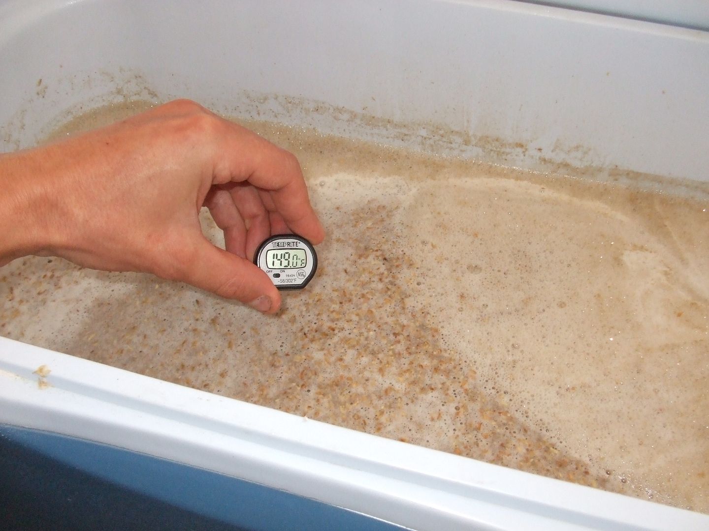

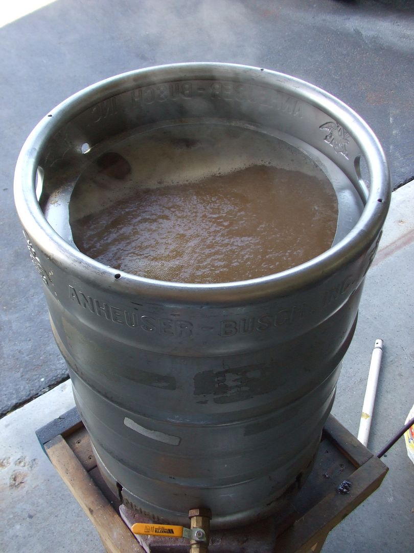

I mashed in 10# of 2-Row and 10# of Wheat at 150 degrees. It held to 149 after a 60 minute mash. The ~150 water activates the enzymes in the grain which turns the starches into sugar. That sugar is what the yeast eats to make alcohol and CO2.
Here is about 14 gallons of wort that has been boiling for 10 minutes. I just added 1oz of Northern Brewer hops and started my 60 minute timer for the boil.
Mike

The American Wheat got an ounce of Centennial hops at 10 minutes and another at 0 minutes. The brew went pretty well and I hit my standard 82% efficiency.
Call me crazy but while the first batch was boiling I started mashing another one. This beer is a an American Pale Ale with Magnum, Columbus, Simcoe and Amarillo hops. Should only be around 60 IBU.
A friend stopped by for a beer and to see how the brewing was going. While talking about the Jeep, the build thread came up and he asked if all of you knew what I looked like and I told him no. Well, here I am after almost nine hours of brewing 25 gallons worth of beer. Not my best picture but...
It was a long day but at least now I have some beer in the works for my fridge. Here they are in the utility room with the yeast pitched and blow off tubes. It will be at least another 3 weeks before they are fermented, kegged and carbonated.
Mike
