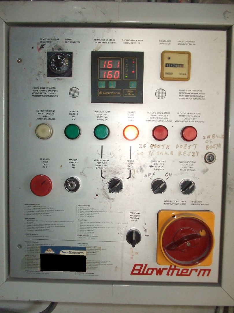

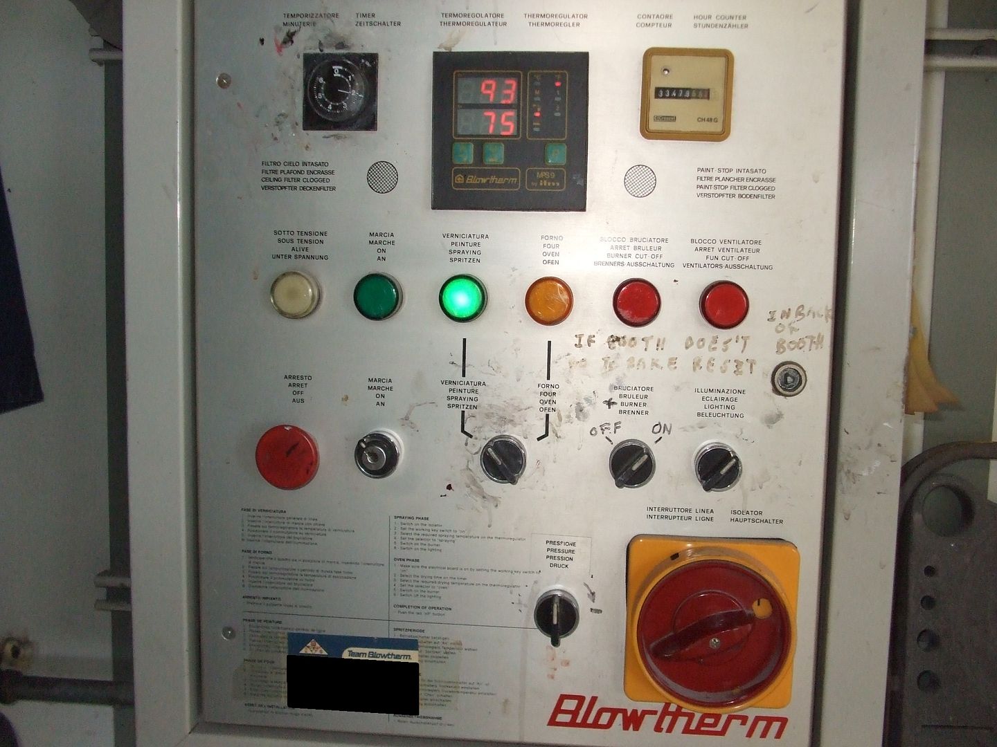

Paint Booth Oven:
I thought it would be kind of cool to give you a few details about the paint booth for those of you who have never been exposed to one before. Here is a picture of it in spray mode, notice the green light. This means the internal fan is on and you can spray at any time. Note the two temperature readings. The bottom number is the set temperature of 75. The top number is the actual booth temperature. Since it is only an oven and not an A/C that means I was painting at 93 degrees inside the booth with the fans running.

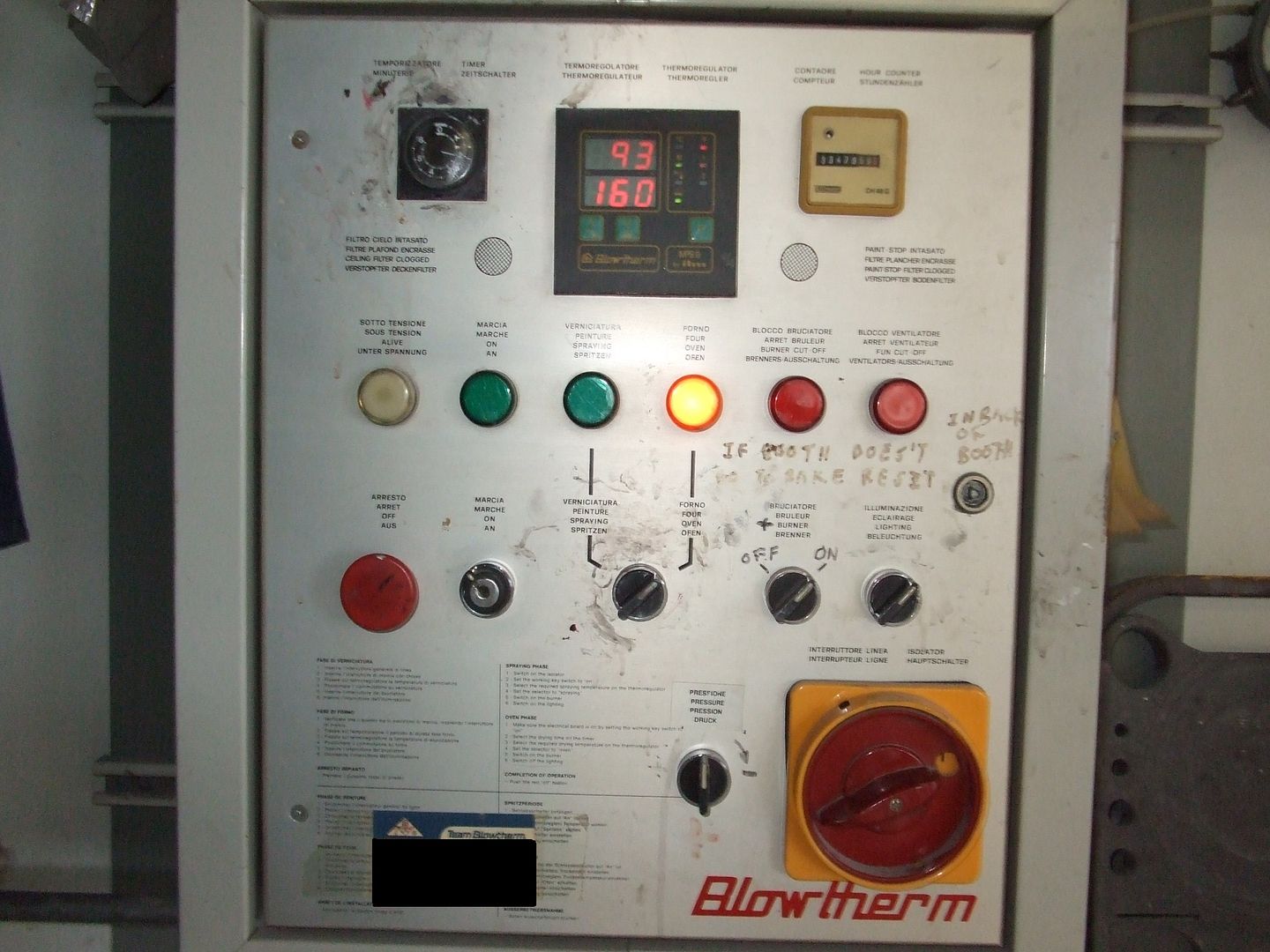

Here is right when I turned on the oven, notice the yellow light instead of the green. The set temperature is 160 degrees for baking. Also notice the small timer in the upper left, that is set to 2 which equals 20 minutes.

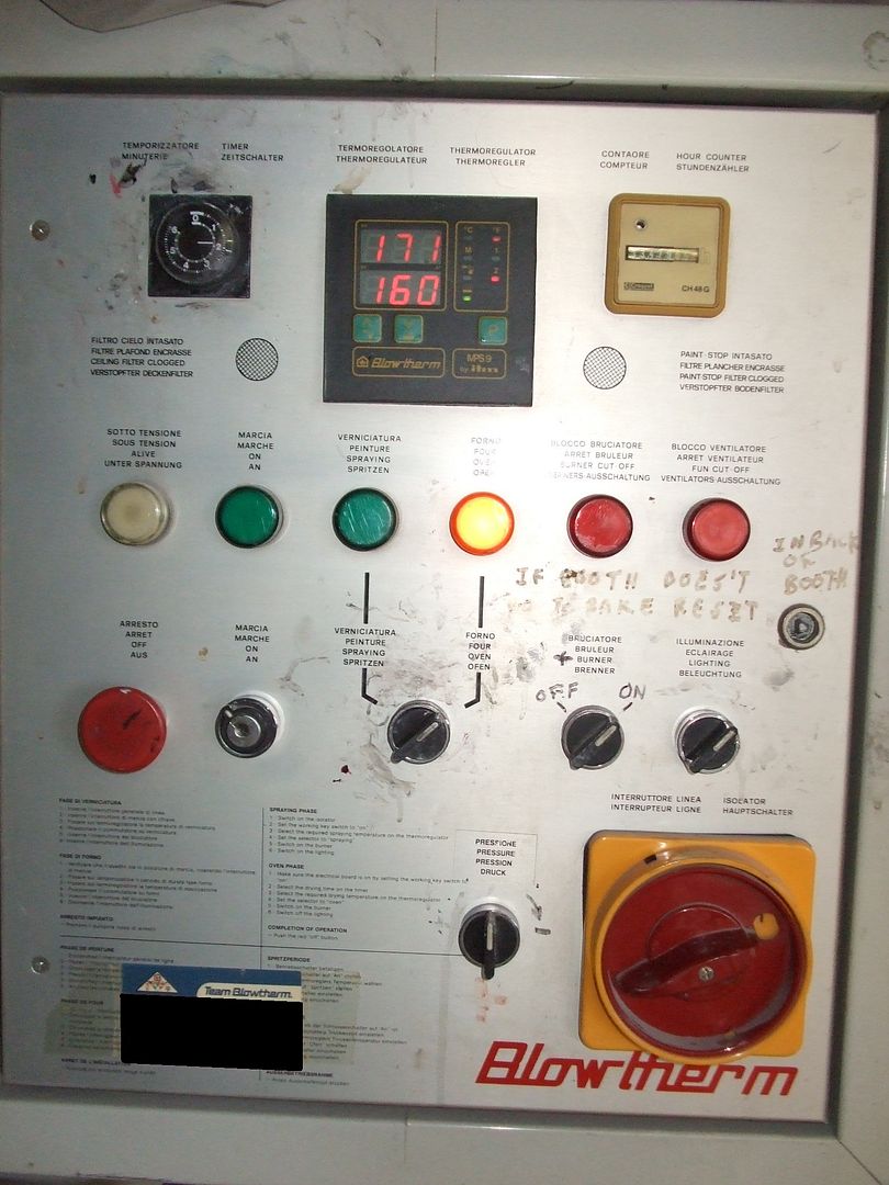

Notice the timer is now down to 18 minutes and the oven is already at 171 degrees. That's what you call some serious BTU's! Right now your thinking, if its set to 160 degrees than why is it at 171 degrees? The reason is because there is a buffer built in on the expectation that the car or panels inside the booth are going to absorb that initial heat.
In this last picture you can see the timer is at 16 minutes and the booth has stabilized at ~160 degrees. It stayed within one degree for the next 16 minutes. I would have to say it was pretty impressive at how fast it worked.
Once the timer was up, the oven shut off and the fan continued to run to pull the temperature back down. I walked in there around 120 degrees to take a look at the parts and they were pretty darn warm to the touch. Even though the baking process helps evaporate the solvents and the hardeners to cure, the paint is still considered soft. So it is safe to handle but you want to be pretty careful with it for several hours. I opted to let most of the parts sit overnight and picked them up the next morning. I hope this provides a little insight into paint booths for those of you who have never had the chance to see one.

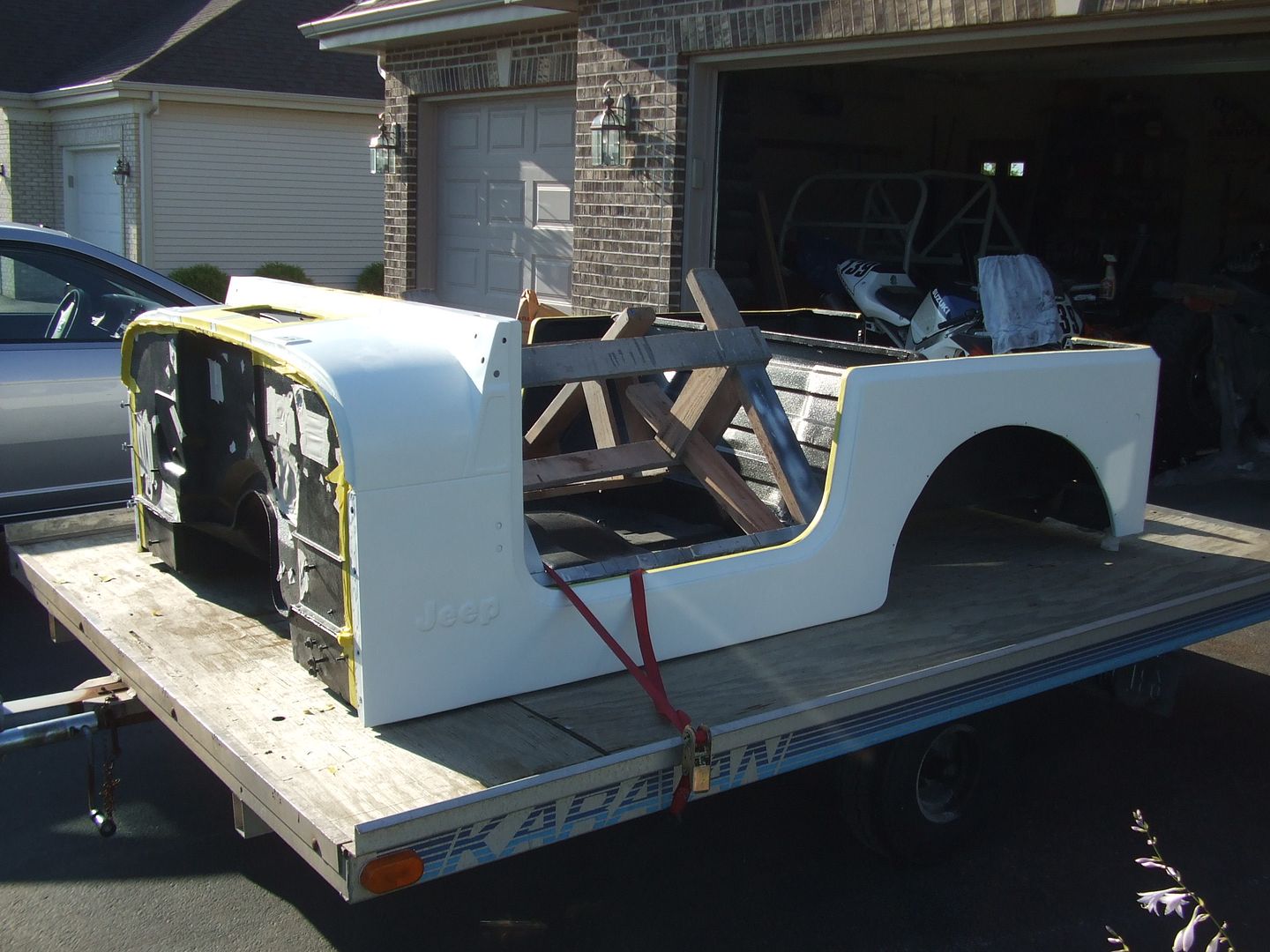

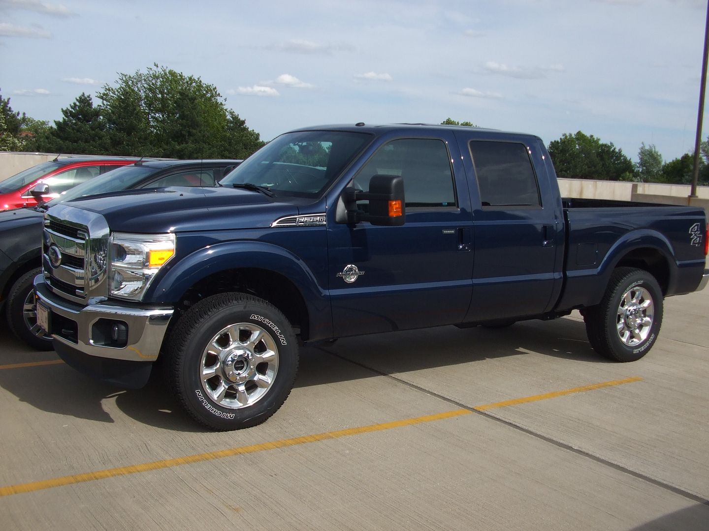

I took all the pieces back and forth to the paint booth with my Truck, yeah that's a capitol T. I'm currently driving a 2011 Lariat F250 6.7L Diesel Super Duty, it's a hoss and I love it. Currently averaging almost 19 mpg overall and it's not even close to being broken in with only 4000 miles. Here's the day I picked it up. 390HP 735lb/ft of torque.
I made two separate trips to the booth. The first time the roll bar was on my 5x8 tilt trailer with the rest of the parts in the bed or the cab. The next time I borrowed a 7x10 flat aluminum snow mobile trailer to haul the tub and the rest of what I took was in the bed or cab again. Here is the tub at 7AM just before heading to the booth.

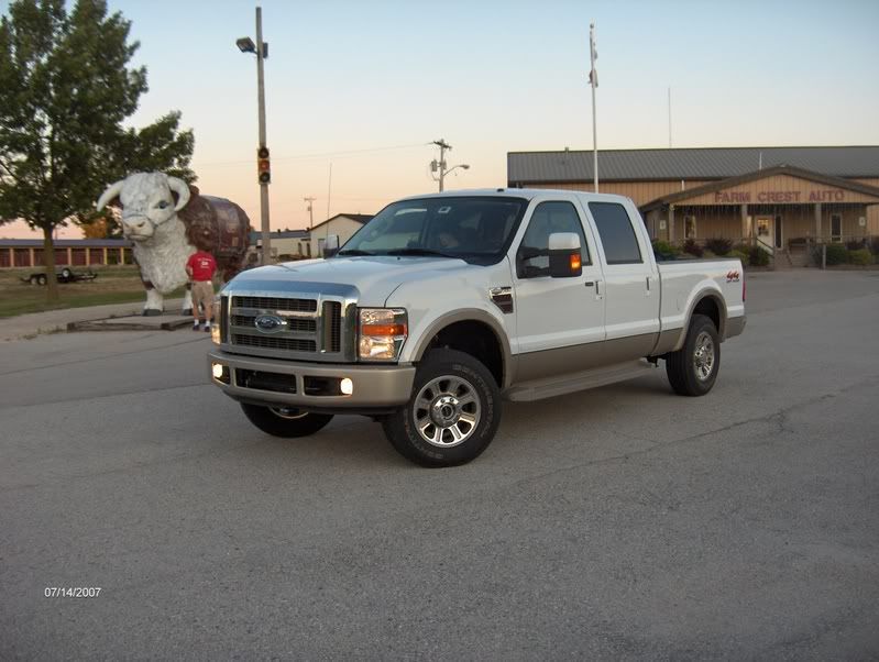

I had an 08 F250 King Ranch with the 6.4L and would average around 16.4 mpg in that truck. I probably do 80/20 highway/city driving. I really like the white and tan two tone King Ranch edition and the leather interior is really nice. That was a sweet ride. Look me up when it comes time for a new one and I'll hook you up with the X-Plan. This is when I had a friend come up from Memphis to ride our bikes at Road America. He wanted to take pictures of himself with every big cow statue we saw in WI. I think we saw seven or eight of them over the weekend.
