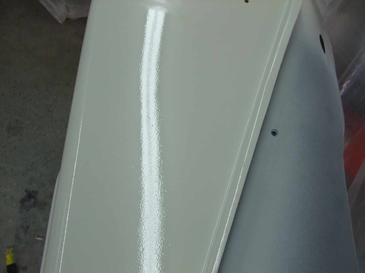

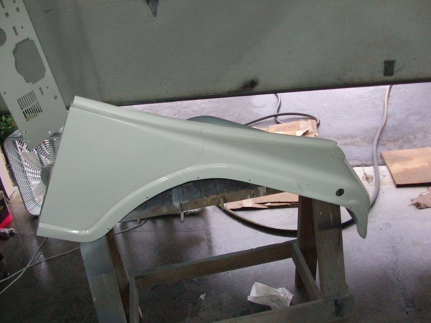

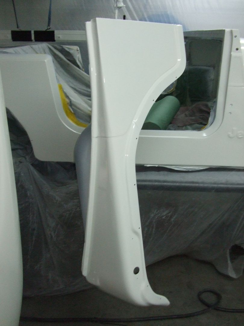

The passenger's side fender was a little glossy after the first coat.
The driver's side fender was also looking pretty good after the initial spray.
I put a coat on the hood and then one on the grill.

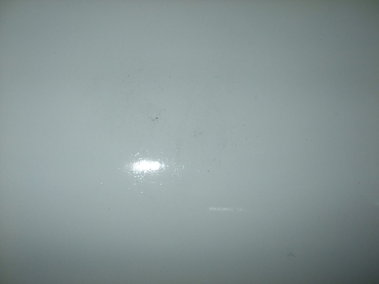

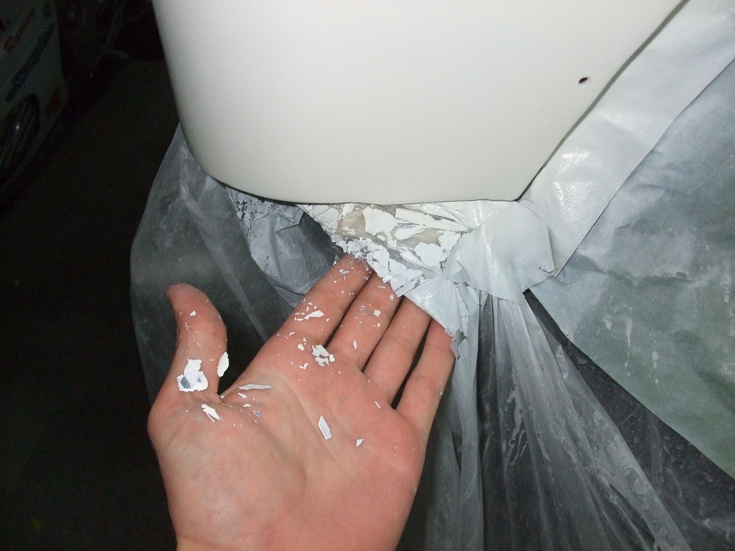

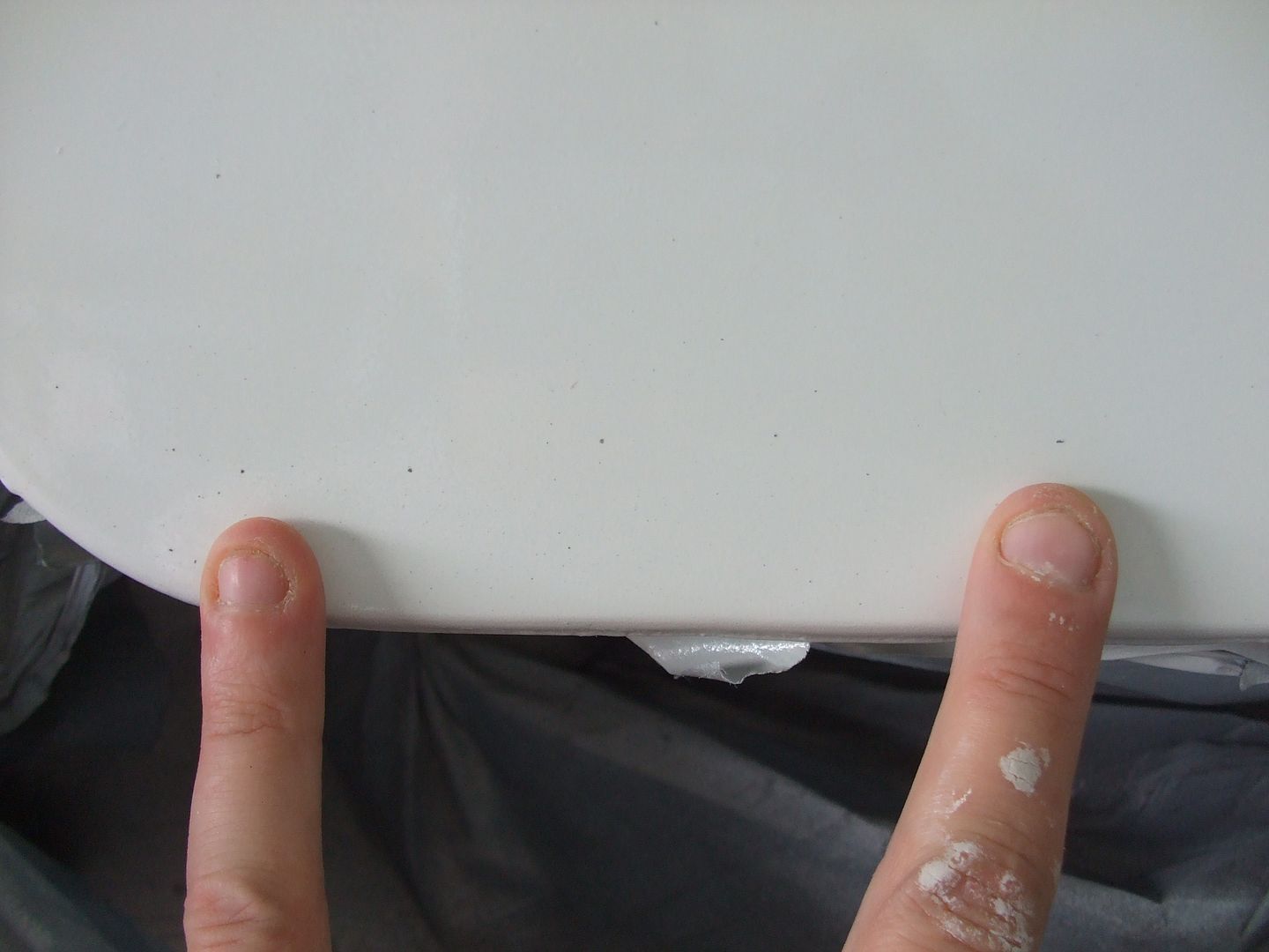

This is where the problems started to arise. Since all of the parts were so close together, I accidentally backed into the freshly painted hood while spraying the first coat on the tub. This left a nasty dirt print on the side of the hood. Here is a close up of the spot. This entire picture is just a little bit bigger than the palm of my hand. Also notice the little piece of hair in the lower right corner.
Knowing I couldn't do much about the dirt print on the hood I finished the coat on the tub. Only after I was done did I notice all the other specs that were getting kicked up onto the lower edge of the tub.
All of those specs werenít coming from dirt in the air or off of the floor, it was getting kicked off the plastic I had used to mask off the Raptor on the tub before I started painting.
That is the same plastic I had applied before I sprayed the primer, wet sanded and then painted the white. The air pressure from the gun was flaking the paint off the plastic and putting it right into the clear. The lesson learned here was to apply new masking before spraying the clear. Hopefully this will keep someone reading this from repeating my mistake. After going back and looking at the passenger's side fender, I noticed quite a bit of dirt in the paint. I think this was from trying to do too much at once. You really need to spray a coat and leave the area rather than moving around to work on other pieces right next to it. I wasn't worried about the orange peel because the first coat was sprayed light intentionally but the amount of dirt was simply unacceptable so at this point I quit spraying and had to come up with plan B.
I had to let the parts cure before I could do anything with them so disgusted with the results, I gave up for the day. The next morning I started taking a closer inspection of all the panels which revealed I had quite a few of those little hairs, the one I noted in the hood dirt print photo, were in just about every piece I had sprayed. It took me a little while to figure out where these came from but I eventually determined the hair was fibers that had came from the inside of the sweatshirt I was wearing while painting. Lesson learned here was to wear lint free clothing.
If that wasn't bad enough, here is where another wrench gets thrown into the scene. Since I had only sprayed one light coat, it was pretty easy to sand most of it smooth with some 1000 grit paper. I tried to only sand it enough to remove the dirt specs but in some places I broke through the clear and into the white. Since my first few coats of white were Oxford and the main color is High Performance, a few of the spots I had to sand pretty deep to remove the dirt and got all the way into the Oxford white. So now I had a few areas that needed to be touched up with more HP white. More work, more time, more headaches and more heartbreak. I took pictures of this but there is not really a lot to see. I had to tape off the black, air brush the spots with white and scuff them up before shooting more clear. Before I wanted to attempt the clear coat again I had to either come up with a better procedure to only spray a few pieces at a time or a better place to spray. So my first attempt at clear coating the Jeep was an, in every sense of the currently overused term, "Epic Failure".

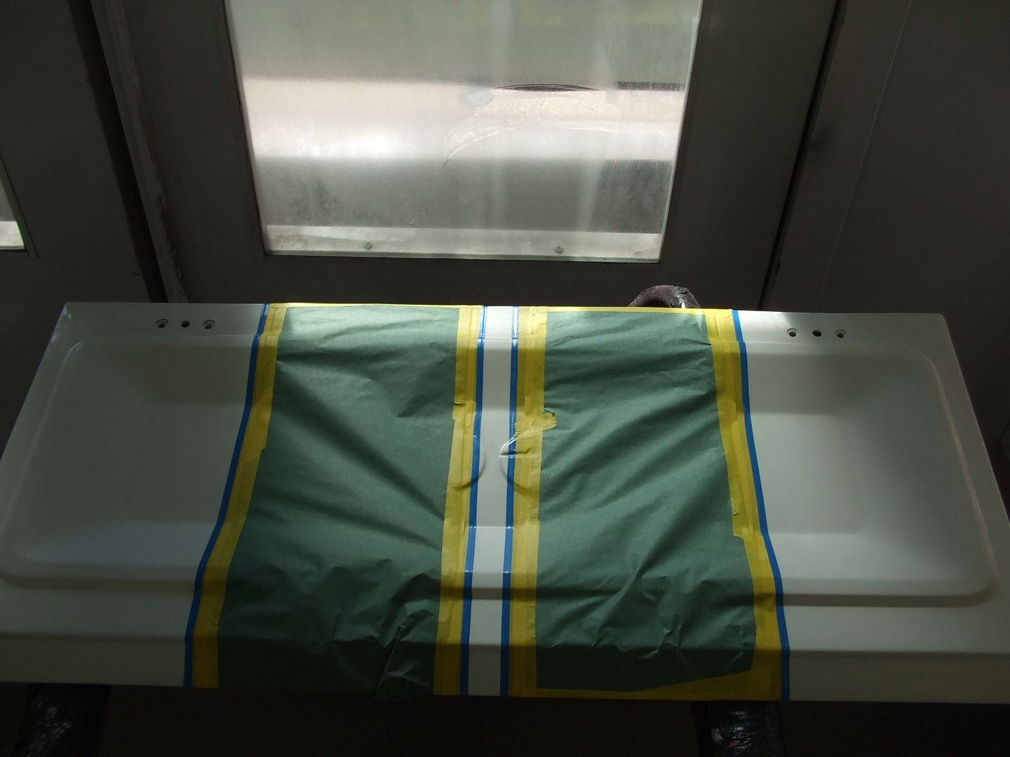

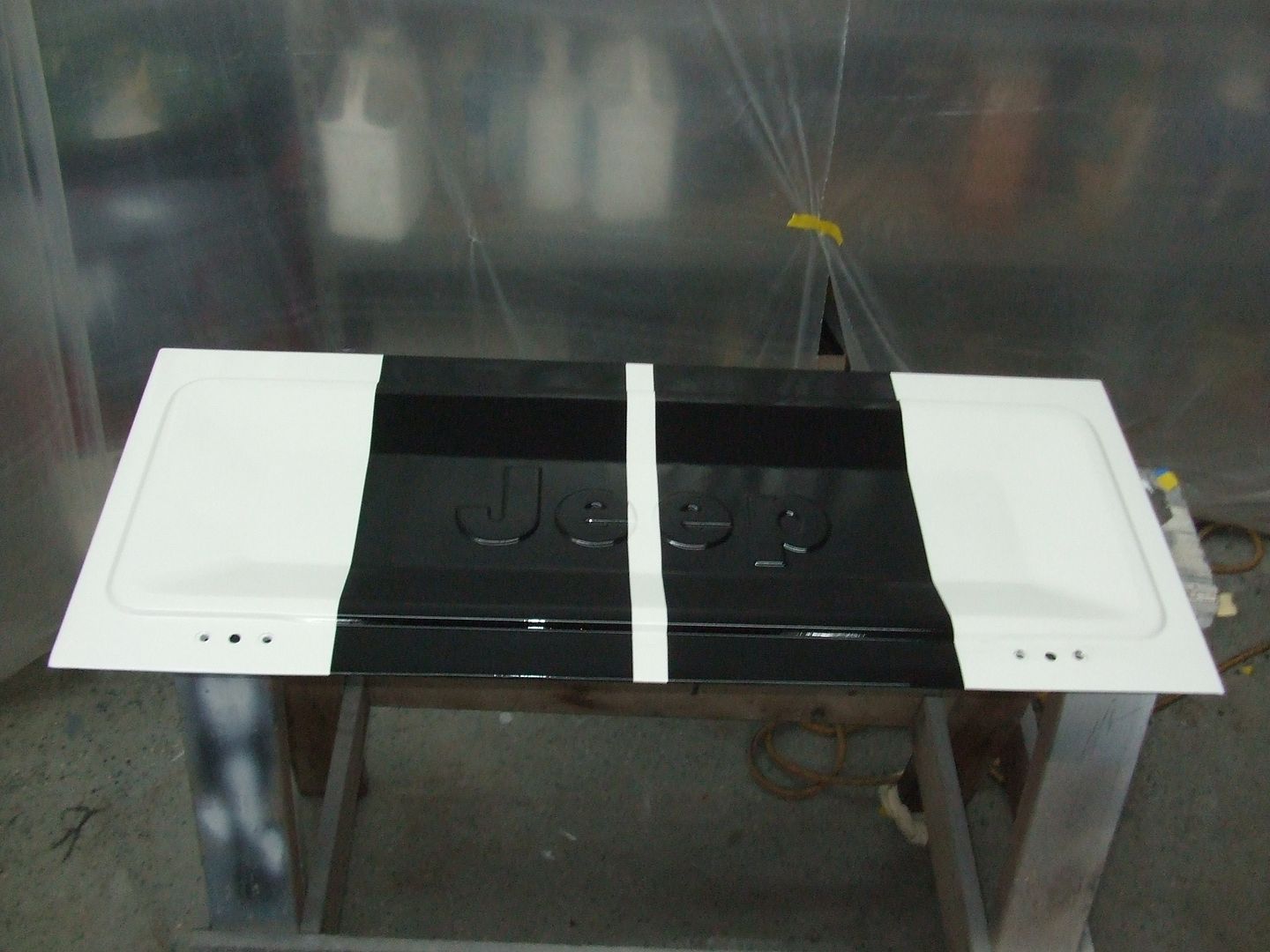

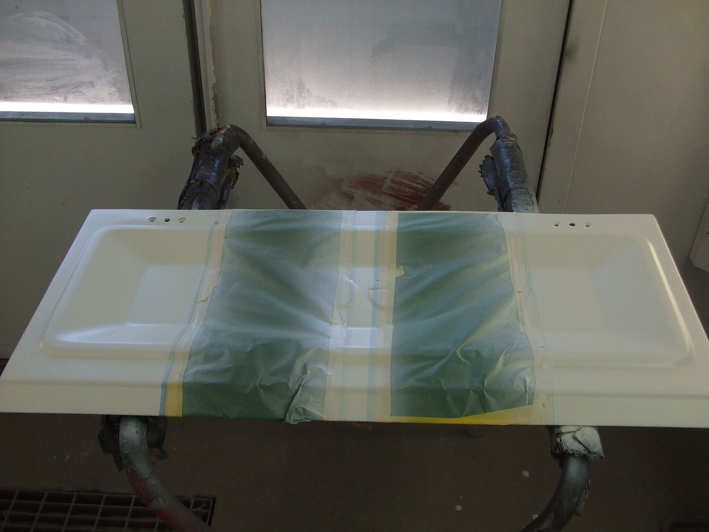

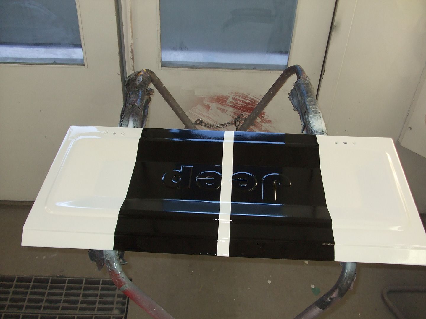

Through a couple contacts I was able to work out a smoking deal to be able to use a paint booth for a day. I started with the tailgate again. The clear coat that went over the black looked fine so I just scuffed that up with a gray scotch bright pad. I had sanded the white sections a bit more with 800 grit until they were smooth. I taped off the black and hit it with pre-clean and a tack cloth.
Here is how it looked after I sprayed it with two more coats of white.
I waited for it to flash off then removed the paper and shot it with two coats of clear coat. I would have to say the lines came out awesome, especially around the letters.

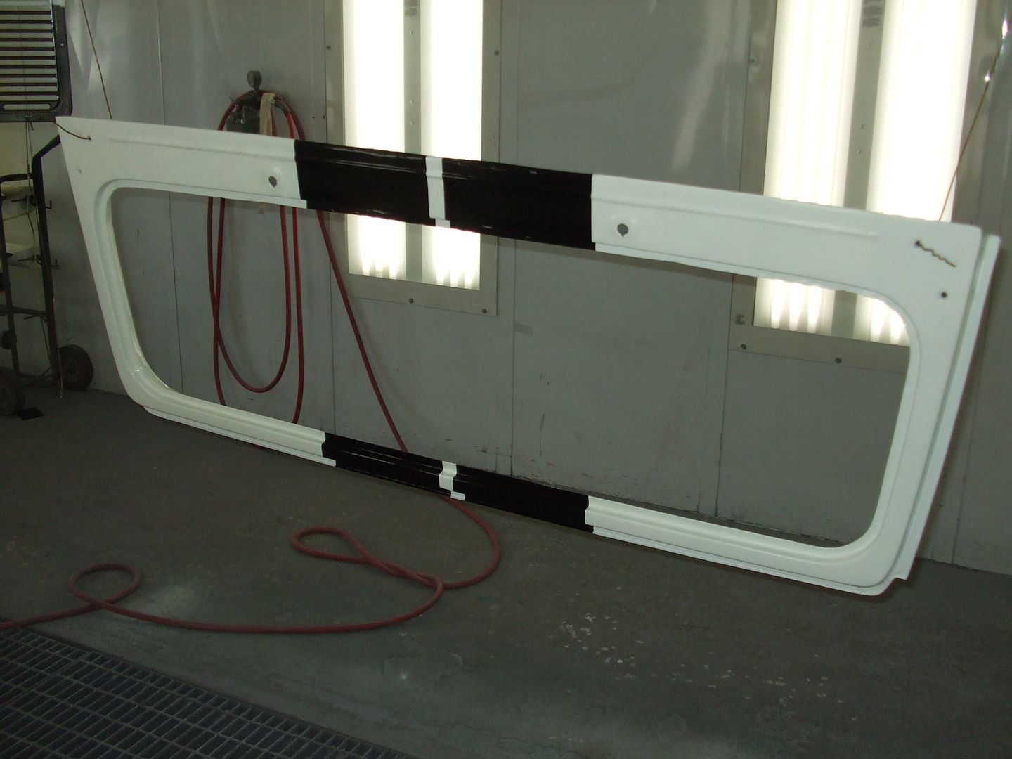

The windshield frame was good to go from the first round so all it needed was the clear coat.

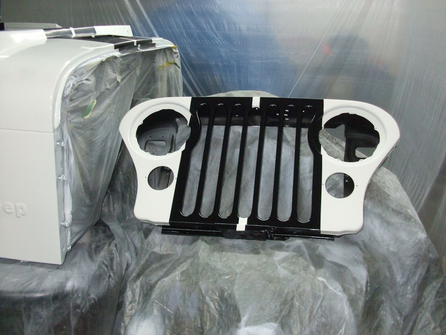

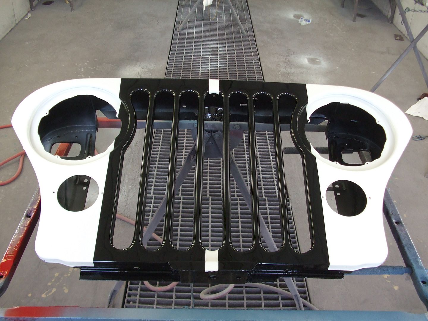

The grill also faired pretty well from the first round of clear coat. All I had to do was lightly sand two small areas then scuff it with a gray scotch bright, clean and tack. Then it got sprayed with two coats of clear. This picture is with the flash because it showed the most gloss.

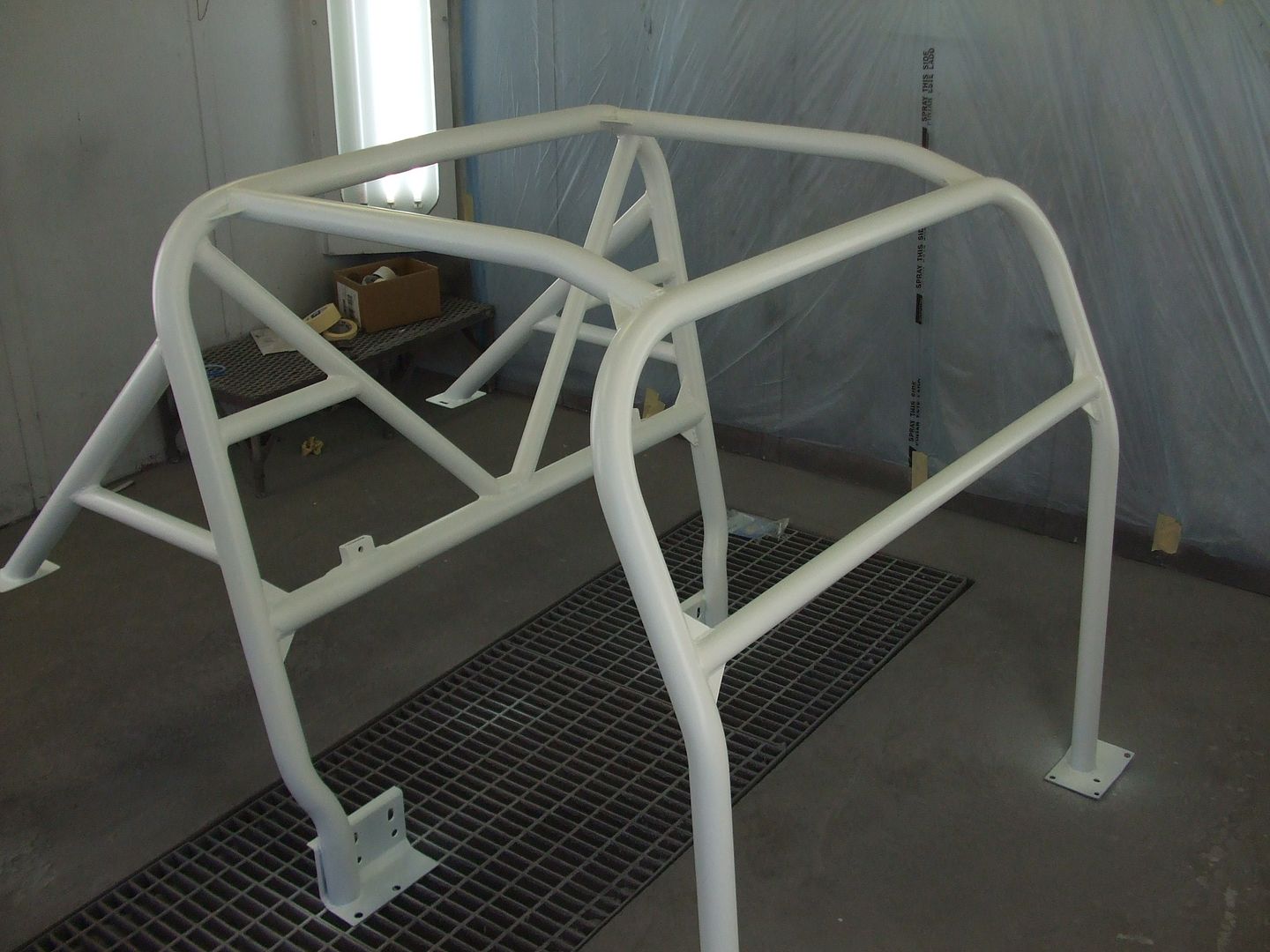

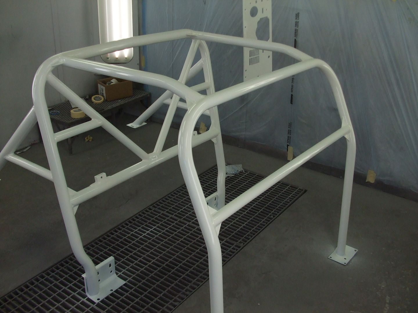

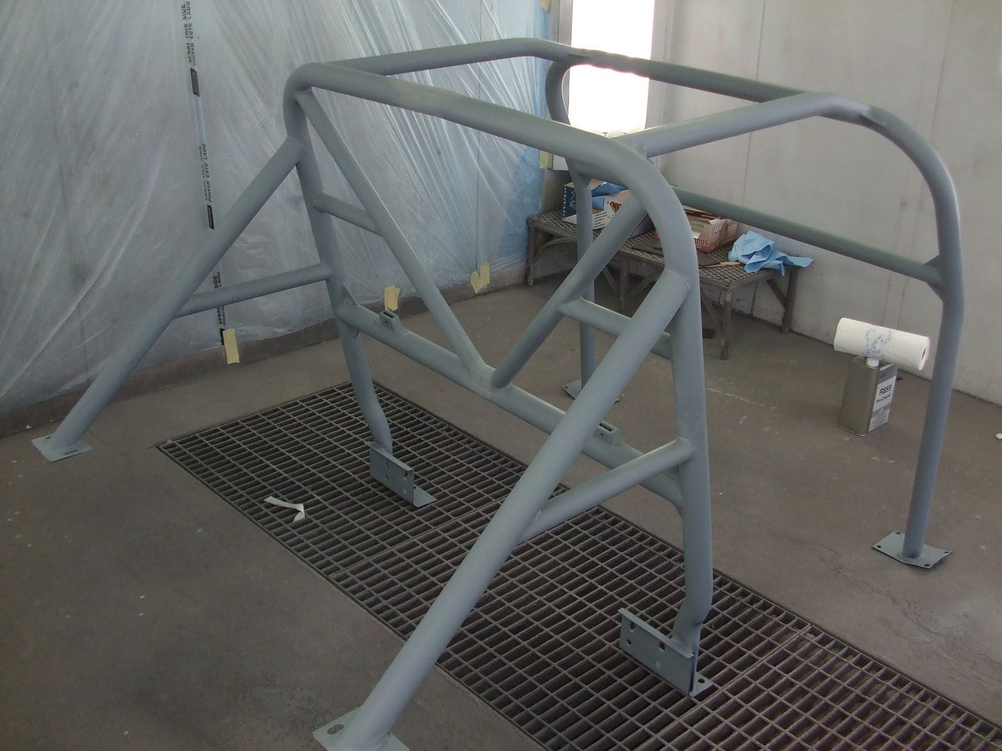

Time for the roll bar to get some TLC. Here it is all cleaned up and ready for color.
After three solid coats of white.
All clear coated. The roll bar was kind of tough to spray but I think I did a pretty good job on it.

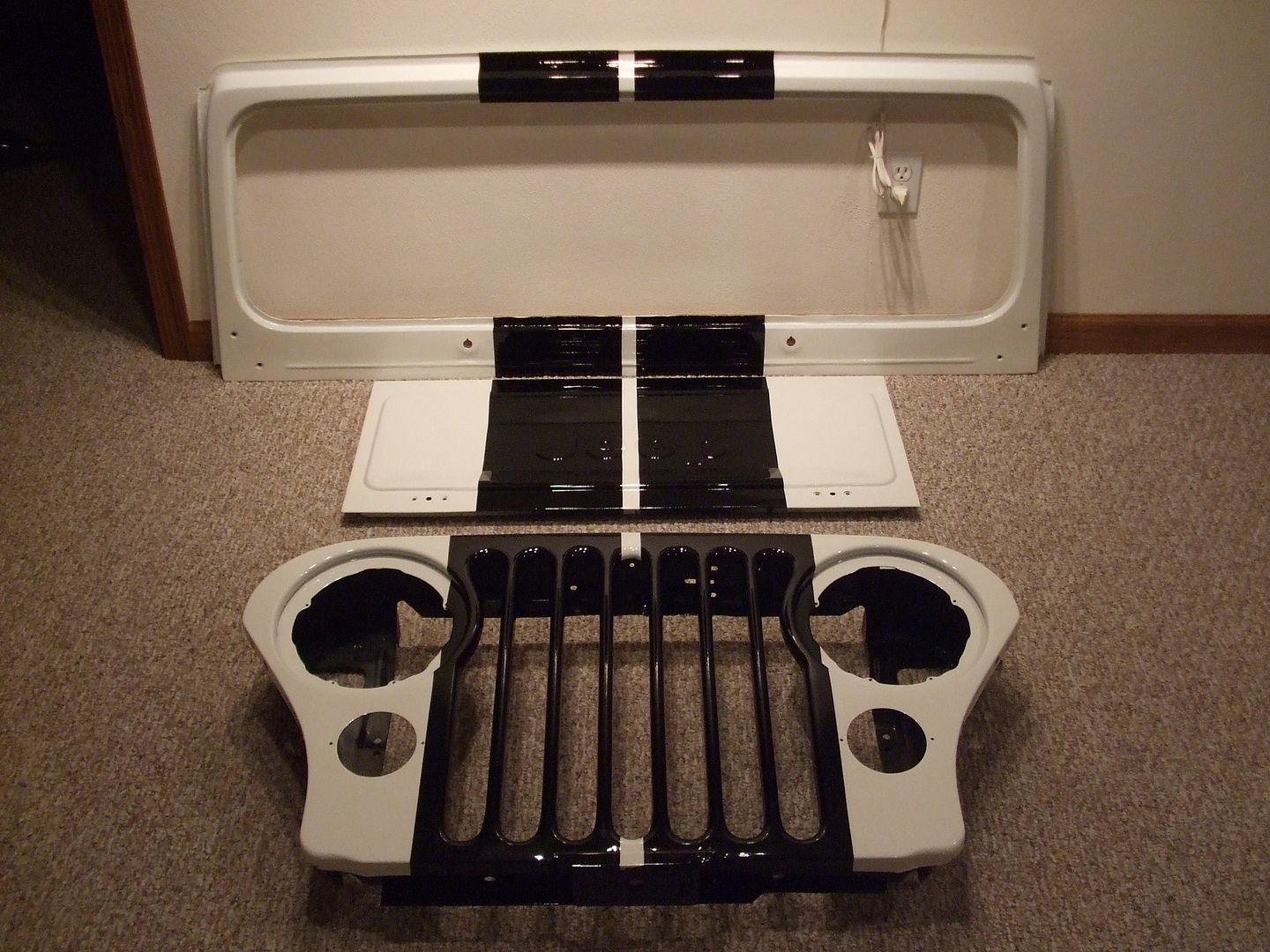

Here is how the main parts are resting in my basement at the moment. Sorry for the crappy picture. I'd have to say I am pretty happy with the way they turned out. I'll have to do a little typical buff and polish but they turned out really nice.
