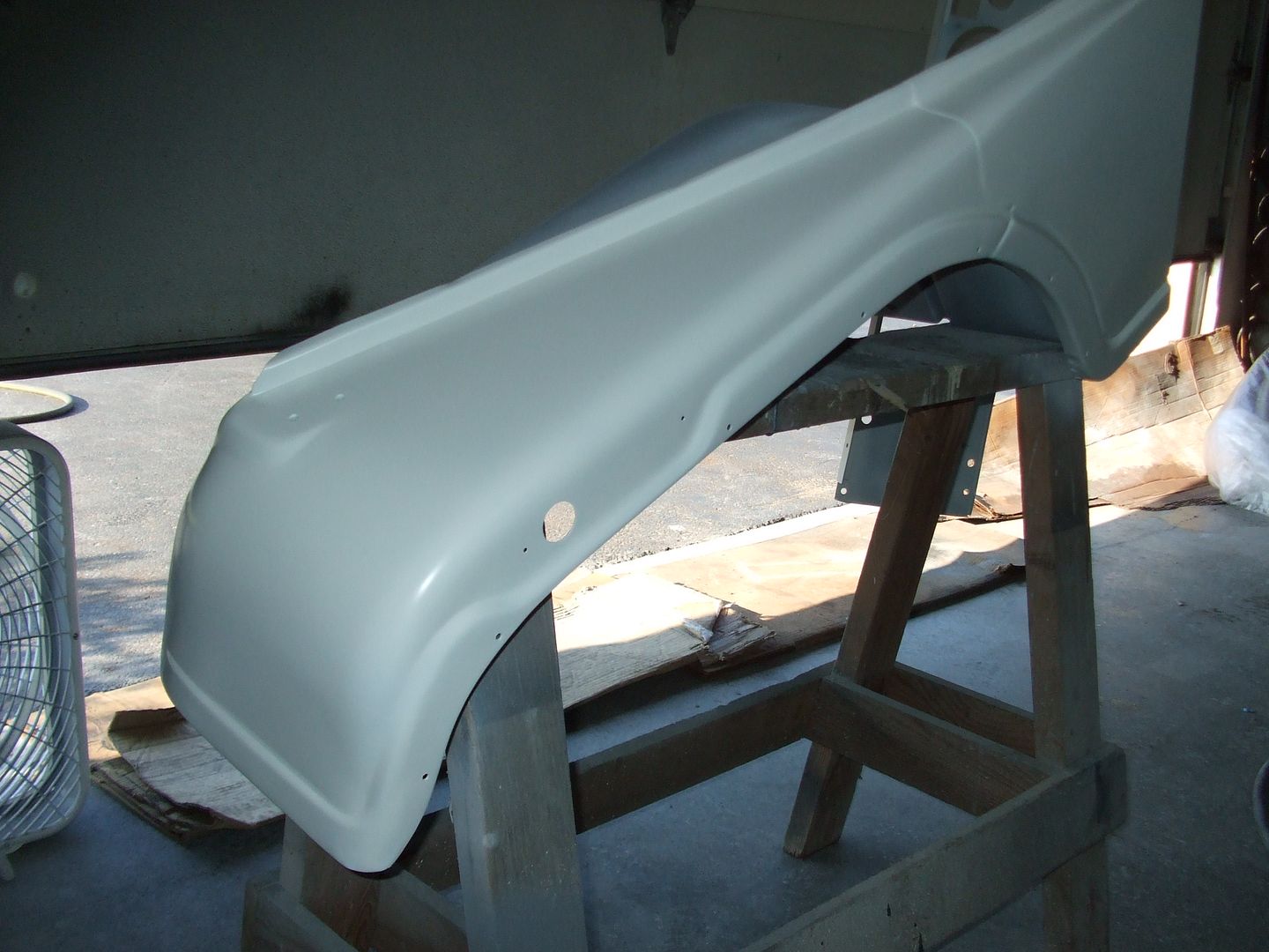

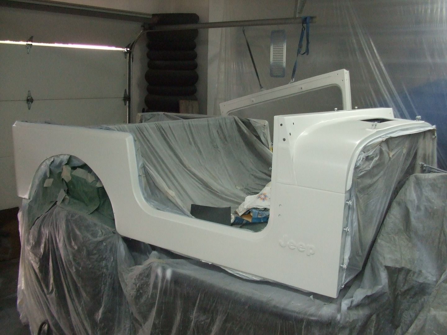

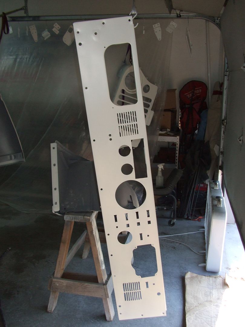

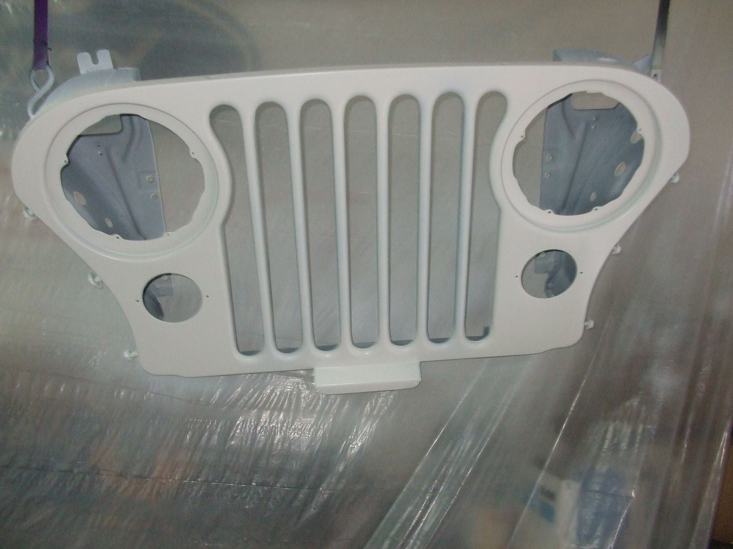

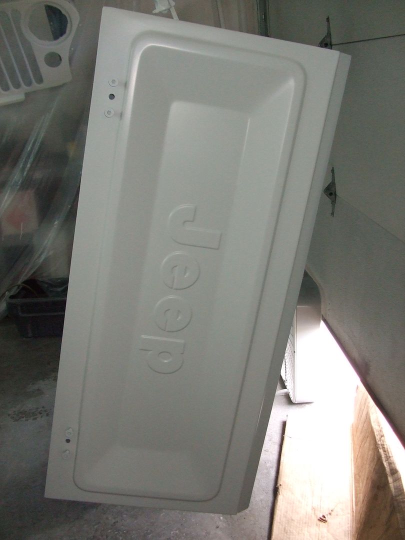

So I had to sand down the grill, tailgate and top of the hood to remove the bits of binder from the faulty paint. I also had to scuff the rest of the parts because it had been longer than 72 hours since I last sprayed. It is mostly just more wasted time but it does actually help make the paint job just a little bit smoother. So I finally got to start spraying the HP White. Of course everything has been washed with pre-clean and wiped with a tack cloth. Here is the grill after two coats of the HP White.
The tailgate is looking good.

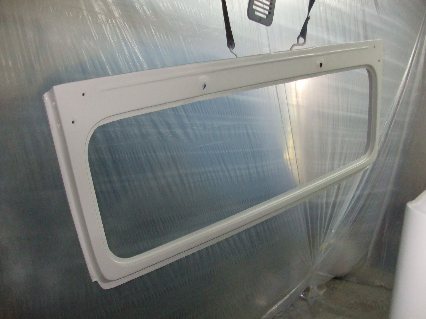

The windshield frame is a little difficult to work with. Don't forget that lower edge is covered by a seal. That lower lip adjustment is what we call FFF, Final Fit and Finish. That's usually performed with a hammer.

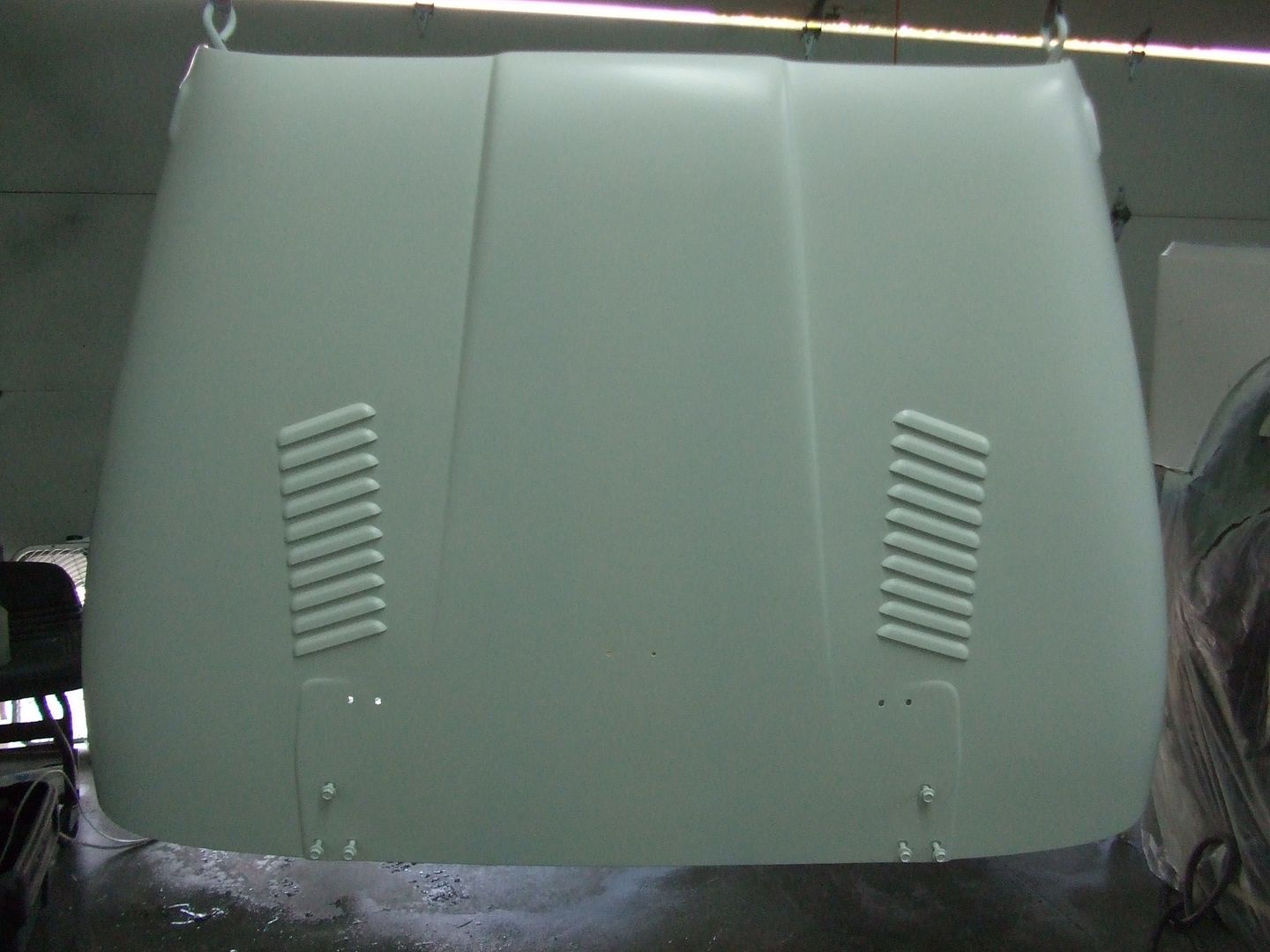

The hood is looking solid.
I was originally only going to paint all the pieces that had white and black together during the first session. I had planned to leave all the white only panels (fenders, dash and roll bar) until another weekend. We'll things seemed to be going well and I had some paint left in the hopper so I figured what the hell, I'll try to knock out a few more pieces at the same time. So I quickly cleaned the fenders and dash. Here are the driver's side fender and the dash in primer sanded to 600 grit.

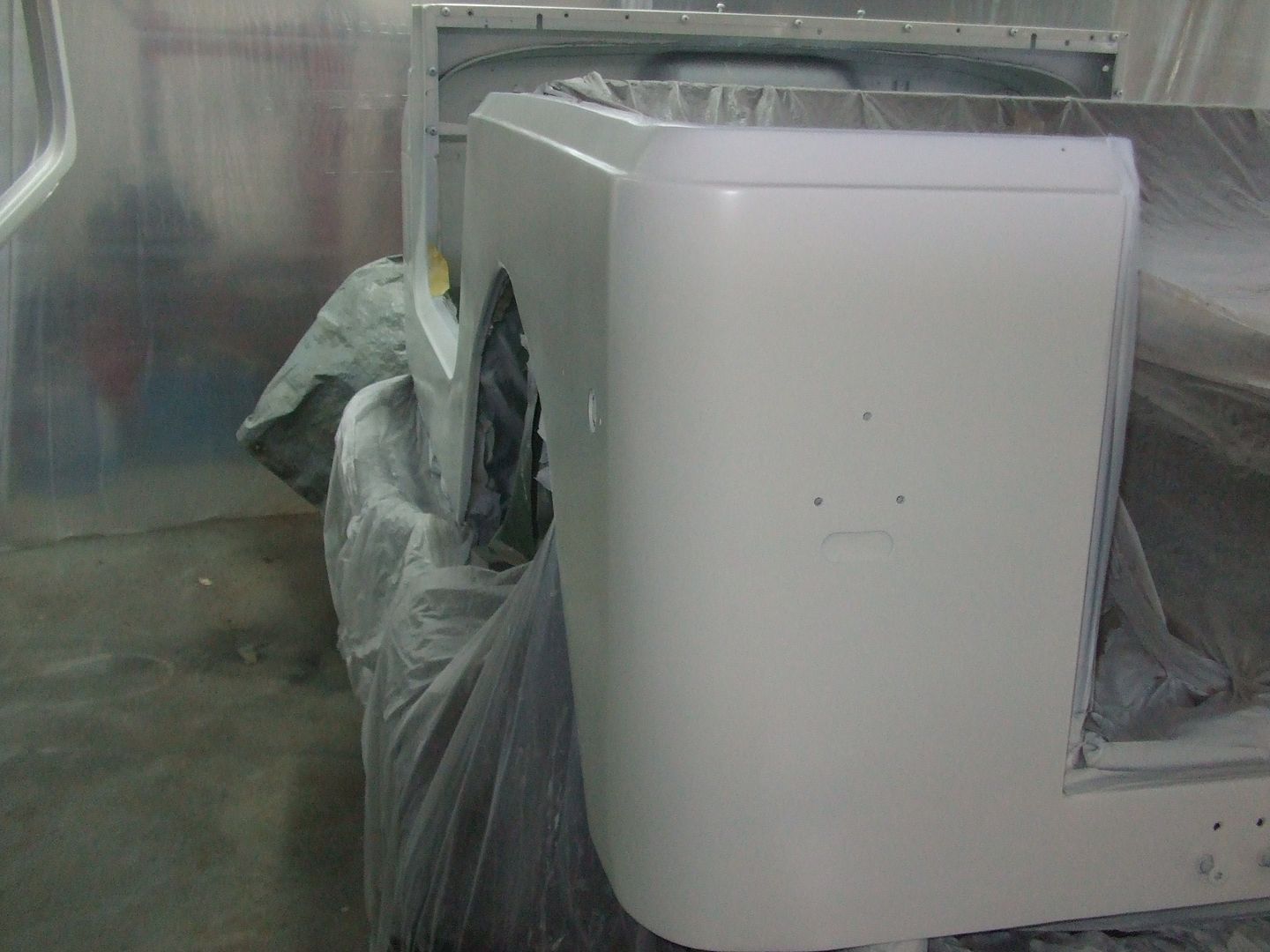

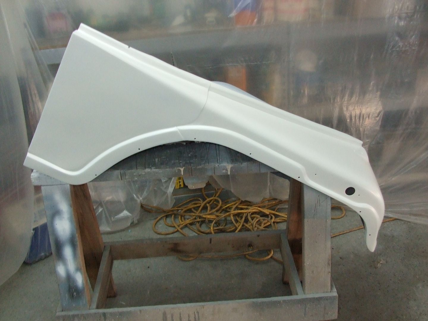

Driver's side after three coats of HP White.

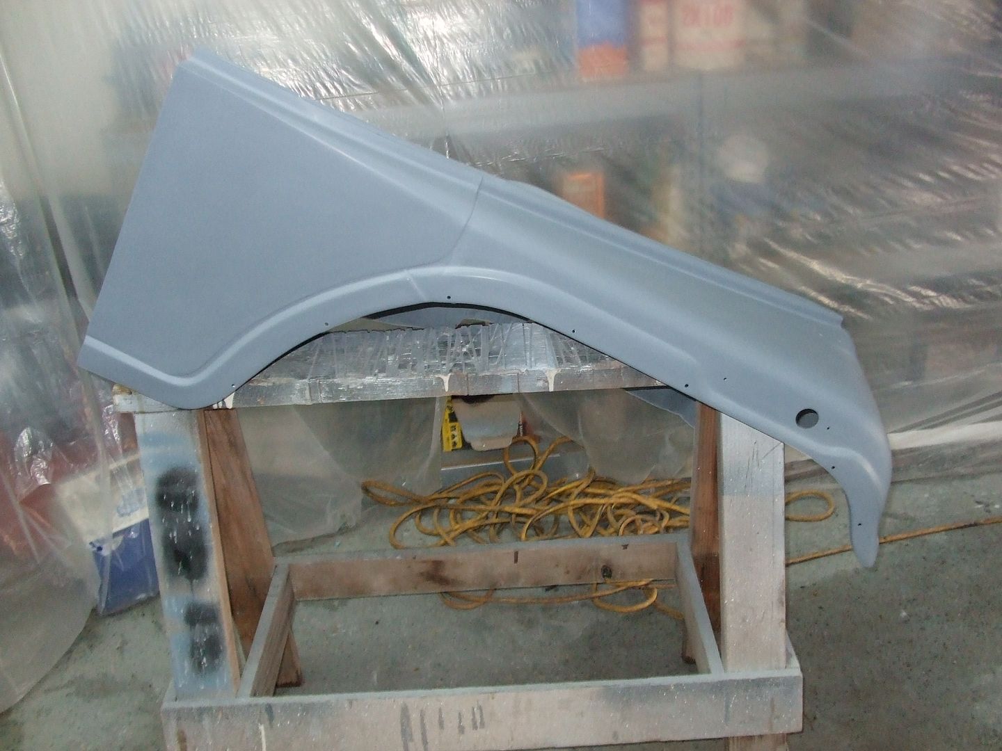

Here is the passenger's side in primer.
After 3 coats of HP White.
One of the dash ready for clear coat.
This is a good view of the driver's side rear corner.
One last picture of the entire passenger's side of the tub.

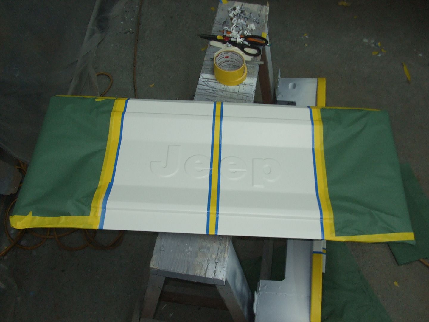

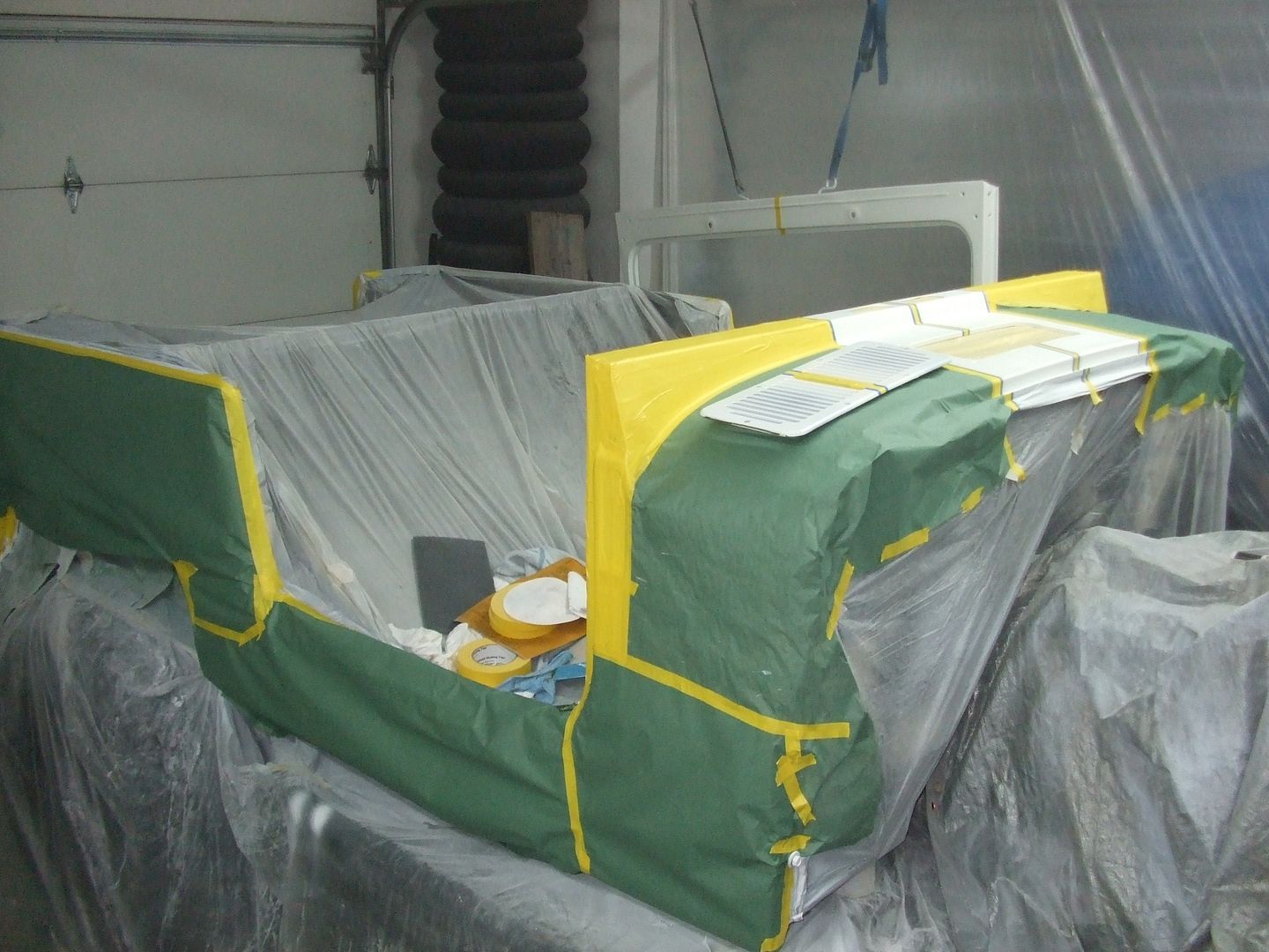

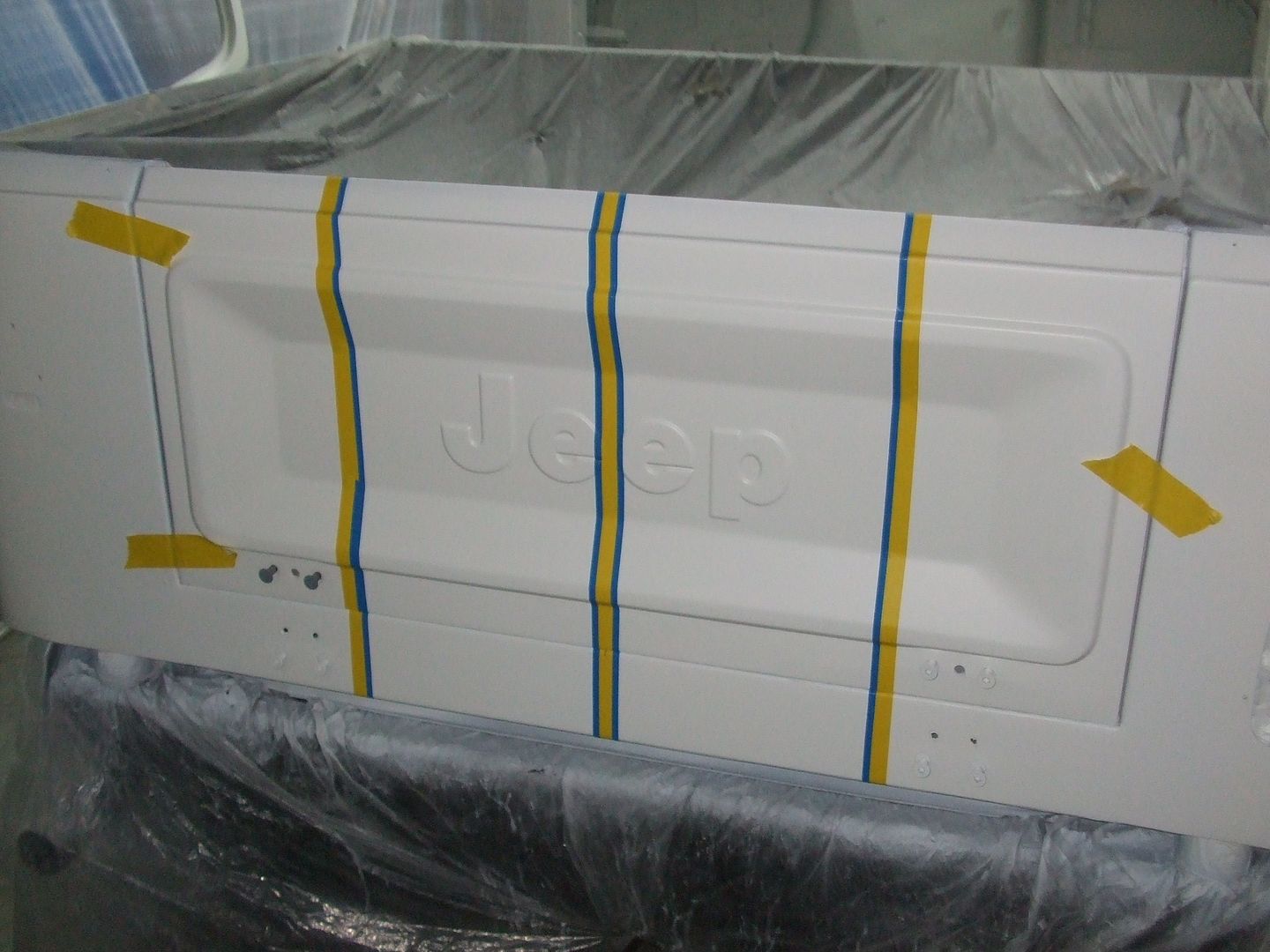

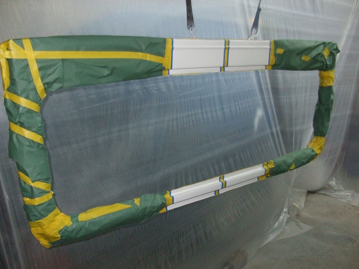

I am painting dual 9" stripes with a 1" white center down the middle of my CJ much like a late model Cobra. So at this point I had to start taping everything off for the stripes. I started at the rear of the tub and found center from the edges of the tailgate opening and double checked from the hinge bolt holes. I laid down a 3/4 inch piece of yellow masking tape as close to center as I could get. I then used the 1/4" fine line tape to make the exact 1" edge. By placing the blue tape over the yellow, this allows me to quickly pull off the fine line tape directly after painting the black to give the sharpest lines as possible. This also leaves the rest of the tape and paper in it's place. Once the center 1" stripe is down, I measure 9" out from the edge and do the same process with the blue over the yellow tape. I did the rear of the tub then followed the same procedure on the tailgate. Once I was done I held them up to each other and much to my surprise, they lined up perfect!
So I finished taping off the tailgate. The back side will be Raptor'ed.

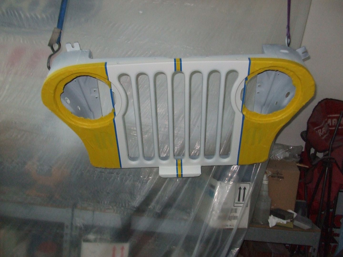

The grill got the same treatment.
The windshield frame only gets the black stripes on the outside. This piece was hard to measure the center line. I actually saved this piece for last.

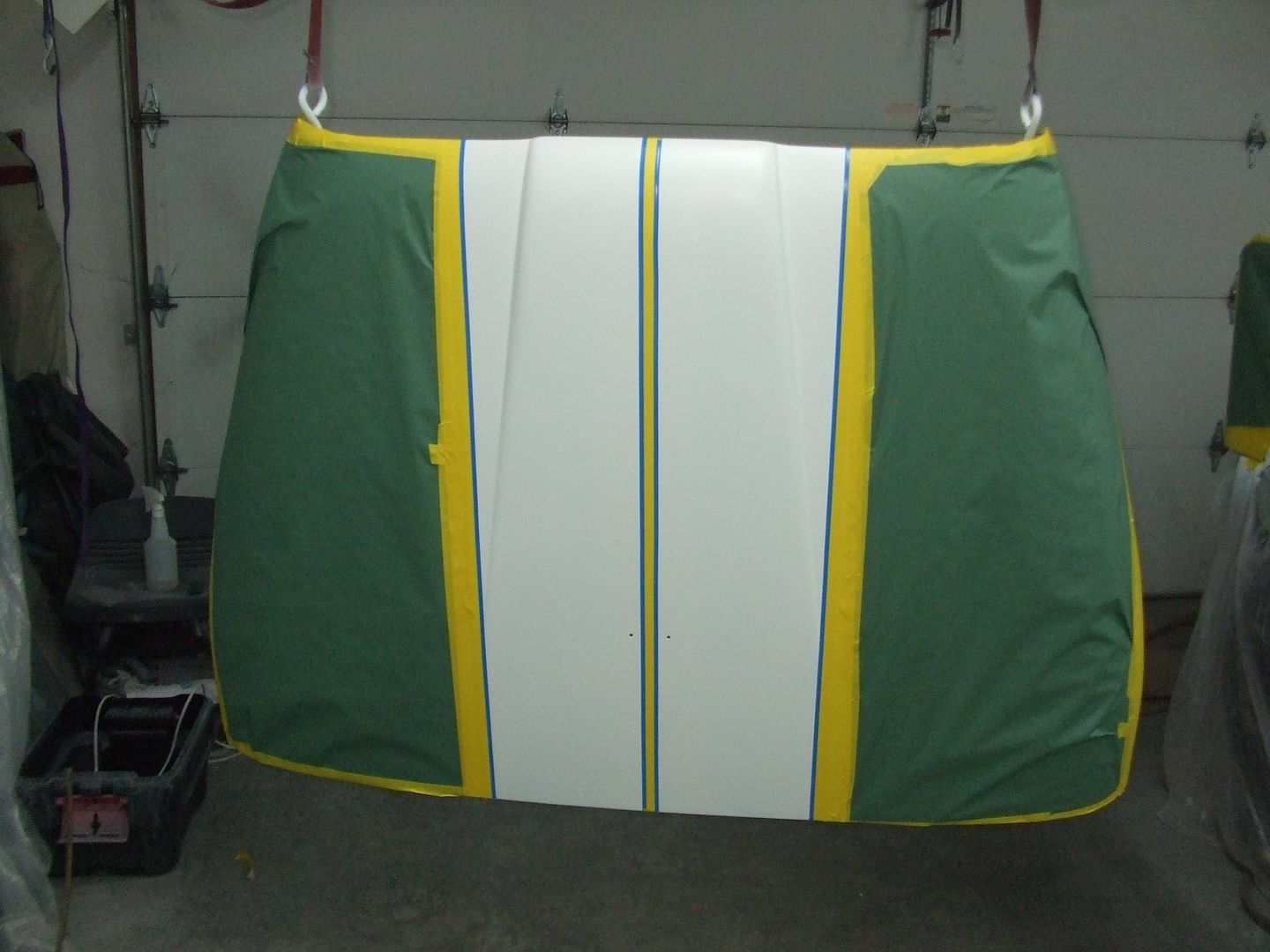

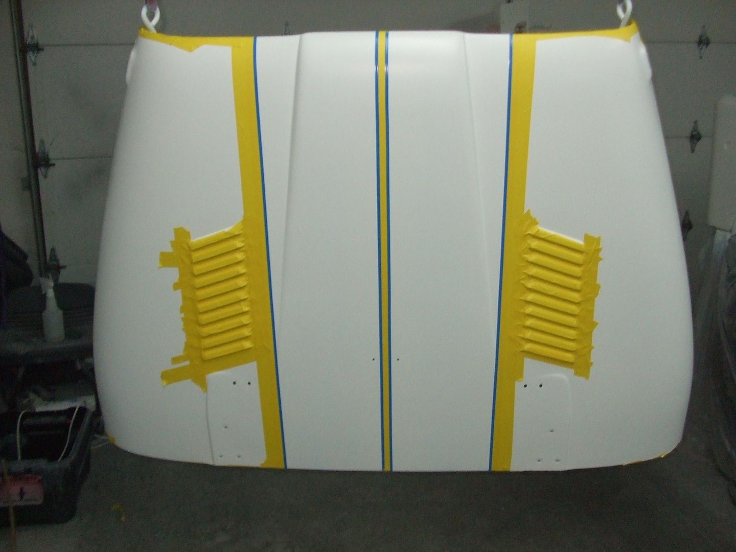

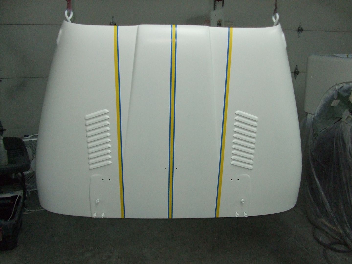

The hood is probably the most important due to the sheer length of the stripes and also very hard to find center on the front edge. Here are the main measured lines on the hood.
I had to tape off all the louvers because the underside of the hood is going to be black. I was scared of black bleeding onto the white.
Finished taping off the rest of the white.
Last came the taping of the front cowl, fresh air inlet cover and the rest of the tub that's covered in white.
It took me almost ten hours to tape all of those panels but at this point it was time to start mixing up the black paint.
