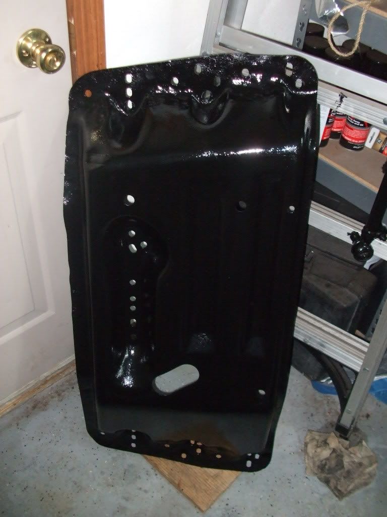

Yeah, I had to look up the date in the picture properties but it was painted on Oct 12th. Three weeks later we had one last warm spell and that's when I knocked out the axles, skid plate and just about anything else that bolts to the frame. We're getting pretty close to where I'm actually at in the rebuild. I am going to post some pictures of the parts and of the few things I have put back together. Then I'll be caught up to present time. The cool thing is I have the next 4 days off and plan on spending some time in the chill box garage.

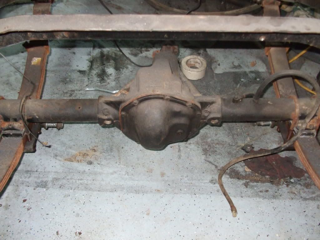

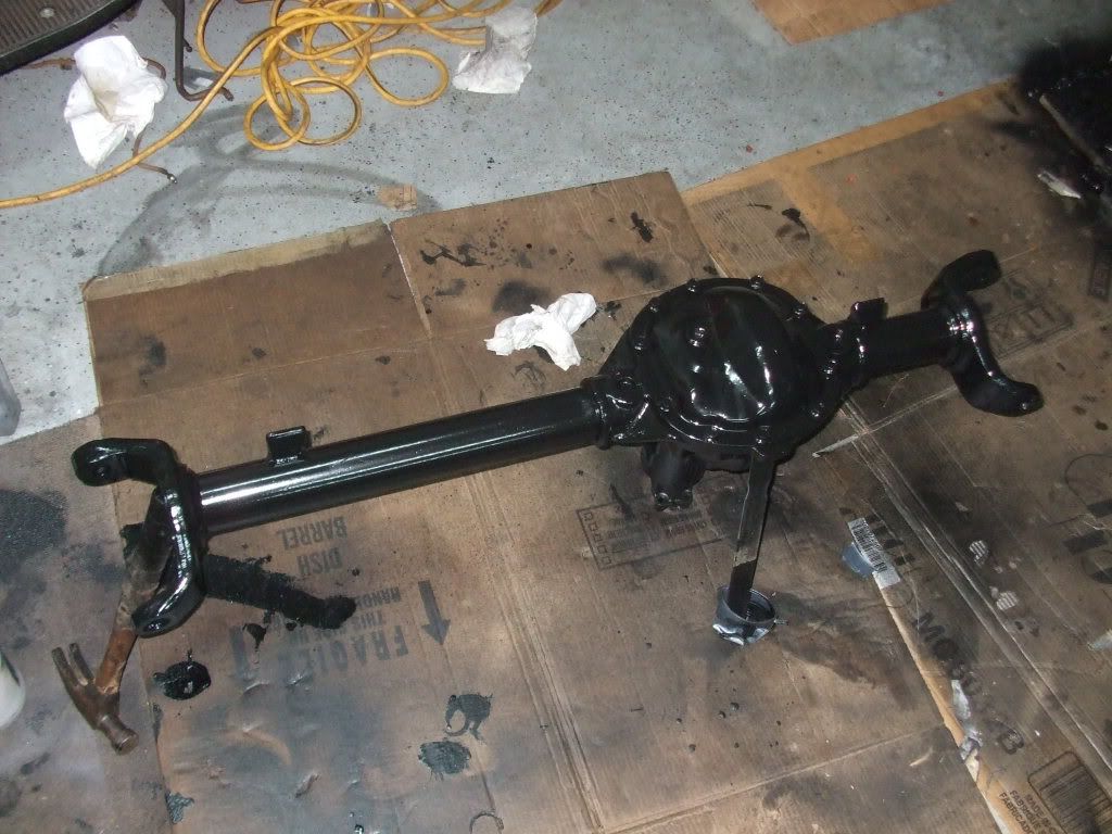

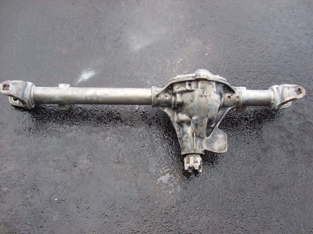

Axle and chassis parts

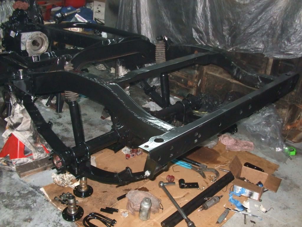

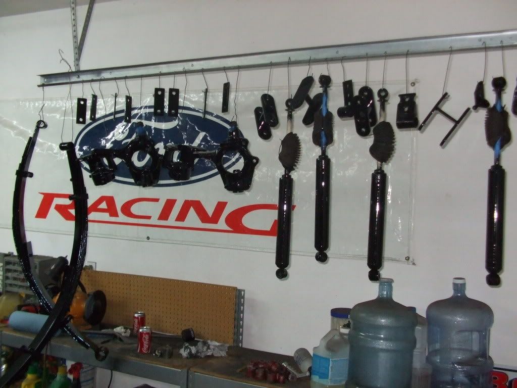

These are just some pictures of the axles and other chassis parts.
Transmission Cross member before:
Here it is after a wire wheel, Marine Clean, Metal Ready and 3 coats of POR-15. I also hit it with Blackcote:

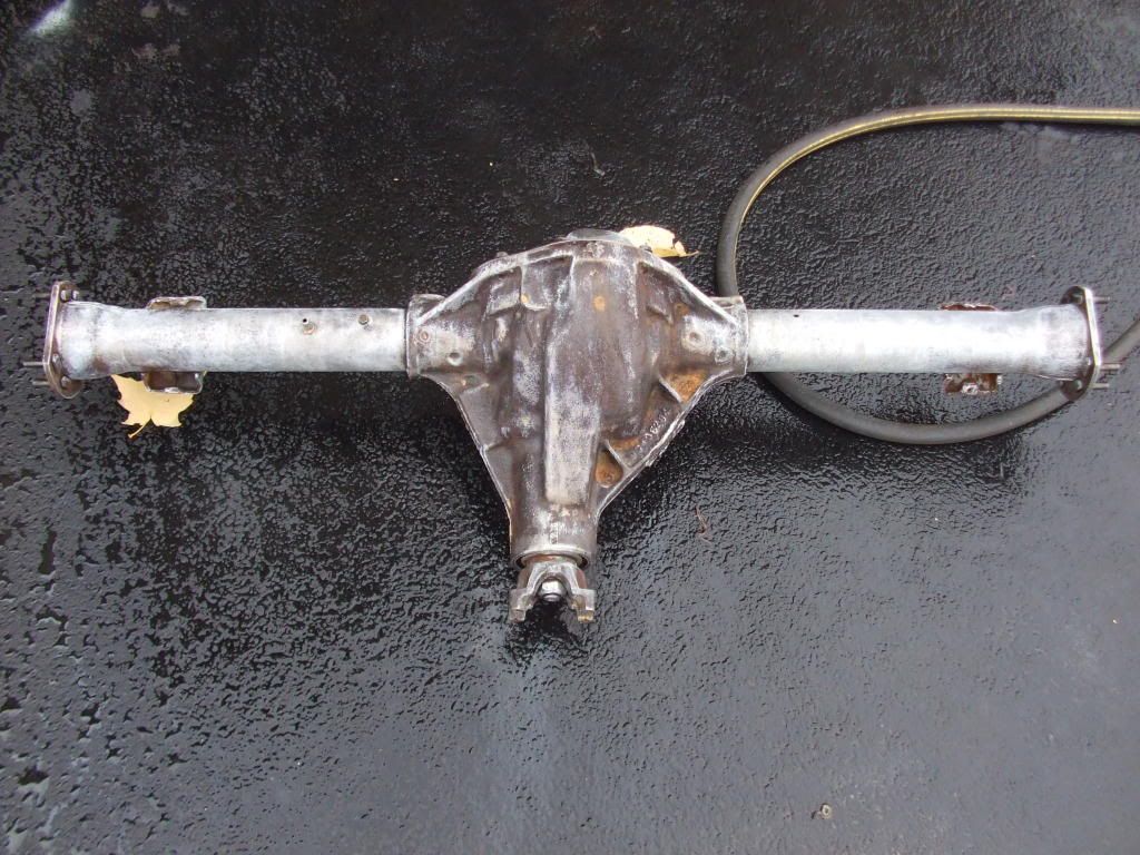

Rear axle before:
Rear axle cleaned:

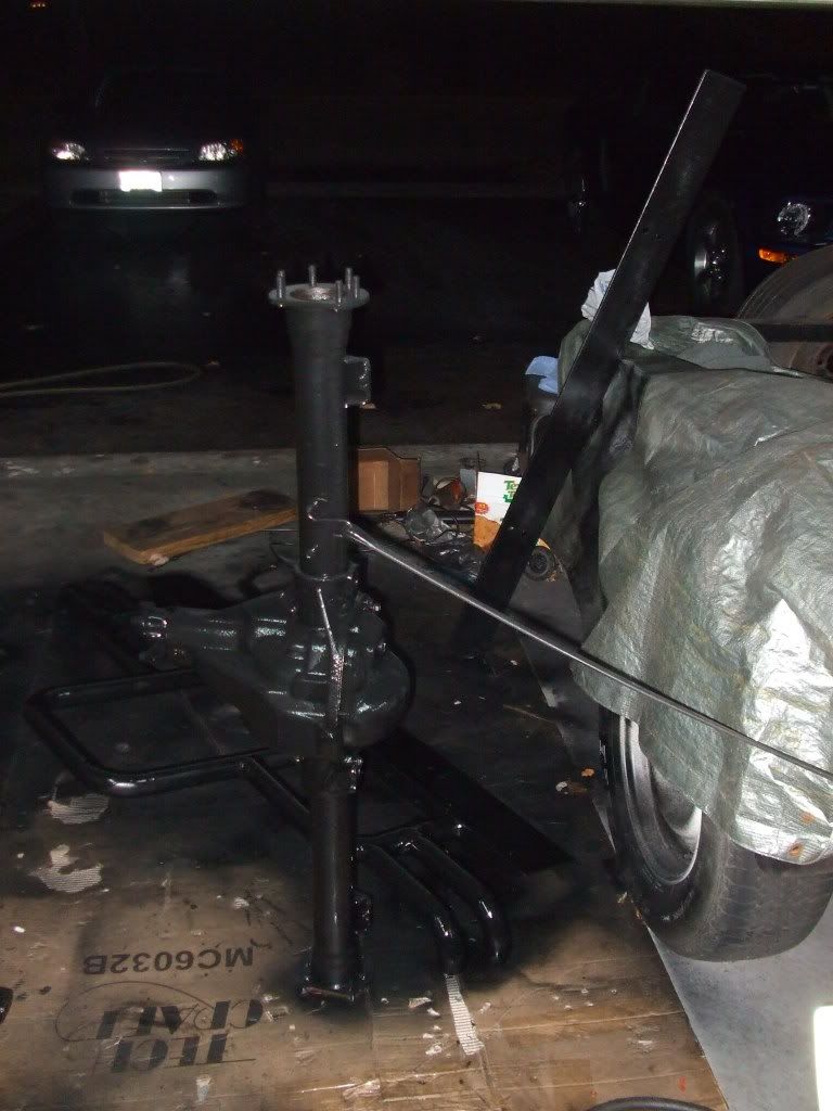

Rear axle painted:
Front axle cleaned:
Front axle painted:
Miscellaneous parts all cleaned up:
Parts everywhere:
I cut up almost every wire clothes hanger in the house so I could hang all of these parts for drying. Once dry I stacked them around the frame to get them out of the way:

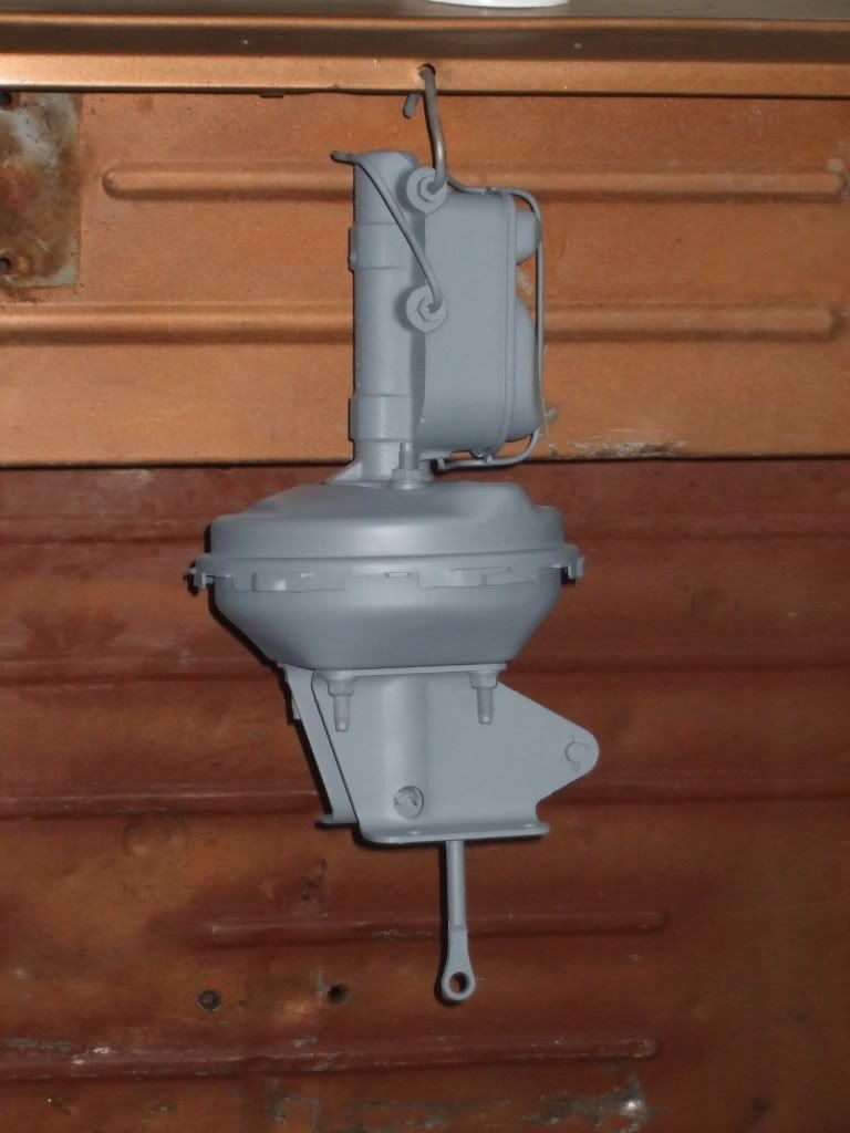

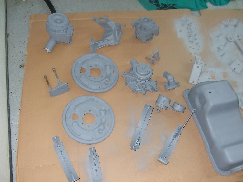

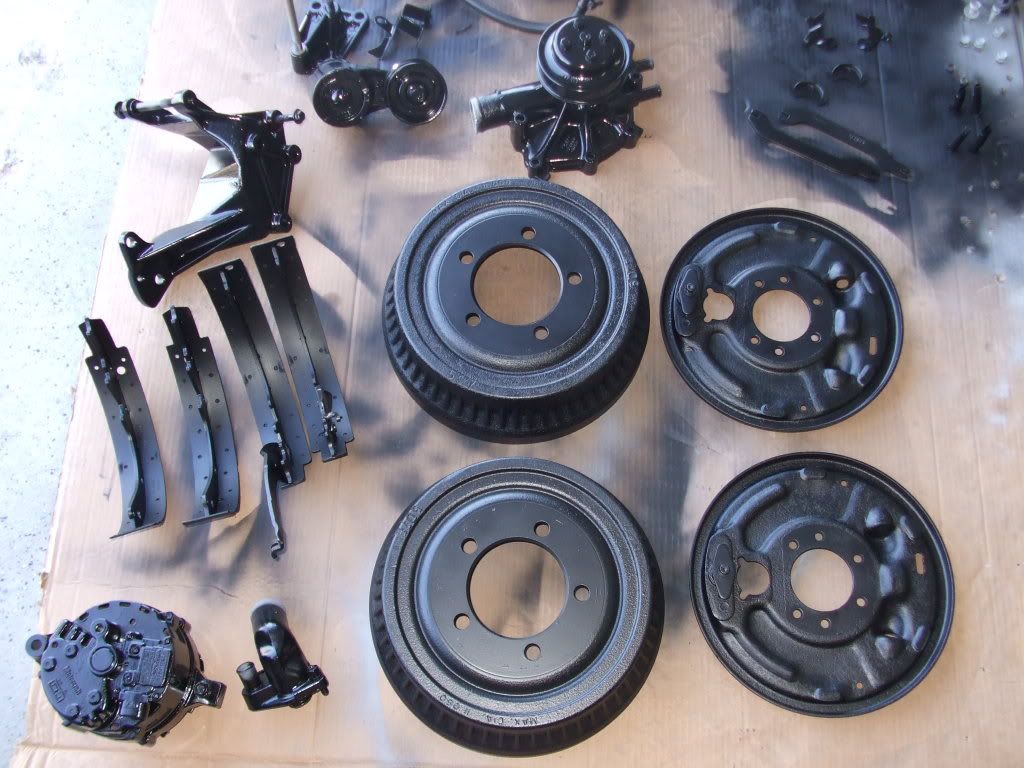

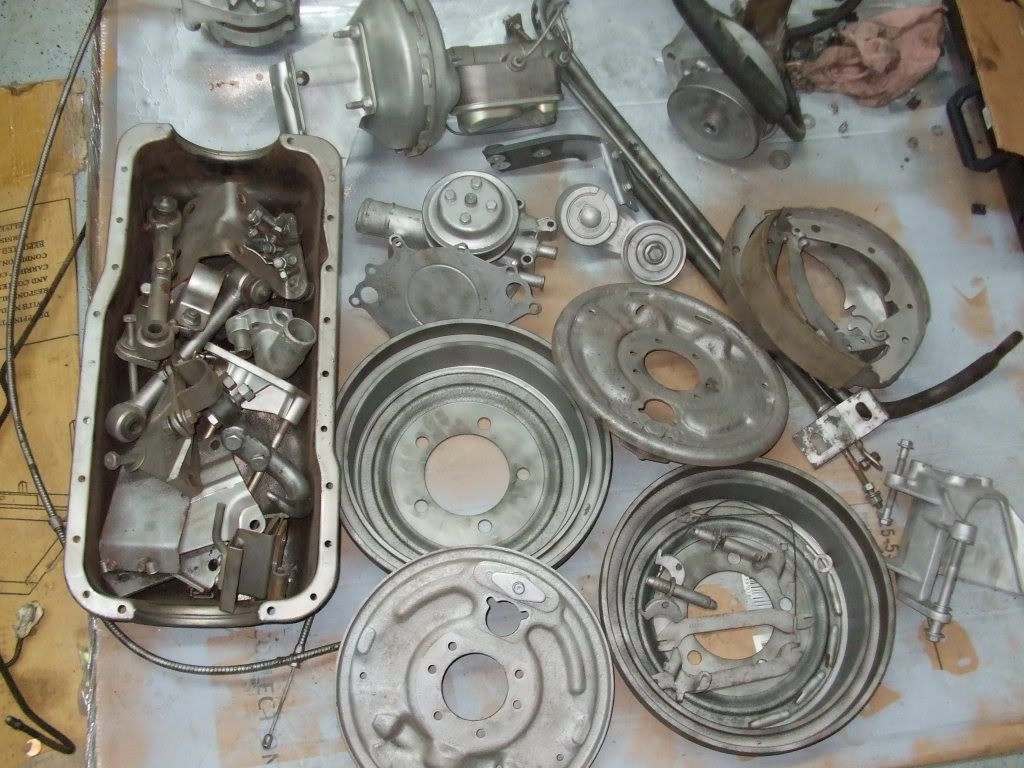

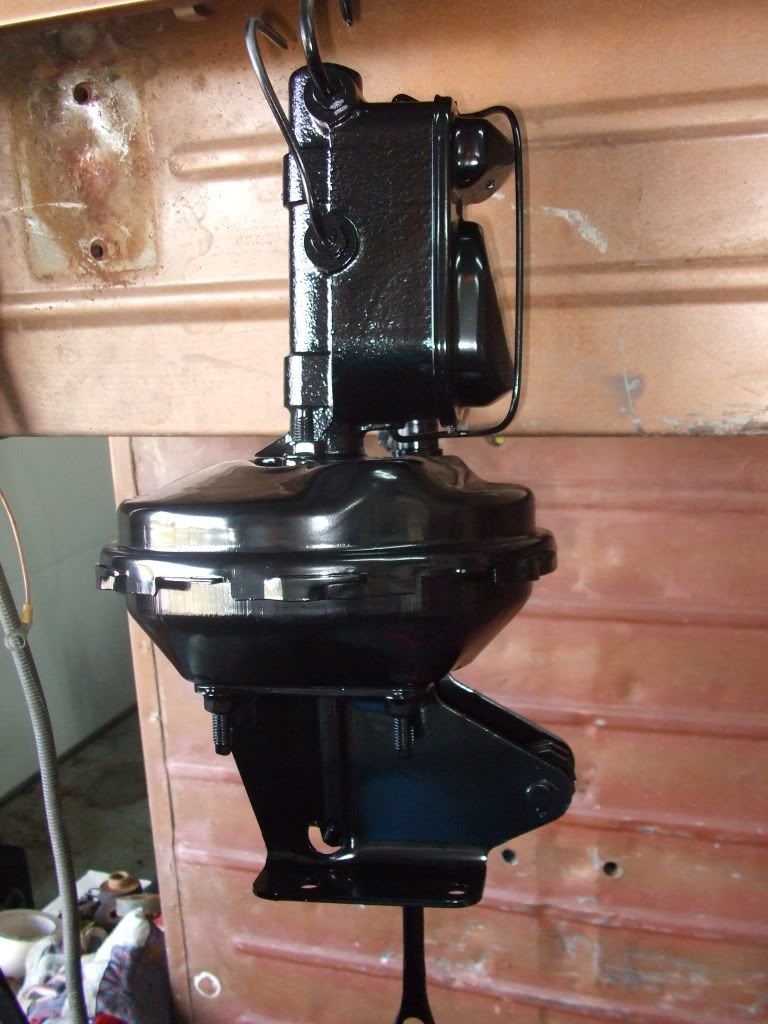

Brake Components
I can tell you that having full access to a bead blaster is a wonderful thing. I couldn’t imagine trying to do this without one.

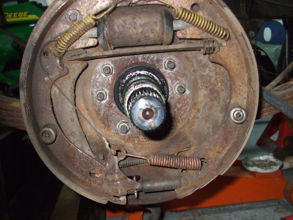

Rear drums, backing plates and hardware:
Same parts bead blasted:
Primed with high temp paint:
Painted with high temp paint:

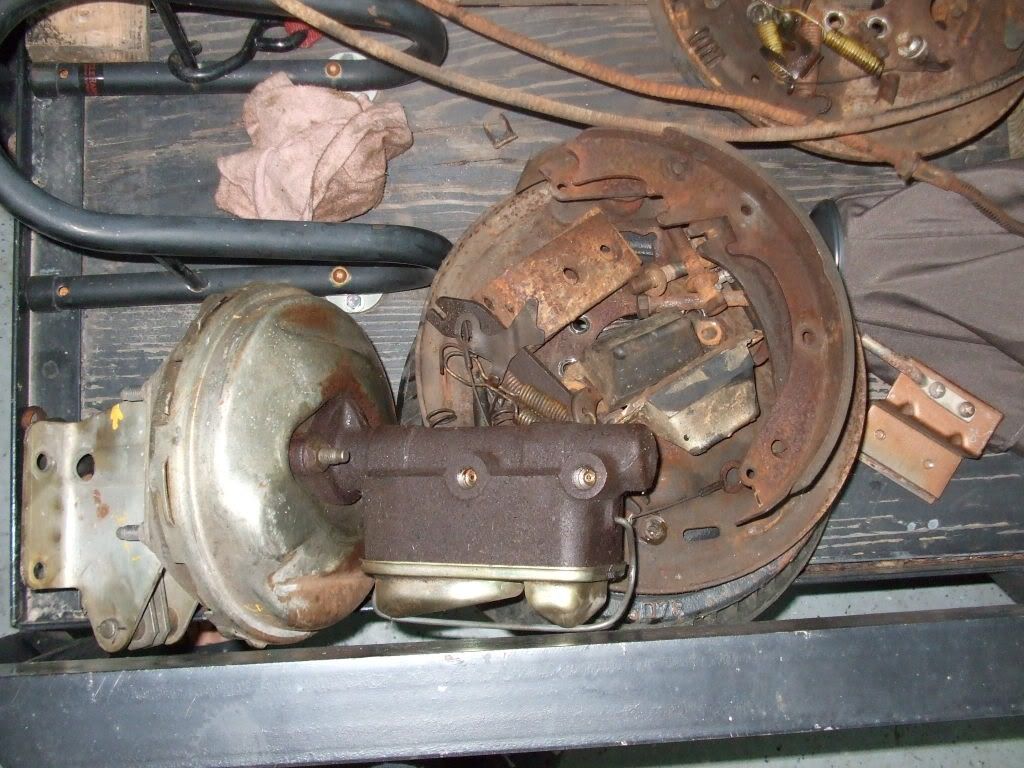

Check out that master cylinder:

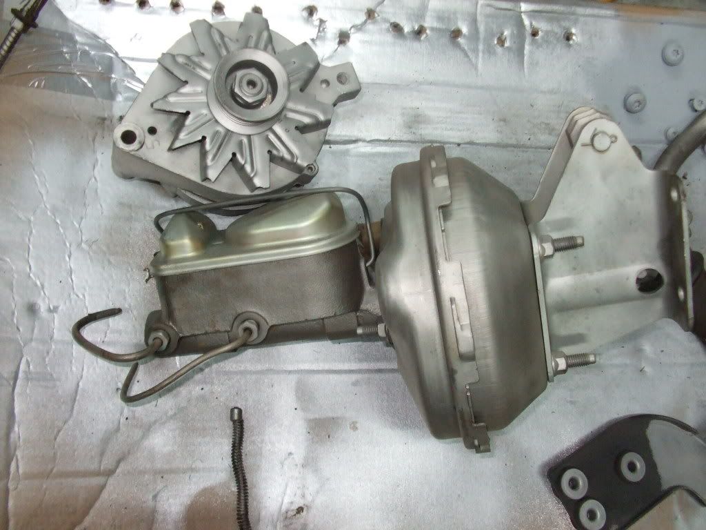

Bead blasted:
Assembled brakes before:
Assembled brakes after:
That’s about where I’m at up to this point in the build. I put the rear springs and axle on and completed installing the rear brakes. I plan to install the rear hubs tomorrow to finish off the rear axle. After that I will likely move on to installing all of the front engine accessories before I tackle the front suspension and steering.

The parts were all ran through a glass bead blaster. I had access to a shop where I could go in after work, during their second shift, and use it until they closed at midnight if I wanted. I was even able to turn my own drums. I did the rotors too but one was out of spec so I just bought two new ones. Just about every part on my Jeep has been ran through that blaster, from the foot controls to the battery tray. I really don't know how you would do something like this without one. Wire wheel, clean and paint does work but would take forever. I know, I did that to the frame and alxes. The bead blaster makes it look like you are spray painting the parts with metal colored paint.
I would consider buying one but the space in my garage is already limited. Not to mention it would be a tool I would use a lot during the rebuild then be lucky to use it once a year after that. I would have to say around 10-12 hours were spent in the cabinet for all of the chassis and engine parts. That's about 90% of everything. I still have to do the seat risors and a coupe things like that but nothing like all of the frame/chassis parts.

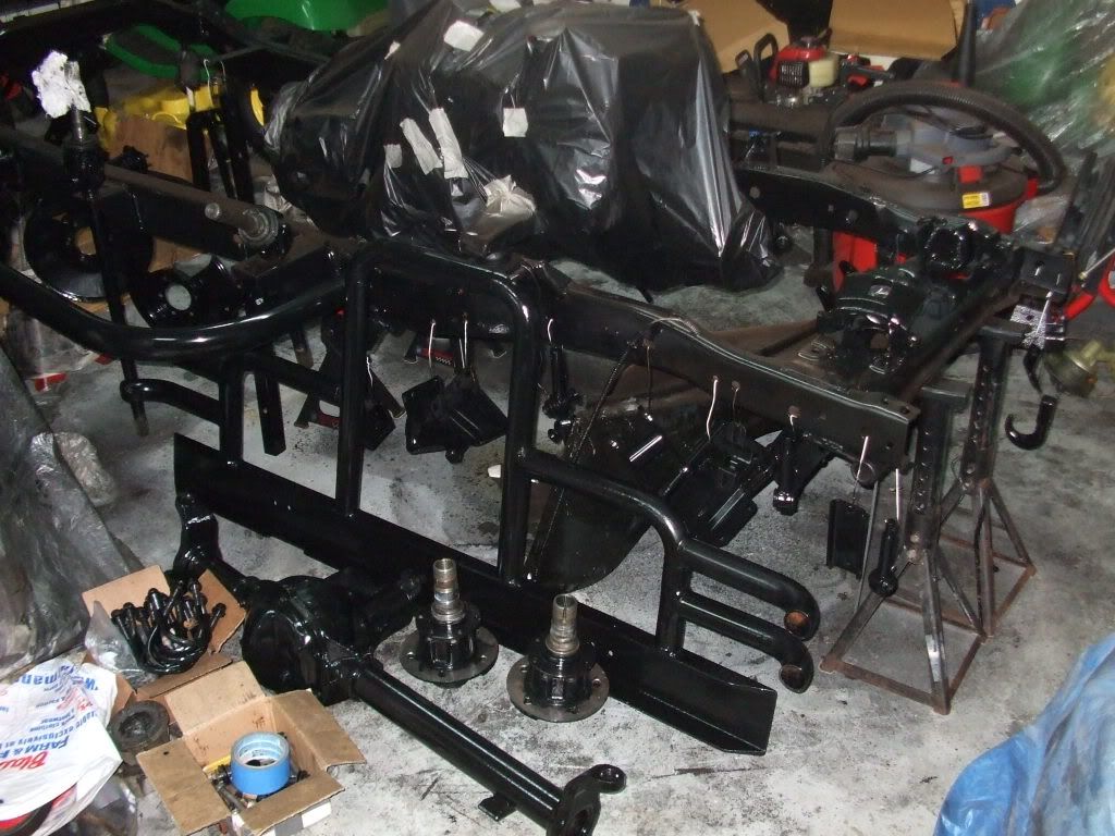

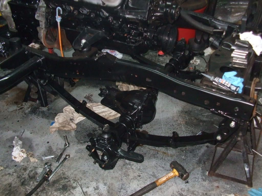

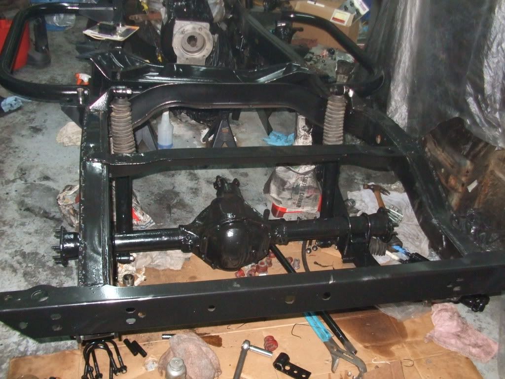

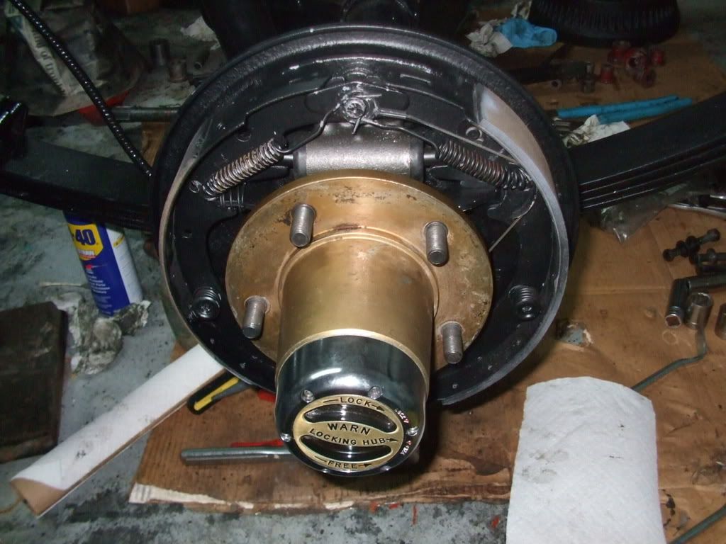

Well, here is the work I finished up over the 3-4 days before I took off for Christmas. This is the first chance I've had to get the progress posted.

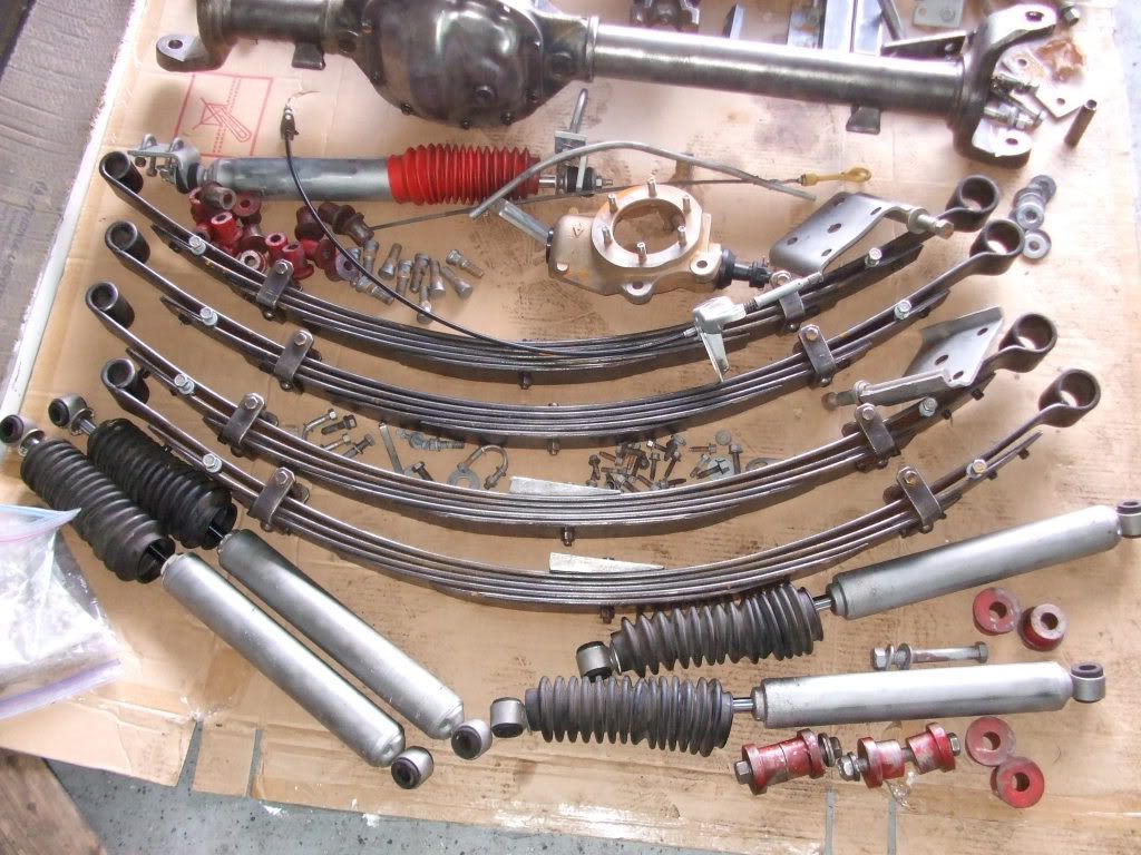

Rear suspension and axle
Pretty simple here, I just bolted on the frame hangers, grease able shackles and then springs. Lay the axle into their alignment pins and install the U bolts. All new Daystar bushings with a lot of anti-seize.

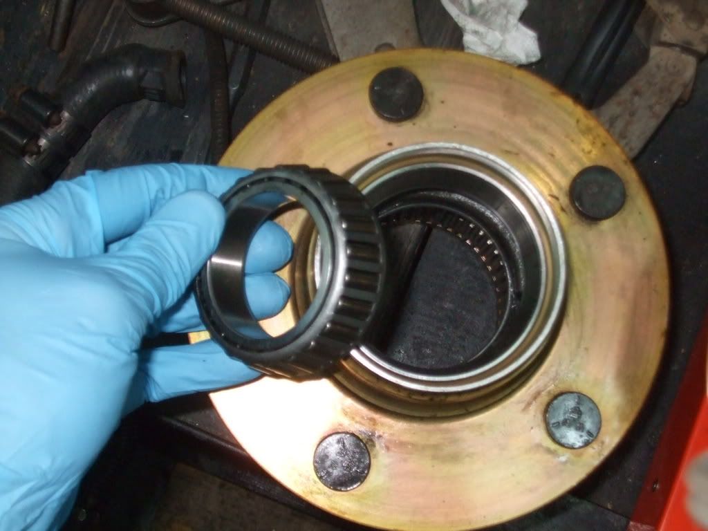

I installed the spindles, axles, brakes and hubs on both sides. Here are some pictures of the Warn full floating rear hubs, inner bearing:
Hub parts:
All assembled:
With brake drums:
The assembly of the front suspension was pretty much the same as the rear. No need to go into too much detail.
I also got the power steering box installed on the frame. That's as far as I got on the chassis and how it will sit for the next several weeks. I still have to install the axles, spindles, hubs and brakes. All of that should go pretty quickly.
Mike
