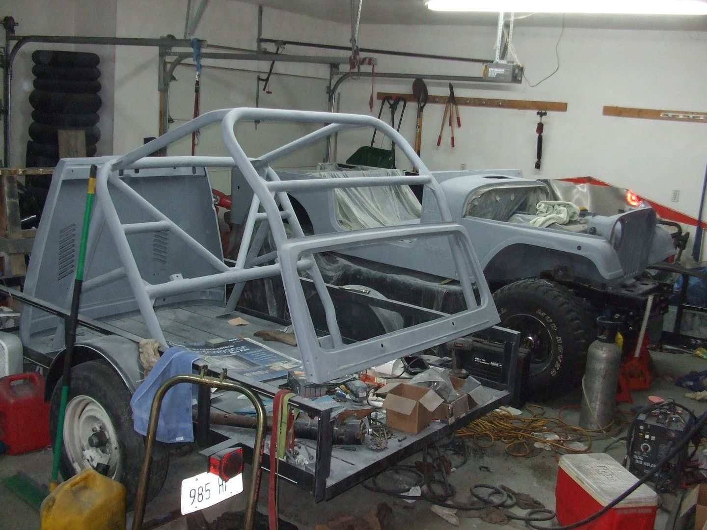

I got the tub on the frame and all the body mounts loosely installed. I also got the holes drilled for the brake lights, marker lights, rear fender flares and the fuel filler bezel. Next I need to get the new front fenders installed so I can check the clearance near the shock mounts and trim as needed. I've read in multiple places that the replacement fenders are not trimmed correctly around the shock mounts. Then I'll drill the holes for the front fender flares and bolt all the panels together for a final test fit. Once I am sure I have all the parts and pieces I will need for assembly I will break it back down and finish any touch up with the easy sand filler and final coats of primer. I'm hoping to start shooting color on the weekend of June 12th or it may be the 19th. You never know how things are going to go.

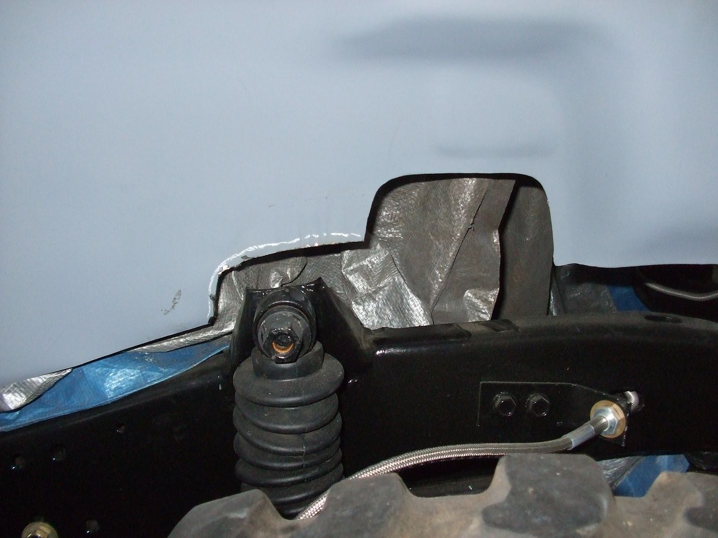

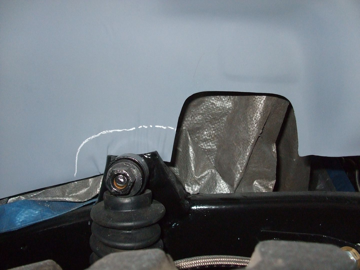

I got the front fenders placed into position and found the shock mount cutouts were in the wrong location. It was pointed out to me that the cutout is in the correct location for 82-86 CJ's but not for the 76-81's, even though they are advertised for 76-86. I guess I should have converted to the high mounts. Either way, they needed to be trimmed.
Nothing 15 seconds with my angle grinder couldn't fix. I'll get that cleaned up once I pull the fender back off.
The other side was the same way so no need for pictures of that. The fitment is questionable and took some pretty heavy prying and twisting to get them close to lined up. I think I might have to enlarge a few of the mounting holes to make everything bolt together a little easier.
