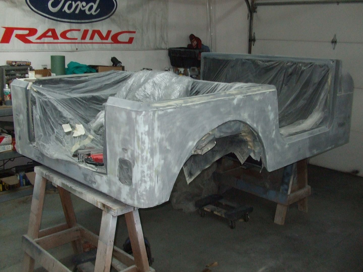

Everything was ready to be sanded and painted with the 2K Urethane Primer. I pretty much either used the DOA or hand, block or sponge sanded every piece of bodywork with 220 grit paper. That was a lot of work!
I had sprayed the tub with two lights coats of primer in the fall but it was with Acrylic Lacquer. Just about every painter I talked to said it would not hurt to paint the 2K Urethane directly over it but they also suggested to sand most of it off if it was put on light. I gave it a really quick once over with 220.
I decided to take it all the way off. I only spent 20 minutes and used three sanding disks to get it back to the filler layer and Tie-primer. This was after it had been washed and dried. Doesn't it look terrible?

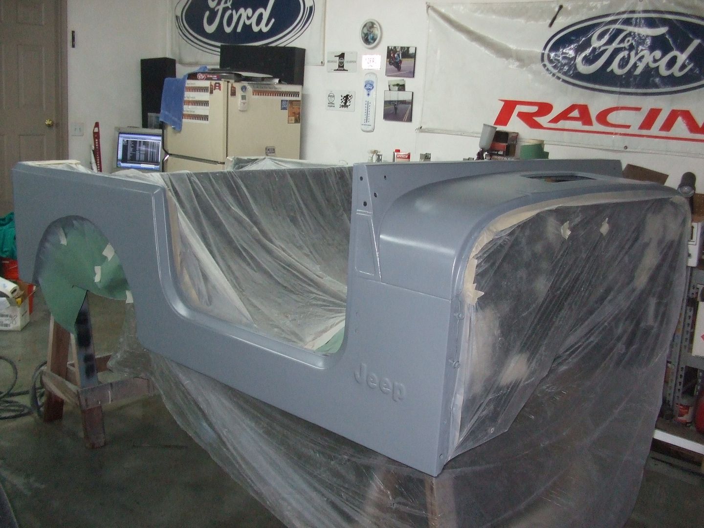

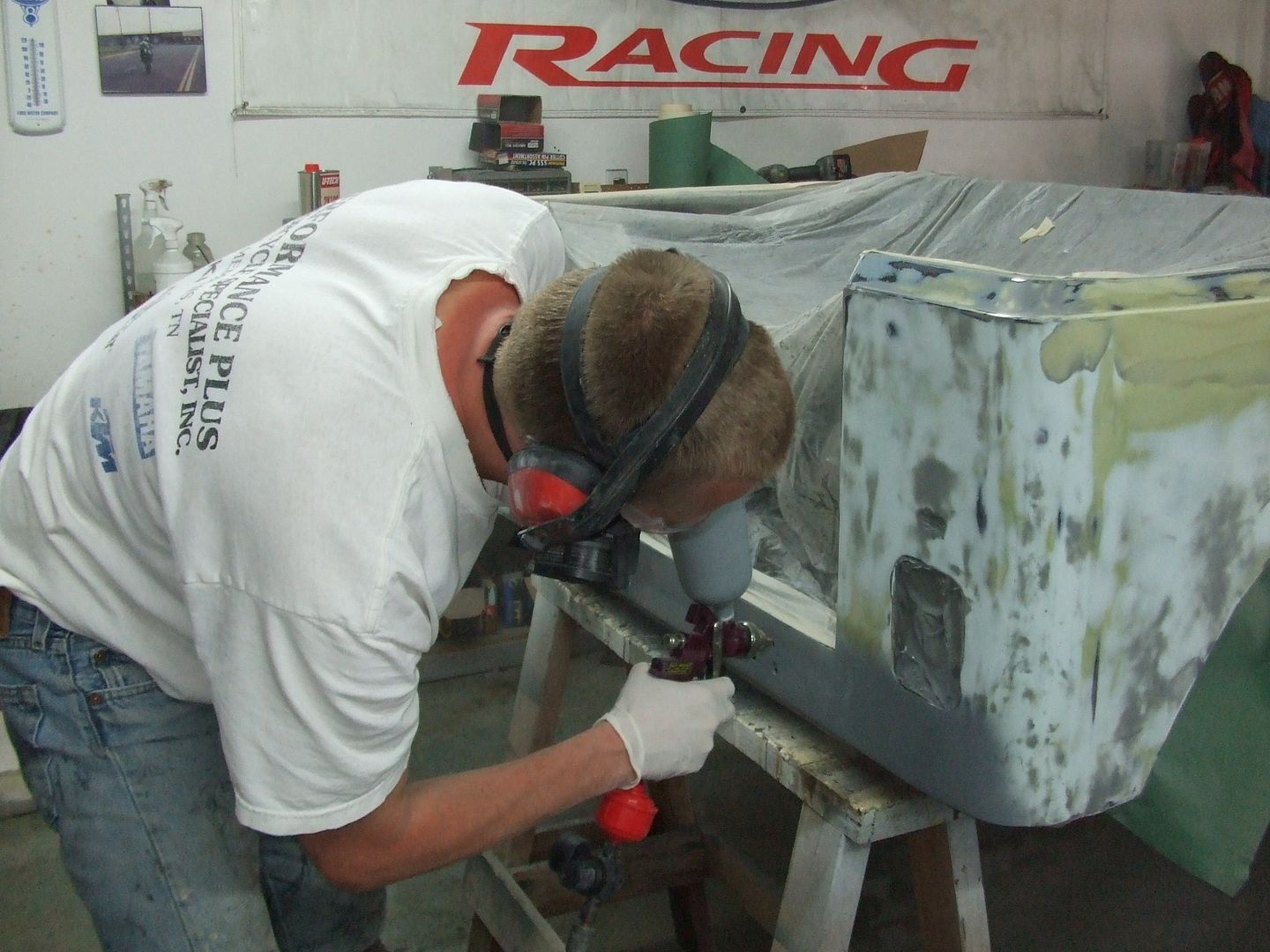

Everyone likes to see an action shot! Notice the fresh sunburn from brewing beer outside for the AHA Big Brew Day the day before. The weather was perfect that weekend for brewing and painting.

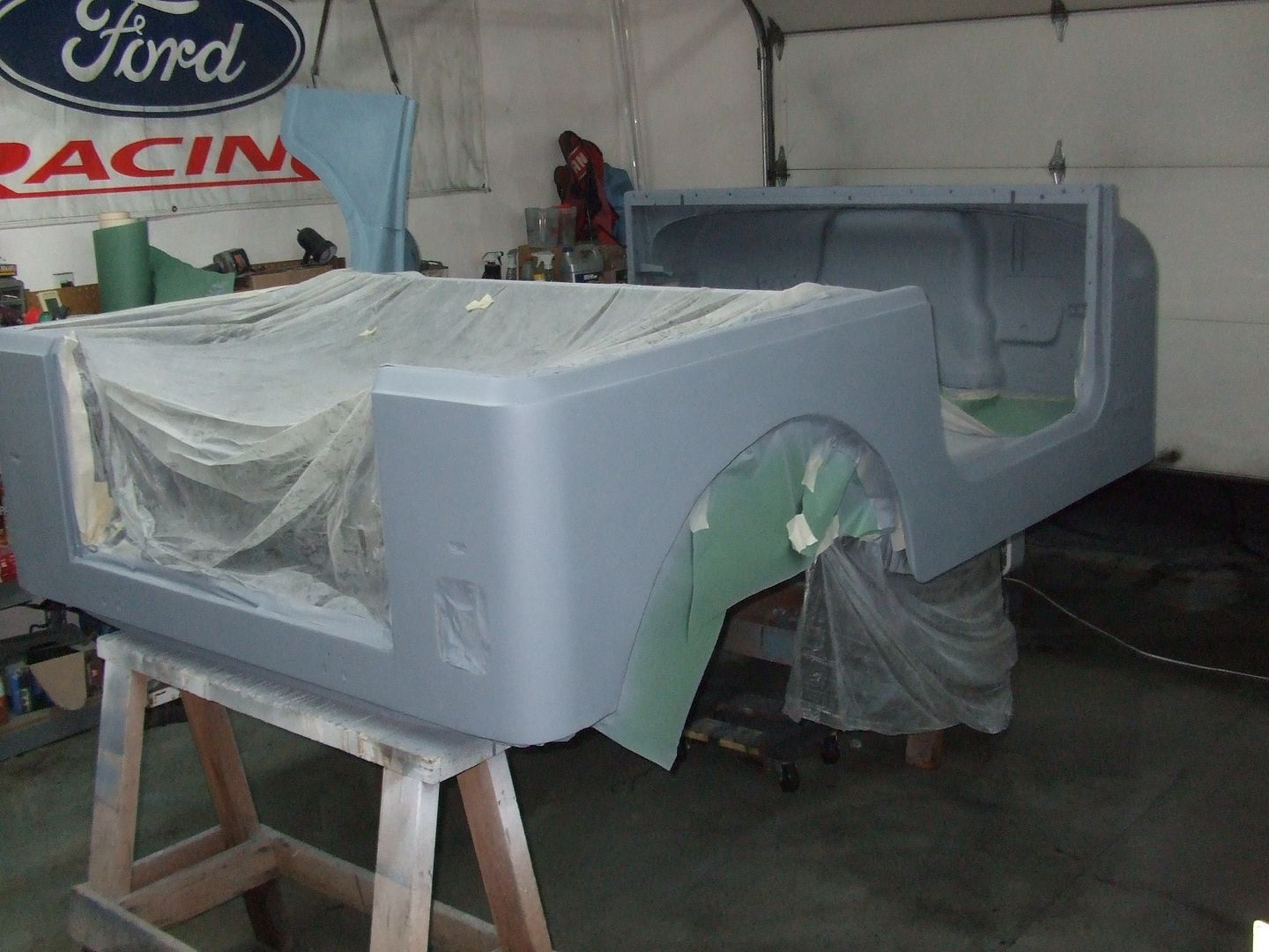

Here it is after three coats of primer, still a little wet as I took this right after I finished.
This picture was taken about one hour after I finished spraying.

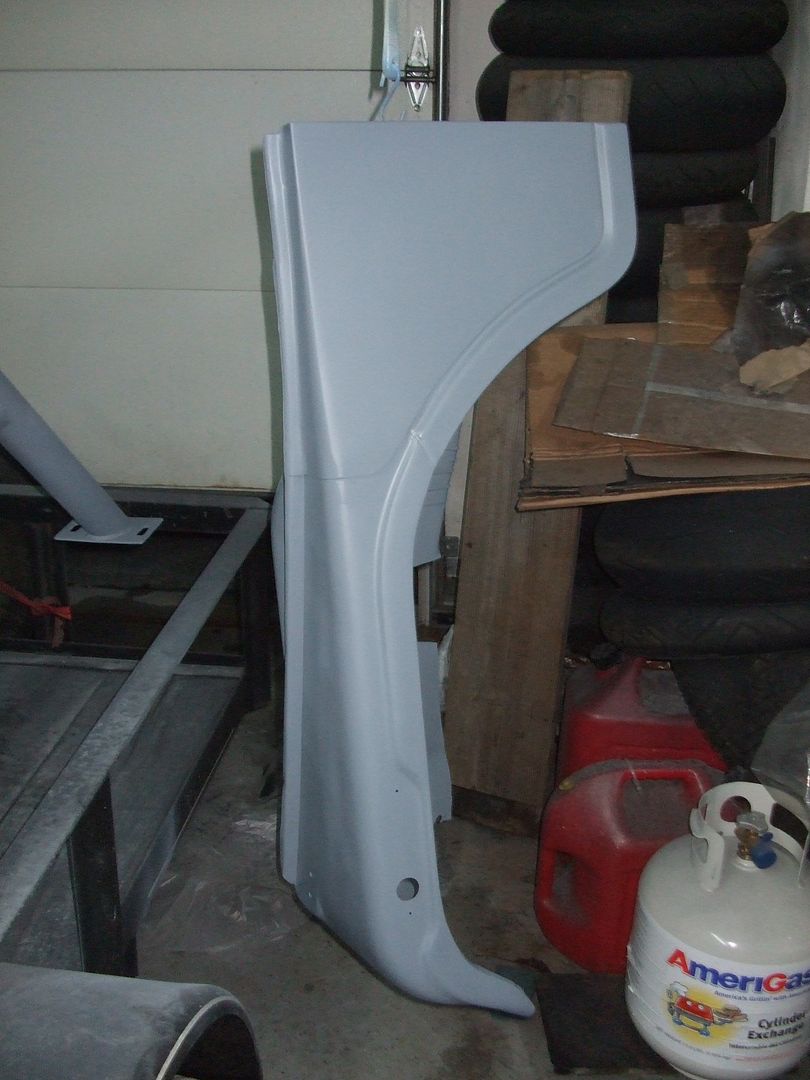

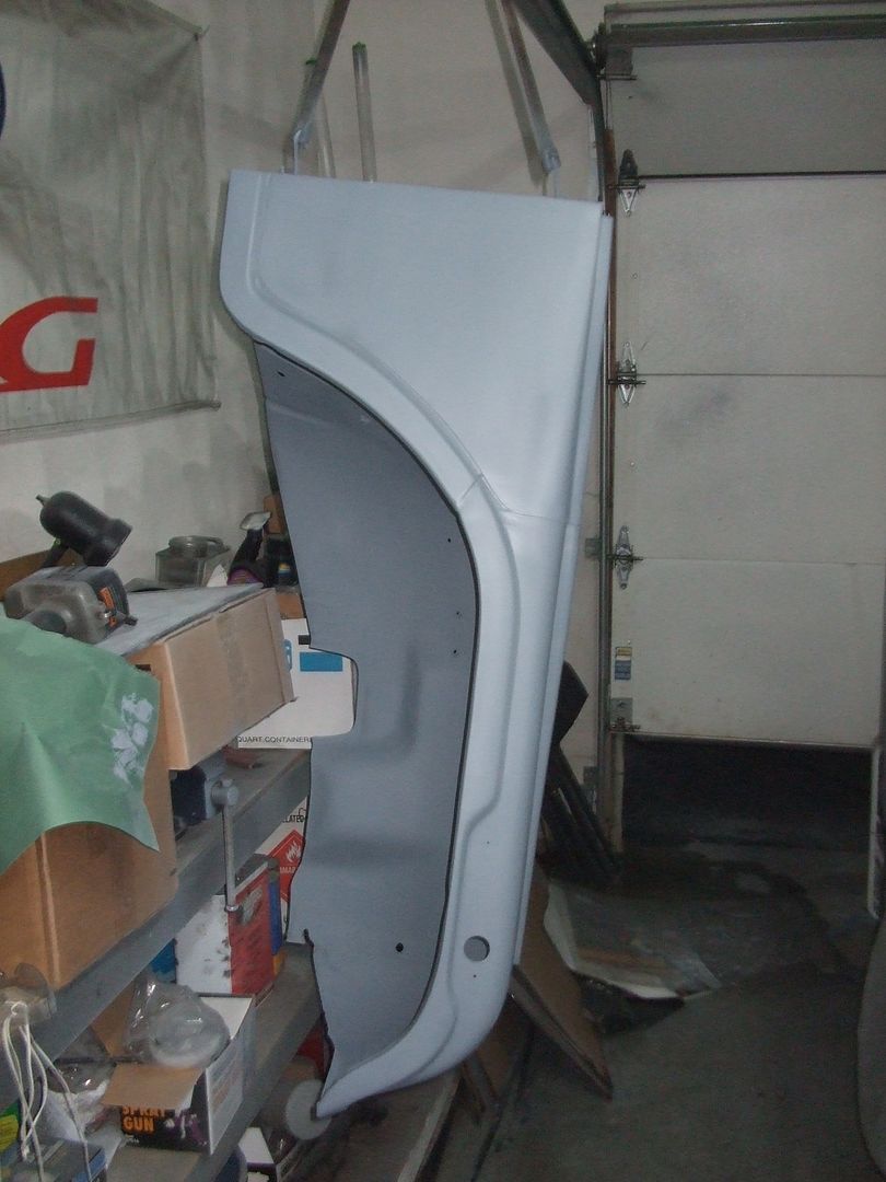

I sanded the fenders with 220 and sprayed three coats on the outer surfaces. The inner and outer fender wells only got one solid coat since they will be scuffed and Raptor'ed. It also helped to save on paint as those things make up some real estate with all three sides. The passenger's side.
Driver's side.

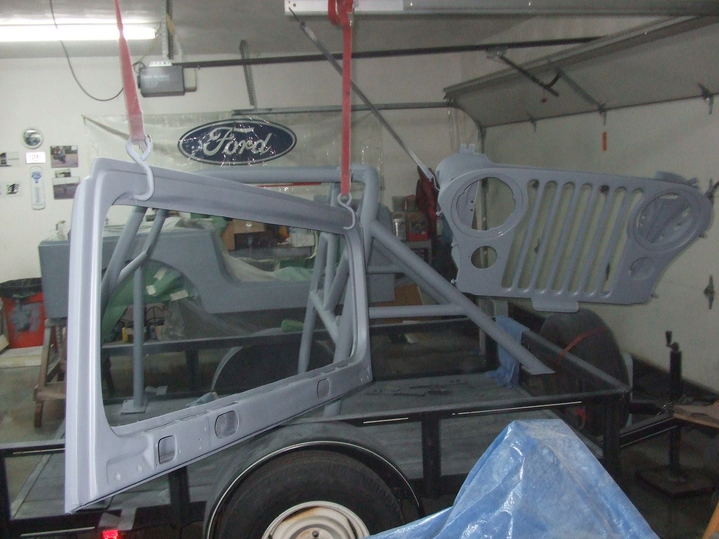

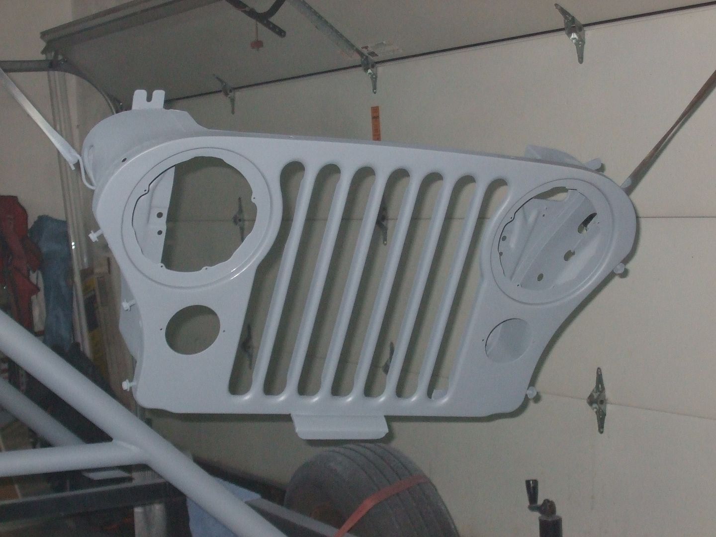

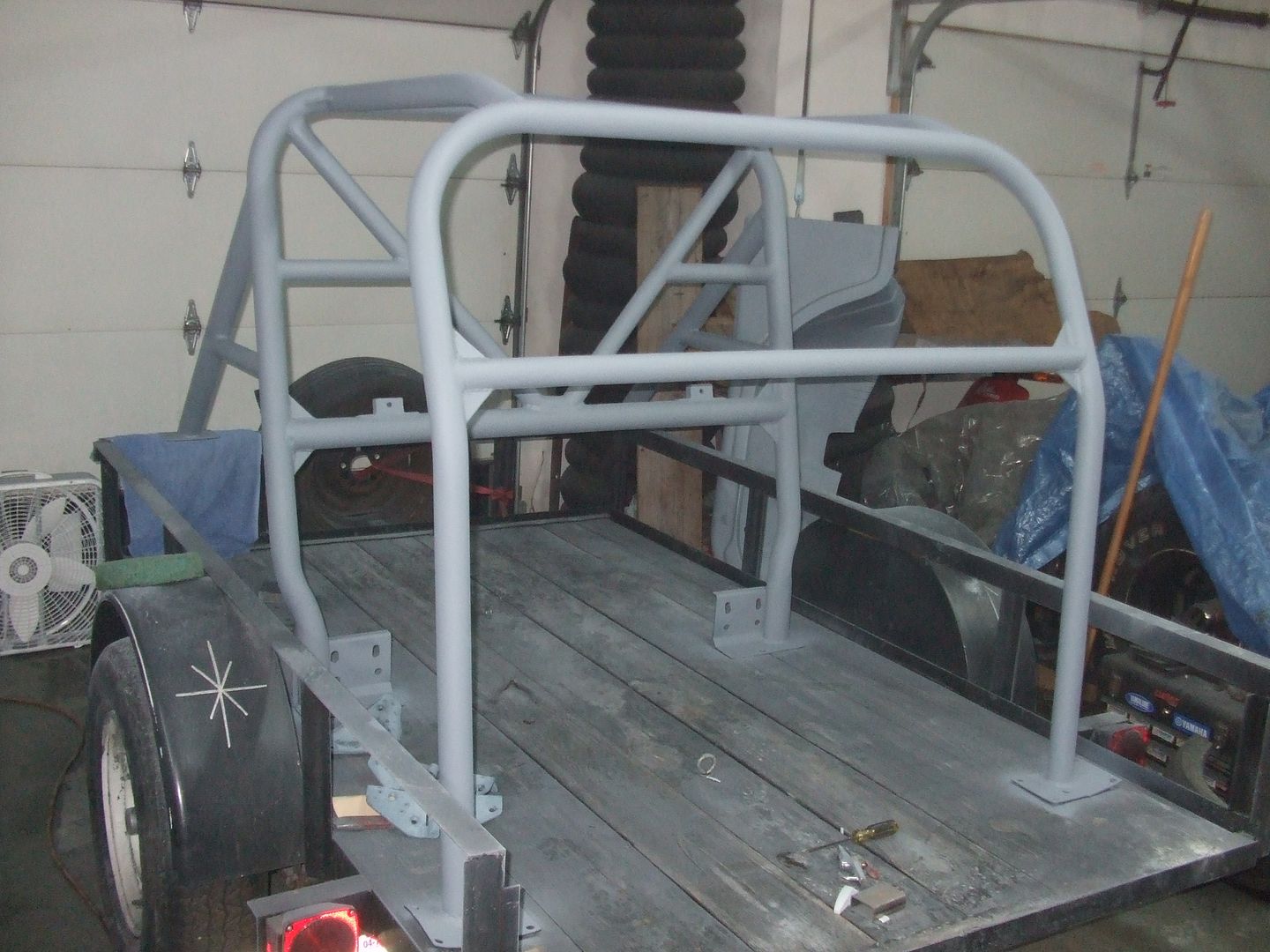

Next part to get the gray was the roll bar.
The grill came out nice. I have two minor spots to touch up.
One of the windshield frame.

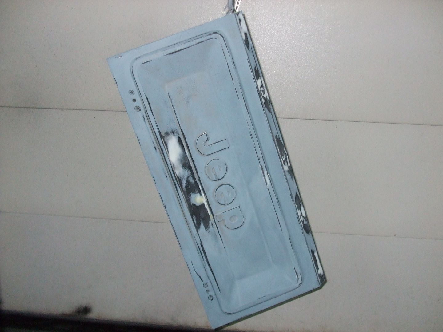

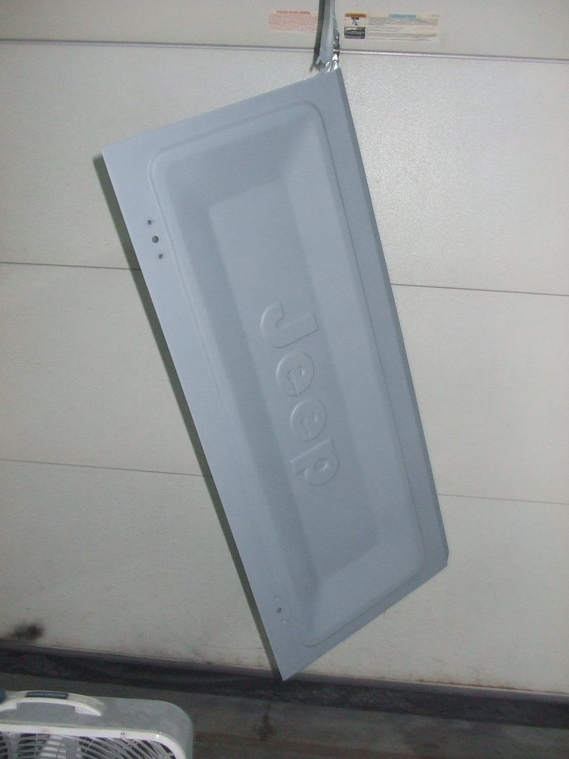

Here is the tailgate all sanded, washed and ready to be shot.
Three coats later.

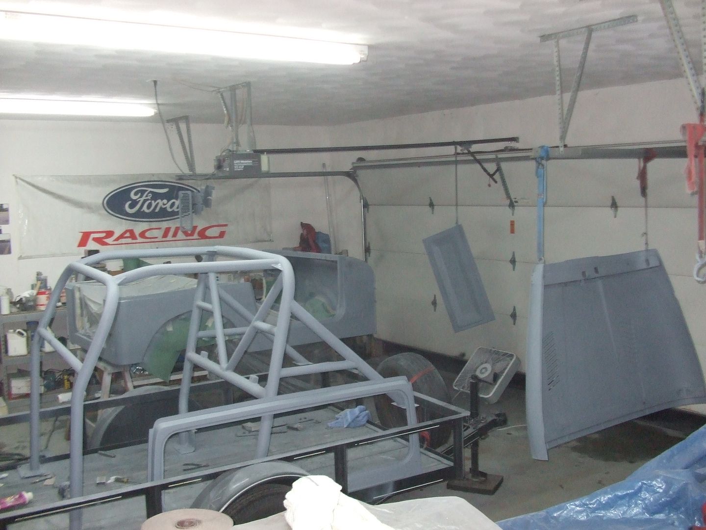

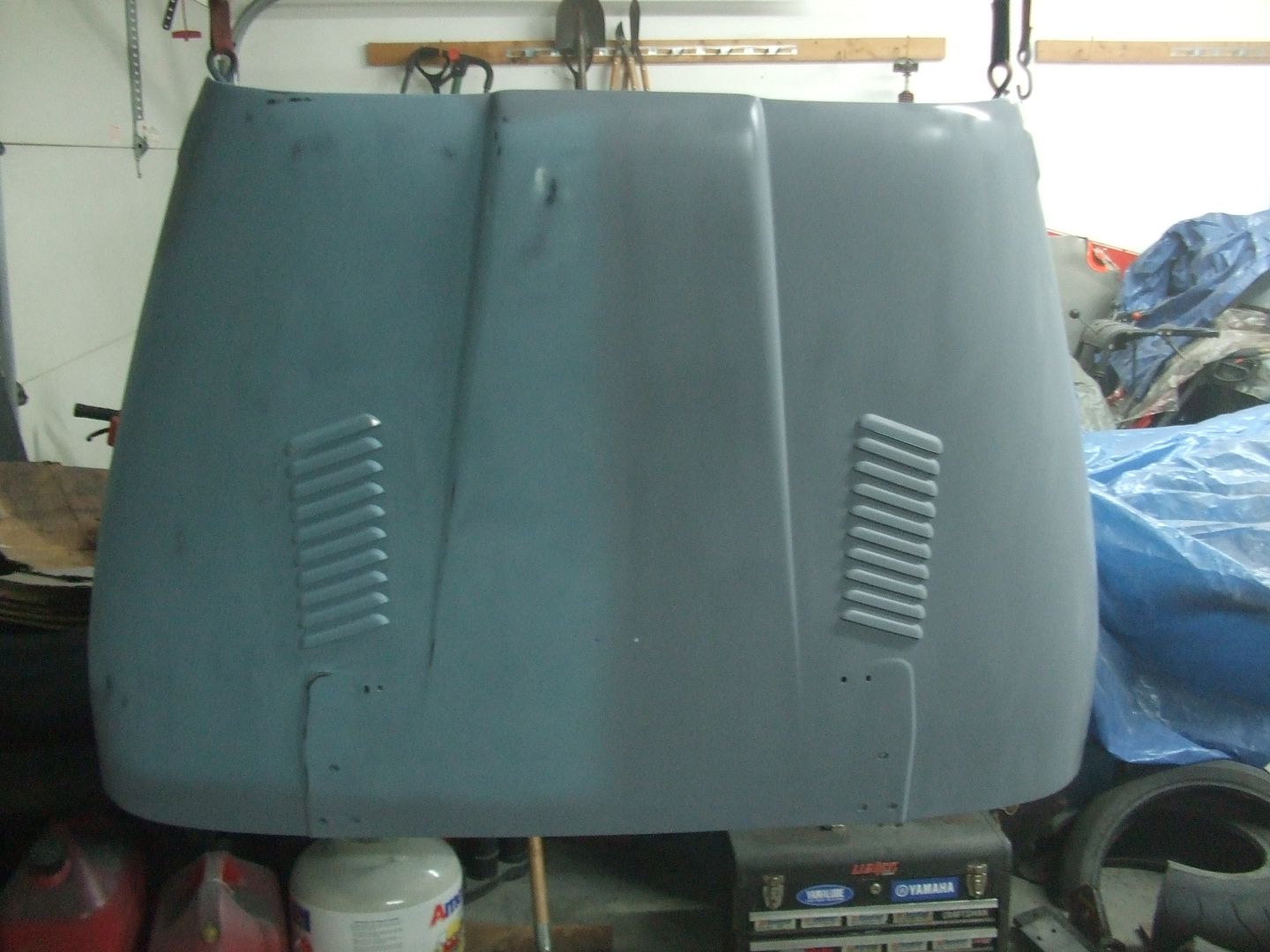

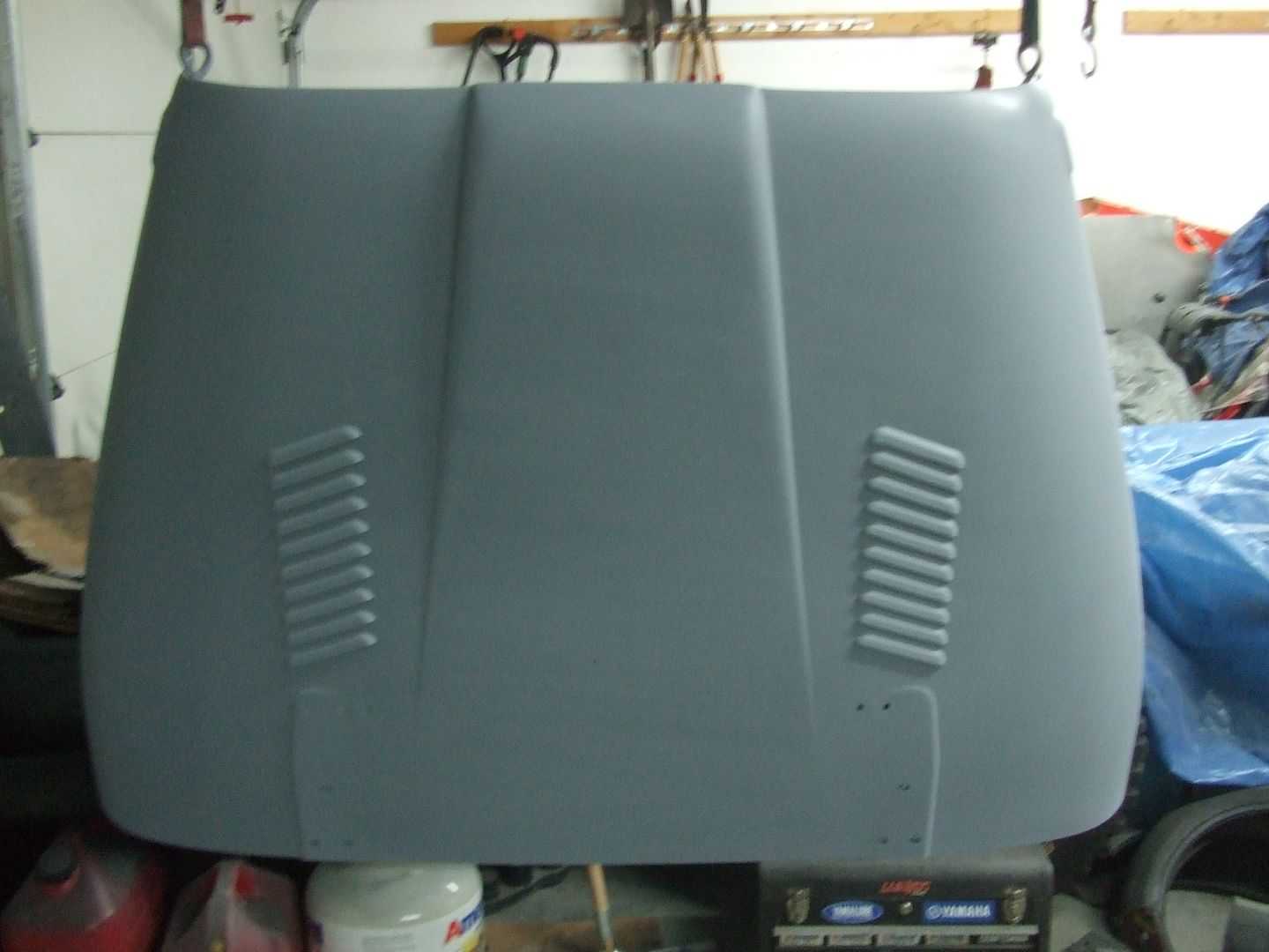

They tell you a 5 minute flash time between coats, the problem is that it takes 5 minutes just to spray half the hood. I was using a 1.4 tip while I should have been using a 1.8.
The hood came out nice.

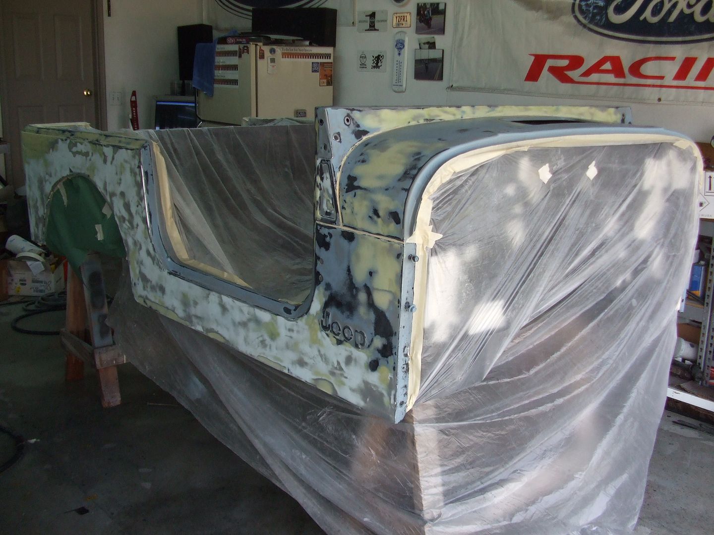

So here is how my garage sat for a couple weeks while on travel for work and a few days off riding my GSXR at Mid-Ohio. Notice there is no dash? I had it hanging in a separate room and spaced it out.
The chassis is basically done and covered with a few layers of plastic ready for me to gather a few friends to help me lift the tub back on. Then it gets the final fitments of all the parts and the last of the final detail touch up work. I'll sand with 400 and then give it two more coats of primer. Final sanding will be with 600 grit before the color and clear. Only a couple more weekends of work before I can paint. I've got a couple committed weekends over the next month and I also have to rely on the weather a little bit but I am getting close.
