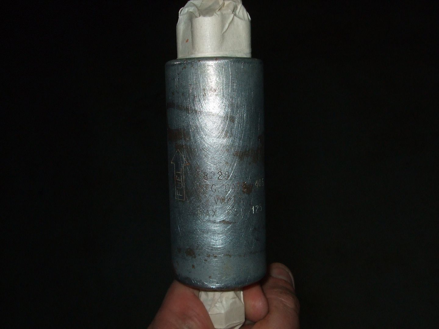

I am trying to finish up all the last little tid-bits on the chassis so I can put the tub back on the frame for final fitment and paint. I got the fuel pump cleaned up and painted. It went from this:
To this with a little cleaning, primer and paint:
Here are the fuel pump and filter installed on the crossmember. All new FI fuel line and SS hose clamps. I put a small piece of rubber around the filter and used a few zip-ties to hold it in place, mainly to prevent rattles.

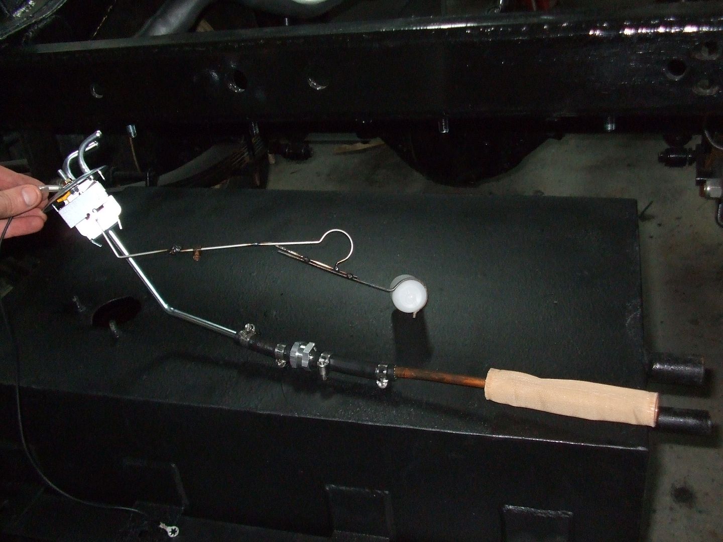

I took the new sender and extended out the lift arm for my aftermarket 20 gallon tank. Before the float arm was cut and spliced back together with small blocks with a set screw, you can still see one on there. I never had much faith in those connections so I removed the arm from the sender and welded them together. You can also see the one way check valve I installed in the pick up line to prevent fuel drain back and potential fuel pump dry run. Got it off eBay for $16 shipped. I checked the resistance readings and made some minor adjustments to the stops.

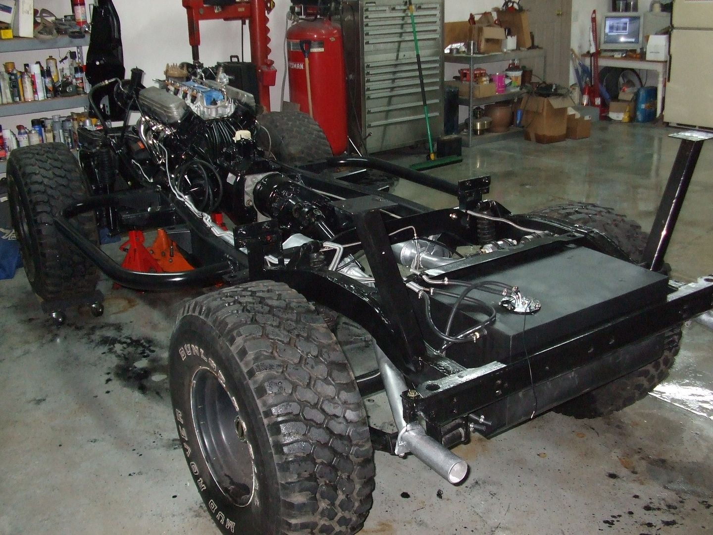

Here you can see the seam sealer I applied to the MORE frame rail reinforcement weld seams, the carriage bolts I welded in for the fuel tank and a few of the lines hooked up. I still needed to paint one of the clamps at this point and give the whole thing a wash.
Here is a picture of where I mocked up my fender well brace with the liquid check valve and my new DeLorean rollover valve. That's all new fuel hose and $30 worth of SS hose clamps. I cut a few of the hoses a couple inches longer than needed so I can trim them to perfect length once the body is on. Notice I used the 5/16" line as the fuel return and converted the 1/4" line to the canister vent system.
Now that the chassis is basically done I can go ahead and put the tub back on the frame for final fitment, filler and paint. I just need to finish a little filler work on the fenders and windshield frame.

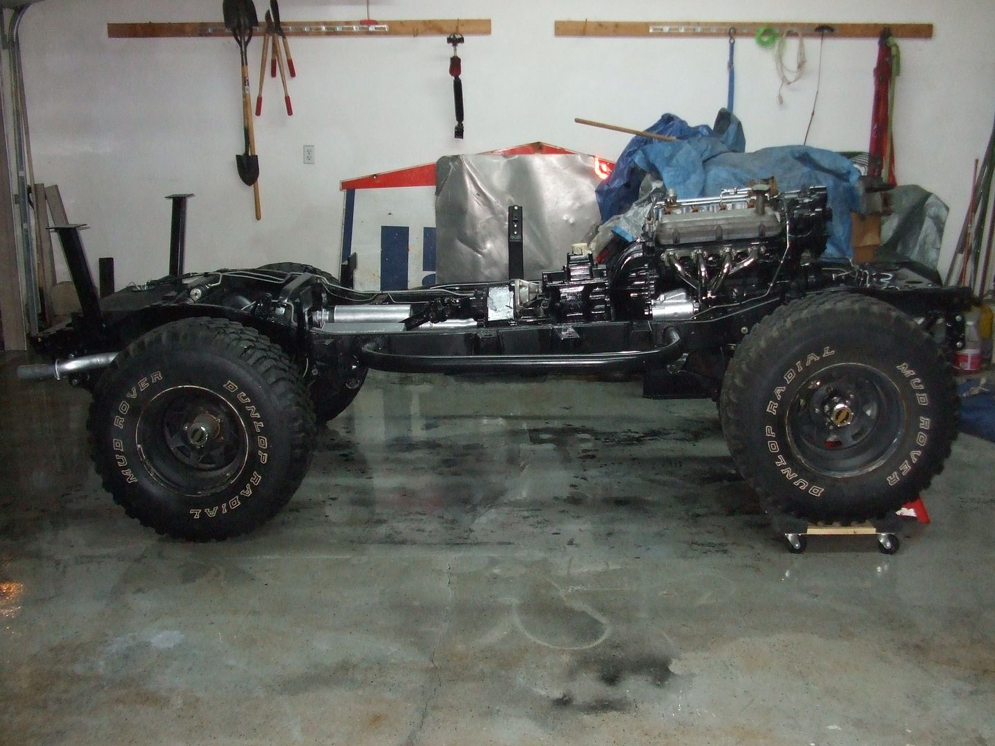

Got the garage cleaned up last night and gave the chassis a quick wash. Just need cover it in plastic and get a couple extra hands to help put the tub back on the frame.

What type of fuel filter did you use?
CJ7-1986 is offline
post #220 of 1946 Old 04-21-2010, 03:32 PM
motiv8ya
1979 CJ7
Location: Las Vegas
Posts: 1,020
Do you have a part number for the fuel sender? I just picked up the same tank and don't have a clue what sender to use.
motiv8ya is online now
post #221 of 1946 Old 04-21-2010, 05:07 PM Thread Starter
Coiz
1979 CJ7
Location: Northern, IL
Posts: 4,228
Originally Posted by ErikEastman View Post
Feels good to clean the garage out doesn't it? It's like hitting the reset button on the project.
Yes it does and yes it is.
I used a Fram G7248. I just searched through the high pressure fuel injection filters until I found one with the 5/16" fittings and about the size I was looking for. It is for 1991-96 Dodge Dakota's all the way up to their 5.9L/360ci D350/W350 gas trucks.
I ended up ordering the Fuel Sending Unit Kit by 4Wheel Drive Hardware Part #KIT5357373K. I was really tempted to order this one to try and avoid having to extend the arm but wasn't sure of the fitment as it says for 20 gallon plastic tank only. ??? I figured it would work but didn't want to take the chance of it not and having to deal with the time and effort to return it. My tank came with the extra little extension arm and the little set screw couplers when I bought it ~12 years ago. I lost one of the couplers so I resorted to the welder. I had to remove the arm from the sender first as to not damage the potentiometer from the welding heat.
Mike
Coiz is offline
post #222 of 1946 Old 04-22-2010, 10:01 AM
wanabejeeper
1987 YJ Wrangler
Location: NJ
Posts: 549
The two 20 gal senders are just a bit different. The old 20 gal plastic sender cj 87-89 yj has a square cover and is not really available any more. The mid 90s FI YJ's has brackets for the fuel pump and a square cover. It can be ordered without the pump to use in the older square hole cj/yj's. If your aftermarket tank is 20 gallon and round hole you want the 15 gallon sender. The tanks are identical except for the hole. They put a long vent line into the tank to reduce the tankage from 20 to 15 from about 90-94. Eventually they went back to two tanks a 20 and 15.. the 20 retained the square hole... In short there are no aftermarket round hole 20 gallon senders

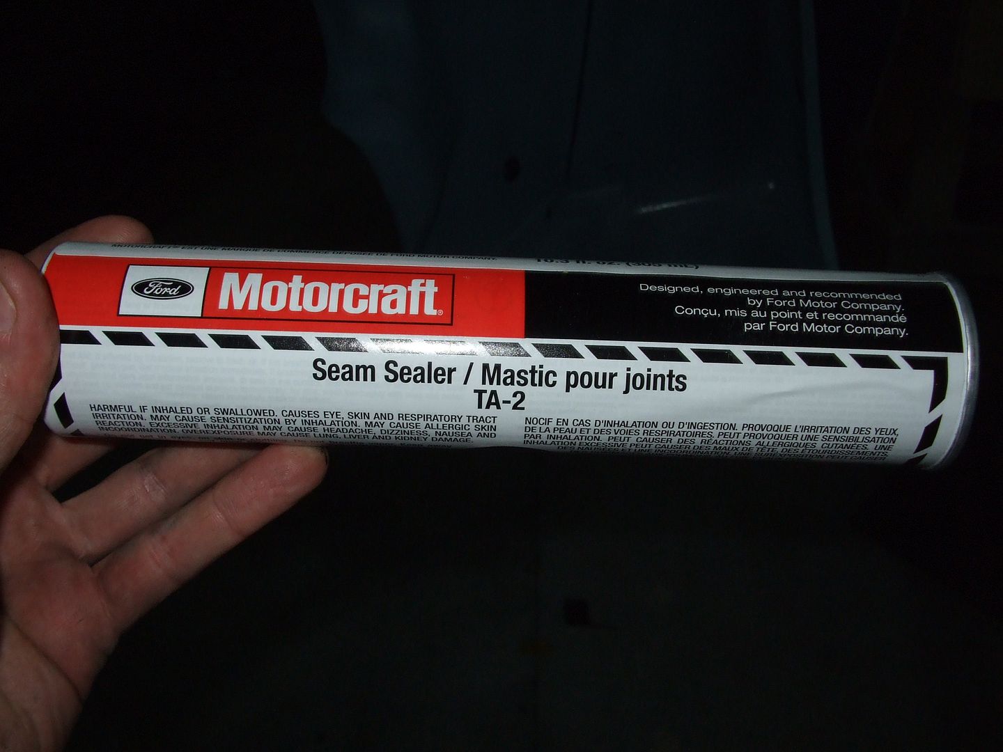

Originally Posted by Coiz View Post
... To get back to the Jeep. I used another tube of Motorcraft TA-2 Body Seam Sealer to seal all the places I could get to where two or more pieces of metal are joined. This stuff retails for $45 a tube but I can get it for $27. If you can't get the Motorcraft I know that 3M also makes some good stuff. I used two tubes on the tub and one more for the rest of these parts...
Mike- Thanks for the pics and heads-up on the seam sealer... 'preciate it. The sealer gets hard enough to sand? The small bead on your fender exterior looks very good after primer.
