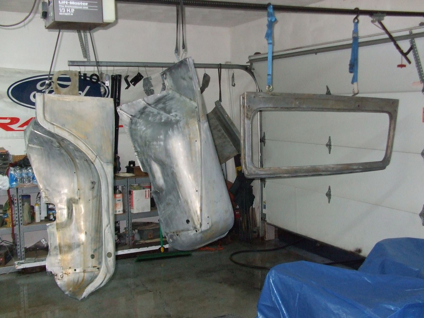

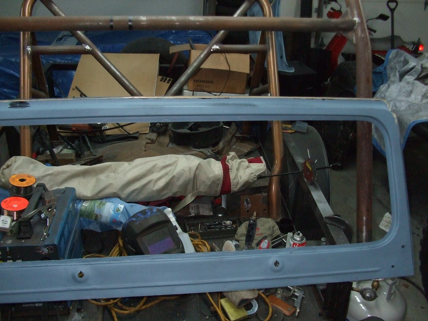

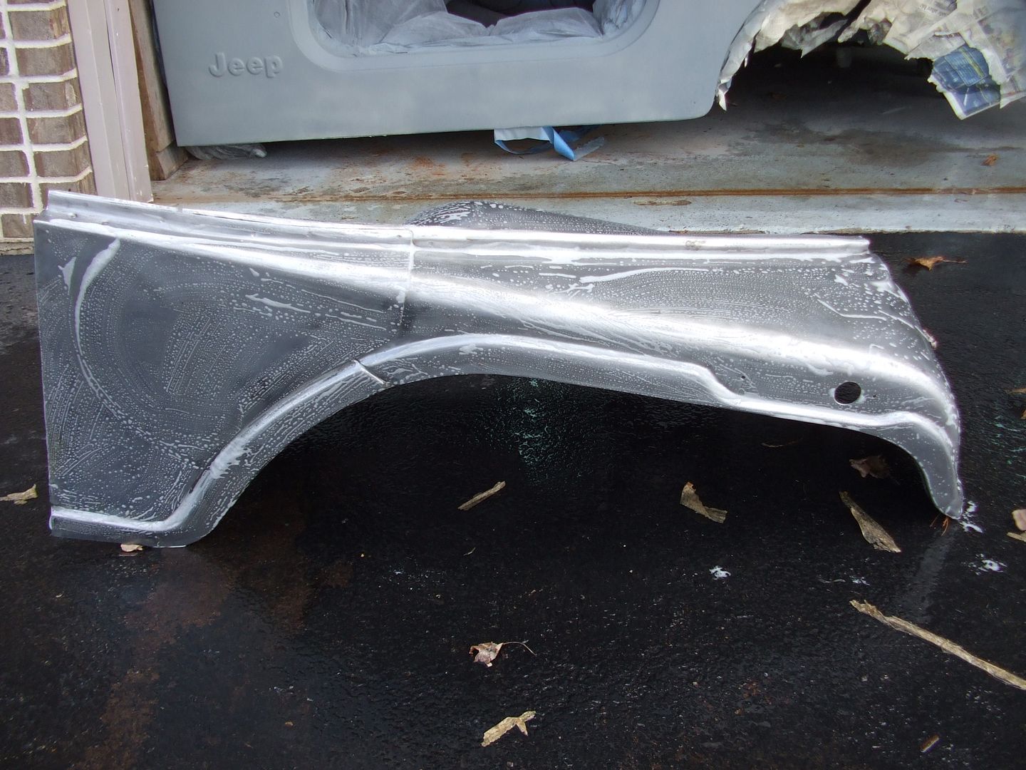

I did some more work on the windshield frame and front fenders. I used Marine clean to wash and degrease the parts.
Once they were clean I let them dry then soaked them with Metal Ready for about 30 minutes. I dried them off and used a hair drier on all the pieces to make sure they were bone dry and no water left in the seams or between panels.

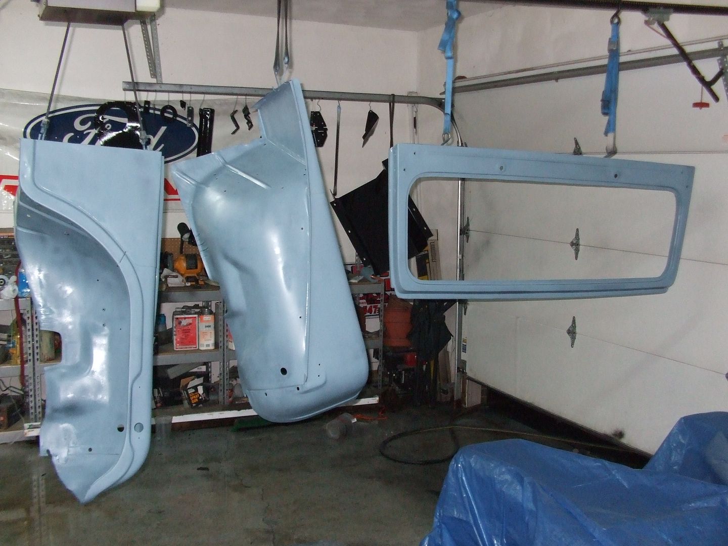

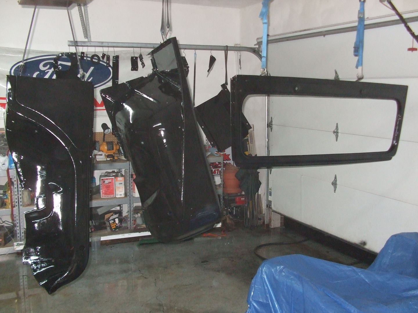

Next came two coats of POR15. This was after the first coat.
Then they got a coat of Tie-Coat primer.
Now I have to apply body seam sealer to all the parts and give them another coat of primer.

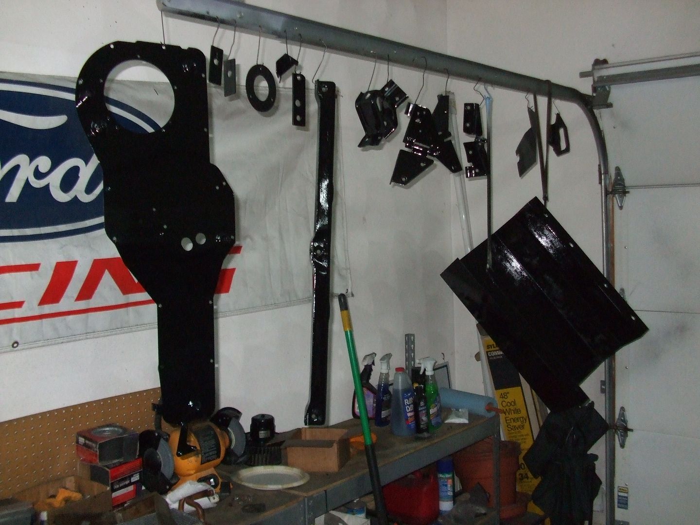

Here are a few other parts that got some POR at the same time. From left to right; heater case backing plate, Oh sh!t grab handle backing plates, fuel sender plate, clutch linkage brace, rear seat mounts, windshield hinges(yes, there are three), gas tank skid plate and my charcoal canister mounting bracket.

Ha, that has happened with some motorcycle stuff but not with any Jeep parts (yet). If you notice the garage door is cracked. That's the universal sign to the GF to never activate the door if it is cracked. If it's cracked, it's because I wanted it that way! Don't touch it!
Once the parts are well past tack I move them to another area to cure. Only a few more weekends of dirty work, then I get to reassemble.

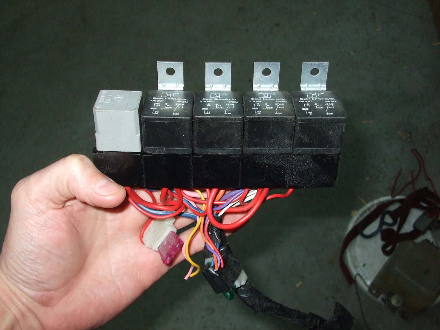

I have acquired several different sections of wiring harnesses and relay boxes in my travels with work. I plan to go through the Mustang engine harness pin by pin to eliminate any of the unneeded circuits and shorten them to the correct length. The Mustang and the CJ have the batteries in the opposite corners so that makes for extra length for a lot of the harness. Just about everything will have a dedicated ground. I plan to use a relay box I got to power the headlights, PCM power, fuel pump and both cooling fans. I'll probably try to find another 3-5 relay box for fog lamps, hi beams and anything else that might get added on later.
As far as the Jeep's body harness I'm not quite sure what I'm going to do yet. I might save what I've got and just clean it all up or maybe just buy a new fuse panel and wire it. I don't think I want to go with Painless or the like because most of those harnesses are for the engine which I don't need or can't use. I'm planning to strategically wire up some LED lights around the interior up under the dash and under the lips of the rails in the back area. Place them so you can't see them but make it so I will actually have some interior lighting. The best I had before was one of those flex map lights you plug into the cigar lighter, it sucked. I'm thinking 4-6 of these should do the trick.

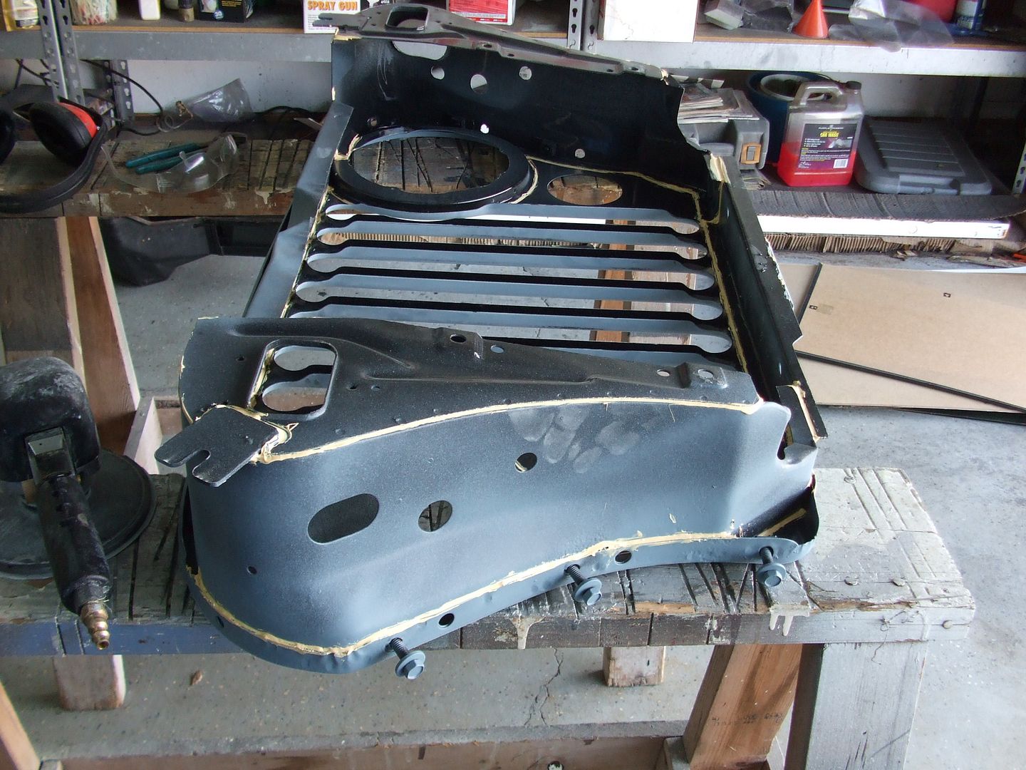

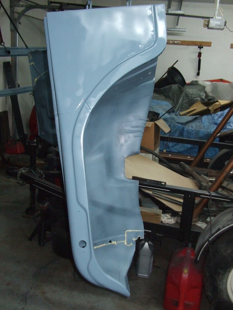

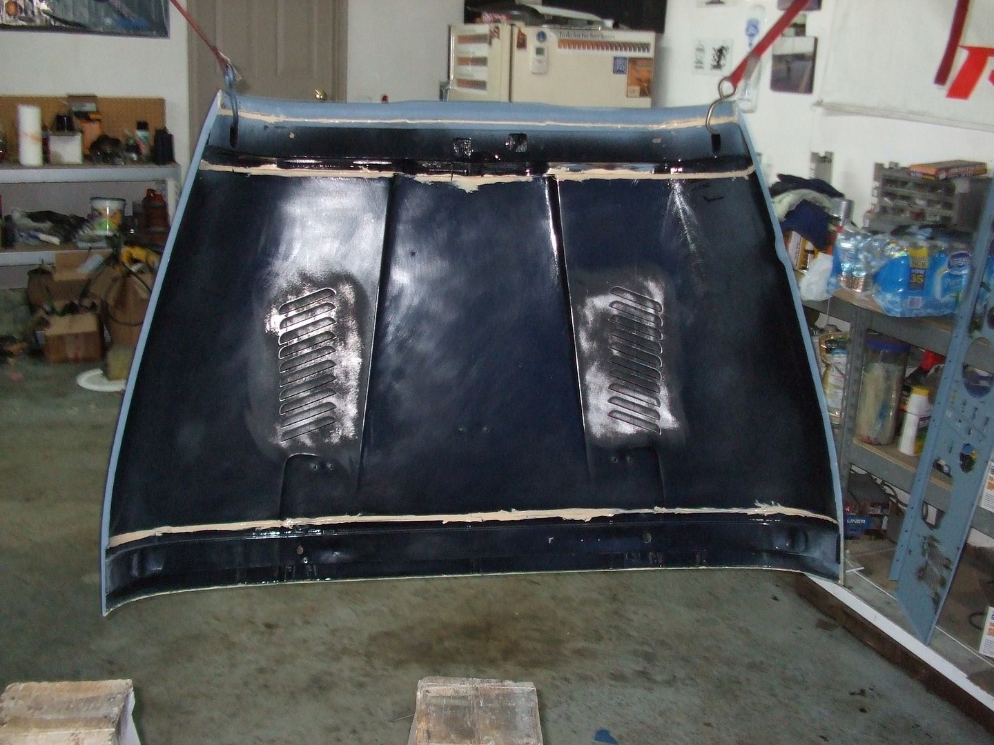

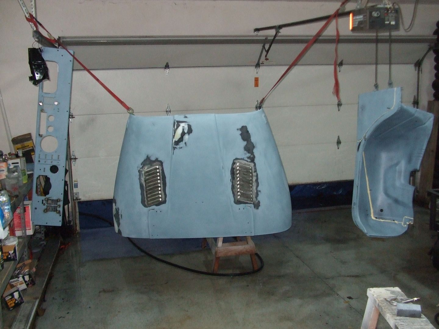

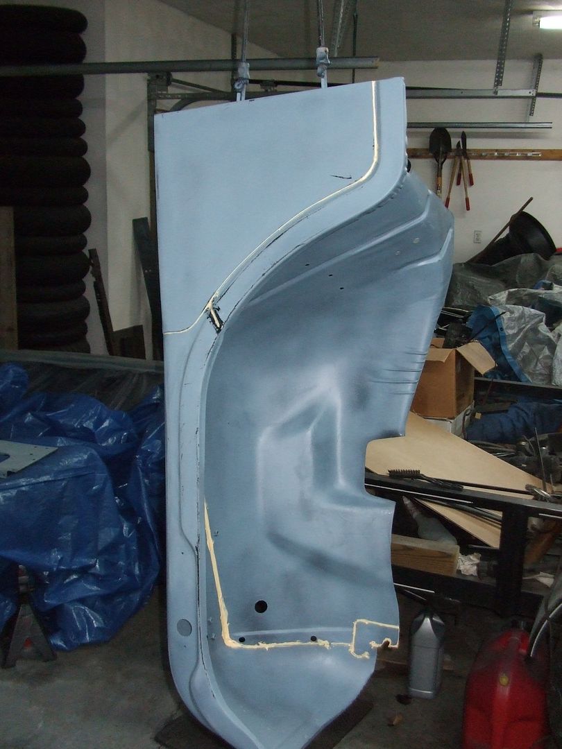

To get back to the Jeep. I used another tube of Motorcraft TA-2 Body Seam Sealer to seal all the places I could get to where two or more pieces of metal are joined. This stuff retails for $45 a tube but I can get it for $27. If you can't get the Motorcraft I know that 3M also makes some good stuff. I used two tubes on the tub and one more for the rest of these parts.

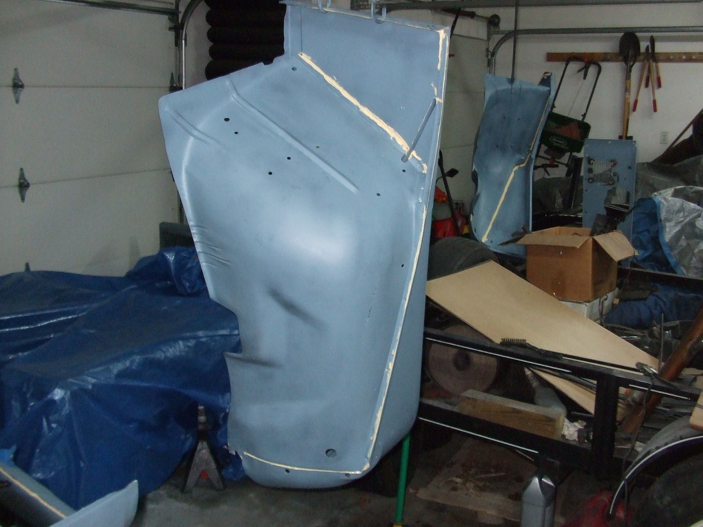

I just started applying the sealer to any seam I could find. Notice the other fender in the background. I saw where I missed a small seam right after I took this picture. I looked over every piece three times after that.
Another angle from the side. It takes a little practice to get those fine little edges. That seam sealer is some thick, nasty sticky stuff.

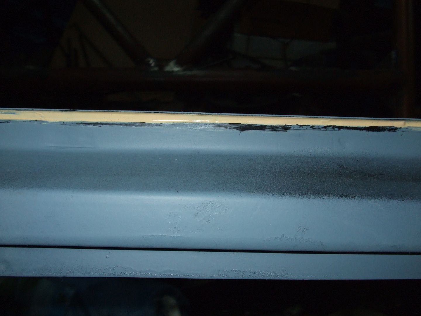

I also went around all of the seams on the windshield frame.
No water getting into that seam.
I also hit all the seams I could get to on the front grill.
I hit some seams on the hood as well. By this time my hands were getting pretty tired from pumping that caulking gun and the gaps on the hood were fairly large so I just took off the needle tip and applied it straight from the tube. I'll sand off any excess before I apply the next coat of primer to it.
After the sealer had set I went back and put another coat of primer on some of the surfaces. I wanted to hit all the seams and anything showing filler or bare metal. I was running low on Tie-Coat primer so I had to be fairly selective on what got more paint. Here are a few of the parts getting some additional paint.
This turned out really well once it all dried.
Here is how the seam sealer is going to look under paint.
At this point everything is dry and needs to be sanded. Time to head out to the garage to sand and apply body filler to all of these parts. I'm hoping I can get the rest of the filler work done today but there are a lot of pieces. Then I just need to check final fitment before I start applying the 2k paints.
