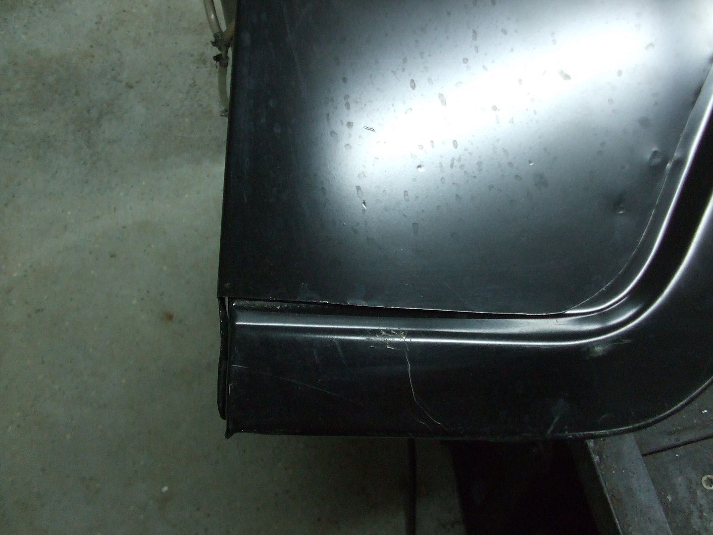

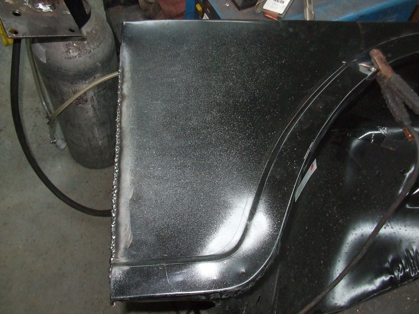

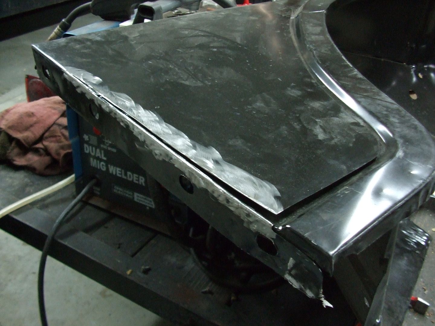

So I finally pulled my new front fenders out of the box and quickly noticed a problem with the passengers side. There are two main pieces that are welded together to make the main fender and a third piece that is essentially a cap that covers up most of the mating line of the main two pieces. It looks like this cap piece was not held in the correct place when they spot welded it together. This caused a 1/4" gap at the bottom fender where it mounts to the firewall. There was no way I was going to leave it like this and returning it for another was no longer an option since I bought them almost 2 years ago. It doesn't look like much in a picture but would surely look like crap on the Jeep.

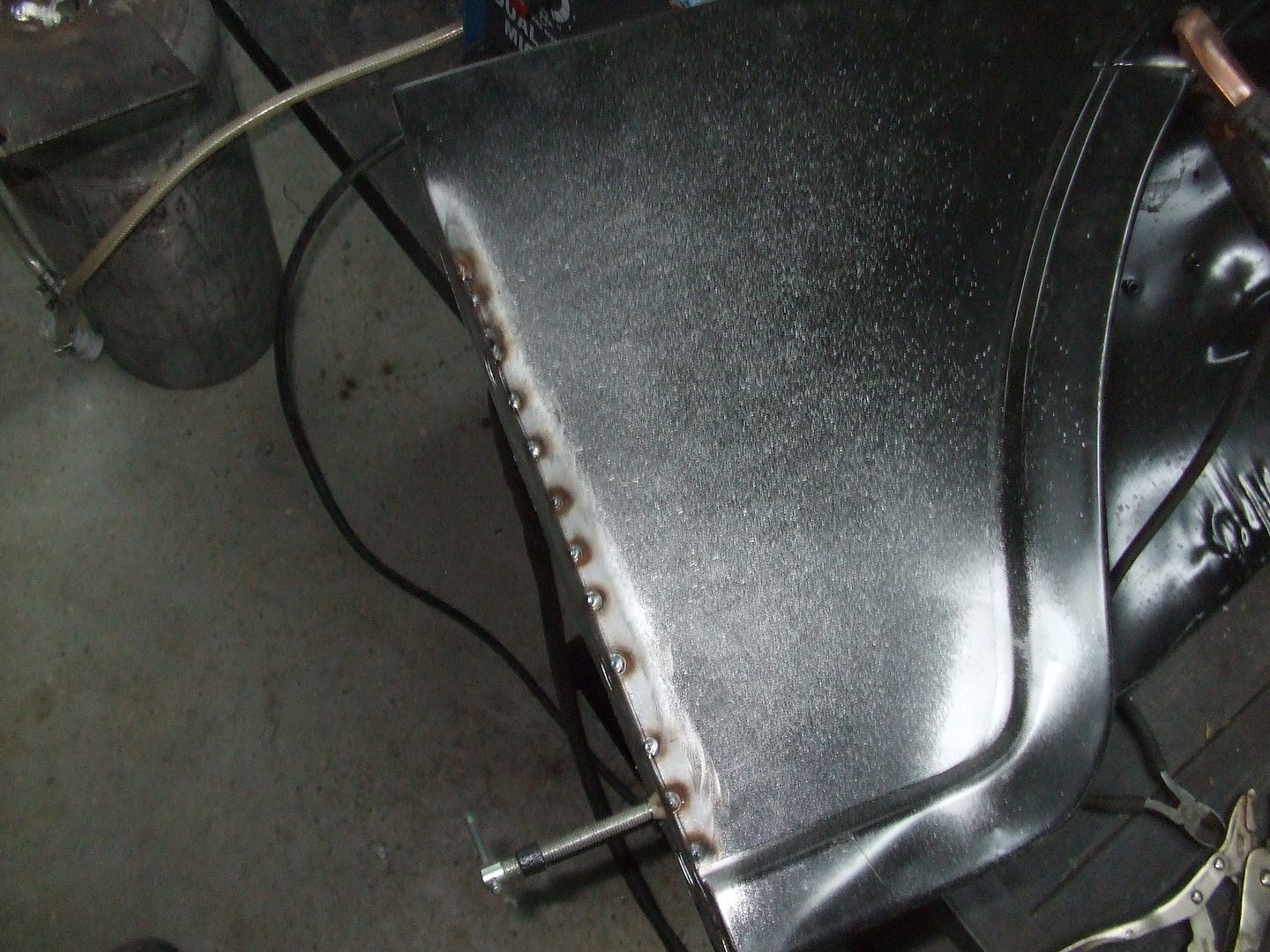

I talked it over with the guys I met at the hotrod shop and we figured that I either needed to drill out every spot weld and completely remove and reinstall the piece or make a relief cut on that edge and remove the gap that way. I decided to go with the relief cut option since there were a lot of spot welds and several on curved surfaces. So I made a relief cut most of the way up the edge and ground off the excess metal.

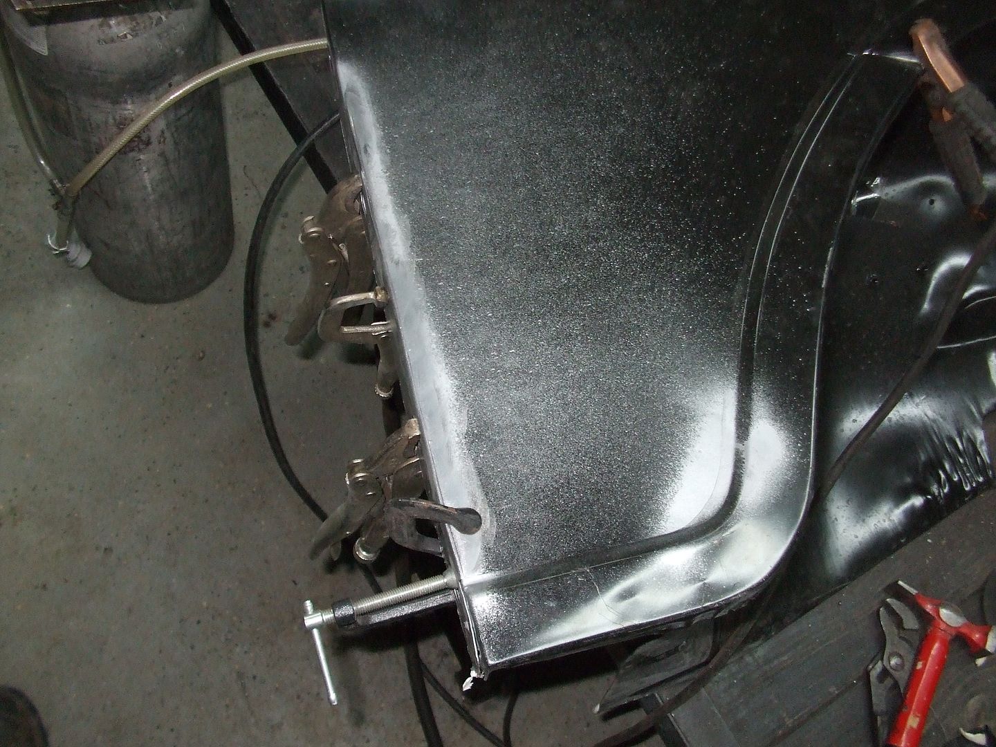

I shot some weldable primer under the seem and clamped it into place.
All tacked into place.

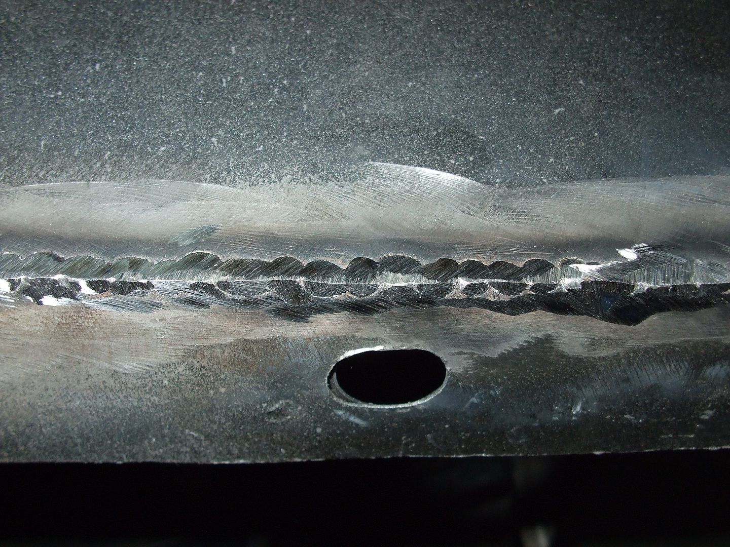

Completely welded up.

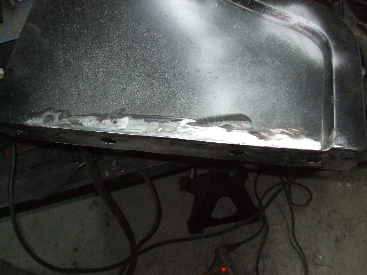

Here is where you act like a surgeon with the angle grinder. Just enough to knock off the welds without hitting the base metal.
Follow that up with a 120 grit flapper disk and call it a day.
I looked the fenders over pretty well and added in a few tack welds in places where they had poor welds and places where they were really unevenly spaced out. I also got some work done on my dash but didn't quite get it finished. I'll post that up once it is done. Slowly plugging along and one less day of work needed before I can apply paint.

post #184 of 1946 Old 03-22-2010, 01:00 PM
longboy
2006 WK
Location: Longmont, Colorado
Posts: 952
I'm not a body man, but I'd recommend sealing up that front edge with some seam-sealer or equivalent. When I pulled off my OE fenders, there was gobs of rust happening where those two pieces sandwich together. Kinda a weird design. The build is looking good, keep up the hard work!

post #185 of 1946 Old 03-22-2010, 01:14 PM Thread Starter
Coiz
1979 CJ7
Location: Northern, IL
Posts: 4,228
Yeah, that is the typical place for them to rust. I will seal every seam on both fenders inside and out with Motorcraft TA-2 body seam sealer. Thanks for the comments.

Yeah I seam sealed everything I could on mine, especially overlapping sheet metal that will constantly be getting wet like those fenders.
Good fix!

post #189 of 1946 Old 03-26-2010, 07:47 PM
ErikEastman
1986 CJ7
Location: Maine
Posts: 349
You would use an angle grinder for that. Those discs you are talking about with the overlapping layers of sandpaper work pretty good.

post #190 of 1946 Old 03-26-2010, 10:00 PM Thread Starter
Coiz
1979 CJ7
Posts: 4,228
I used a 4.5" angle grinder with a 1/4" thick metal grinding wheel to grind down most of the welds. I used 120 grit flapper disk for the final sanding with the angle grinder. From there I would hand sand or DAO before paint. This is a flapper wheel:

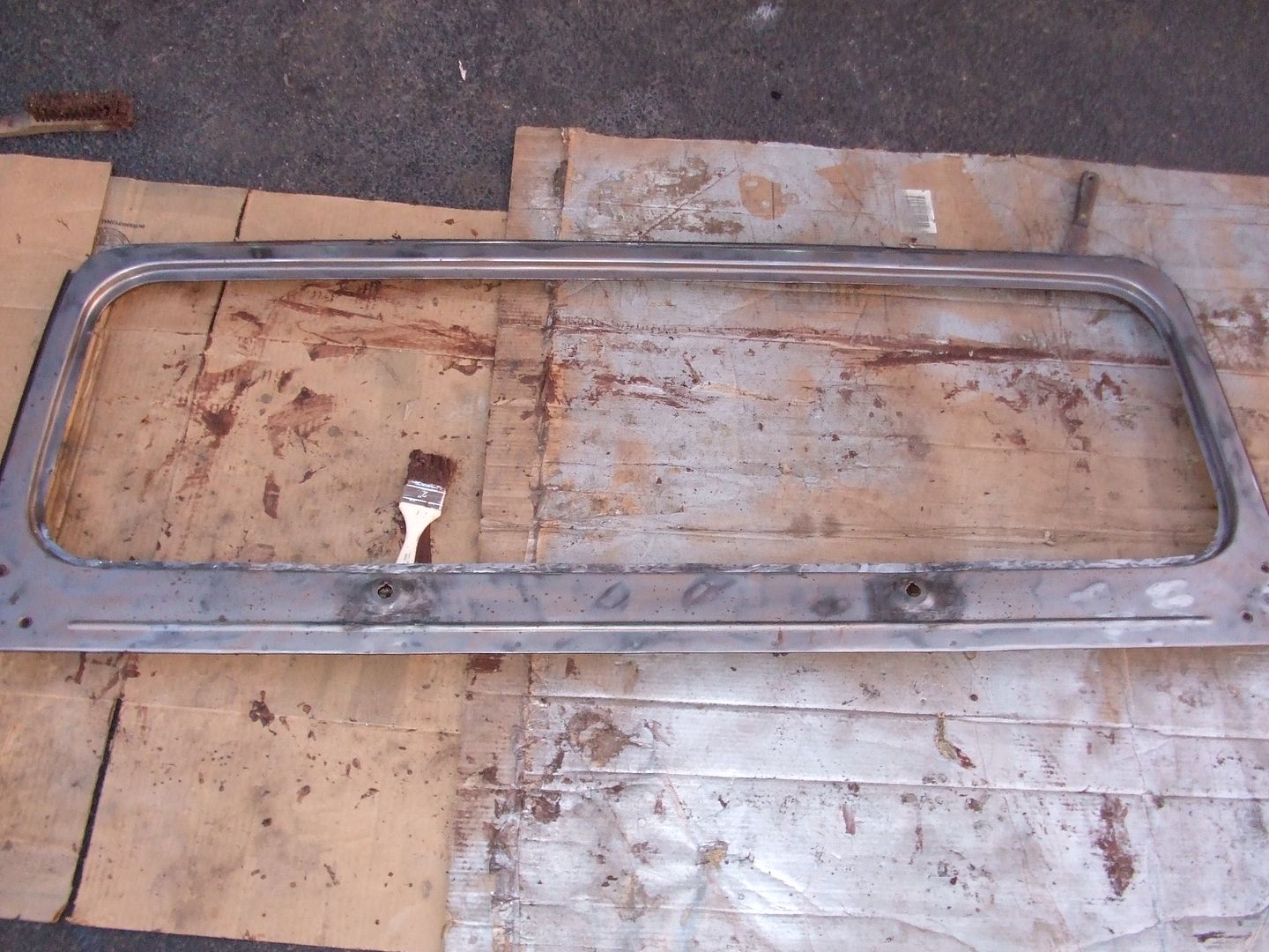

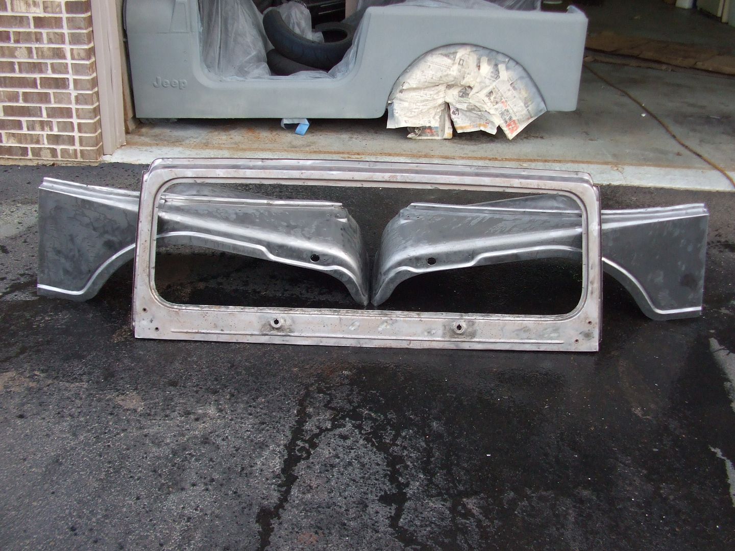

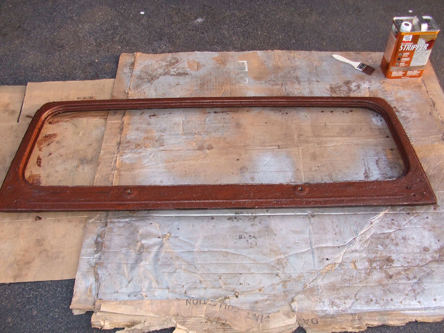

Windshield Frame and Front Fenders
I started on my final prep to paint the windshield frame and the front fenders. Here is the windshield frame with a coat of paint stripper on it.
Here it is completely stripped of paint.

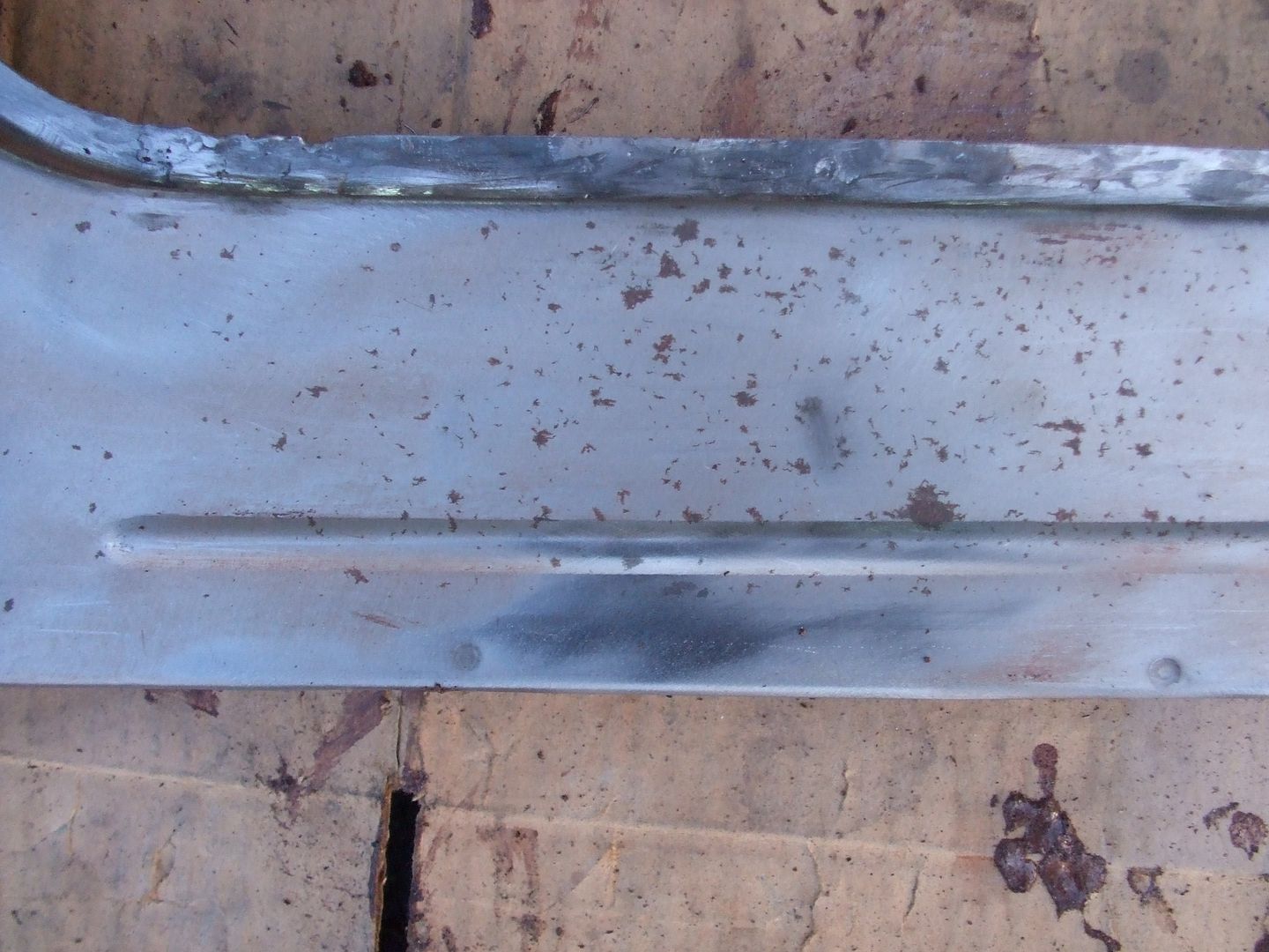

There were quite a few small rust pitting spots on the front of the windshield frame. I will sand these out just before I perform the final cleaning before paint.

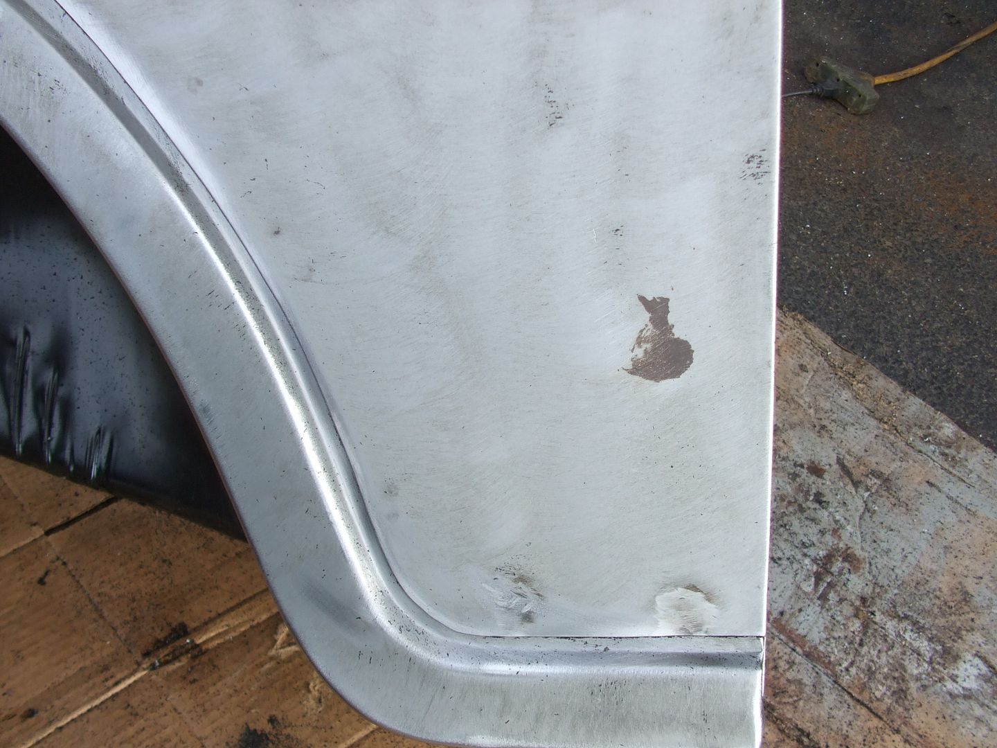

I was contemplating for a while whether or not I wanted to strip the primer off of the new fenders. I finally decided I had enough paint and might as well stay consistent with the rest of the body panels. Here is one soaking in paint stripper.
I'm glad I did strip them down because I found a couple of spots of rust under the primer on the driver's front fender. This would definitely be bubbling paint ten years from now. I expect this rebuild to last another thirty years.
Here is another area of rust that will need to be sanded completely out. I'm really glad I decided to strip these down because that is cancer waiting to happen.
So here they are all stripped down and rinsed off. I'll sand them down to remove any of the remaining rust spots before I clean and paint.
It is supposed to rain tomorrow which is not good for POR application but I have plenty of other things to work on. I should have another update or two from this weekends work.
