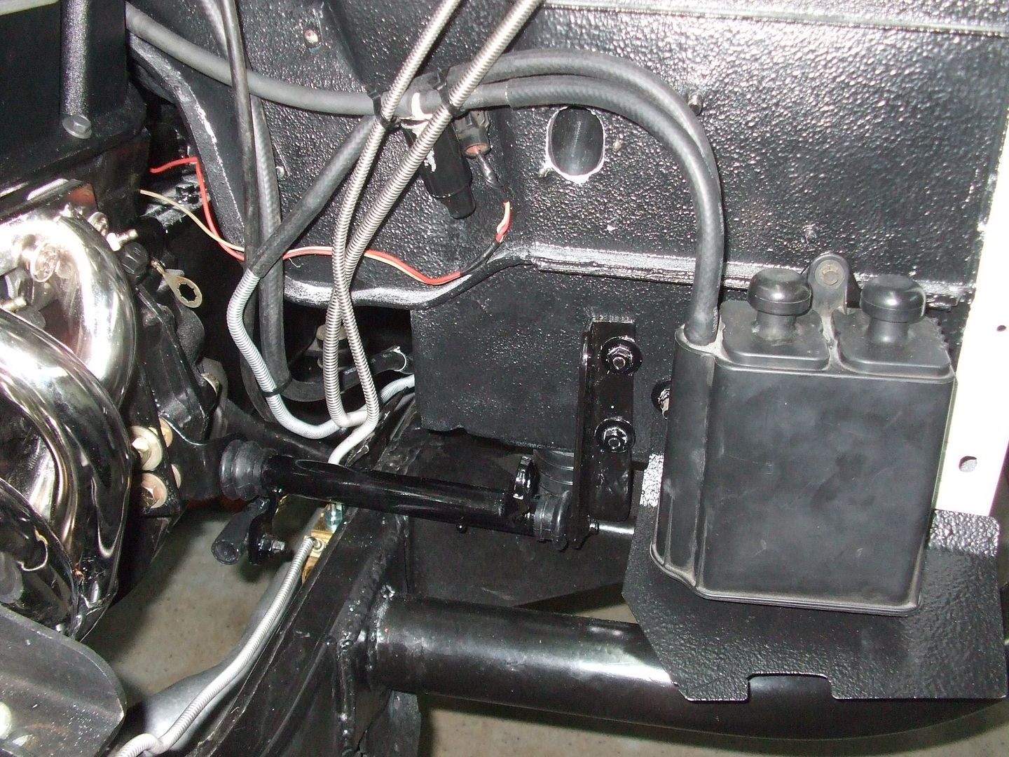

Mike did you use a canister like this one below? I'm trying to figure out from your page 15, thanks.

Hi Rob,
I actually ended up using a canister off of a Mustang since my engine uses a PCM controlled solenoid to turn evaporative flow on and off. Only two lines hook to that style canister. The vapor feed from the tank and the line from the canister to the manifold with the control solenoid in the middle. This post details it pretty well. Let me know if you have anymore questions.

I'll go ahead and post a picture of if here for you. I got the canister, canister mount and solenoid off the Mustang in the salvage yard for less than $5 and it adapted to the Jeep perfectly. I should note that I did end up having to move the canister up several inches from the spot in the picture to help clear the brace for the driver's side fender well so take that onto account if you go the same route.
Awesome thanks, I was wondering about using the Mustang one too

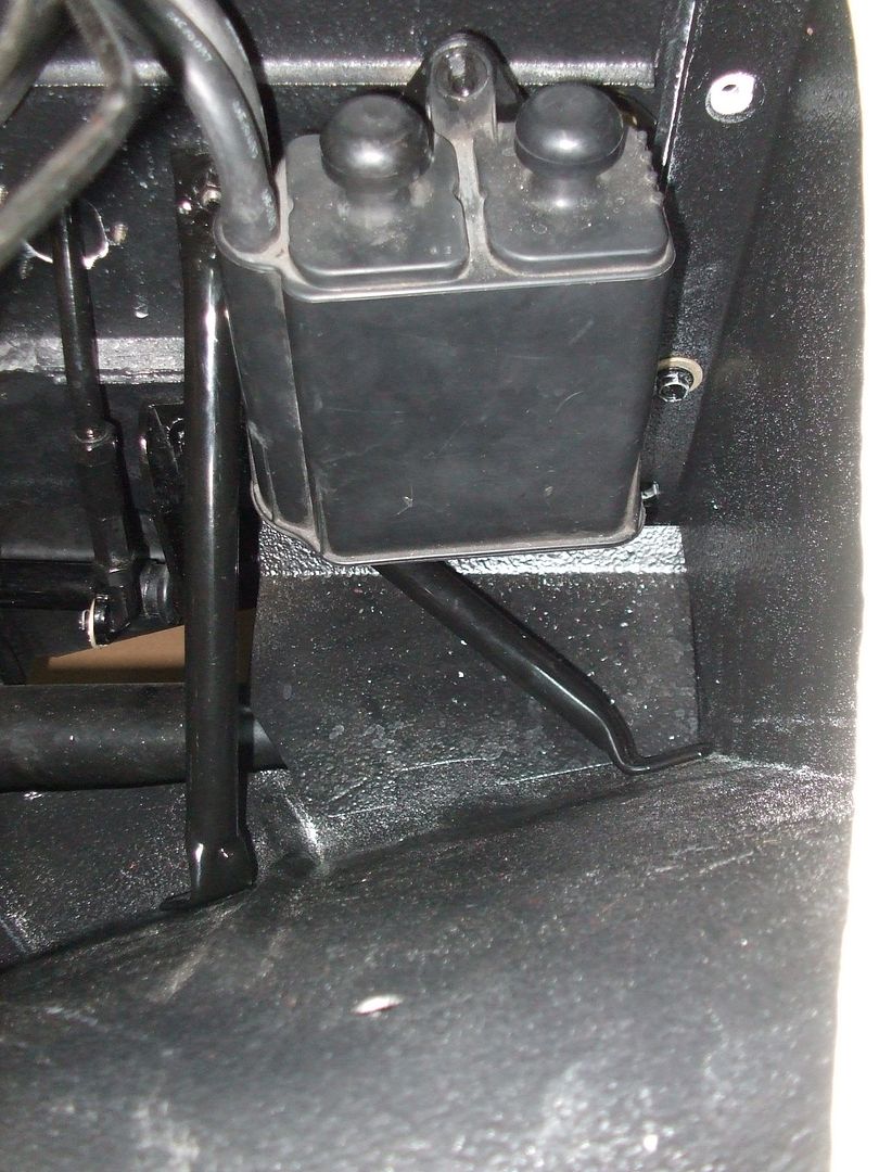

Here is a shot of the fender brace I mentioned.
Here it is moved up to clear the brace. Note where the clutch rod comes through the firewall in relation to the main body of the canister. You should be able to make out how far I had to raise it to clear the brace when you compare this photo to the one in the previous post.

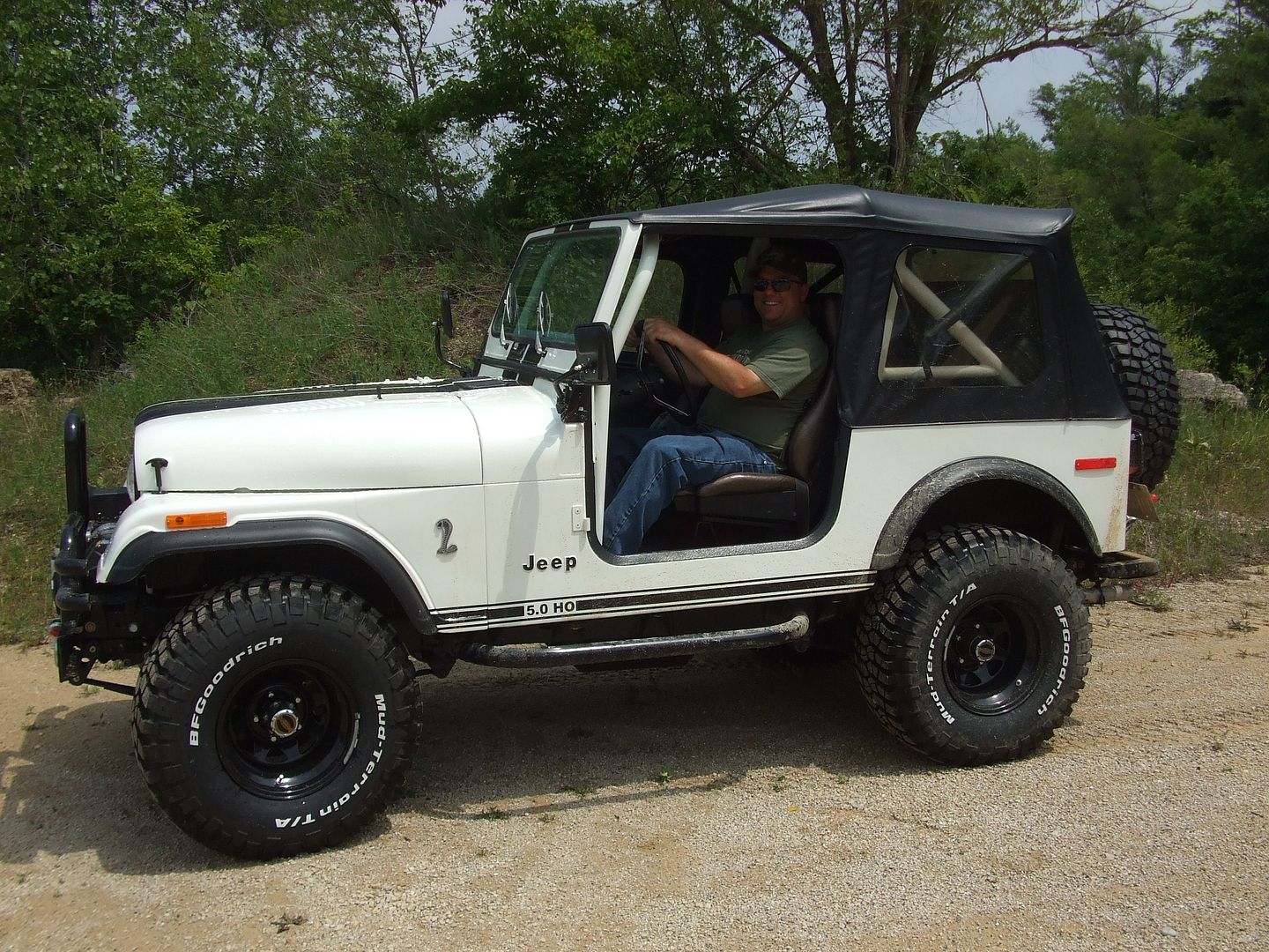

I hope everyone is having a great Memorial Day weekend. Thank you to all those who serve in the military and to all those who have given the greatest sacrifice.
As Jim has mentioned in a couple threads, I started off my weekend off with a bang sighting in a new .50 cal muzzle-loader. Jim and his friend also sighted in a 300 Win Mag. We had all kinds of good stuff to shoot.
Here's Jim playing king of the front end loader showing us the biggest guns of the day.
Jim is the first person to ever drive my Jeep besides myself, sorry Scott, and I didn't even go with him. I have a feeling he didn't drive it very hard, next time I'll have to take him for a ride.

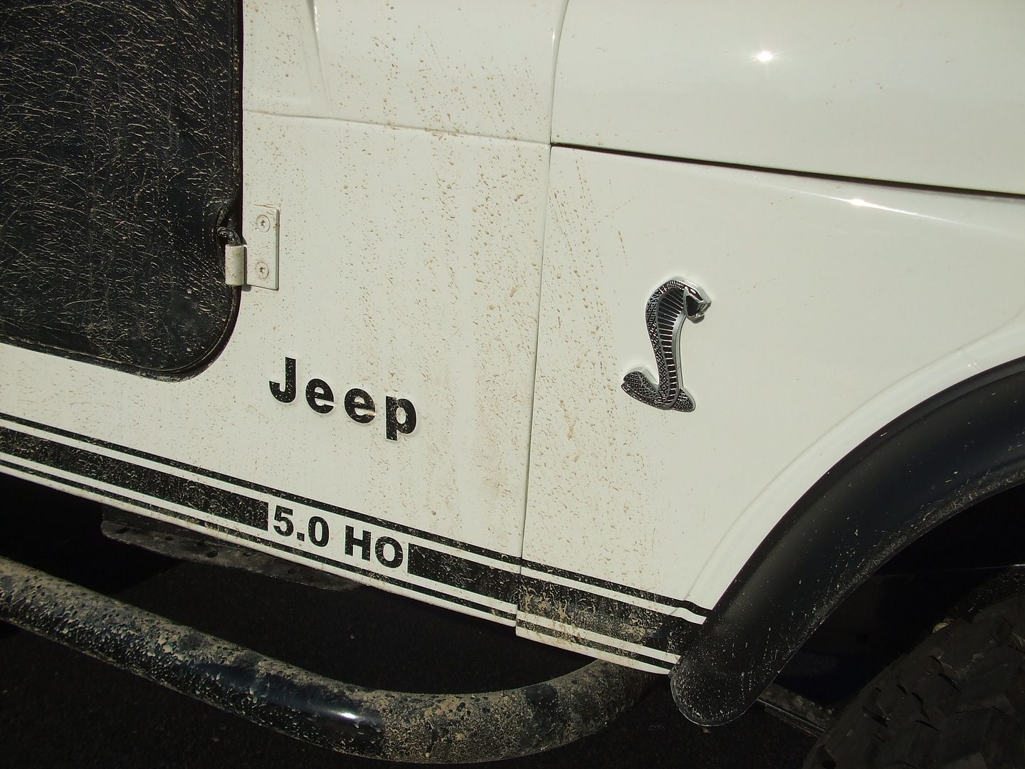

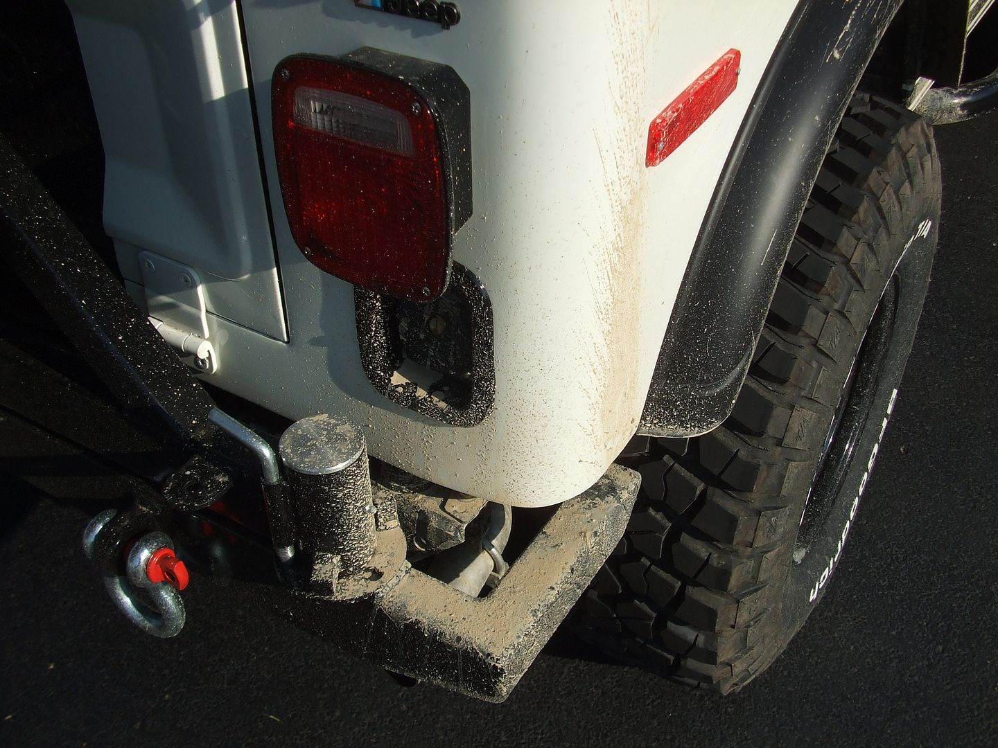

I don't know if this is considered muddy but it is certainly the dirtiest it has ever been since the rebuild. If you noticed all the standing water in the quarry pictures above, we had gotten several inches of rain the night before so there was no shortage of ~1 ft puddles to drive through. Not sure why we didn't take any pictures but it was throwing water higher than the hood.

I washed the Jeep in between tending to the smoker so it is all cleaned up and I think it is time to pull the top off for the summer. I hope everyone is having a wonderful Memorial Day weekend.

I KNOW that old man had to have a ladder to get into your Jeep!! Much less on top of an articulating loader. Looks like ya'll had a great time. Did you get the rifles sighted in? Mike, we get that muddy just driving down the roads around here!

The picture of Jim1611 in Coiz's CJ, ladies and gentleman, is what makes JeepForum so great...good folks who meet online here in the forum and then become friends offline...looks like you all had a great time and it is about time we saw a little mud slung around on that jeep of Coiz's...
