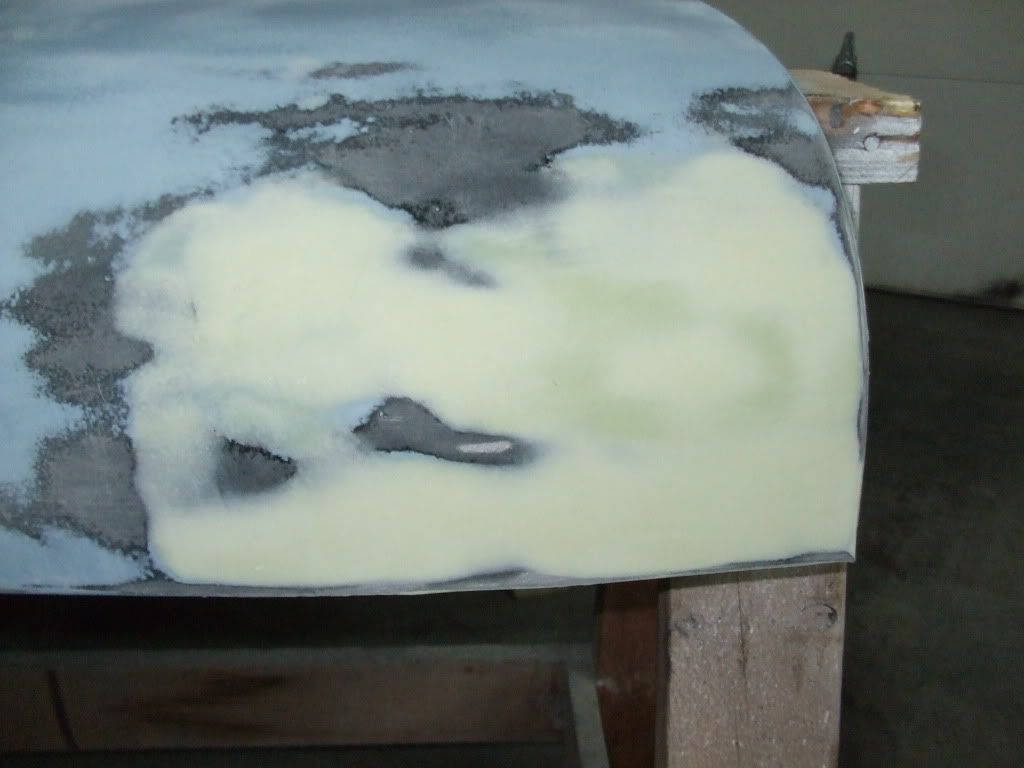

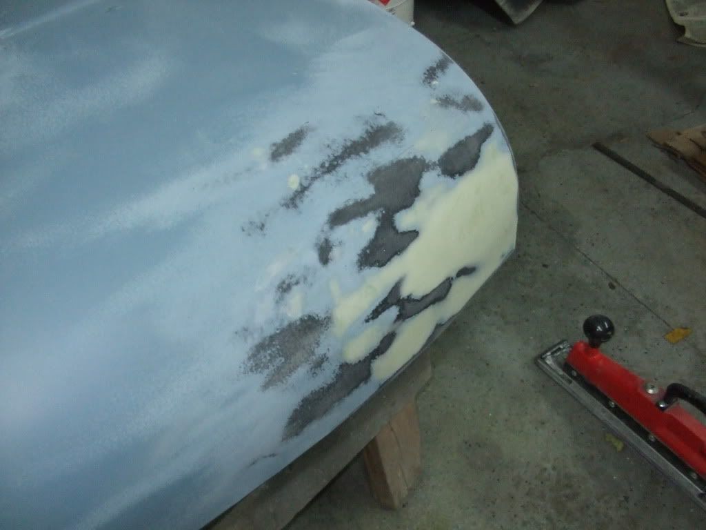

Finishing the Hood

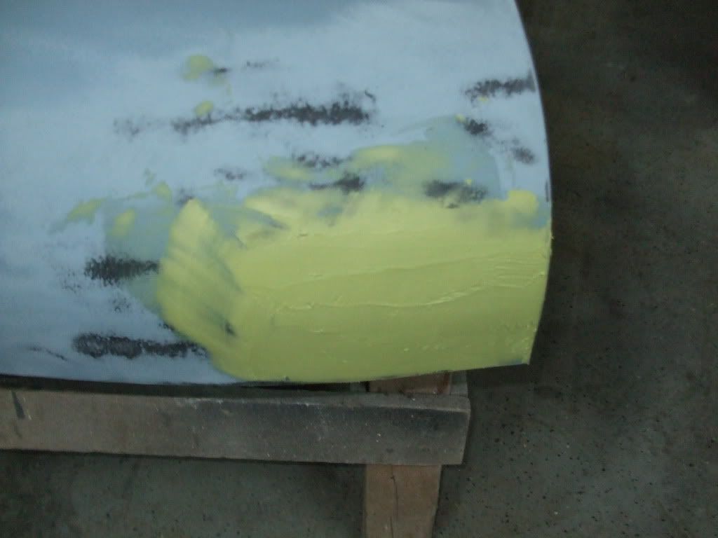

I had a couple dents I needed to take care of on the hood. The main one was there when I bought the Jeep in 1995. I always assumed it was caused by a tree or something.
I pounded out as much as I could from the back side but there was a brace blocking much of the main dent.
Sanded the area to create a nice scuff for the filler to stick to.
Applied the first layer of filler to the area.

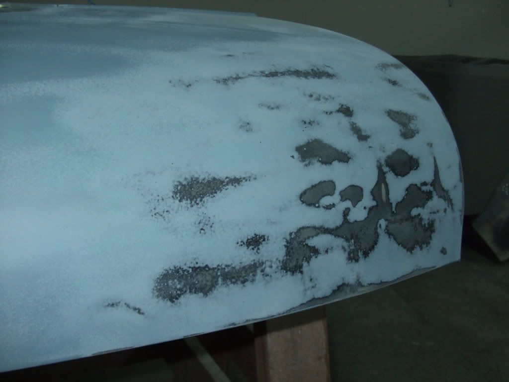

Sanded that out with 60 then 220 grit. You can still see a minor low spot.
Applied the second and last coat of main filler to the area.
Again, I hit it with a 17" flat air sander with 60 grit right as it started to solidify to get the main shape then followed up with a quick 220 DAO sander to make it smooth. I should have took a video of this, would have made a great demo.
It was looking pretty straight and I only saw a few pin holes but decided to use a light coat of easy sand on the entire area.
If you can time the sanding just right into the curing cycle you can really cut down on the time it takes to smooth everything out.
Ready for a coat of primer to make sure it all looks good. Feels smooth with my hand.
Mike

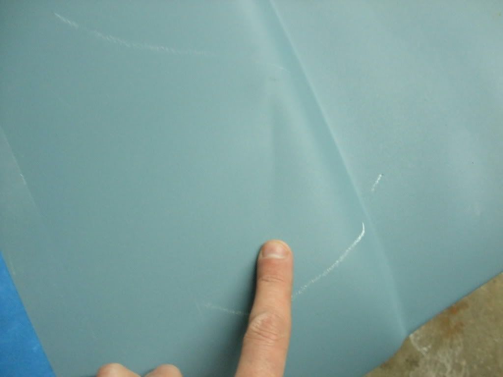

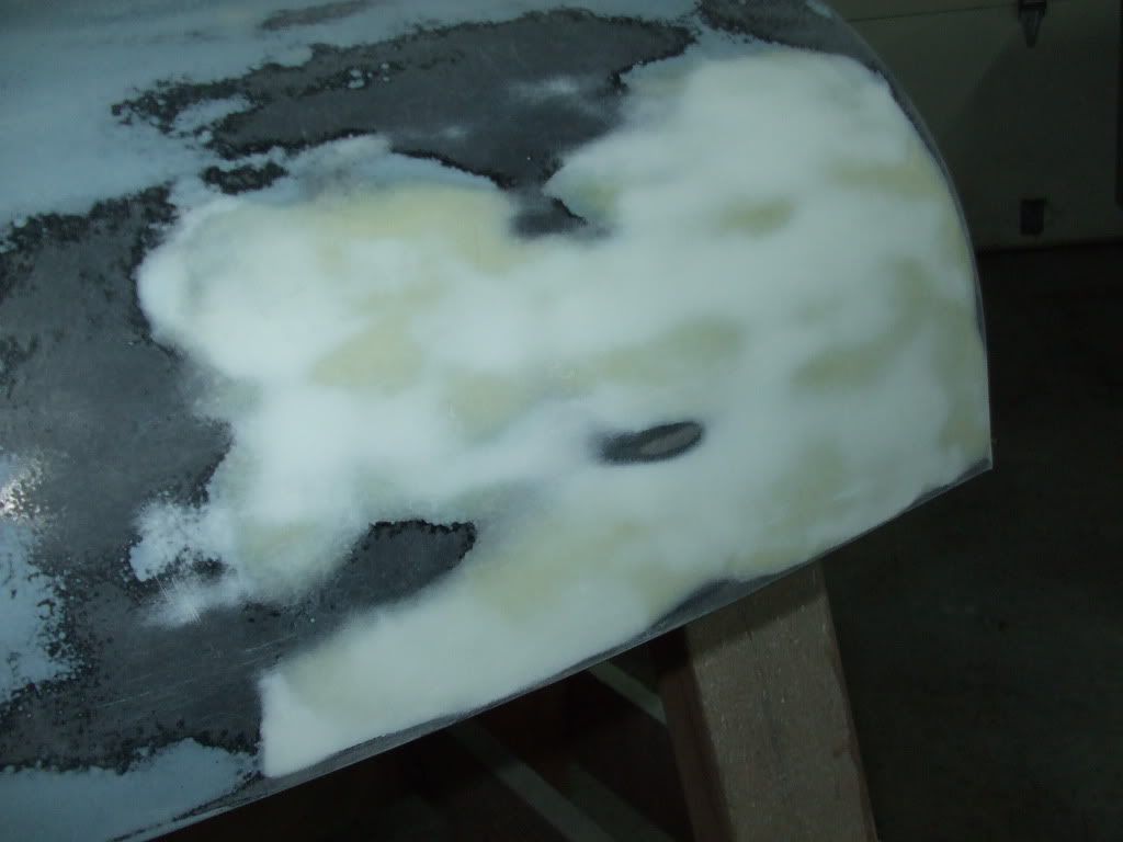

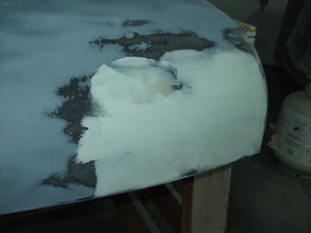

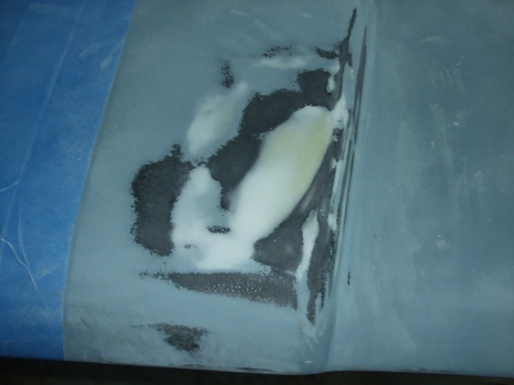

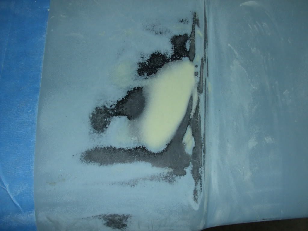

Middle hood dent
Another spot on the hood I had to fix was from an unfortunate incident that happened right after I had stripped and cleaned the hood. I had it standing up air drying when a rouge gust of wind came up and blew the hood over. It landed on its' top but I didn't notice any damage on my initial inspection upon picking it up. After getting some paint on it I could clearly pick out the dent. I was able to smooth out some of it but an inner brace limited how much I could pound out from the back side.
I had to sand that down before I could apply the body filler.

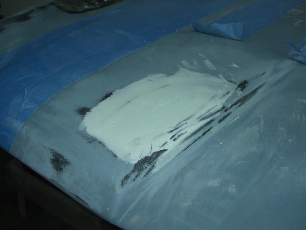

First layer of filler.
Sand that smooth.

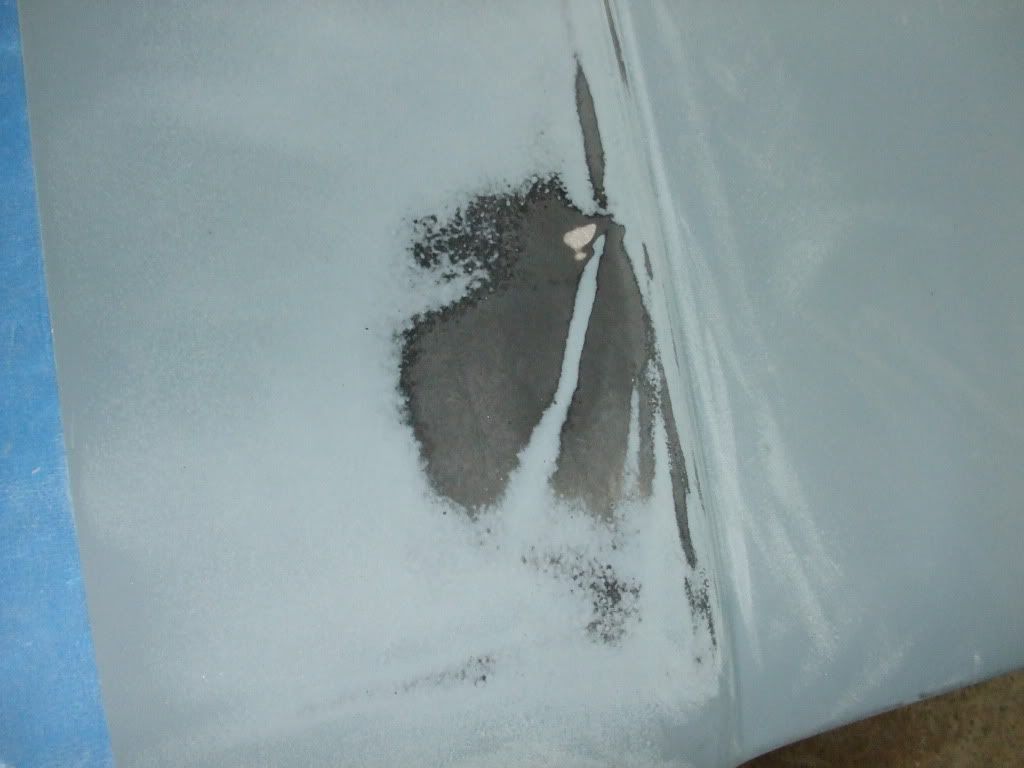

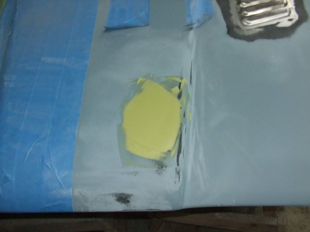

Next is the layer of easy sand.

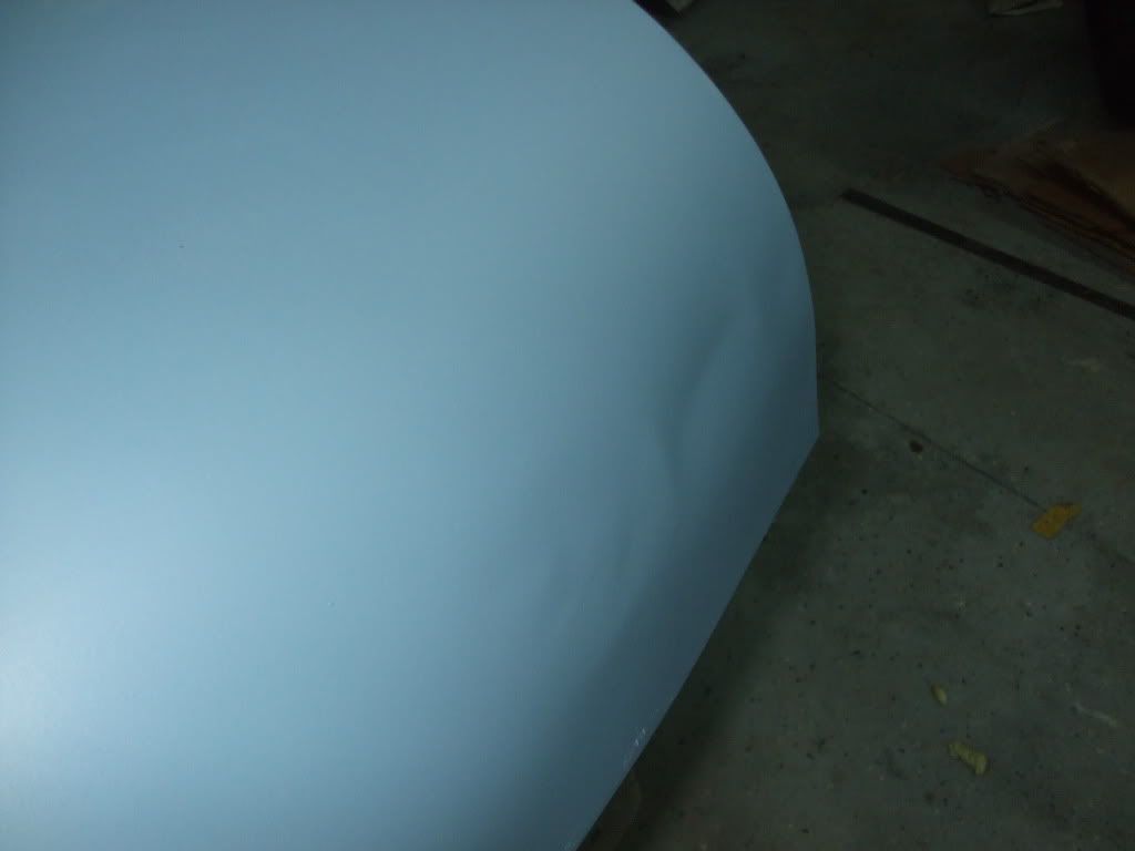

Sand that down to nothing.
Now the dent is non existent and ready for a light coat of primer before color. I need to get the windshield stripped so I can complete the final prep on it as well as get my roll bar sand blasted. I also need to get a hole cut into my dash for a tachometer and decide if I want to clean up the speaker slot cut outs on the driver's side that were hand made by the PO, they kind of look like crap. I need to add some studs for that speaker as it was previously just held on with bolts through the front of the dash. The last thing will be to fix some quality issues on my "new" front fenders. I would like to get everything prepped and test fitted to the Jeep so I can paint the first 75 degree weekend we get. I know that probably won't happen but one can dream.
