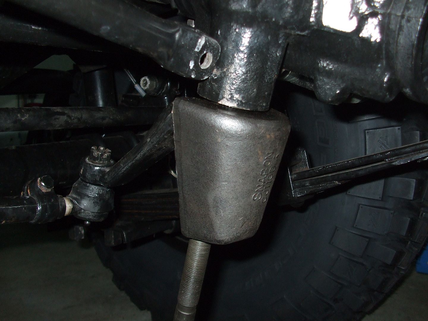

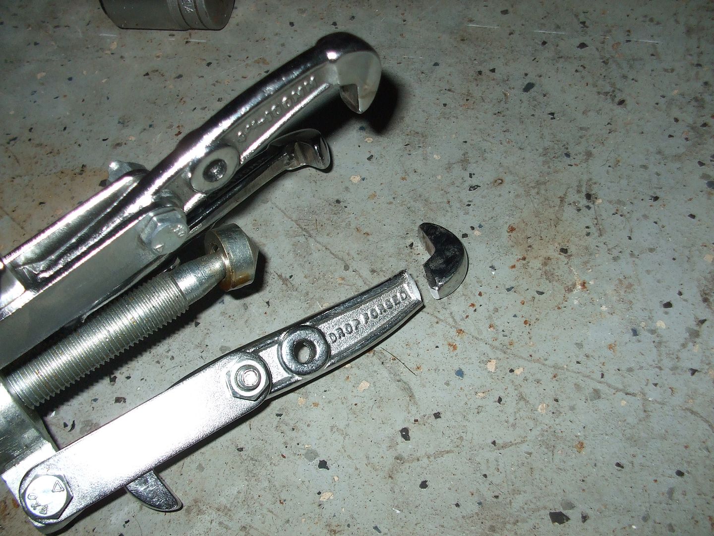

I did finally get a chance to replace the pitman arm. I had a drop pitman arm that came with the 4" lift but after installing the tie rod flip, the steering arms were no longer parallel. You can see how low the arm is in this photo.

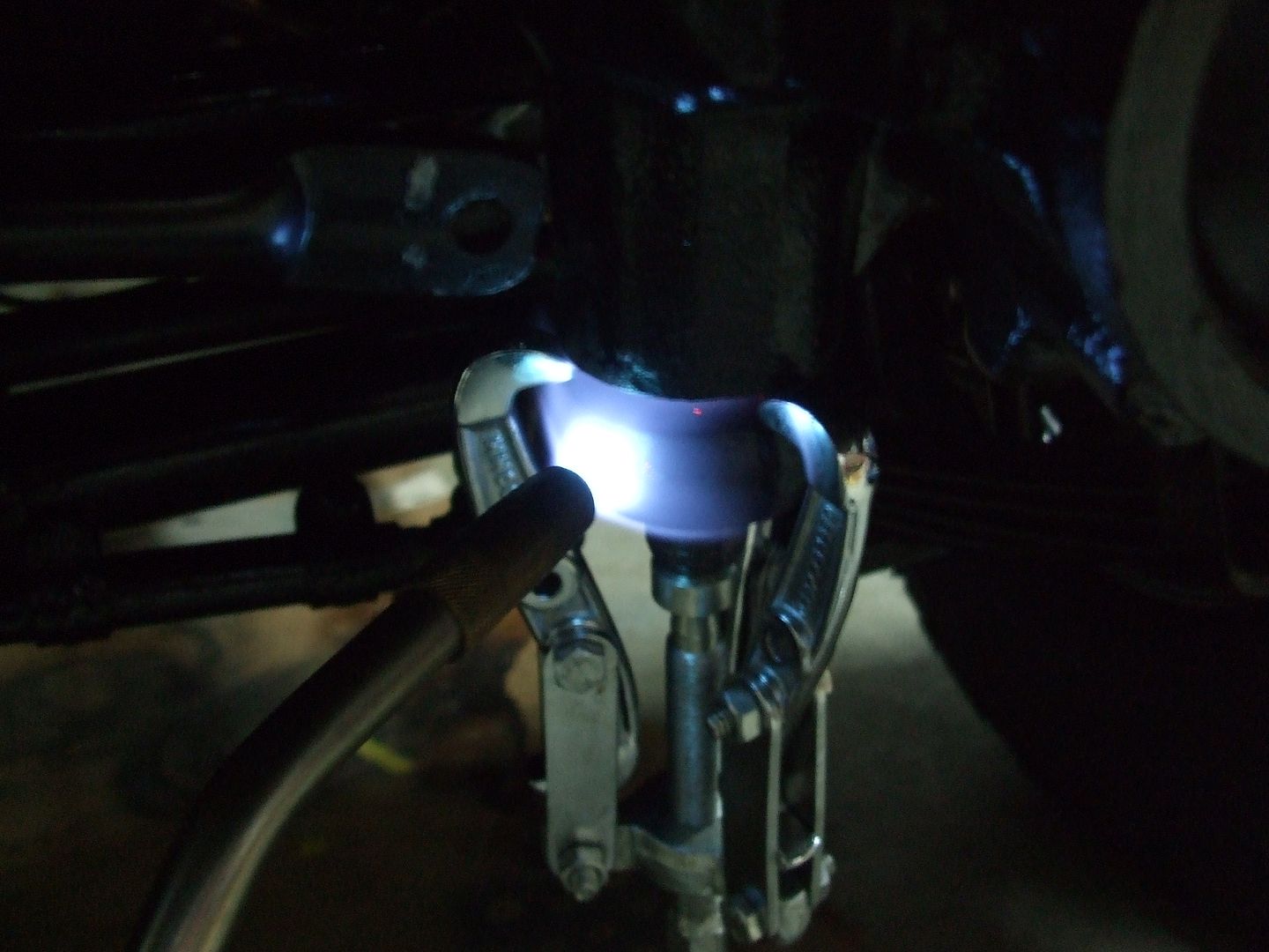

Bill (Lucdog) was nice enough to give me a stock pitman arm to correct my steering angles. The first thing I had to do was get the old one off. I tried to use my largest three jaw puller but there wasn't enough room for the thickness of the ears to get between the arm and the gear box so I had to use my medium sized puller.
I tired and failed on about three attempts before I decided I needed a little help from the blue tipped wrench.
I got it good and hot and the pulley was tight as hell. I gave it three good tugs on the ratchet and I heard the pop. I was thinking, thank God it finally popped loose or did it?

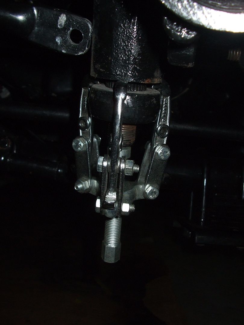

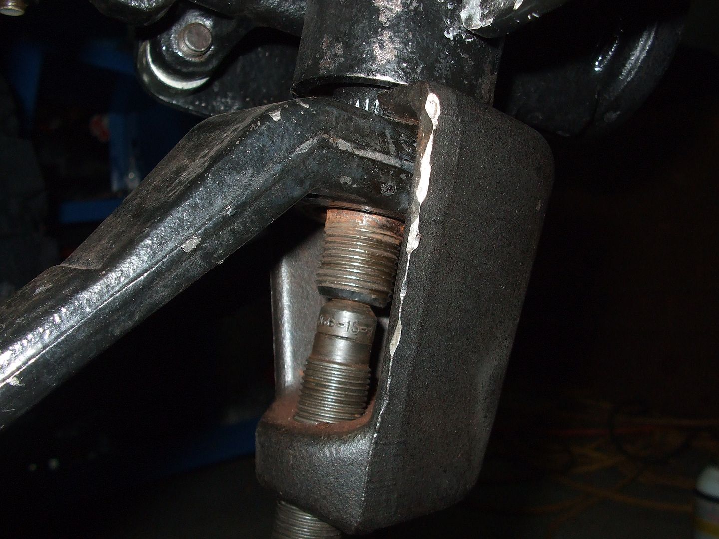

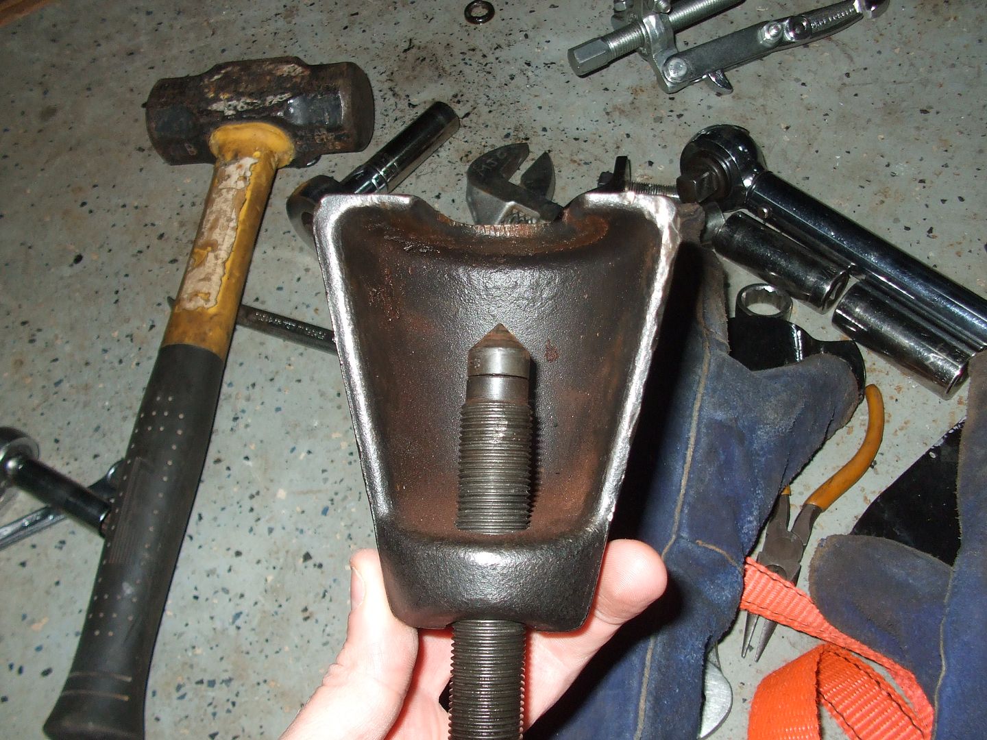

I went to plan B and called a technician friend of mine. He let me borrow his Snap-On puller.
So much easier to install.
I got it put on and everything lined up. I hit it with the impact until it wouldn't spin any further and the arm did not budge. I gave it a couple whacks with a 3# sledge and hit it with the impact again, the arm fell right off.

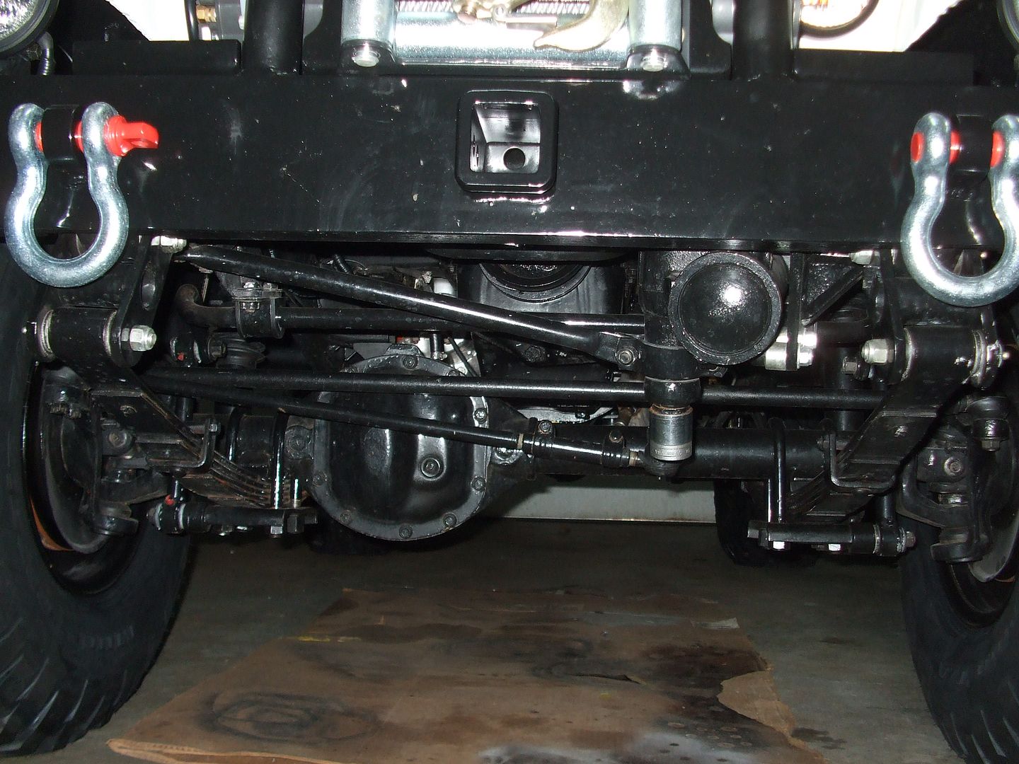

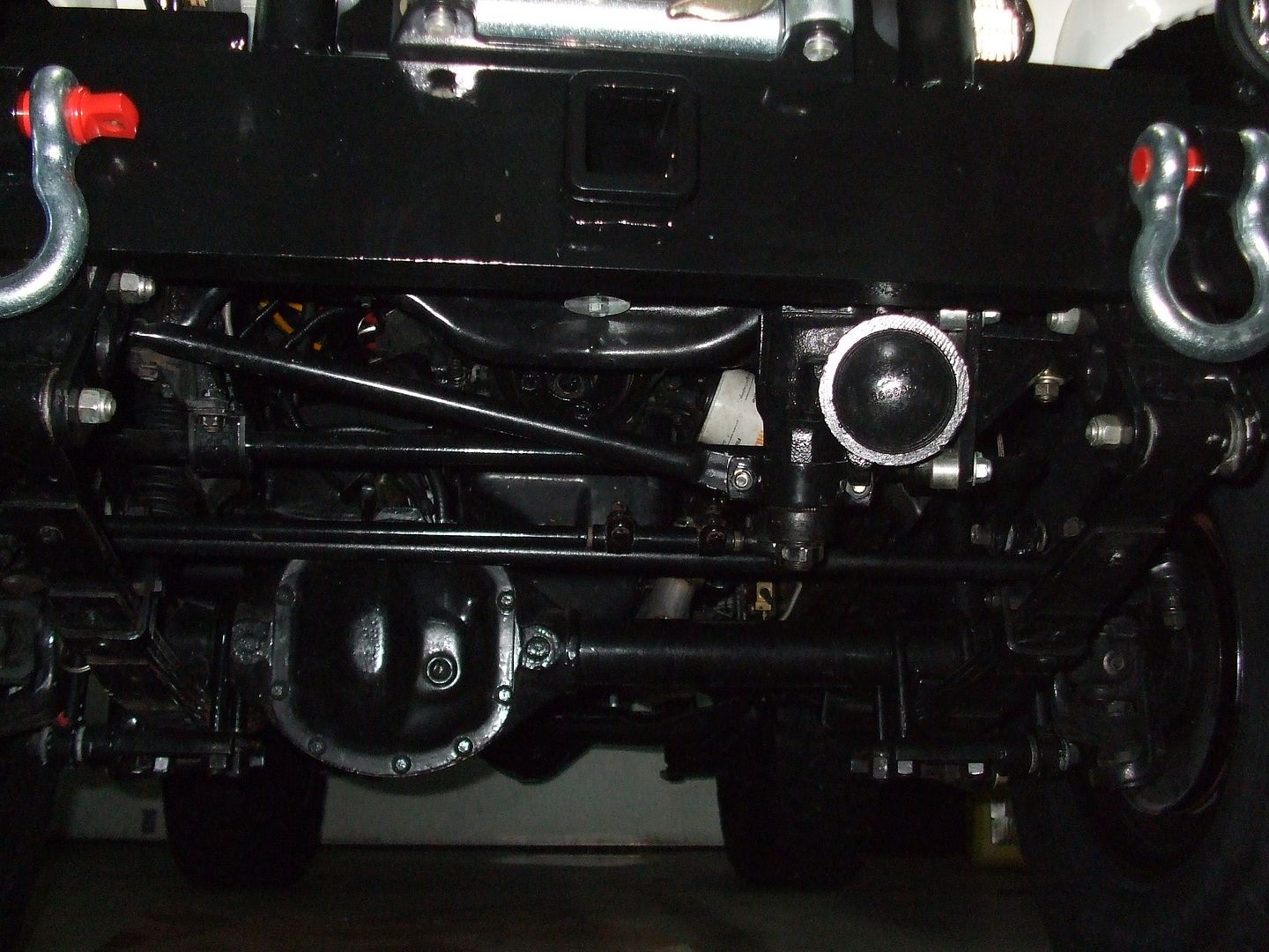

I got everything put back together and now you can see how parallel my steering arms are. I haven't experienced any bump steer so I'm not sure if I want to install my steering stabilizer or not.
