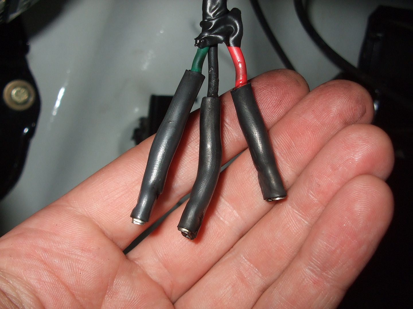

Mike your wiring is always top notch. The soldered joints and heat shrink should go a long way towards giving you years of trouble free use. What are you using to melt the heat shrink?

Thanks Jim. I am just using a standard cigarette lighter as I don't have a heat gun. It works good and doesn't take very long.

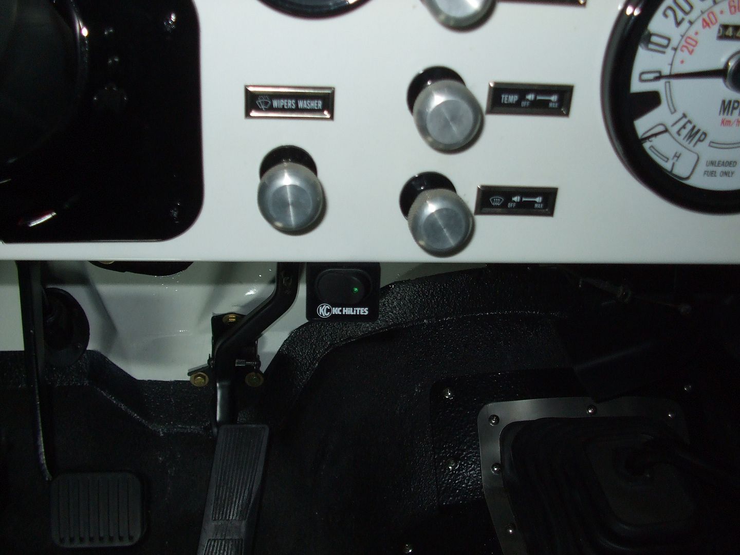

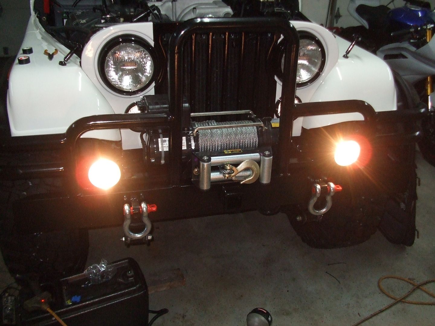

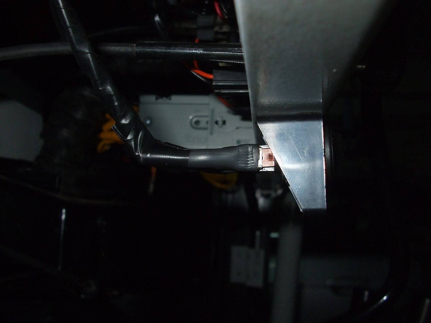

I installed the switch under the rest of the main controls. I couldn't put it on the left as there is just too much stuff in the way with the roll bar and the parking brake release. I didn't want to risk hitting it with my knee every time I got in and out of the Jeep. There were already holes that lined up so I didn't have to drill any new holes through my painted dash.

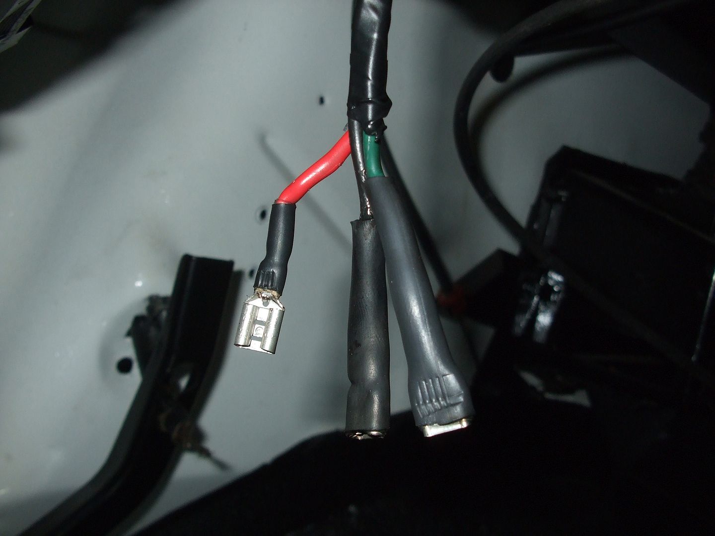

I had already ran the input wire to the relay behind the dash so I only needed to add the short power and ground wires. Once I had the terminal ends installed, I didn't like how close the exposed terminal ends were to each other so I took the next larger sized heat shrink and installed it over the outer edge of the terminal like a shield.
So now they are better protected from the elements and wont be able to short out to each other if they ever got bumped or squeezed.
I flipped the switch and the light turned green. I heard the relay click and my toolbox got brighter.

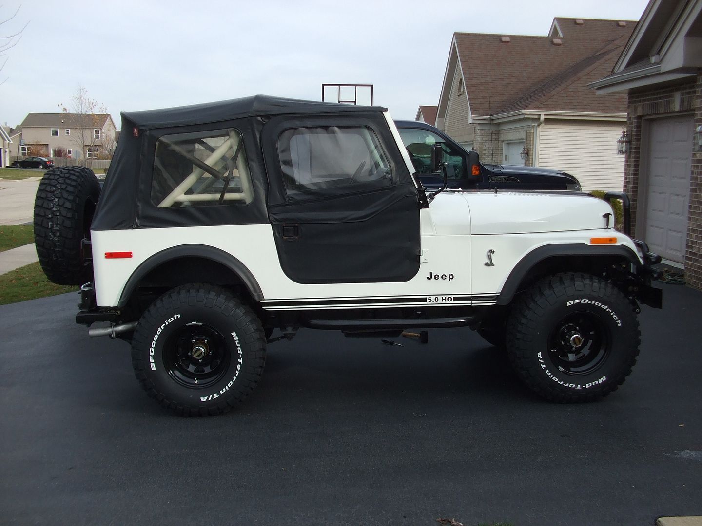

Posts: 4,228

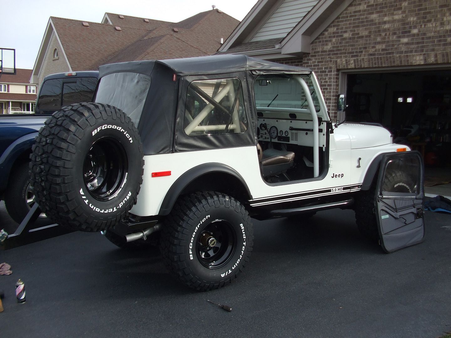

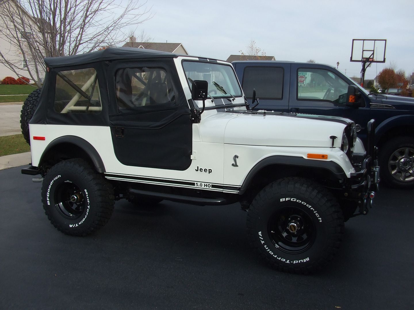

I got all the soft top hardware installed. Nothing to fancy to detail there so I'll just post the pictures.
It was a pretty tight fit. I used to pull the rear bar to the second hole adjustment but I could only get it to the first hole this time. I think the top needs to sit out in the sun for a little while to soften and stretch.
Mike

Posts: 4,228

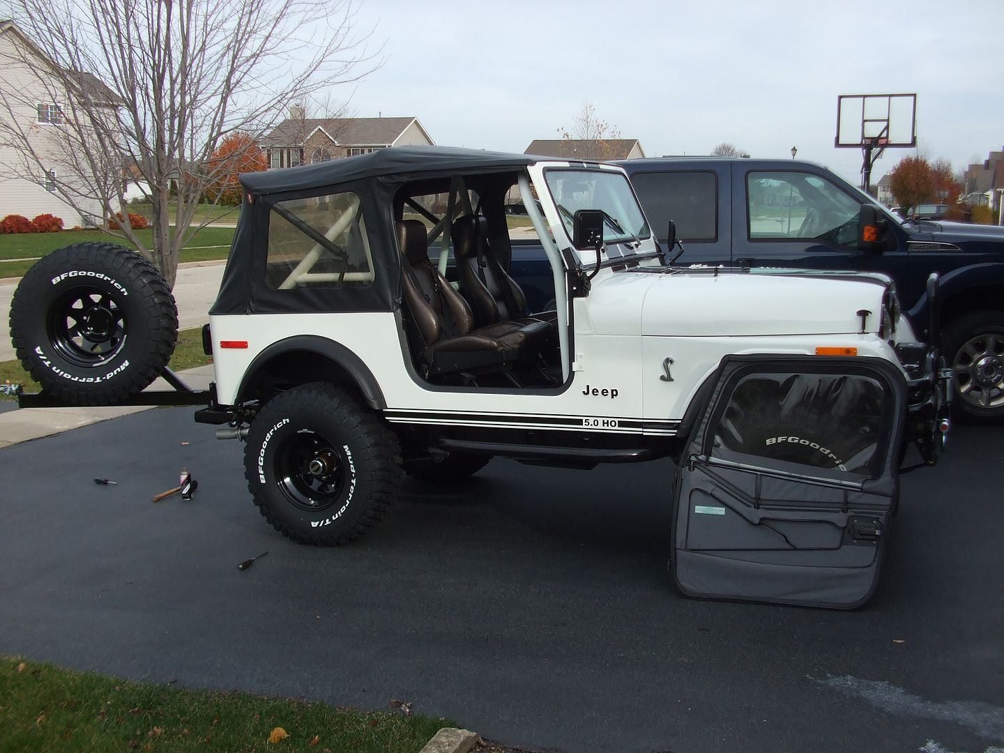

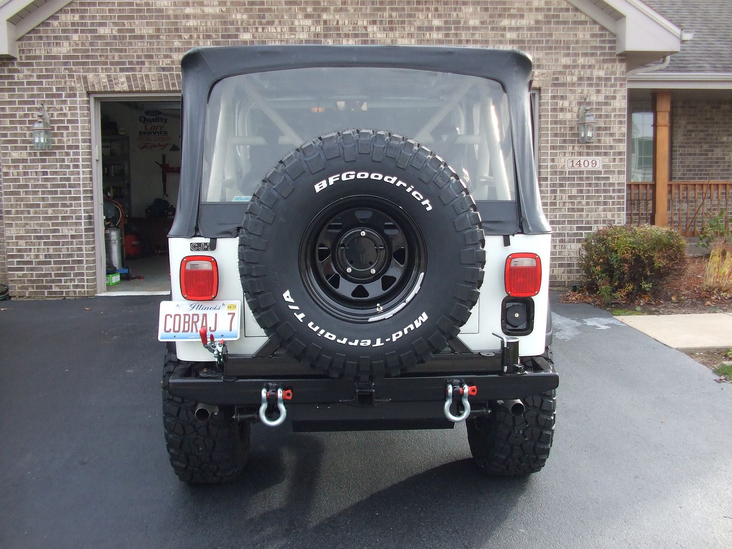

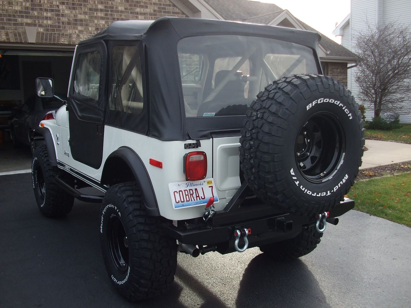

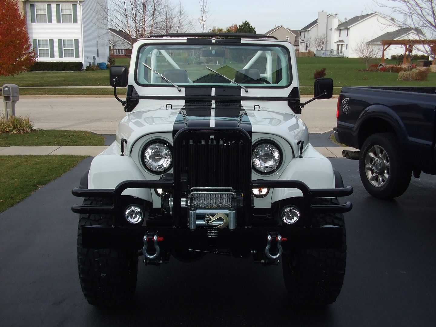

Thanks guys. Here are a few more pictures of the beast.
Mike
