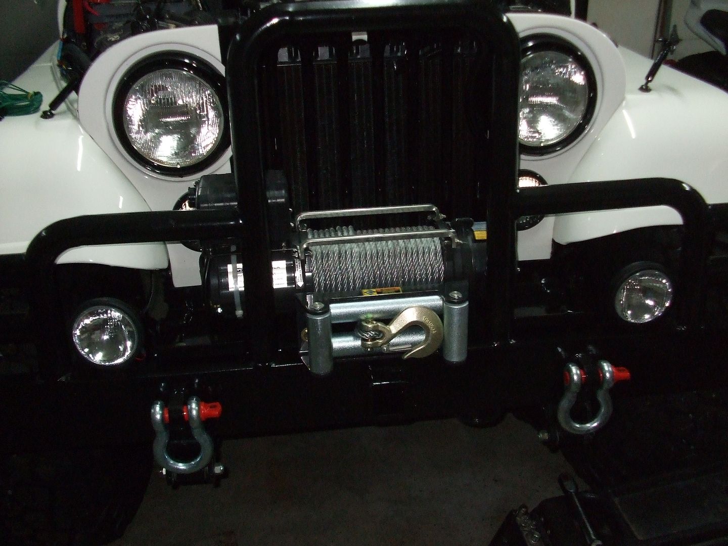

I've got my lights installed and wired. I was up until almost 3AM last night doing some other detailing work finishing up the stereo wiring and even started to install my soft top frame.
Short list of things to do is to remove my drop pitman arm and install the stock one that Bill (Lucdog) so graciously gave to me, get my 4x4 light hooked up correctly using the harness extension Moc sent me and get the proportioning valve brake light switch converted from the two wire switch to the single wire switch supplied by Inline Tube. Uploading pictures of the fog lights shortly.

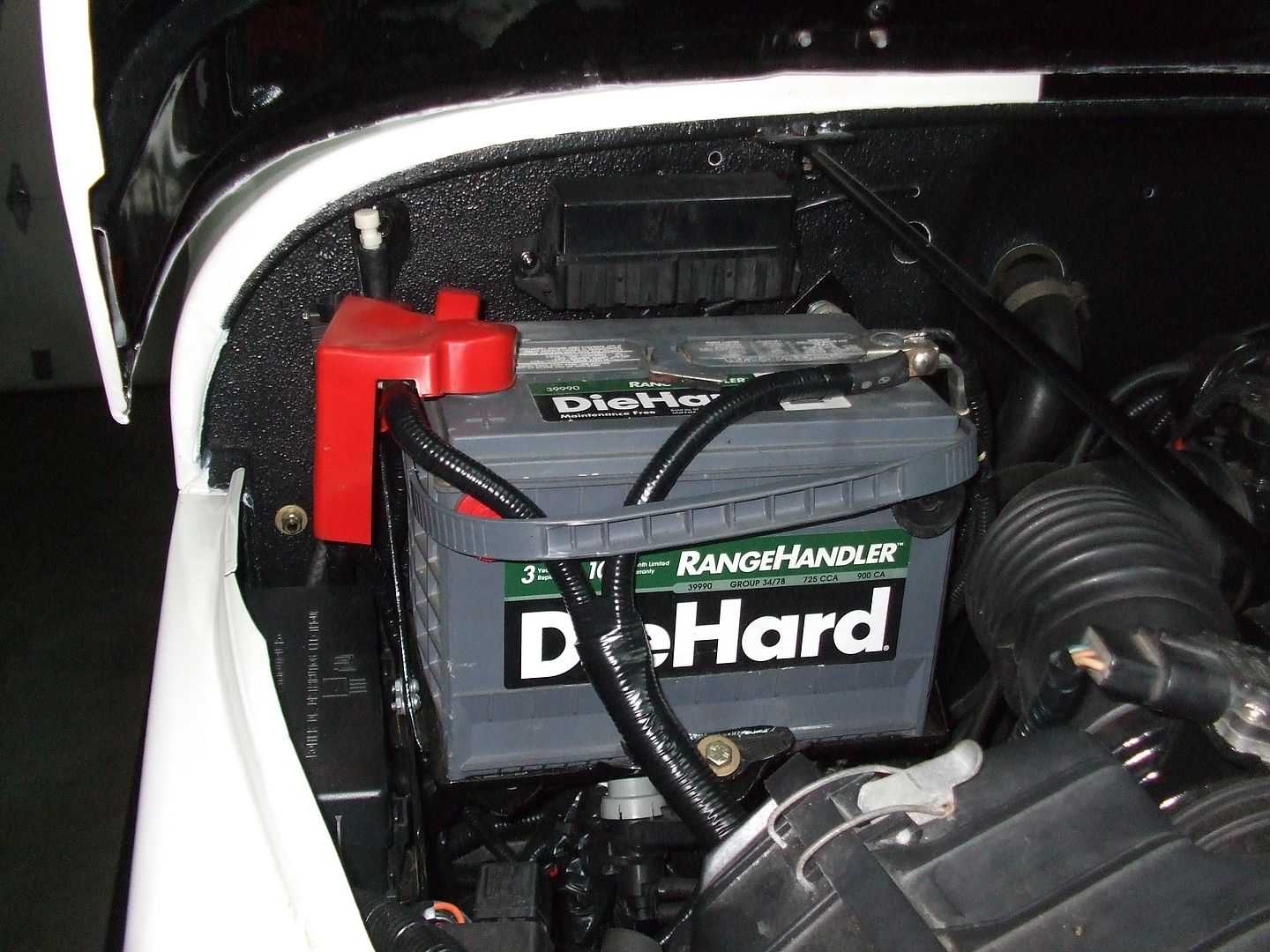

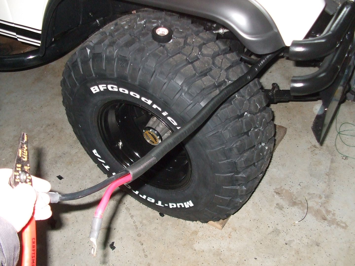

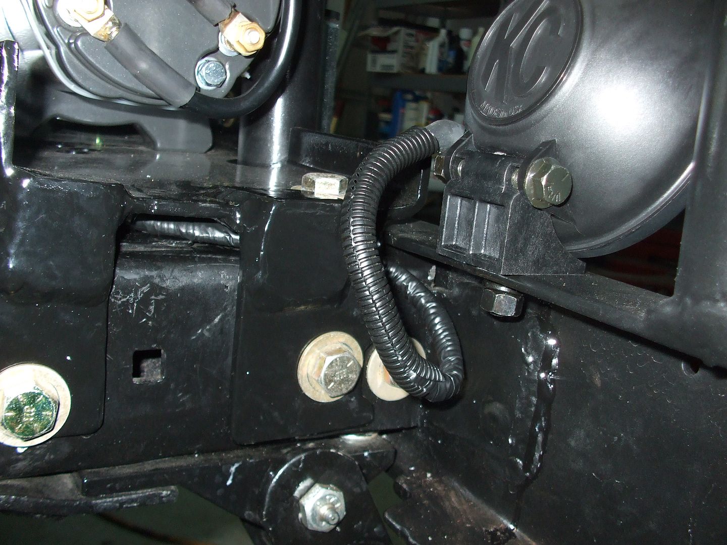

The first thing I did to get my motivation level up was to finish covering the wiring for the winch. I disconnected it from the battery and pulled it out to where I could easily get the new convoluted covering over the wires and tape it up.
Now I don't have to worry about the wires chaffing and it has a much cleaner look at the battery. Also notice I got my D300 vent tube ran. All the little details are falling into place.

How about a shot of those lights installed, Mike?

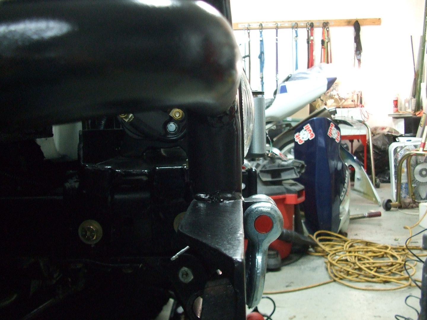

post #1722 of 1947 Old 11-06-2011, 04:39 PM Thread Starter
Coiz
1979 CJ7
Location: Northern, IL
Posts: 4,228

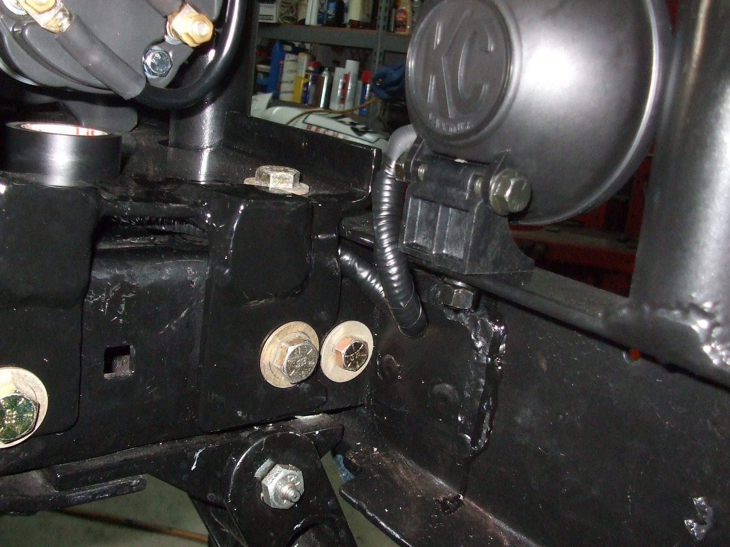

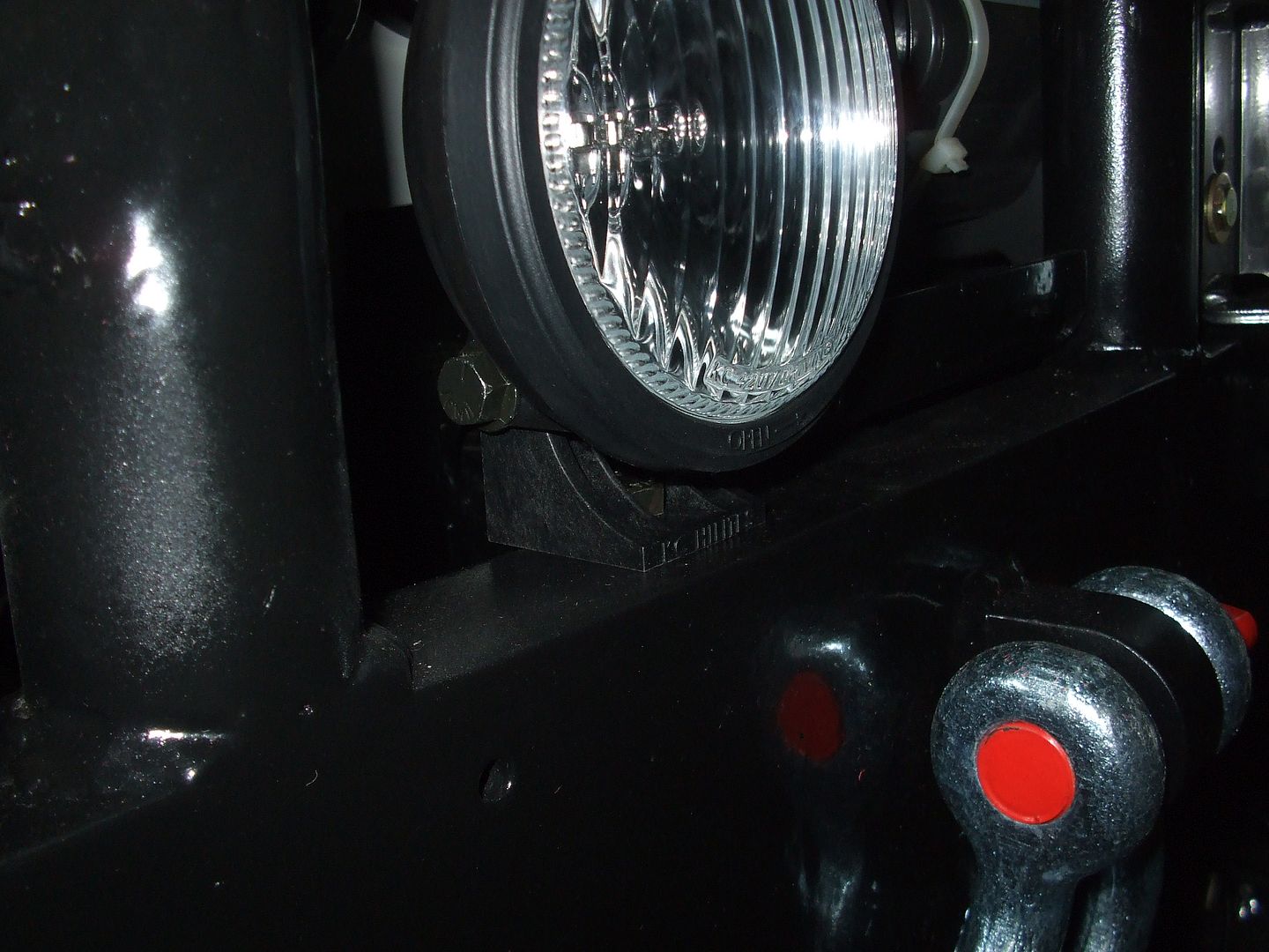

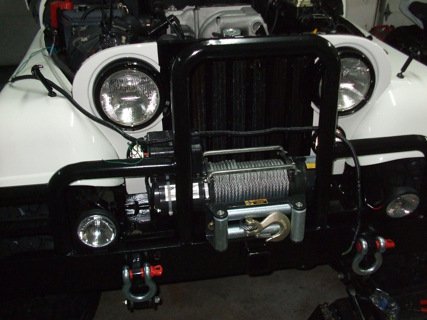

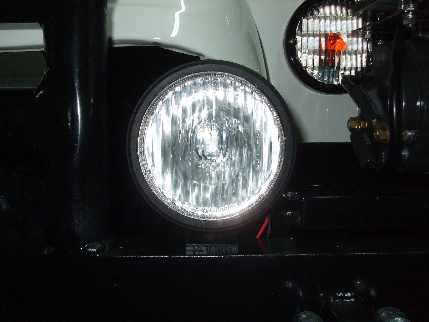

My front bumper already had holes drilled from my previous fog lamps which were reclangular with the single post mount. I never filled them during the refab of my bumper so I just used the same holes.
The square base of the new lamps are not perfect with the line of the bumper but I prefer having them set back anyway.
I like them recessed so they are more flush with the face.
Here they are both mounted. That took all of 5 minutes.

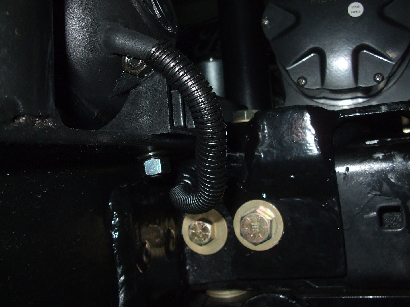

Next comes the hard part of running the wiring. It's not that it's hard, just time consuming.

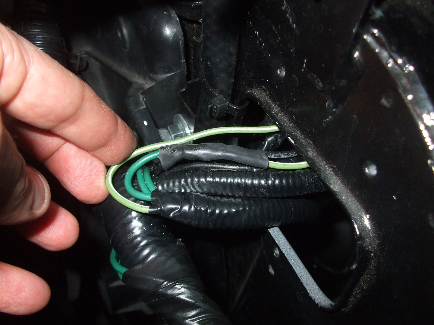

post #1723 of 1947 Old 11-06-2011, 05:16 PM Thread Starter
Coiz
1979 CJ7
Posts: 4,228

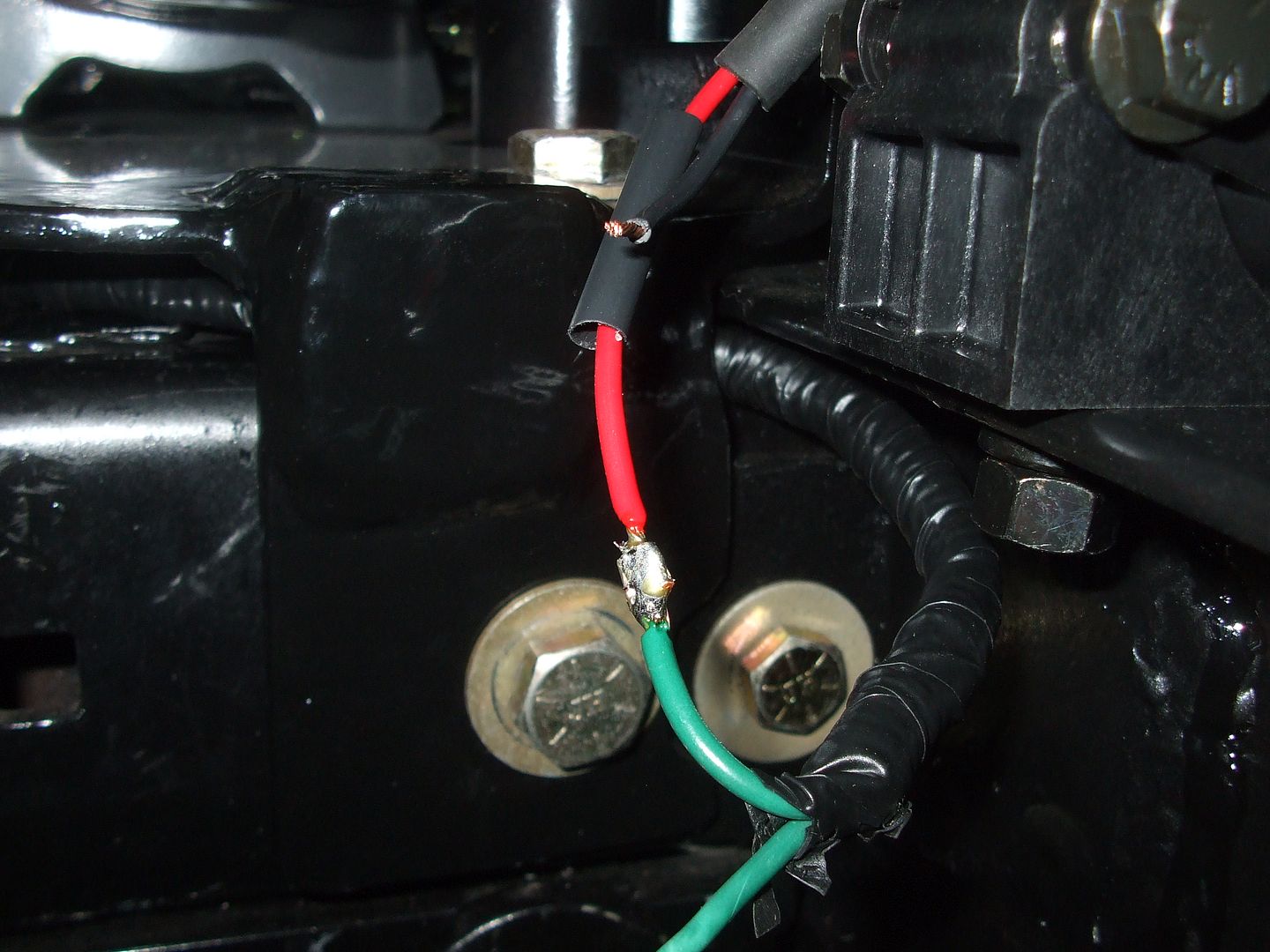

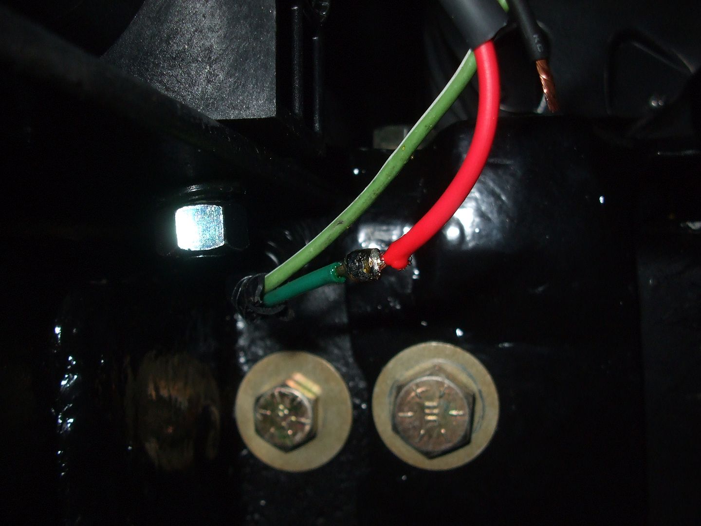

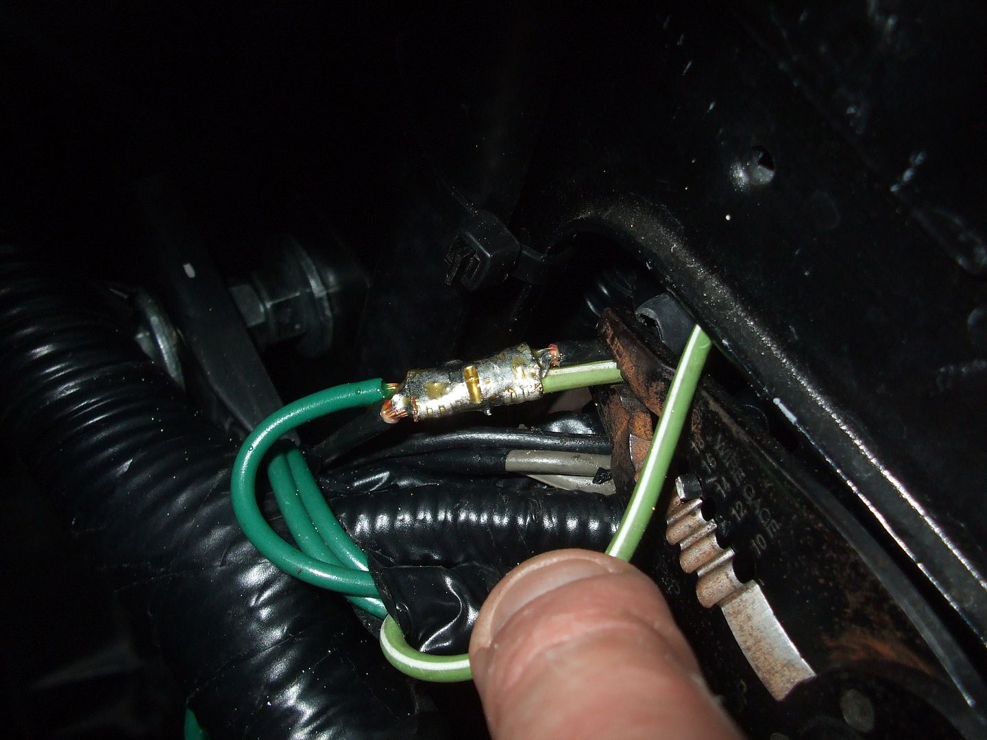

The first thing I did was lay out the wiring and run it exactly where it was going to go. During my intial wiring of the CJ, I had pre-terminated a feed wire from a deticated fog lamp relay in the box above the battery. You can see it on the passenger fender with the blue heat shrink on it. Fishing the wires under and through the winch mount was a bit of a challenge. I cut them to approximate length and pulled them all out. Next I taped the wires and installed the main portion of convolute. Here is it kind of laid out in place.
I started on the drivers side lamp. Soldered all the connections.
Adhesive lined heat shrink tubing on every connection.
Finish off the convolute.
Tape it all up.
Mike

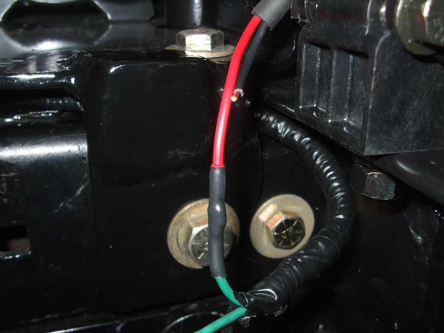

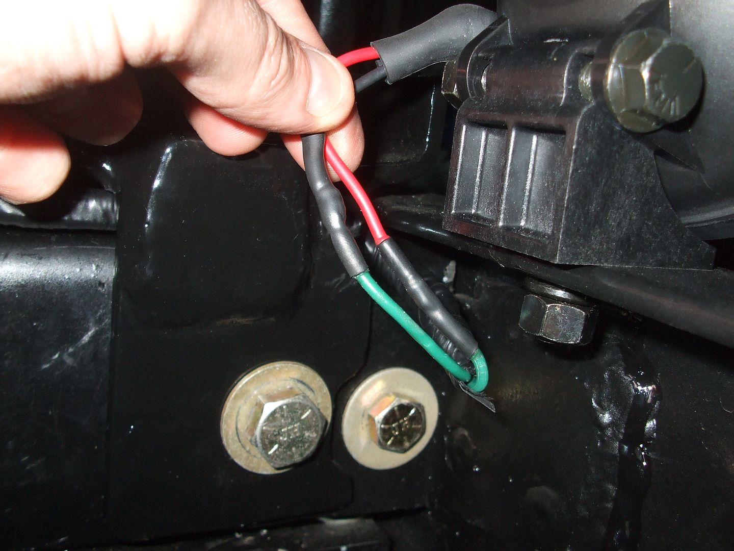

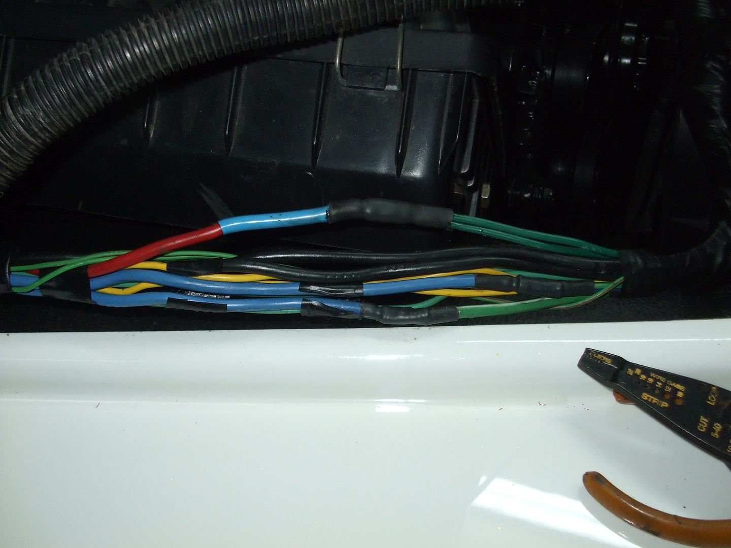

Passenger's side lamp got the same treatment.
Add the adhesive lined heat shrink.
Did I mention that I love adhesive linded heat shrink?
Add the convolute.
Tape it all up.
Mike

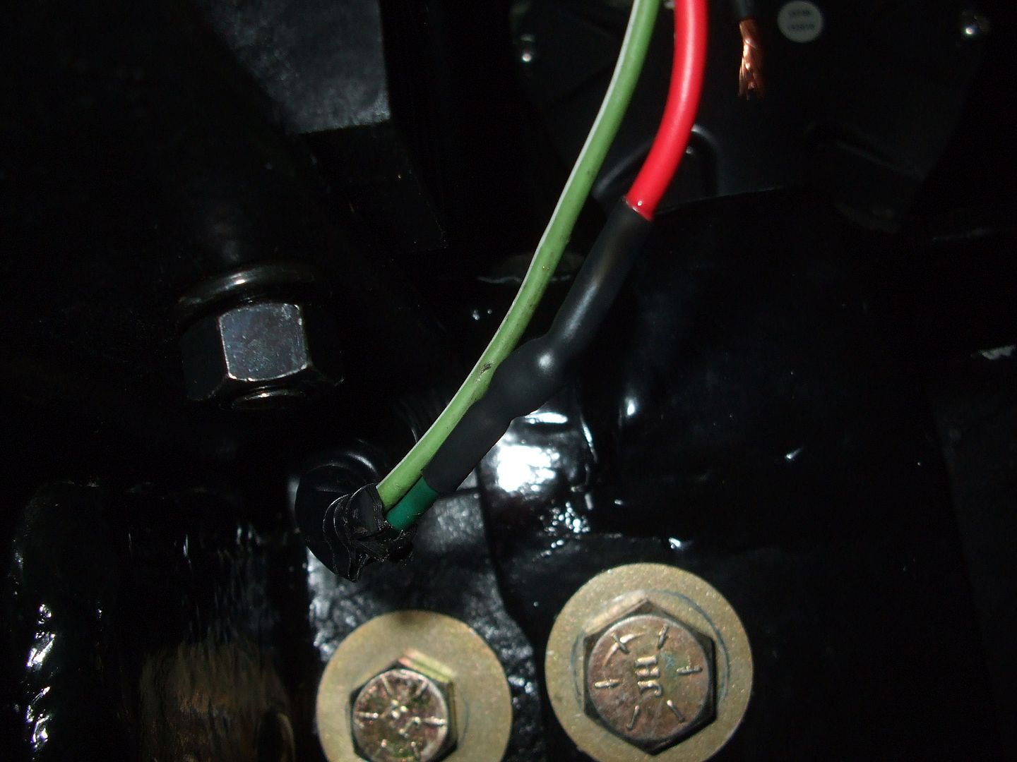

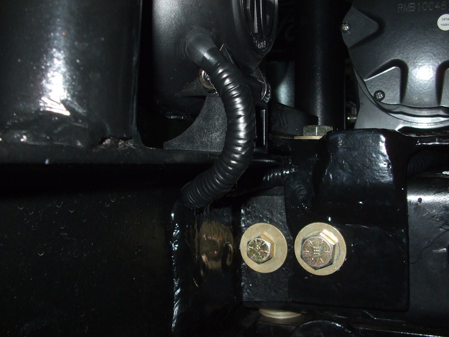

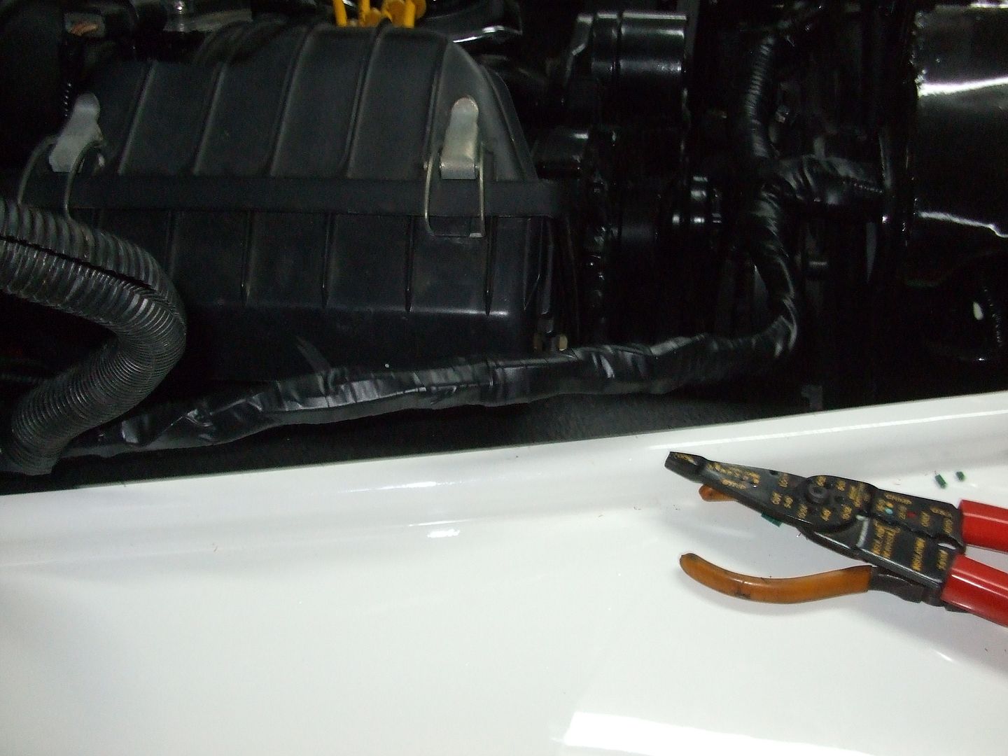

This is where I tied into a dedicated ground wire which is ultimately connected to the frame, body and battery depending on which splice you follow.
Heat shrink.
Main power hook up at the fender, 10g feed from the relay into dual 14 gauge to the lamps.
More adhesive lined heat shrink.
Tape the harness back up.
The only thing left was to wire up the switch.
