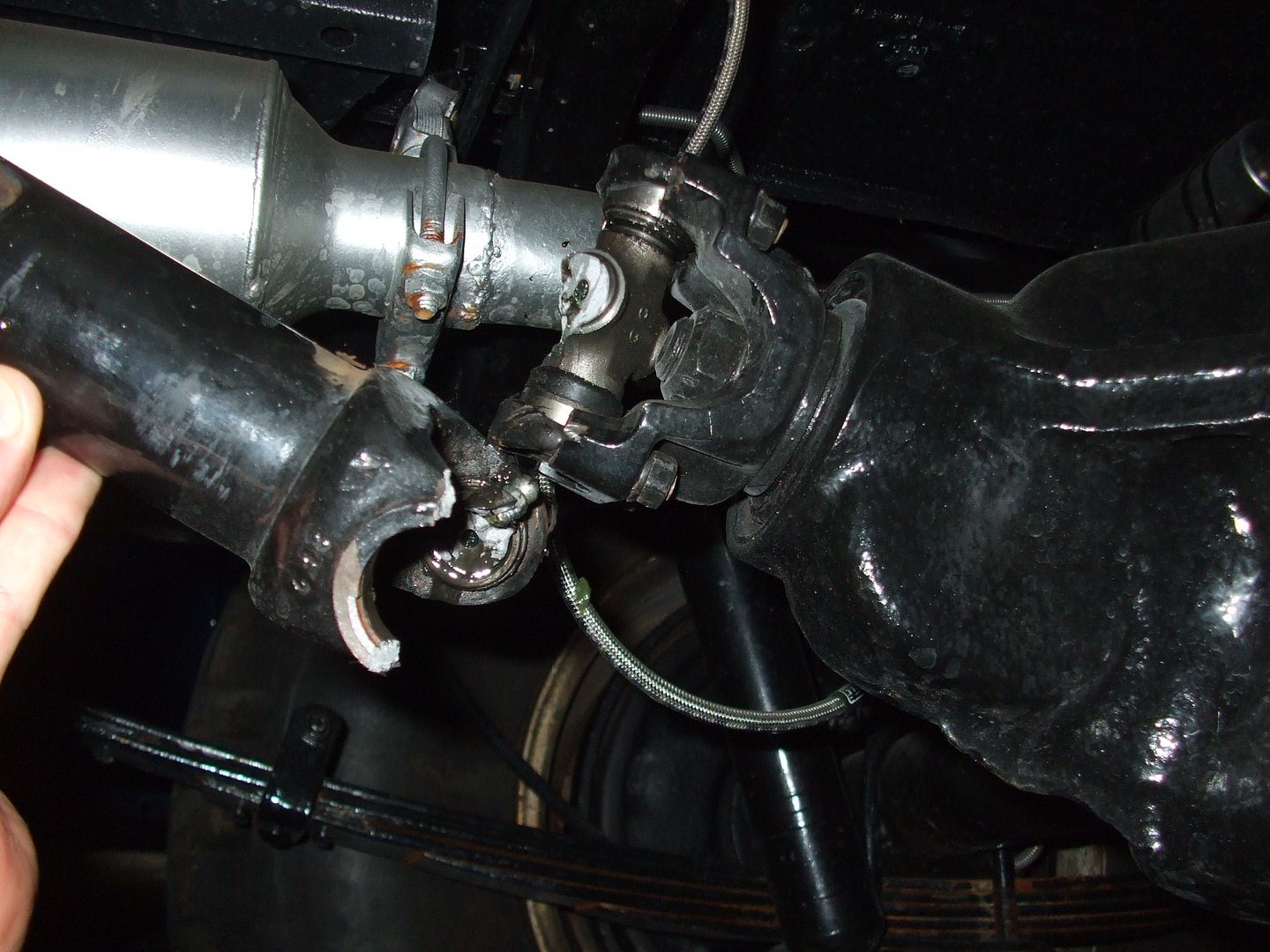

I was horsing around a couple days ago, hit the pavement and dumped it hard in second. *BANG* *CLUNK* *SLAM*
Uh Oh. Finally went and did it.
As I coasted over to the side of the road, all I could picture in my head was this picture:
Luckily, all I did was tear out one of my U Joint straps.
Not sure if the straps are good design or what, since it sort of acts as a predetermined failure point to keep the above for happening, but I was dead in the water. I guess I'll take breakdowns that I can solve for $8 at Carquest anyday.

No doubt you'd rather take the easy fix over the expensive ones. I've been telling myself every drive since then, easy on the clutch, easy on the clutch.

And man did you ever do a number on the driveshaft. 1350s coming soon?

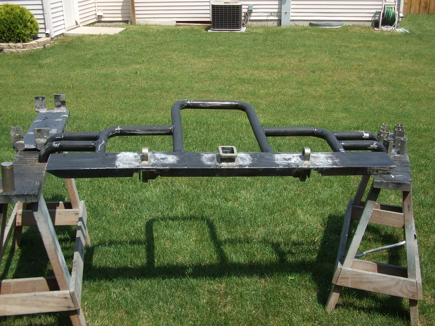

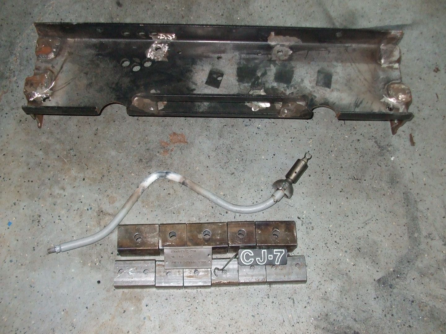

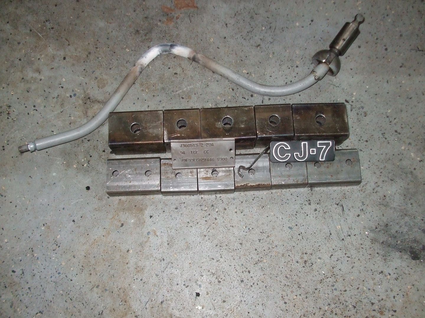

Winch Mount and Front Bumper Paint Prep

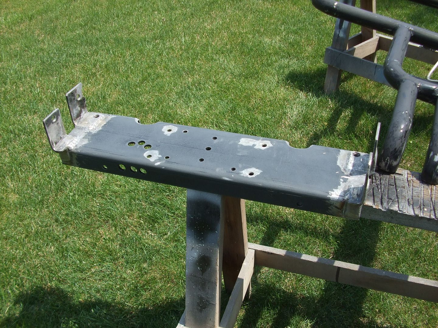

So I have finally made some progress on the last of the Jeep parts.
These are the last of the parts that need to be painted with POR and Blackcoat.
All the square blocks are the rear seat risers to lift the seat up three inches for some additional leg room since the normal leg room for the rear seat has been eliminated by my Scrambler bulkhead. I've also got the CJ7 emblem, the piece I made for my hood prop rod retainer and VIN plate. Also notice the heat marks on the transmission shifter, that's where I heated it with MAP gas enough to where I could tweak its' shape. In reverse it would barely contact my center console so I tweaked it to where it can no longer hit the center console but is still far enough from the dash in 1st to not cause a problem. It is actually a little easier to shift now too.
I took my DA sander with 80 grit paper and gave all of those pieces a solid once over, I didn't see the need to completely strip the existing paint off. I then cleaned them with Marine Clean and coated them with Metal Ready for 20 minutes. Here they are after being sanded, washed and dried. Also notice my rear bumper spare tire spindle cover on the far right.
Closer shot of the winch plate to see the dulled existing paint finish.

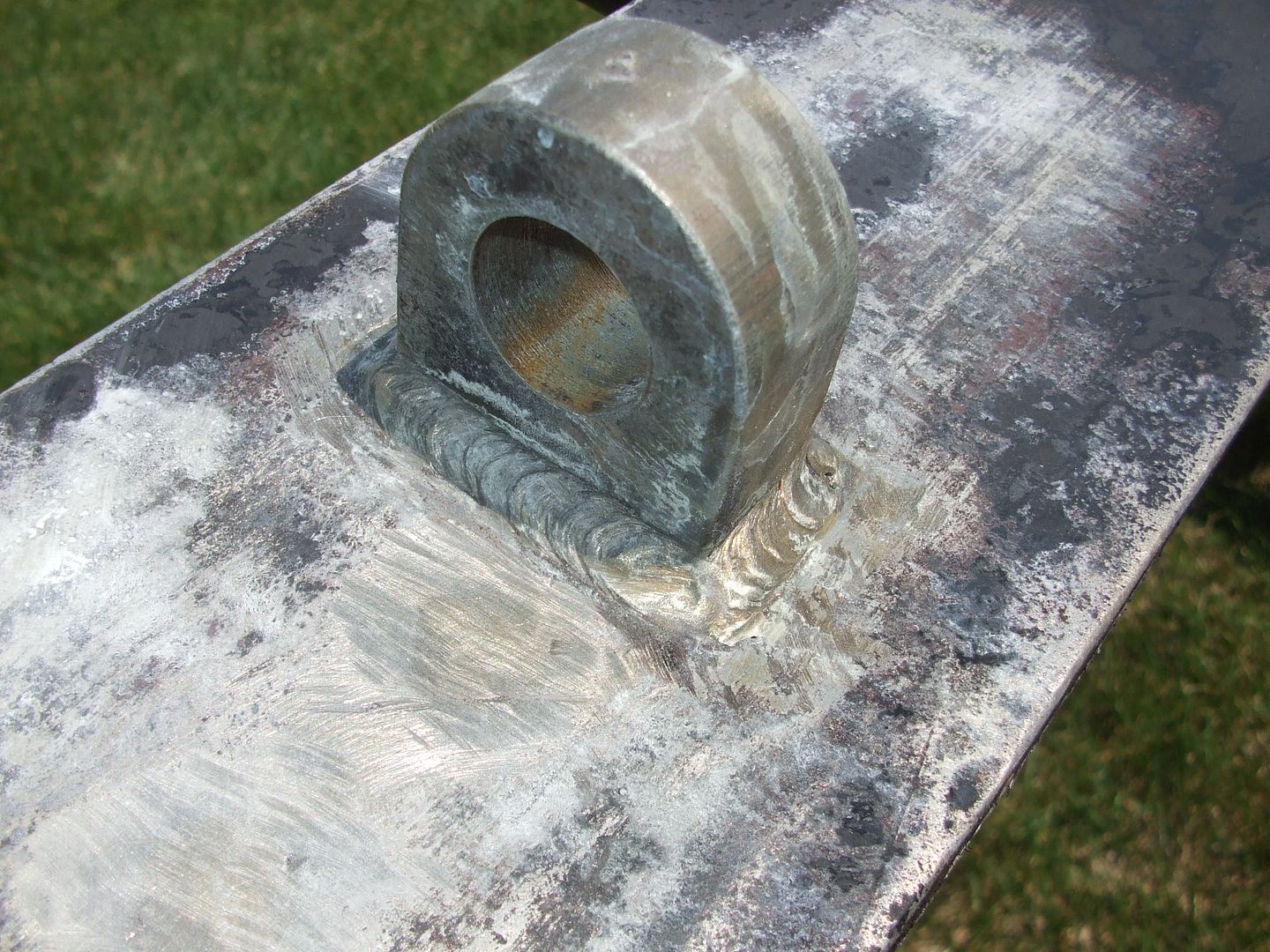

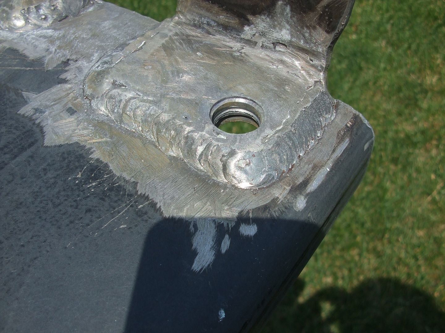

One of the welds after being cleaned and to show how the Metal Ready changes the metal's color after being soaked with it.

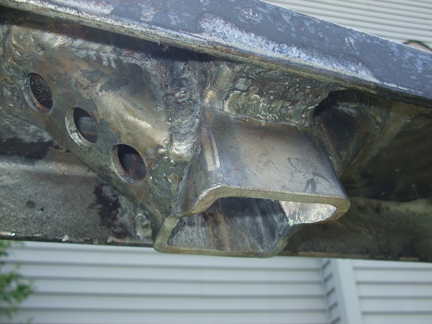

The bumper had already been painted with POR and Blackcoat before I added in the clevis mounts and receiver so I just wire wheeled off the loose paint from the welding heat and gave the entire piece a once over with 80 grit paper on the DA sander.
Shot of the clevis welds all cleaned and ready to paint.
A shot of the receiver gussets on the back side of the bumper.
All those pieces are now ready for two coats of POR and then another two coats of Blackcoat.

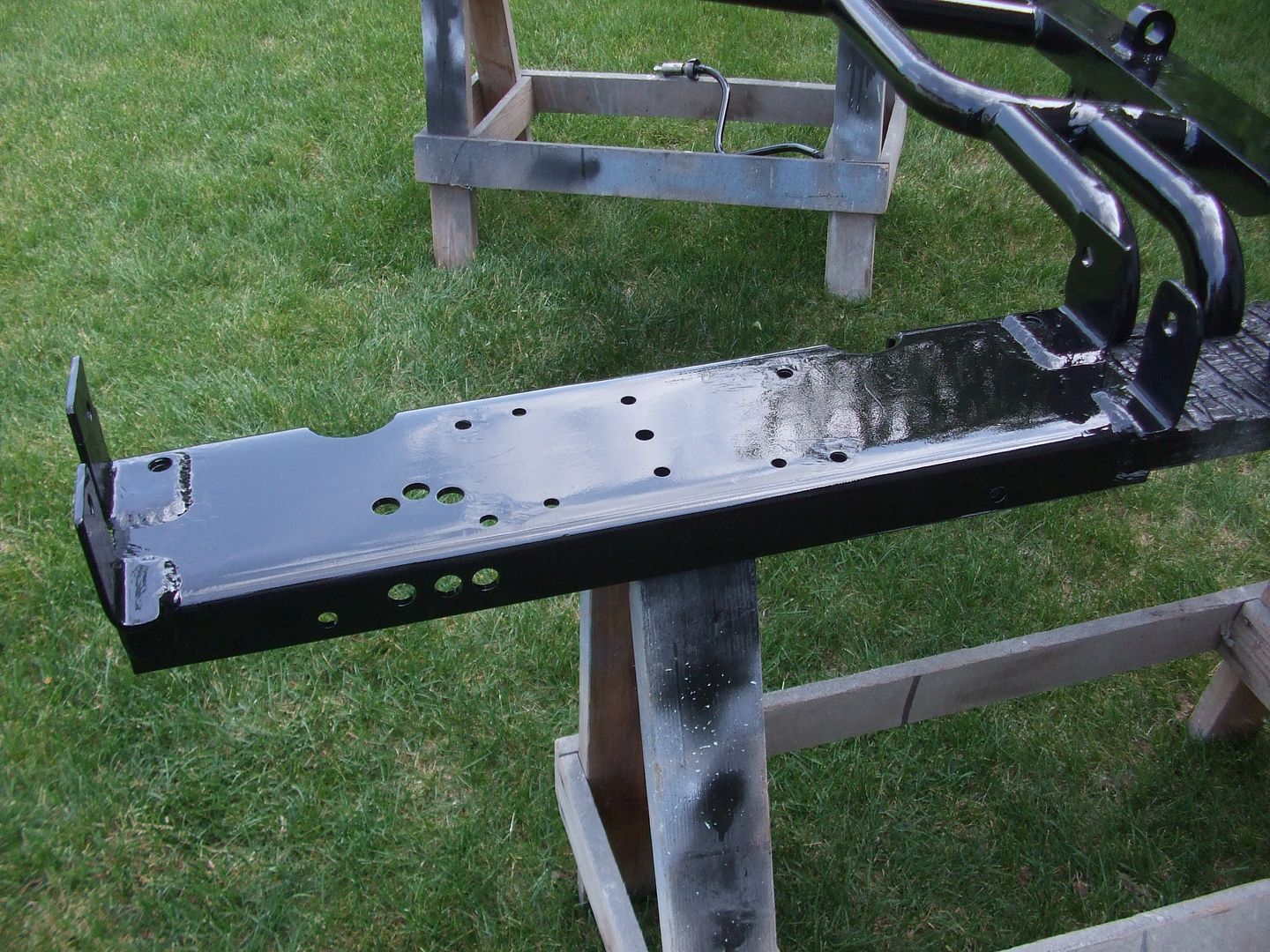

Winch Plate and Front Bumper Painting

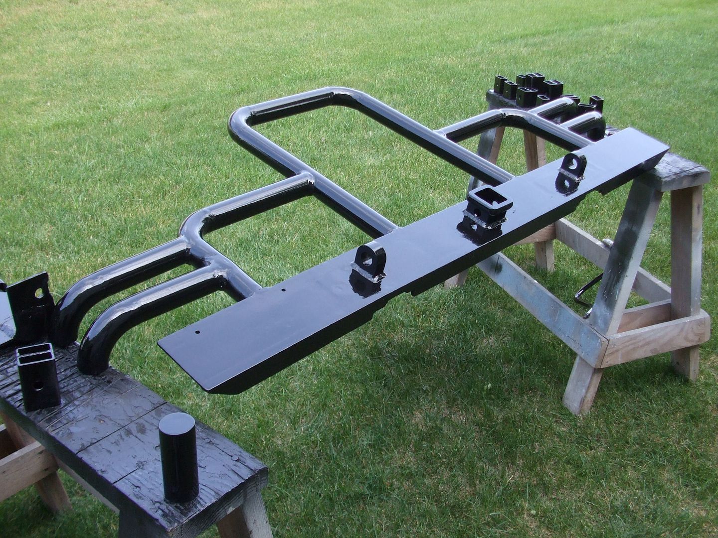

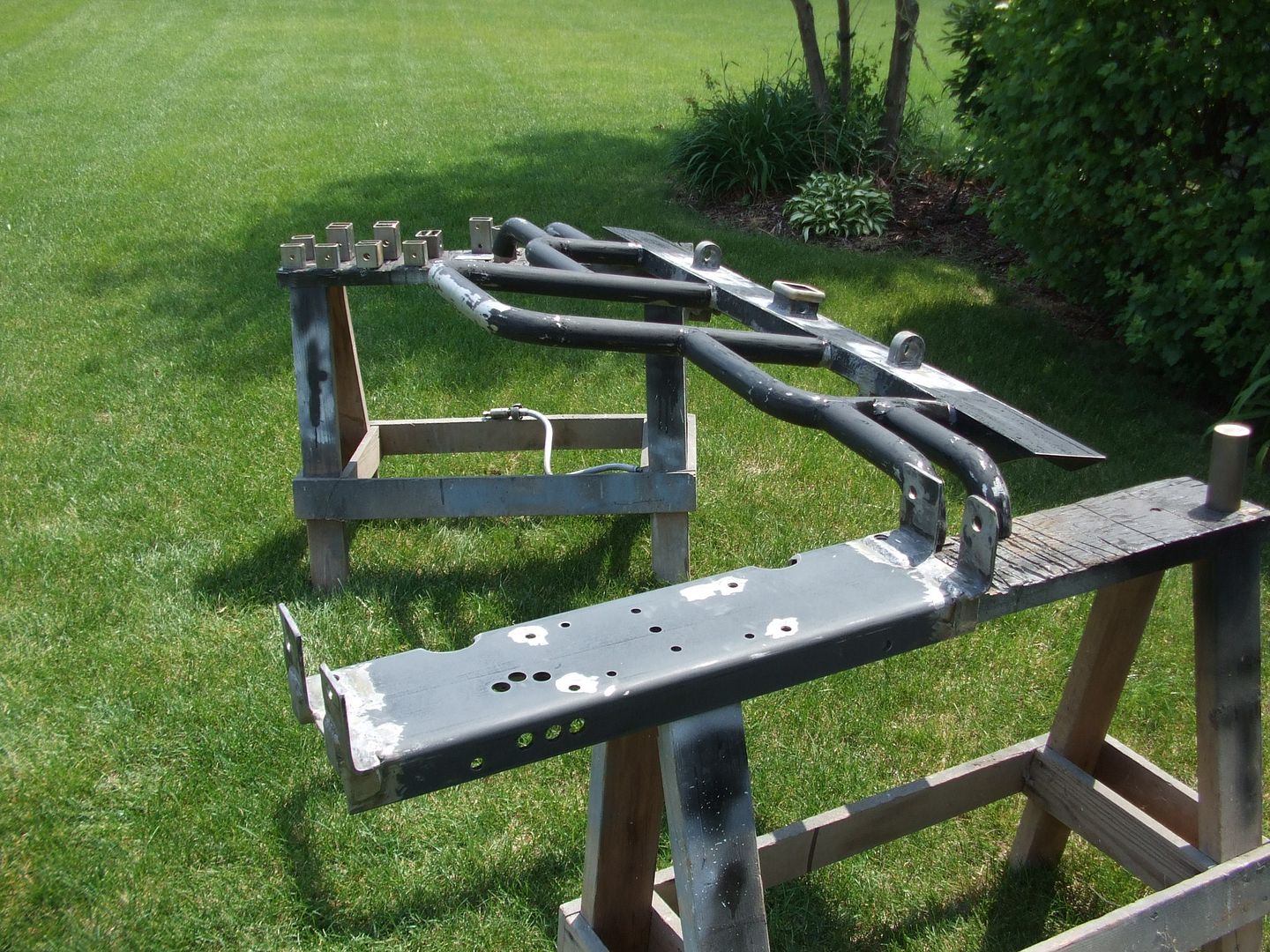

I used the same set up as before with my Harbor Freight HVLP gun and compressor set on 35 psi and went to spraying the POR thinned at 10%. Here is the bottom of the winch mount with the first coat sprayed.
A shot of the bumper and other small parts.

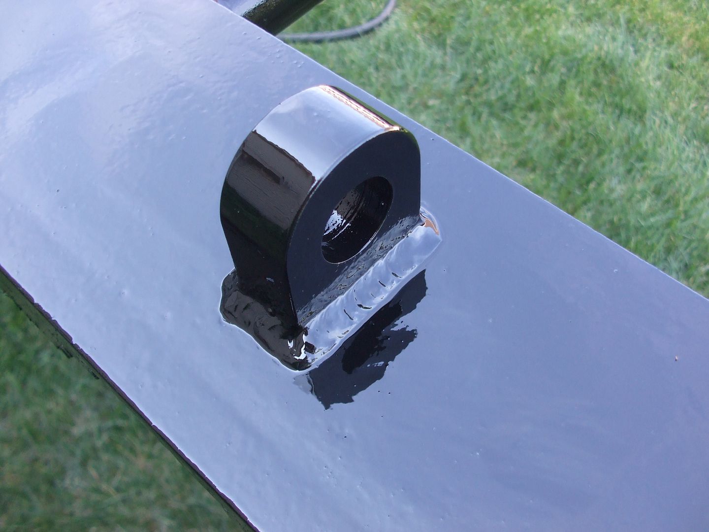

A picture of the POR finish, Blackcoat still to come.
