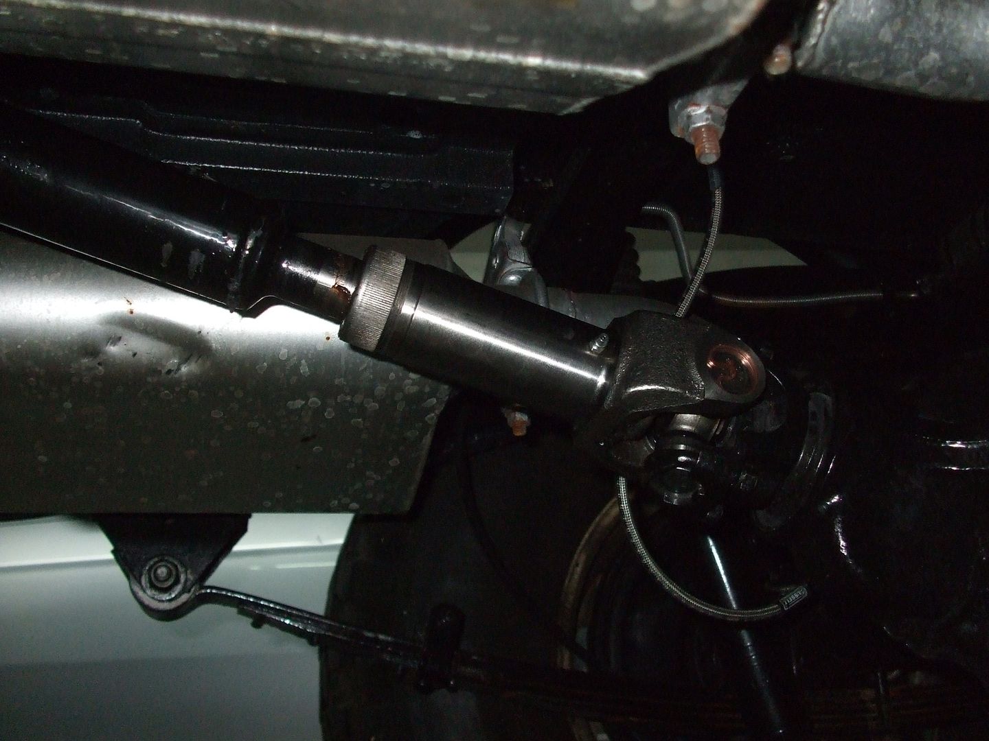

Alright, the CobraJ-7 is back in business. I stopped by the driveshaft shop where I had picked up the rear driveshaft from and showed him my broken slip yoke. I told him I saw they were $50-90 online but I couldn't find a replacement with the exact dimensions. He pulls a Spicer yoke off the shelf and looks it up in the book with a list price of $144.
He stood there for a second and says, how about $50? Make it $60 and I'll throw in a solid Spicer u-joint. So $60 and an hour later we are back in business. I took it on a quick drive up to 65mph with no vibrations so I don't have to take the entire shaft back out to be balanced.
Mike
