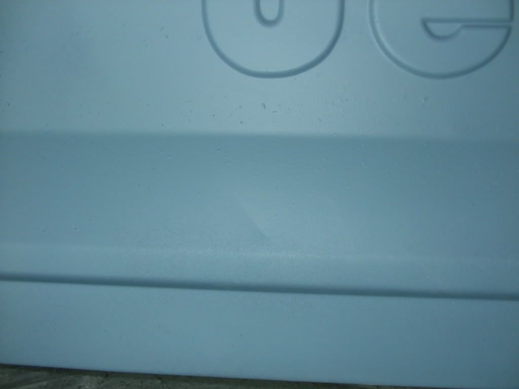

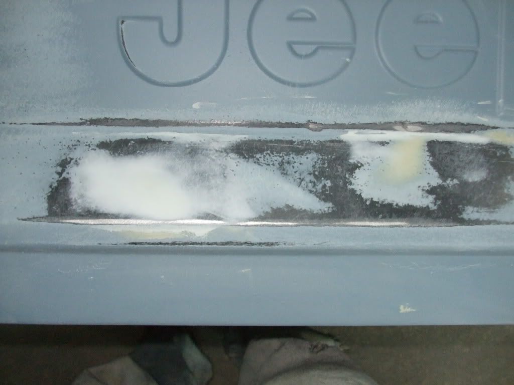

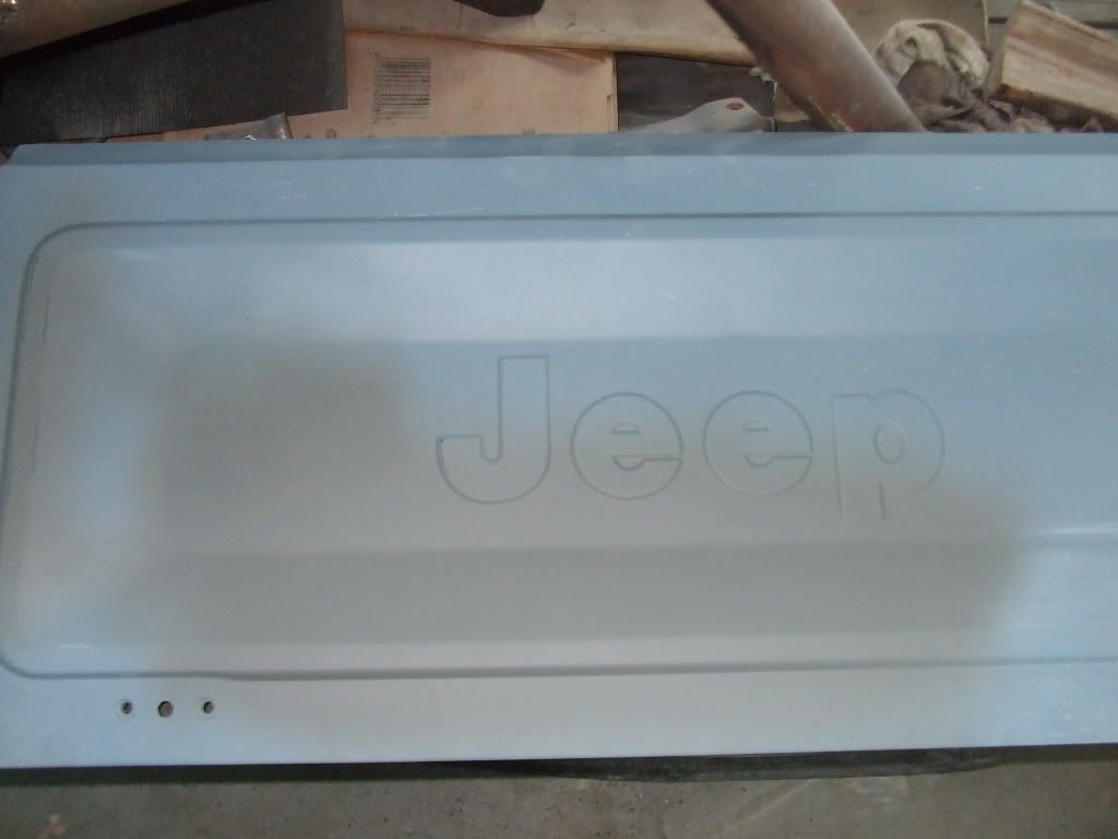

Tailgate Dent
^^^ Thanks

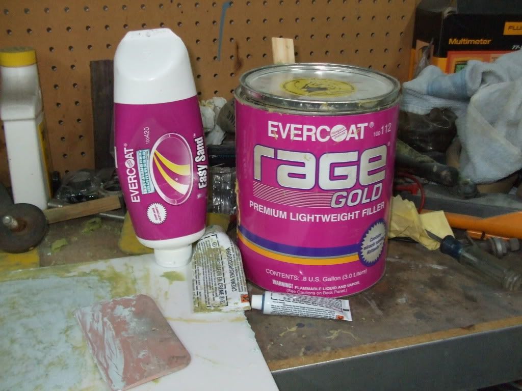

I purchased a mixing board, gallon of Evercoat Rage Gold and a tube of Evercoat Easy Sand to use on the tub to smooth everything out. The mixing board actually cracked and broke while using it so I bought a cutting board from Farm and Fleet for $10. It is much thicker and worked much better then the $3 mixing board.
I had a couple small dents in the tailgate and figured this was the easiest piece to start repairs on to see how this filler was going to work. I have a lot of experience with Bondo on motorcycle fiberglass bodies but this is the first time I had used the Evercoat products. I must say it is much better than the Bondo brand. It costs twice as much for a reason. This is the only dent in the tailgate that was big enough to show up in the photos.
I scuffed up the primer with the dual orbital sander and applied a single coat of filler. I sanded that smooth with 60 grit sand paper then applied a coat of the Easy Sand.
I sanded that smooth with some 240 grit sand paper.
Next I applied a light coat of primer to see how it was going to look. It came out great and is now ready for a light sanding then a full coat of primer and should be ready for color.
After that I started in on the main tub.

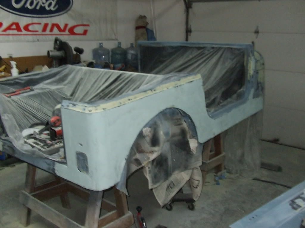

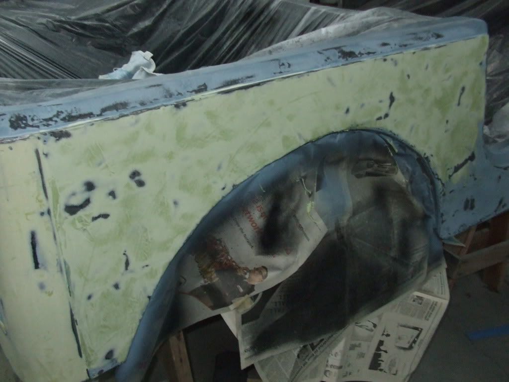

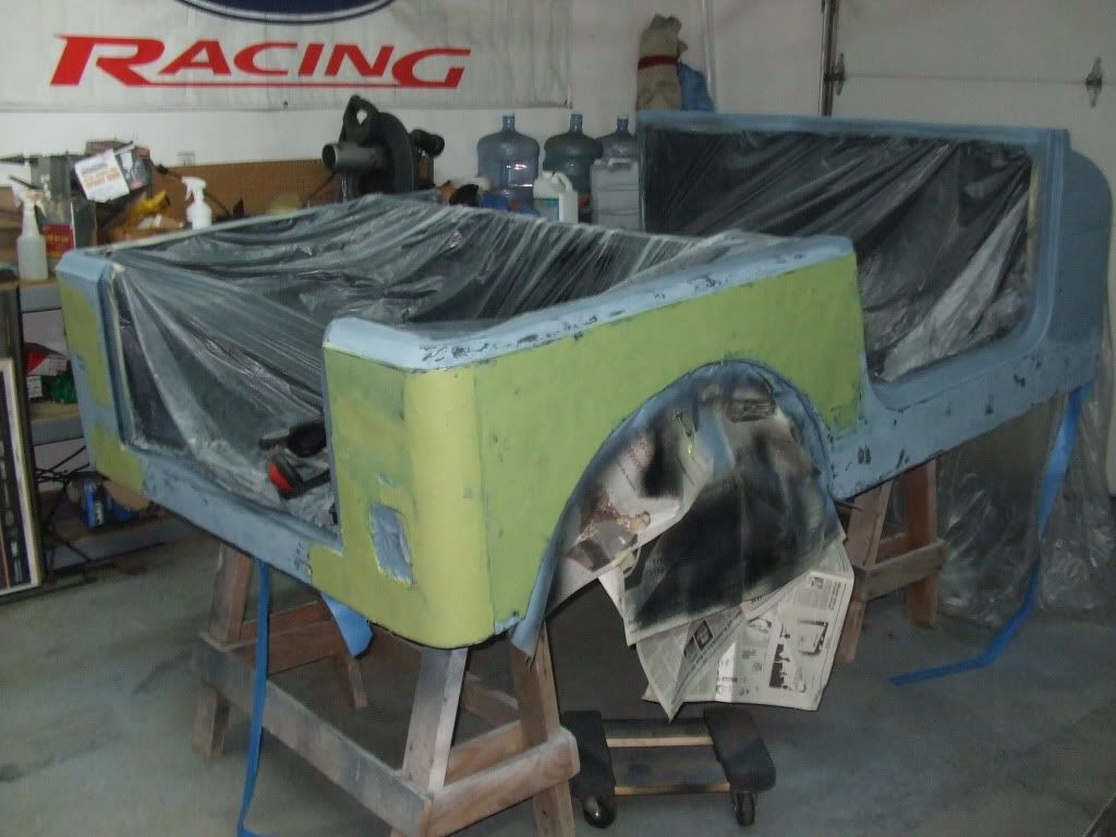

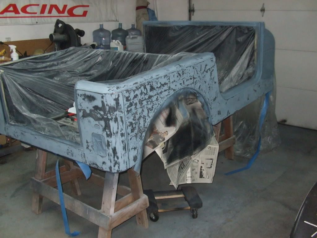

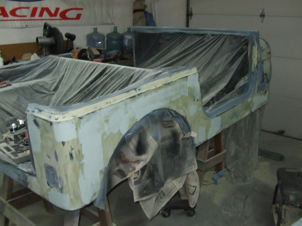

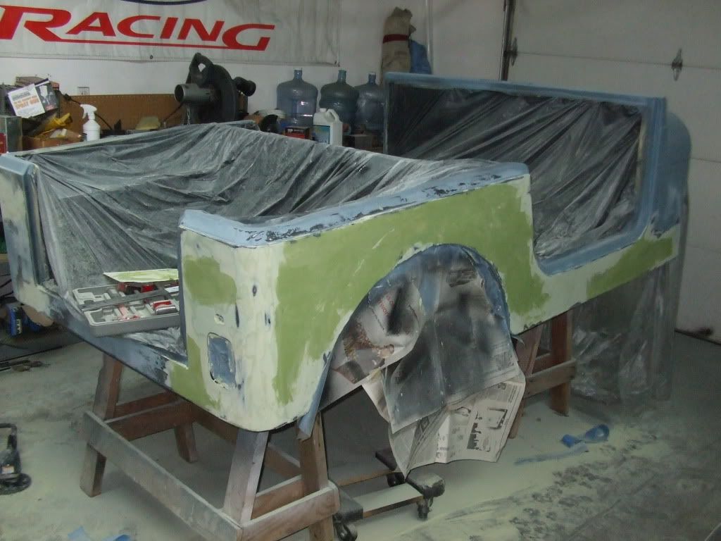

Body Filler Work

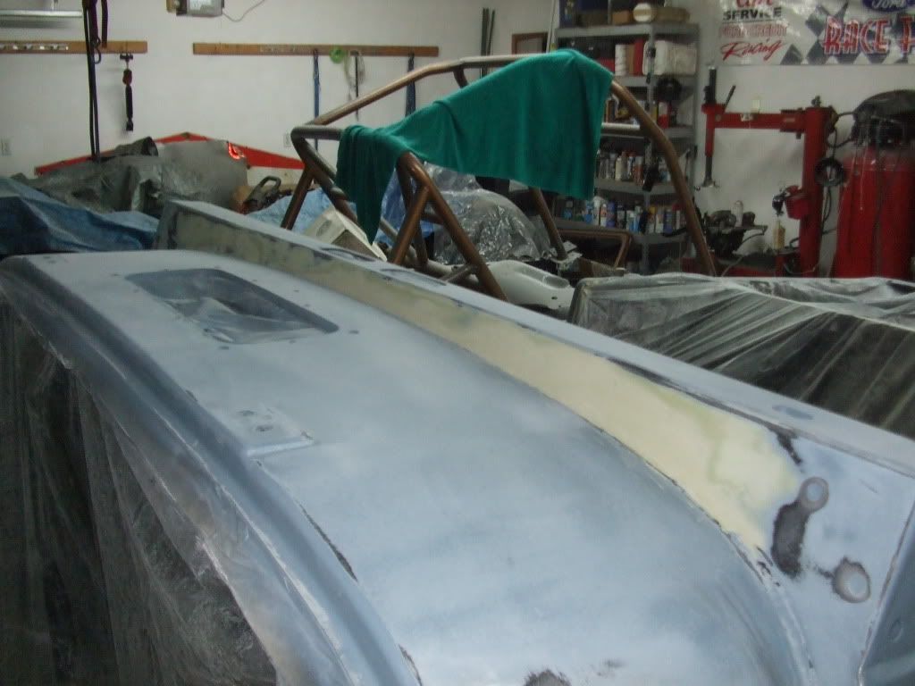

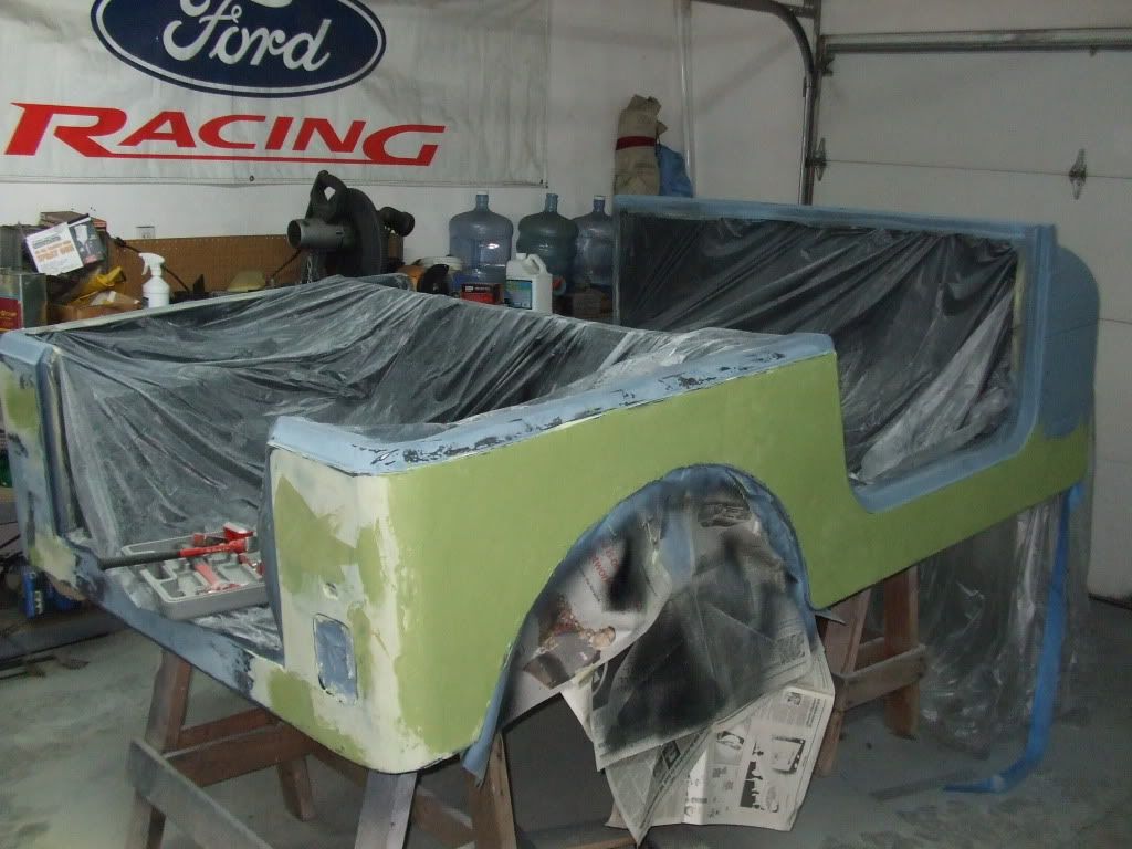

I basically took it one side at a time. First I had to scuff up all the paint to give the body filler something gritty to bite onto. I used a dual action orbital sander to scuff everything up. You can see how wavy the passenger's rear quarter panel is. I tried to get a nice scuff on the paint without going all the way through the POR layer to the bare metal.
I spread on the first layer pretty thin. You actually want to press very hard and make it so thin that it appears that the metal is wet. Then you go back and apply the filler to where you are actually starting to build up some material.
If you time it right you can knock off the high spots of the filler without too much effort. You want to do the major sanding as the filler is still a little gummy. If you wait until it is fully cured, the amount of sanding needed is dramatically increased. So I hit it with my 17" air sander with 60 grit sandpaper to complete the initial smoothing.
You can see how the light color gold is basically smooth while the darker color yellow is where the low spots remain.
Here I applied the second coat and made it just a bit thicker.
After sanding this layer you can see how most of it smoothed out with only a couple low spots remaining.
Here I applied one final layer of filler to fill in the last of the low spots.
After that was sanded and the side of the body was flat and smooth, I applied a light coat of Easy Sand. This is filler which is used to cover light imperfections and any pinholes left in the main body filler. It is a bit easier to sand then the Rage Gold and dries to a white color with just a light blue tint from the hardening cream.
I had so much Easy Sand and loved they way it worked so I actually decided to just apply a light coat to the entire tub were any filler was applied. Here is the passenger's side basically done and sanded down with 240 grit sand paper. I'll apply primer to see the final product then complete any last minute touch ups before I apply color in the spring.
Mike

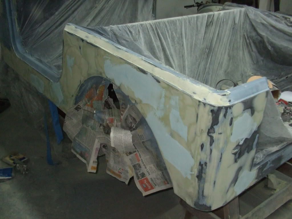

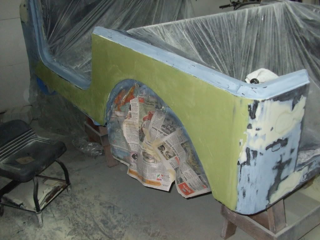

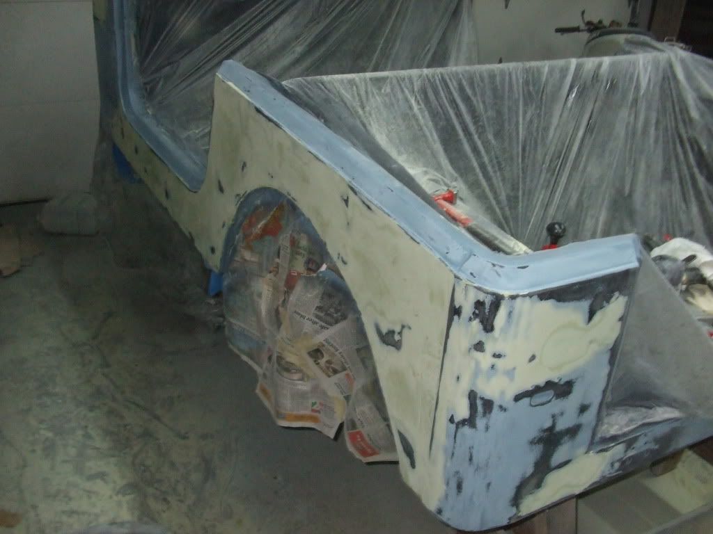

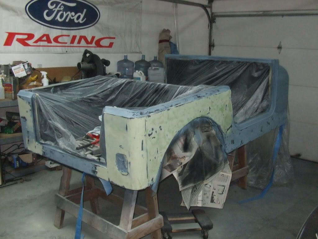

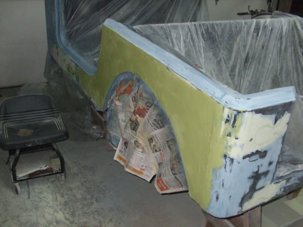

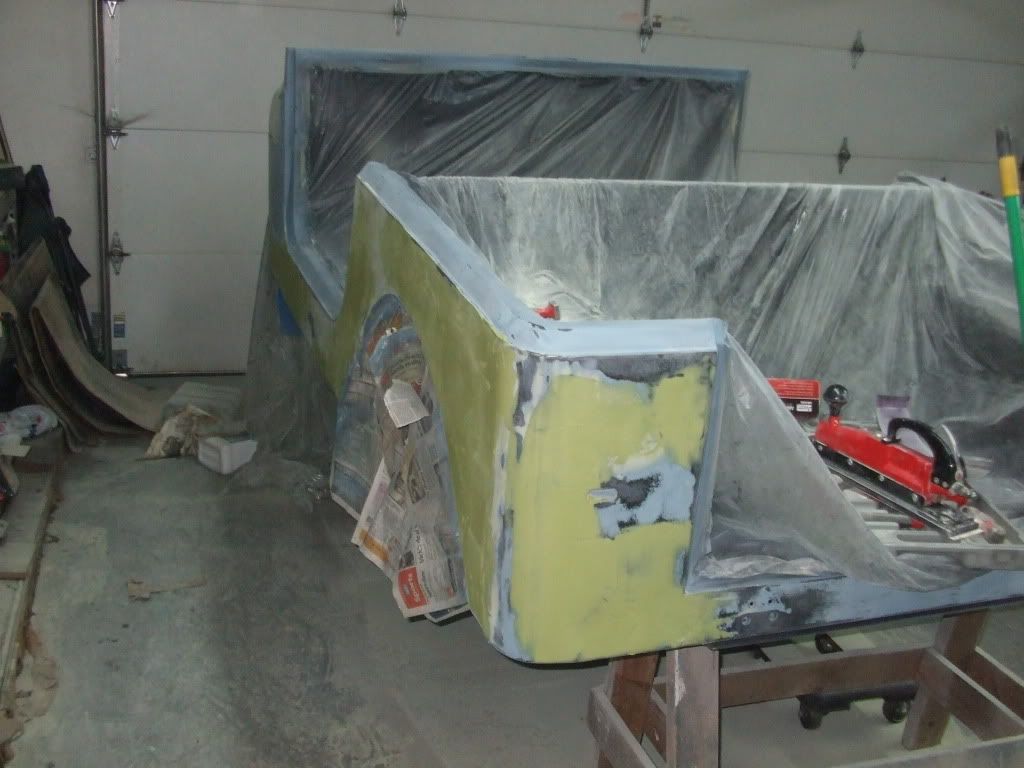

Drivers Side Filler Work

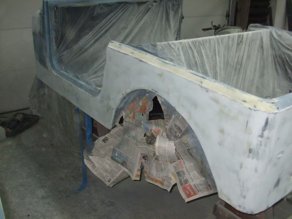

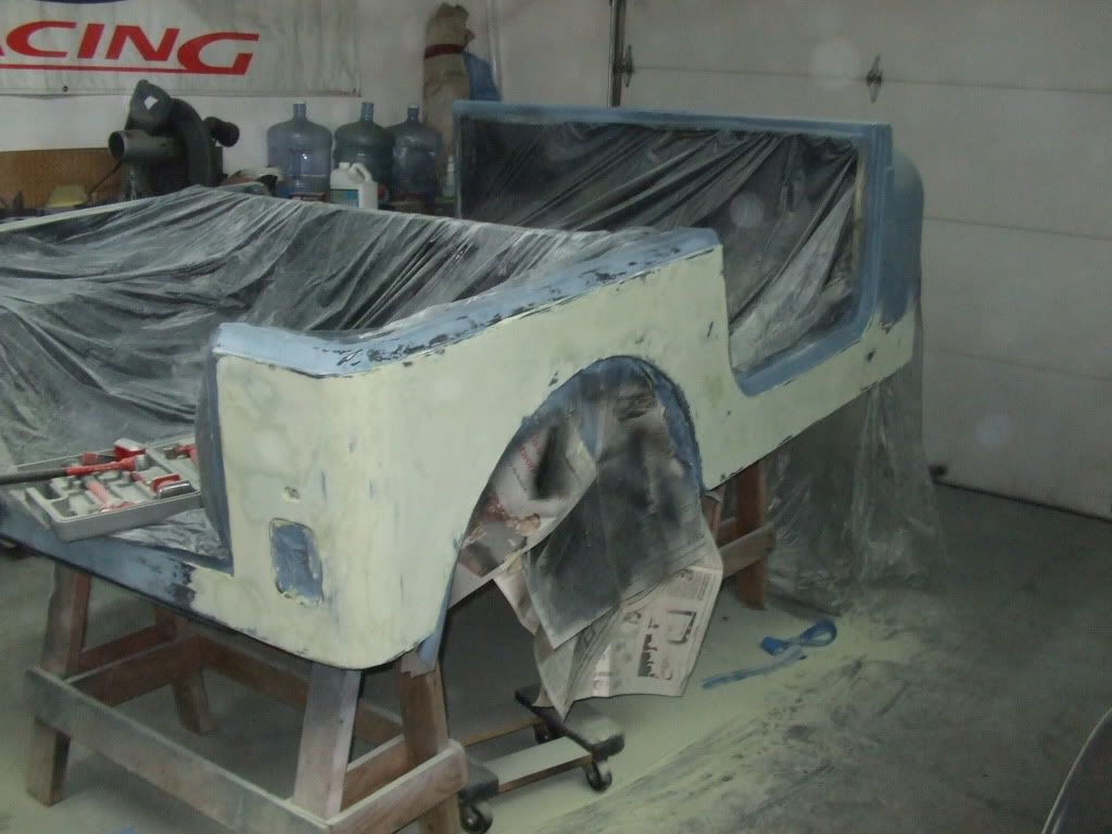

I started in on the driver's side. You can see the scratches in the primer where I ran my flat edge up and down the side to see where the high and low spots were.
I scuffed up the primer with my dual action orbital sander and put on a light first coat. I sanded it out then applied a slightly heavier second coat. Here it is waiting for the filler to cure for another 5-10 minutes before I could start sanding.
I sanded out the second coat but I still had some low spots.
I spread on another coat and hoped it was thick enough to cover the low spots. I could have applied the filler much thicker and reduced the number of times I had to apply and sand but I was trying to avoid putting on more filler than I actually needed.
Here is one final coat of the main filler to smooth everything out.
I applied some Easy Sand to the obvious spots in the driver's side as well.
Here is a picture of the driver's side with the Easy Sand applied and sanded smooth with 240 grit sand paper.
Here is a picture of the filler work done on the cowl below the windshield. This was actually one of the easiest places to repair.
There were a few other spots that were fixed but nothing worth going into great detail over. It took me about three days worth of filler work taking my time to get most of it done. I know I will have to go back and do some final touch up with the filler and apply more primer before I apply color but I am at least 90% done with the filler work. The main areas I have left to smooth out are the straight edges on the top edges on the rear of the tub. I also have two small spots on the hood and the windshield frame to complete. I should be able to get both of those done in one day but probably won't get to those for a couple months.

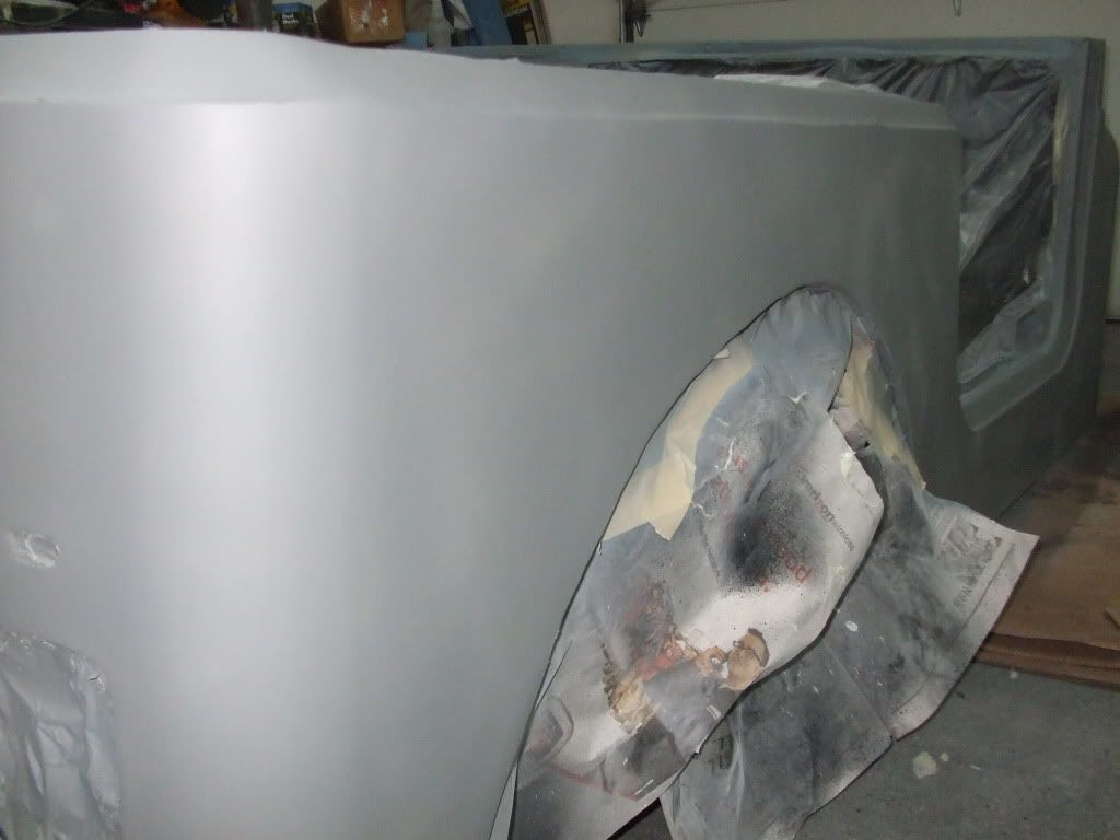

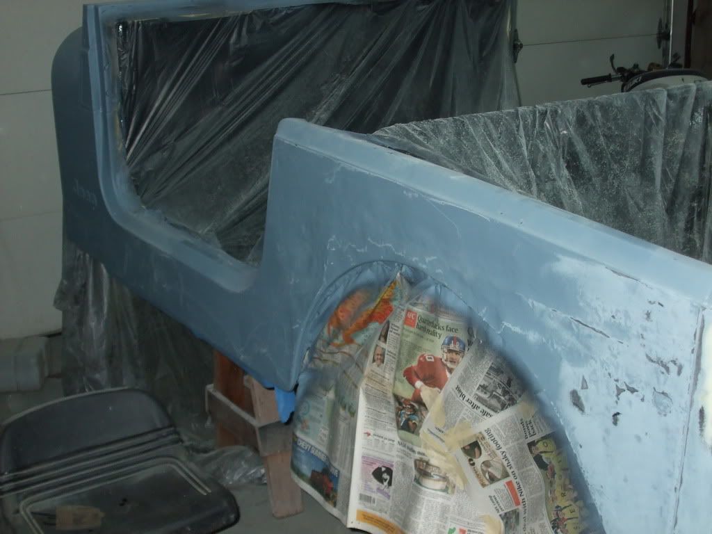

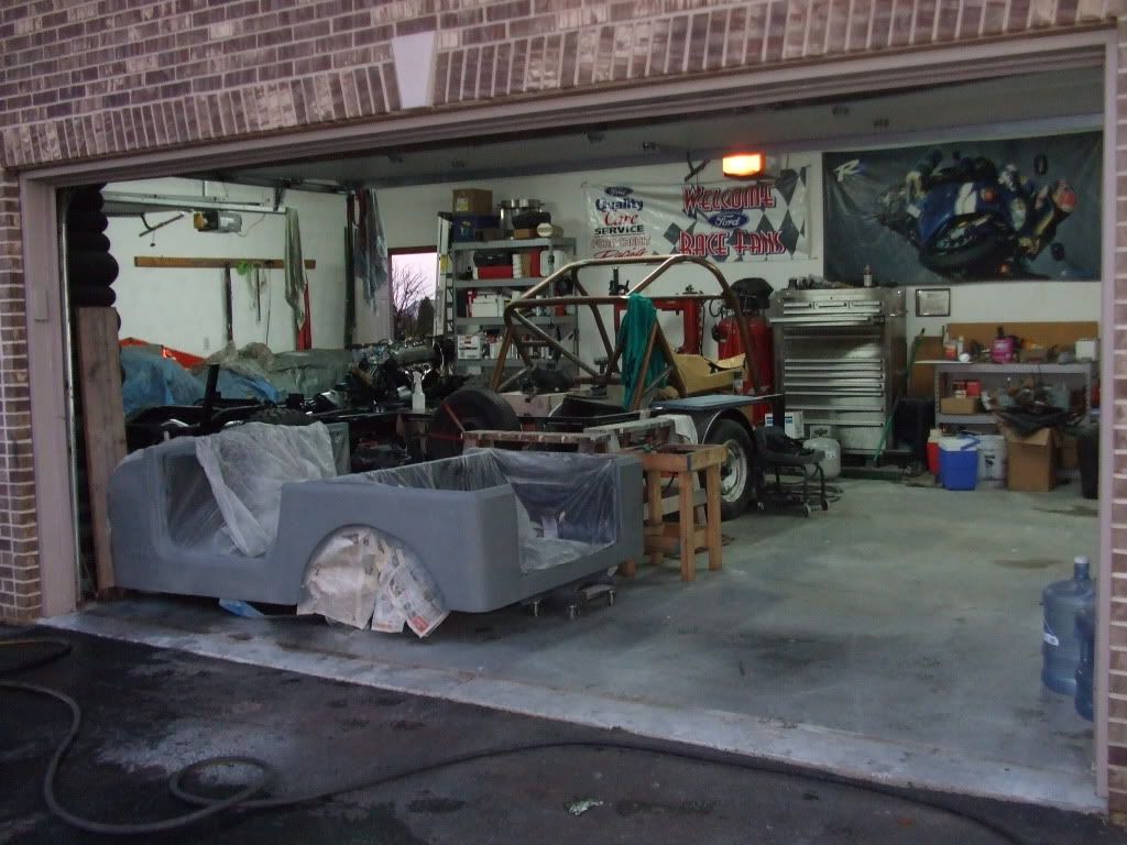

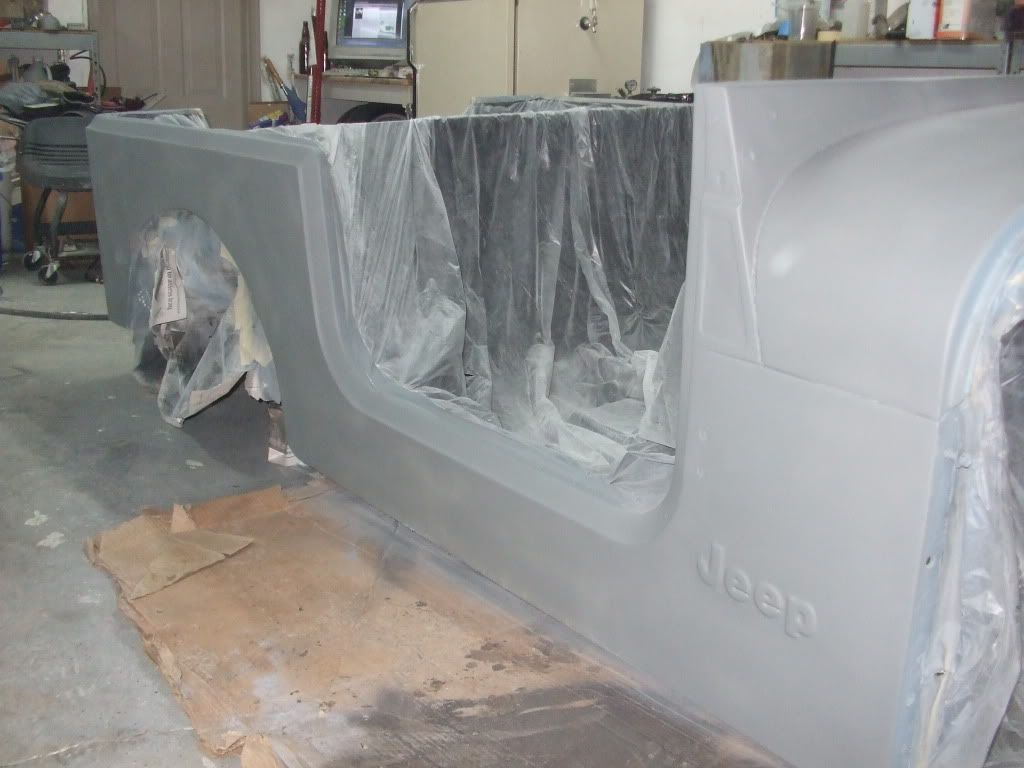

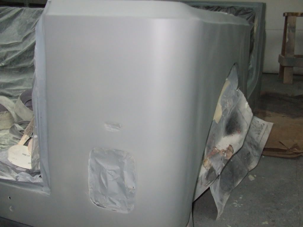

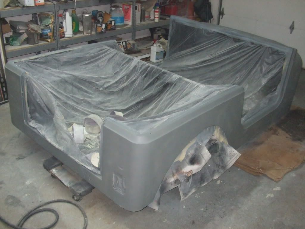

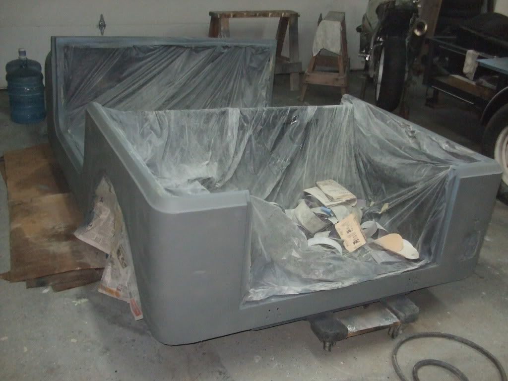

Applying Primer
^^^ Thanks. I also love the 5.0L.

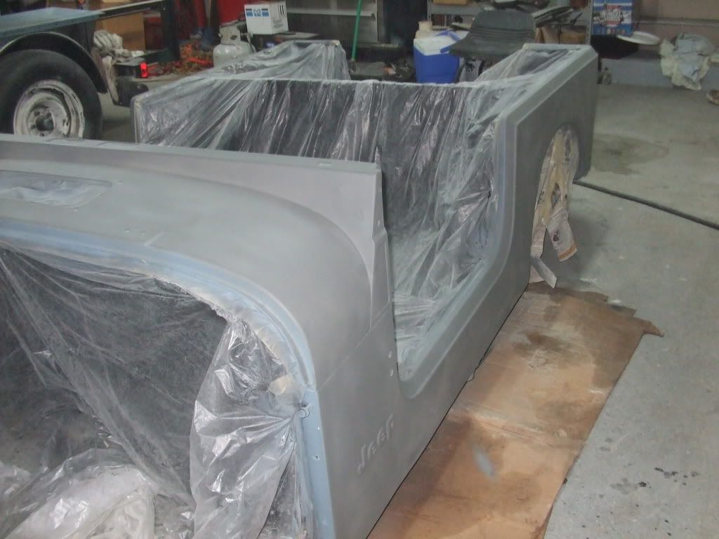

Since I got the majority of the filler work done I wanted to get a coat or two of primer on the tub so it was not sitting naked throughout the entire winter months. I wanted to seal the body filler because it is porous and reduce the risk of any flash rust on the parts that were sanded down enough to show bare metal.
Here it is after two light coats of primer out of my HVLP gun.
What do you think? Looks a little straighter then when I first started huh?
This picture shows the lip that I will straighten out just a bit better when I do my final filler work in the spring. The primer was a little light in places so you can see slight color differences but the panel is completely straight when checked with a straight edge.
Here is another view of the passenger's side from the front.
Here is a good picture of the driver's side.
Here is one last picture from the driver's rear corner.
Here is how she will sit for the next couple of months.
I will finish repairing the windshield frame then complete the main filler work on it and the hood over the next couple of months. After that I will complete all of the final touch up, prime and paint once it is warm enough to do so. I still need to cut a hole in my dash for a factory tachometer and I need to paint my fuel tank and skid plate so I can install them onto the frame. After that the chassis will basically be done. I am looking forward to getting paint on the body and getting this thing put back together. It is really coming along and I am definitely upbeat about the progress I have made to this point. I'm currently in Colorado for the holidays and am enjoying taking a little time away from the Jeep. I should be recharged and ready to dive in head first once I get home and will work on the small details until the weather cooperates for me to paint.
