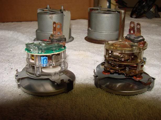

There are two types.....pre 81ish has brass gears and self winds every minute or so. The later "quartz" style is plastic and has a constant running mini motor. Most stop due to moisture inside, corrosion, spider webs, etc.....Enjoy the comparison pics...
Ed
That's interesting. In your experience which has been the better design? I would think the brass would be more durable, but the newer one would have an updated design that might be better.

While I have seen more of the QUARTZ style still running, that could be due to they are newer in the grand timeline and there was more of them made. The one in my 86 runs like a champ, but is slightly harder to adjust now than in years past. I got an old brass one to work again, but only by spraying the insides with T9 spray lube which leaves a waxy film.....I would take the newer ones because I read somewhere (maybe owners manual or dealer book) that if you adjust the time twice within a certain time, the clock will slow down or speed up to reflect the changes.....so it will be more accurate.
