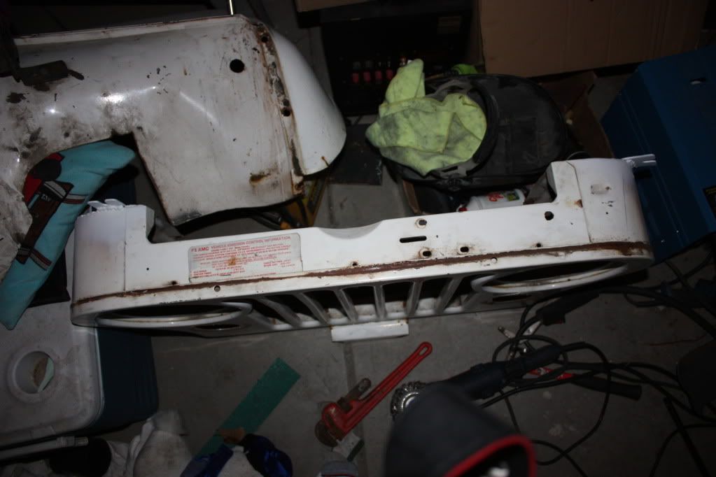

Does anybody have any convenient "looking down" pics of the top of your grill? I believe the PO notched/cut Clay's grill to allow replacement of the radiator... at any rate, this is what it looks like, and it's ugly! Maybe I'll get to weld something on Clay's rig afterall!?

sorry, no pics, but that looks cut out. mine is just a boxed area that you slide the raditator into.
Ben
Ordinarily, to replace the radiator, wouldn't you have to pull the shroud, maybe fan, etc, and pull it from the inside?? Ben, if you get a chance, can you post a pic?
how ironic, I JUST put my front end back together today.
1. bolt on the grill
2. slip in the radiator
3. slip the shroud around the fan (give it the shimmy)
4. bolt it all to the grill.
I am almost done buttoning up the whole front end and moving onto the dash. I have closed up shop tonight but ill snag some pitcures tomorrow!
Ben
Ben
Thank you, Sir!

Here ya go sir...

Originally Posted by sonicr1 View Post
Here ya go sir...
Thanks, Bill. I'm glad to see that PO didn't remove much metal at all! Better than I was expecting...

Now, as for the grill, looking at yours, I am still trying to figure out what those reliefs would accomplish. At least with my radiator, it just sits in the opening, and it attaches to the grill on the outside. Was the radiator mounted inside so the engine/tranny/tc could be pushed forward a few inches?
Right on the money, Bill!!
The relief cuts were done by the PO. In a strange and twisted sort of way it makes sense! And I can say that it works... PO cut the reliefs to enable him to slide the radiator up. Remove 4 bolts and up and out.
