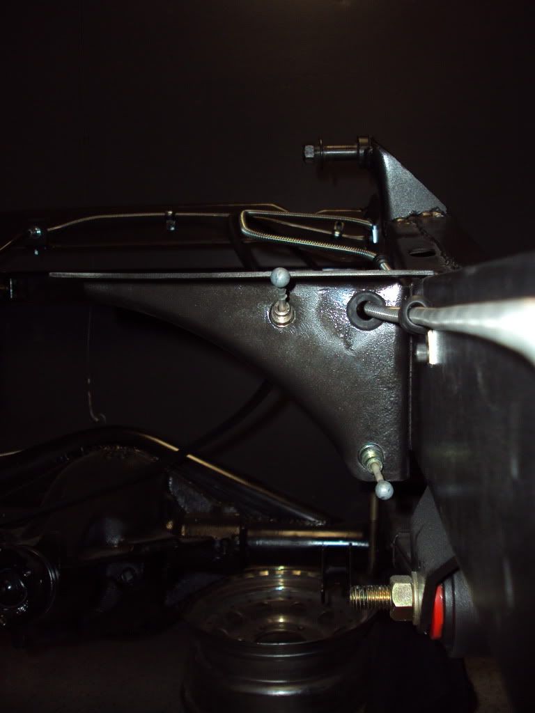

I am trying to reinstall the brake lines. Ag-gra-va-ting! Do the lines run through these holes? I have seen some pics where they were and rubber grommets were used. If yes, where did you get the grommets?

Scott, unless a 5 is much different than a 7, the return, vapor and brake lines run like this with a hold down on top.
EDIT: On second thought, it probably is different.... so ignore my attempt to help.

The lower arrow in your pic is for one of the parking brake cables. I will get a pic of mine when I go out to get back to work.

Those are the e-brake cable holes, I didn't like the way my brake line looked on my build so I drilled an additional hole, installed a grommet (got a grommet assortment from Harbor Freight) and ran it through that bracket.

You may be absolutely right about the lines. I have them sitting where they seem to "want" to go. The PO had told me that he ran all new brakes/lines, etc... but he lied! She DOES have new pads up front however. I will investigate that route.

This is the Pic that I remember seeing! You did a beautiful job with that. I think it was smart to do. Maybe I'll go this route...

Hey here's a shot of the brake lines. Hopefully it's a good enough image that you'll be able to see something that will do you some good.

I have determined that this is the routing that the PO used... factory or not. So I put it back the same way. I think he bought bulk line and made his own bends. I ended up with, I believe, too much line at the rear axle. I wanted to get pics tonight but it's just too dark, so I'll do it tomorrow. I bought nylon cable clamps to tie the line back to the frame. I thought they would be durable and not rust. I recommend that you use the metal clamps... the nylon is too light and will break.
Thanks VACJ7 for the pic.
