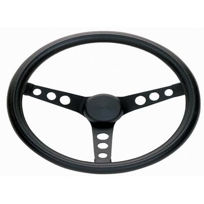

Thanks, Ben. You make me sick with envy! Clay needs a steering wheel pretty bad! Maybe a 3-spoker with horn button!!!! He's going to need flares and side-marker lights, shift knobs for a T18 and D20, if you come up with them. I know he NEEDS more, but I haven't gotten that far, and certainly we WANT more, but the budget doesn't allow right now. You are a great resource!
edit: Oh yeah... the rubber for the pedals. PO taped them on with wraps of electrical tape!

243
1978 FSJ Cherokee
Join Date: Sep 2002
Posts: 3,327
Like this?
or this?

I know about the steering wheel. I have that. Its like Dave posted but its a solid 3 spoke no design. I need to track down the button. I have the D20 knob. Not sure on the T18. I know I have a T18 but I need to see if it has a knob.

Originally Posted by 243 View Post
Like this?
Dat one!
