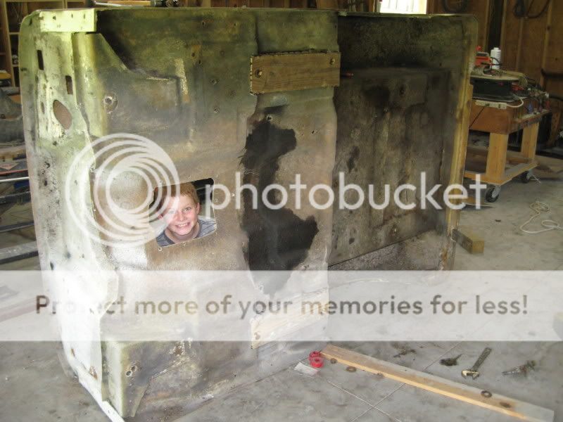

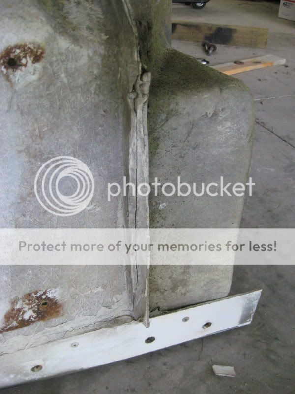

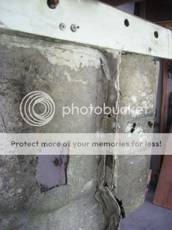

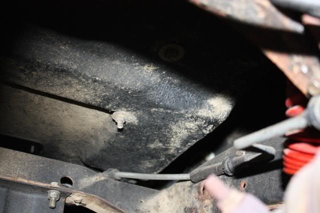

Clay and I had some Jeep work planned this morning. We pulled the tub and started prepping the underside. A couple of things jumped out immediately. Former PO repairs, the inevitable CJ oil stain, spiders, and the biggest problem, a Gremlin!

The biggest problem I found was this Gremlin! It was hard getting him out of the Jeep!

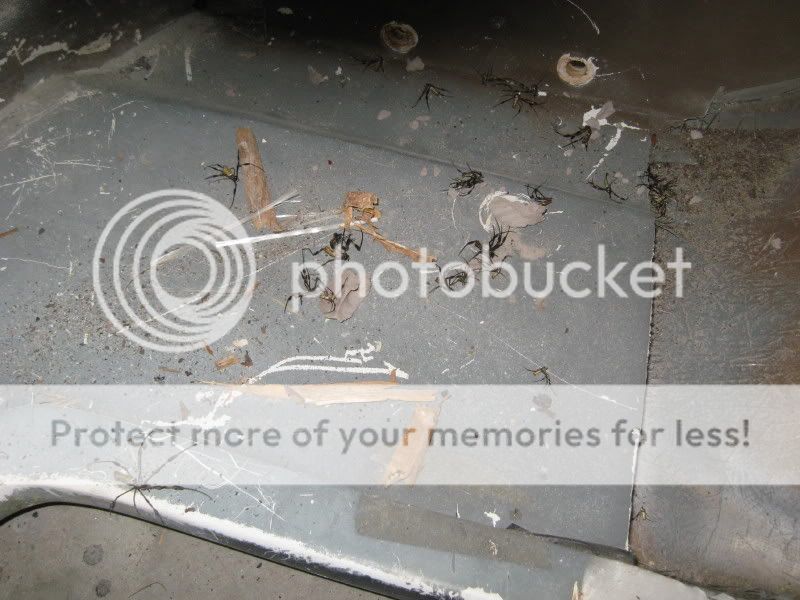

Then there was these spiders from a mud dobbers nest. Creepy!

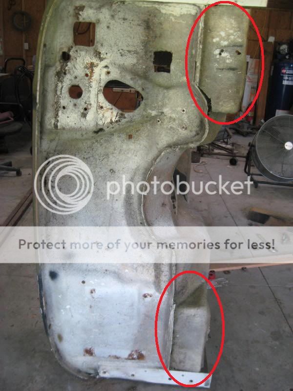

The circled areas are factory pieces installed for forward tub mounts. They are poorly designed. We will have to strengthen them.

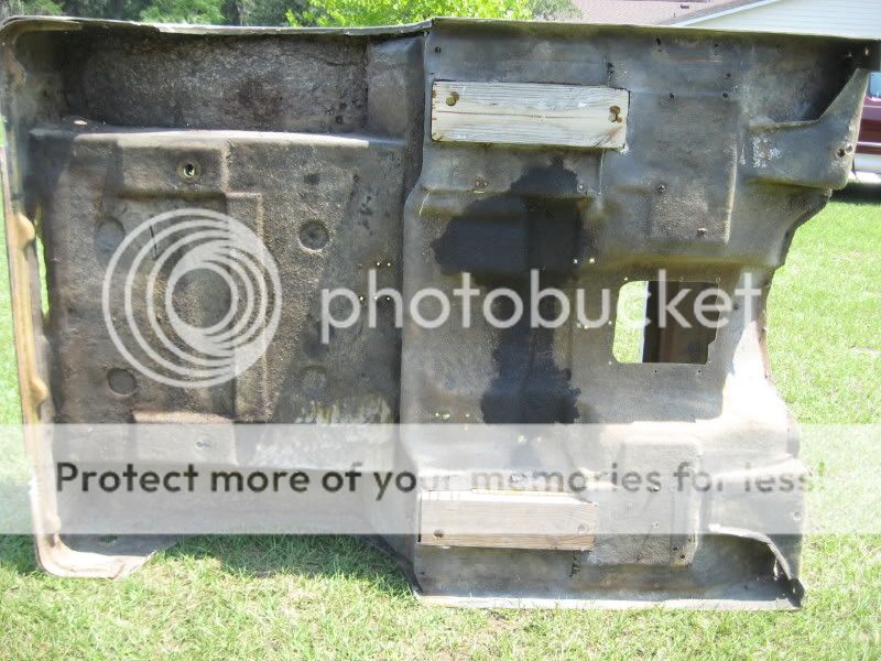

This is how to PO attempted to repair the passenger side tub mount. They were originally factory riveted. Does anybody have an idea of the brand of this glass tub?
The PO repair on the Driver's side. He used some kind of epoxy??

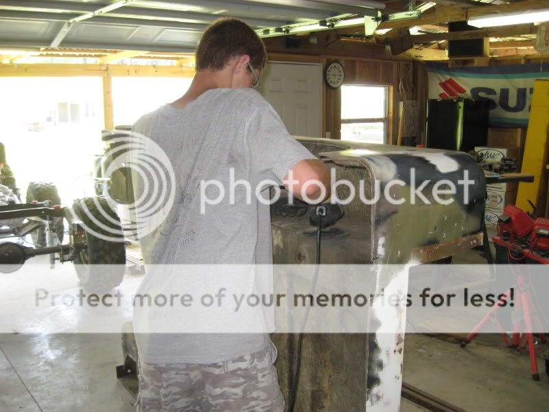

Clay using my sander/grinder with 36 grit. We decided we should pressure wash first!

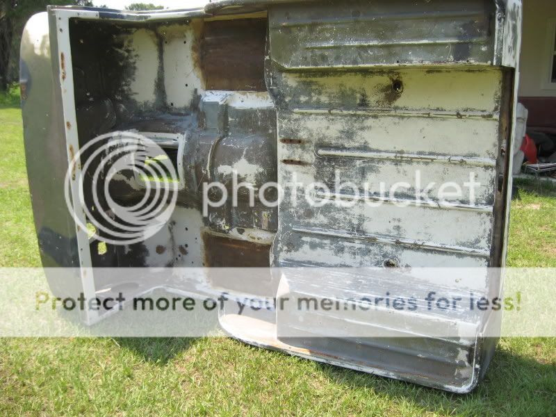

Shots in the sun.

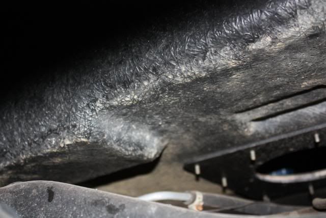

Bottom of tub with the well preserved tranny tunnel.

I need some help with this decision... what do ya'll think??
These areas in red are double-walled. They have a factory piece of plywood sandwiched between the glass. The two parallel areas are factory body mount areas. The vertical piece is a stringer for stiffening the tub. All of this wood is rotten.
1) We can cut out the glass, remove the rotted wood, replace it, and glass it back up. Then add stringers to the bottom of the tub for strength.
2) We can remove the double-walled stuff. Remove the rotten wood. Cover the entire area with 3/4 marine plywood, and glass it. This would give strength and mounting points.
3) Suggestions???
Thanks

I think either idea works good Scott. I am leaning towards the stringers though, kinda like what you did on the other spots.

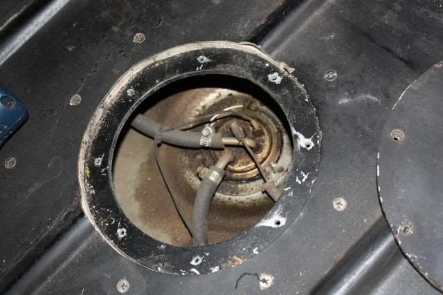

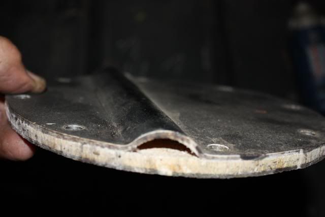

My fiberglass tub has plywood sandwiched in the entire area. So, apparently, that's how some of the manufacturers built them.

Originally Posted by Skerr View Post
The whole square bed area?? Thanks, Rich... that's good to know.
I remember seeing plywood, or some composite material when I made an access cover for my fuel sending unit. So, I just went out to the garage to make sure.
Here are a couple of pictures showing wood beneath the FG floor...
In this next pic, the cover cutout is in the recessed area, inboard of that nut and bolt hanging down...
So, the raised border around the recessed area is another type of reinforcement. Here's another pic...
The wood is only about 3/8" thick, so you may not need to go with 3/4" unless you want BEEFY!

3/4 would definitely be beefy! It could also cause a height problem at the puck, adding a half inch or so of extra height, making the back of the tub sit higher than the front. I'll have to study on it. The original glass is "soft" and used up from the sun. The bed area flexes pretty significantly (IMO) and I want to make it rigid. Maybe I'll just go with some 3/4" stringers and stick with factory wood thickness for the mounting areas. Thanks for posting the pics, Rich. That gives me a better idea of what I need to do.
