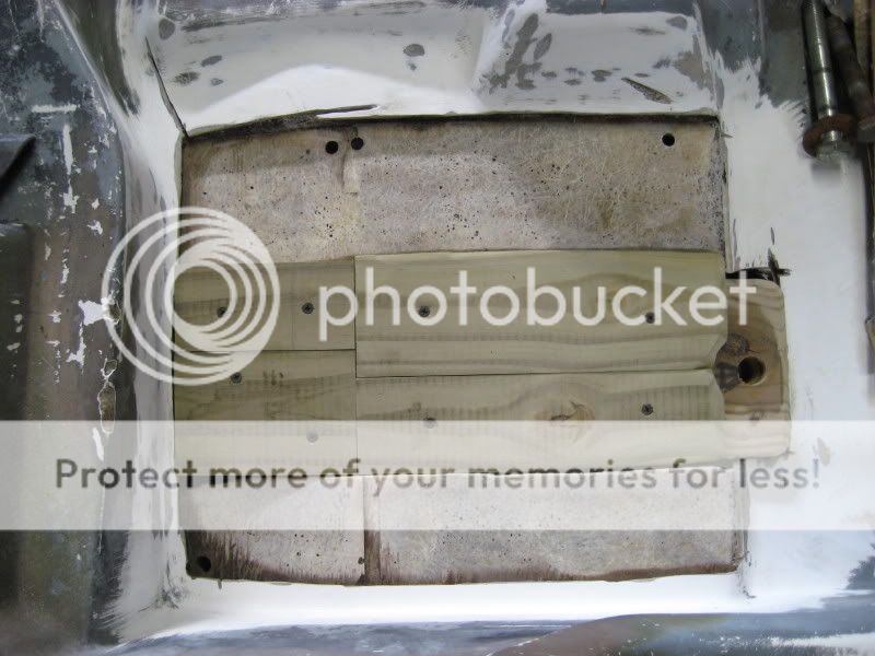

Originally Posted by Jim1611 View Post
Scott I've been looking at your support and wondering something. The wood and the surrounding glass, are they on the same level? Since the wieght of the tub will always be pushing down on the 2x6 should you tie it in everywhere? Like maybe even run some 1/4" x 2" flat steel across the wood and onto the glass and bond that in there too?
Maybe you already have that covered, if so never mind me.
You're dead-on Jim! They are not the same level. The factory had used a 1/4" piece of plywood between the two glass layers. It rotted out and created a void. In addition, the floor slopes downward as it goes toward the back of the tub, creating an even larger gap. The 3/4" 1X4s help fill that bigger gap in the back. We have some heavy mat to apply that will take up a lot of space. Then I have some heavy chop to apply on top of that. I will probably use a 1/4" piece of plywood as a filler too (wasn't planning on it, however) because it fits well. Once all the glass is done on the inside, and the filler (wood) material is in place, we will reattach the original plug that we removed from the floor. It will be stronger than factory on the inside, and once we turn it over and finish it from the bottom, it will be bullet-proof!

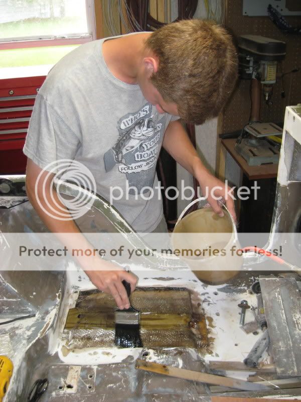

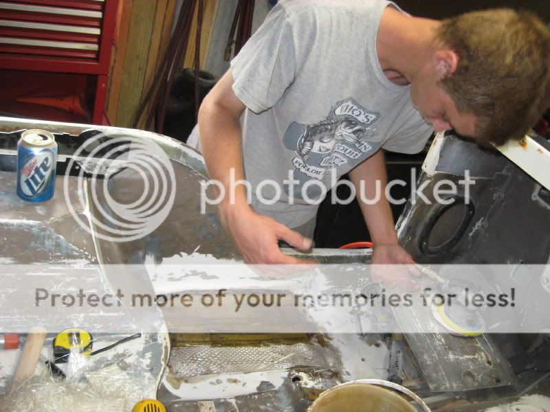

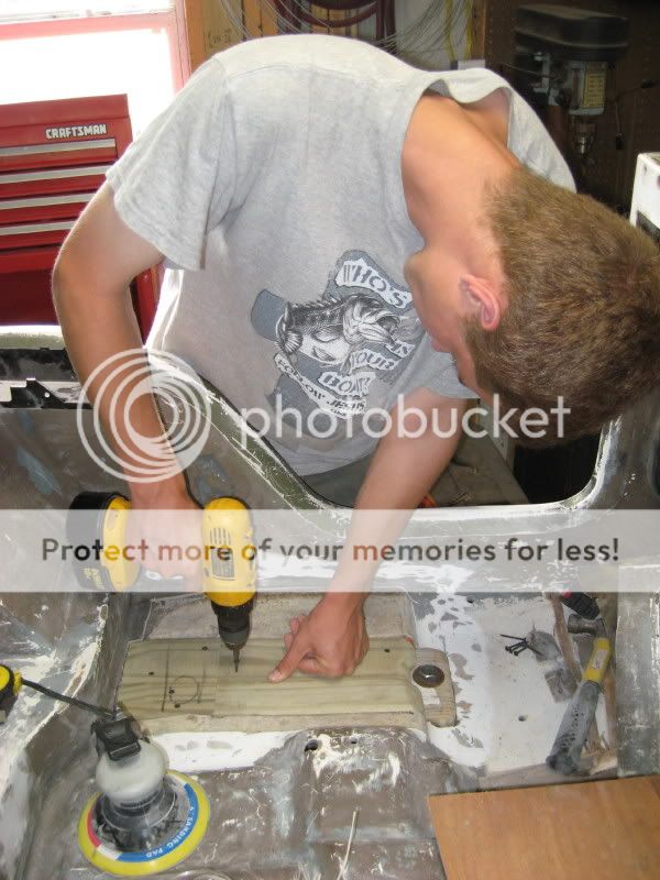

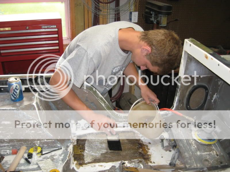

Here are some pictures from today's adventure! With all the English Sparrows swirling around the sky it was hard to get Clay in the shop!! Our goal this evening was to tack down the wood in a semi-finished state. Since we went through so much hassle to get the tub aligned, we couldn't pull the tub and do this on a stand... we had to do it on the frame to make sure our mounting holes stayed in alignment. Now that we have the mounting structure where it won't move, and the holes are where they need to be, I can feel better about working on this thing. I was afraid to lean on it too hard for fear of moving it on the frame, knocking the tub out of square! We're nearly out of resin. We used the last paint brush. And we need more glass! So this week we will just go out to the shop and look at it... sort of admire our work!
These are just pics of Clay doing his side. He really got into as he went. He made a mistake and I corrected him... and he reached down and grabbed the wet glass to move it before it kicked off!! He looked like a cat with a piece of tape on its paw!
Clay is screwing down the wood to keep it from moving around when he lays the glass down.
This is actually my side, but this is what it would look like.
Here Clay is dabbing resin into the cut fibers he shoved into the voids.

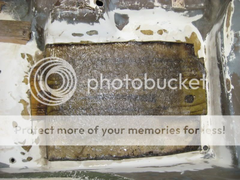

Clay painted the wood with a layer of resin to seal it, then he applied strips of heavy mat to the joints. He was hurrying and I corrected him, and he grabbed the strip and moved it with his fingers to get it right. I don't know what he THOUGHT was going to happen, but from that moment on, anything he grabbed he couldn't turn loose!!
Clay is finishing up his second strip.
A layer of 3 oz chop over the top of the mat strips and the wood body. This will seal the large "pores" in the mat, and better join the mat to the wood.
This is done for the night. We will add another layer of mat, and another layer of chop, then the 1/4" plywood. The plywood will be coated in resin to seal it and make it water proof. Then the floor plug will go back in place.
