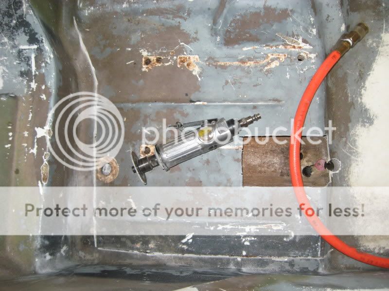

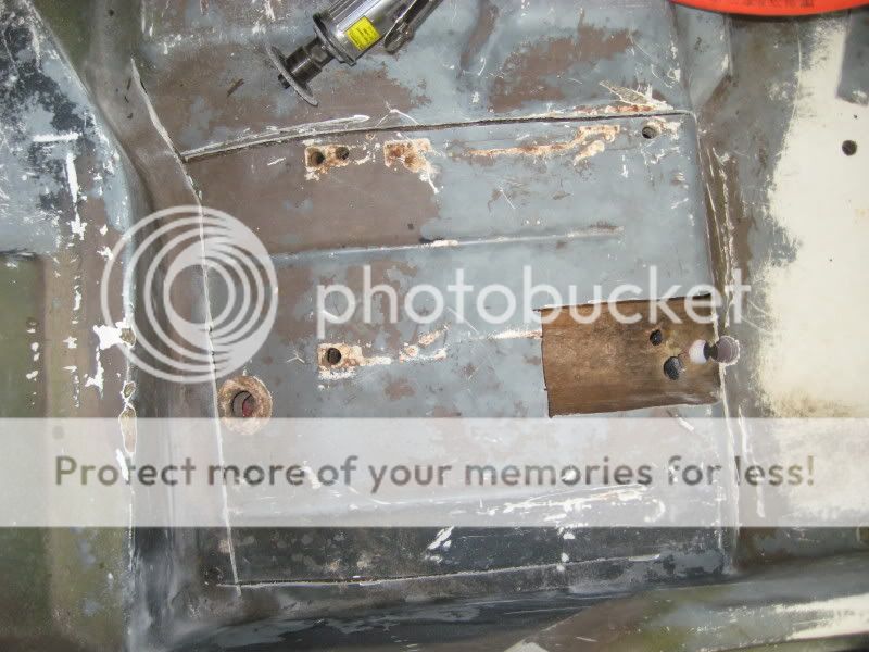

Here are some pics of the process I used to remove the floor panel. My wheel on my die-grinder broke and hit me in the left cheek and tip of my nose. Blood was running down my face. My wife cleaned me up... just a couple of small scratches. Totally surprised me. WEAR FACE PROTECTION AND DON'T KEEP YOUR HEAD OVER THE CUTTING WHEEL!
First cuts...

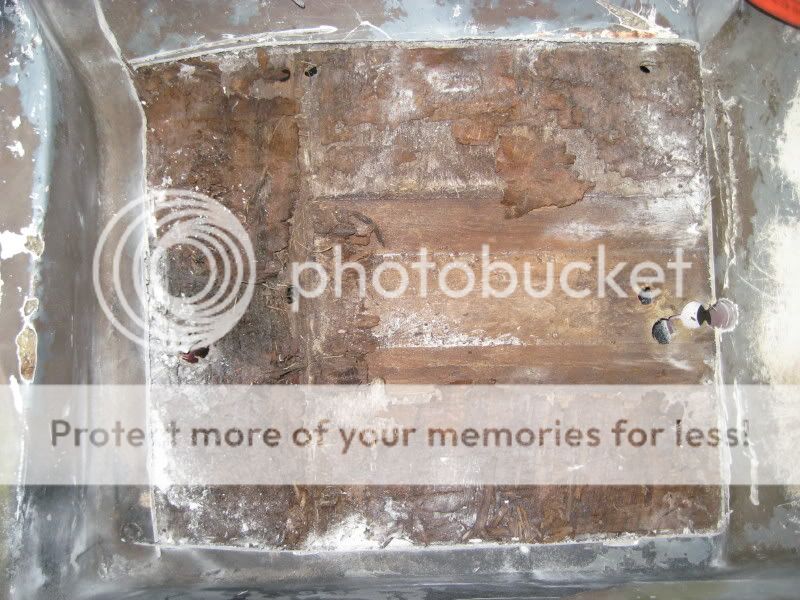

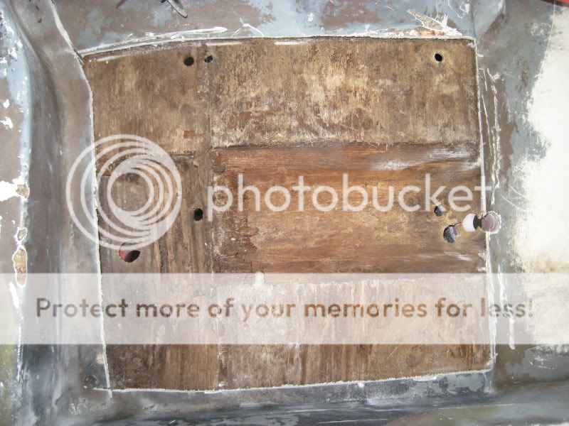

Floor panel (plug) removed. Showing the completely and totally ruined/rotted/destroyed original pine! I don't know the tub manufacturer, nor do I know what year it was made.
Virtually, I vacuumed up the crud. I did not have to scrape or pry any of it. It was like dust and old paper. Glass has taken on the appearnce of the wood.

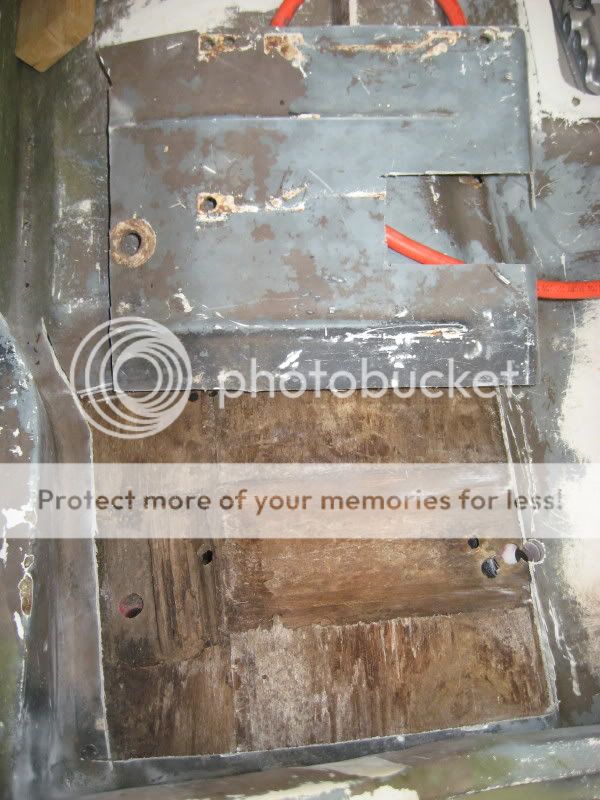

Showing the plug next to the hole. I cut through the tub in a couple of areas, but that is no big deal. We will be flipping it over and glassing/reinforcing in many areas.
Just showing how the plug will go back in the hole when we are ready. First, we have some wood work to do on our fiberglass tub. Wood work!? Sounds stupid! Essentially, it's a boat with wheels!
