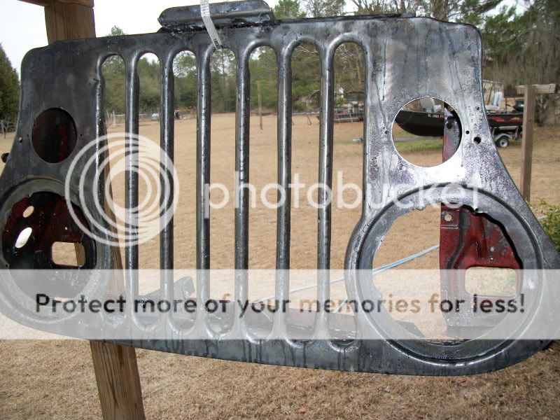

Here are some pictures of Clay's grill after he applied Ospho. He put straight Ospho into a hand spray bottle and liberally applied it to all grill surfaces. He will have to Scotchbrite it and degrease it before primer. I was surprised by how much surface area there is on a grill. It doesn't appear to be a large piece, but it takes awhile to get across it! If you use Ospho, be sure to NOT have it over concrete unless it is protected as it will dissolve the concrete! Also, be sure you are well ventilated because it will take your breath away! We still have some bent metal to straighten on the front.
Here is a pic before Ospho. Notice the difference.

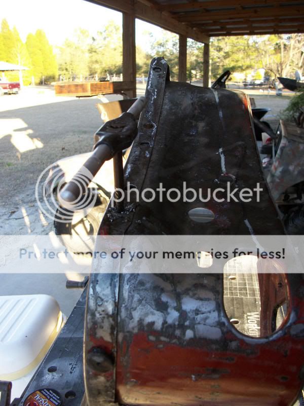

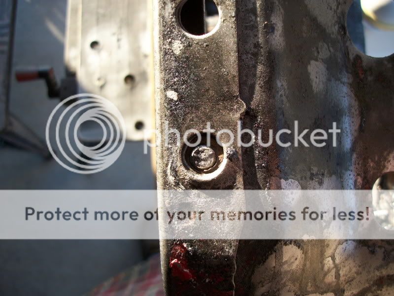

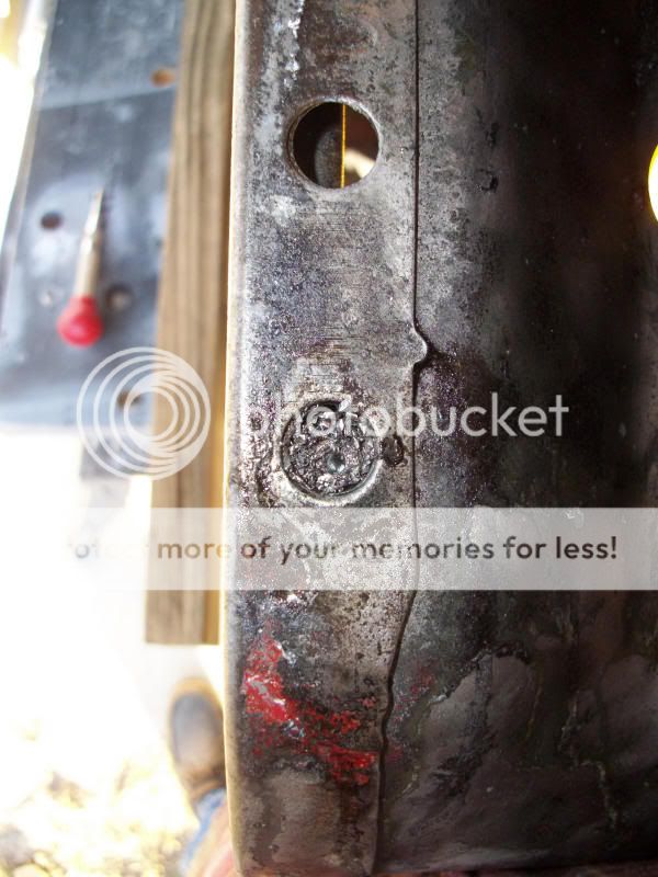

I worked on getting the busted bolt out of Clay's grill this evening. It is SO COLD that my hands weren't thinking! Thinking? Well... they didn't work very well. I pretty much was done when Clay got home from his welding class, but he came out to the shop, in a sweatshirt, and got busy too. Clay sanded the Crabtree Specials with some fine grit paper and hit them with a second coat of primer. Yep, they're going red! Should look cool. In the meantime, I continued to work on the stubbornbrokenrustedpieceofcrap bolt! It was MUCH more difficult than expected. I have been squirting it with Blaster, on and off, for the past month. I had to use a little heat in the form of a propane torch. No pics of that but here is the pic sequence.
Bolt broke off slightly below the top, so it was a little recessed. No chance to weld a new bolt to it. At least, not for me!

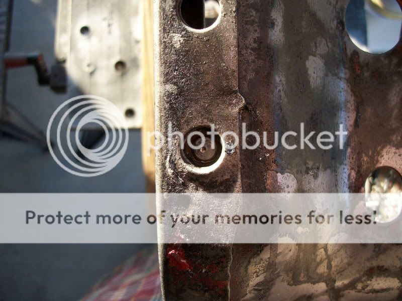

Tried to center punch the MIDDLE of the bolt. This creates a "pocket" for the drill bit and keeps it from wandering.
Here is the dimple after 5 or 6 pops.

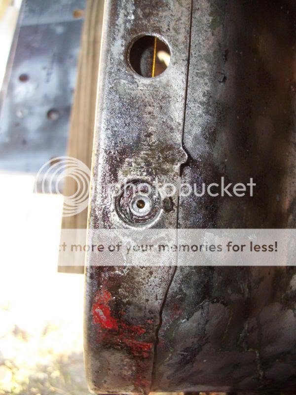

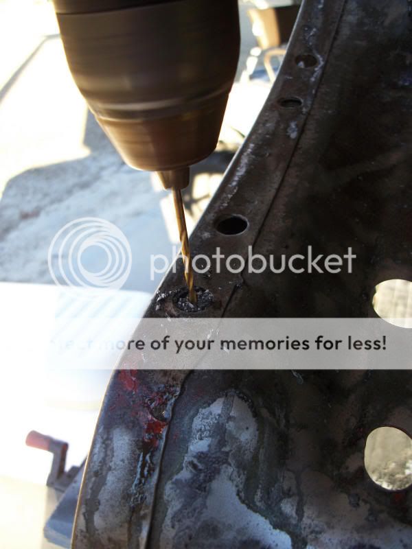

Started with a small bit to create a pilot hole. This will guide a larger bit next.
Pilot hole with shavings. I used Blaster as a lubricant and I kept the drill on the low setting to reduce heat.
This hole shows where I have already stepped up to a larger bit. You can see the pilot hole in the bottom.

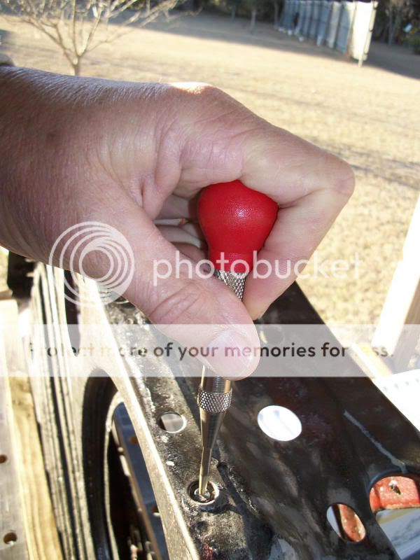

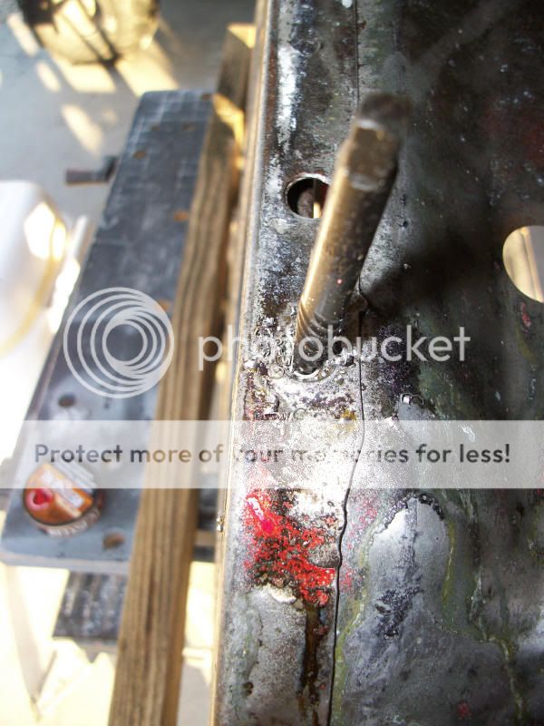

I gently tapped in my Easy Out. You do NOT want to break one of these off in the hole. Trust me on that one! If you haven't ever done it, you are blessed!
Gentle twisting with the T-handle. GENTLE!! Feel it. Don't break it off.

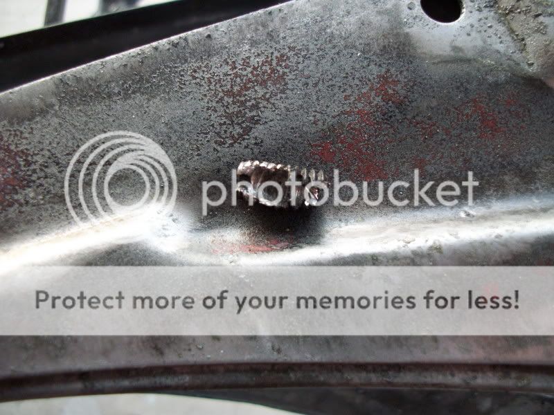

Extracted!

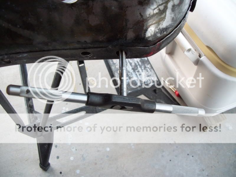

Cleaning the threads with a tap of the correct size.
Are you impressed!? that's the way it's SUPPOSED to go, but it didn't! I fiddled and fiddled with it and finally got it out by continuously stepping up drill bit sizes until there was hardly any metal holding the original bolt threads in the hole. Then, I used pliers and twisted it out the bottom of the hole! The Easy Out didn't get it this time! But it looked good didn't it?
