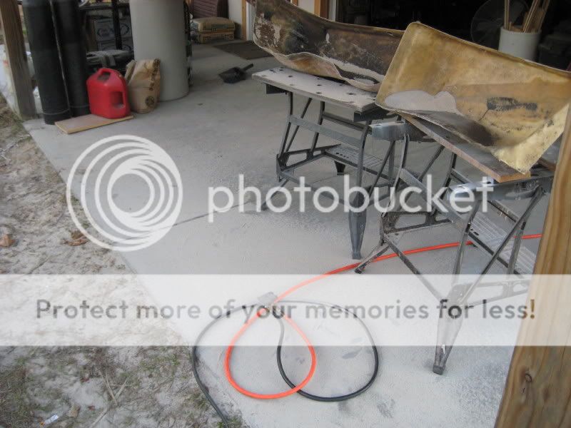

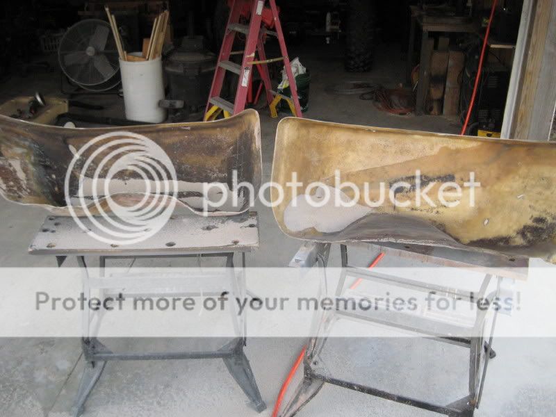

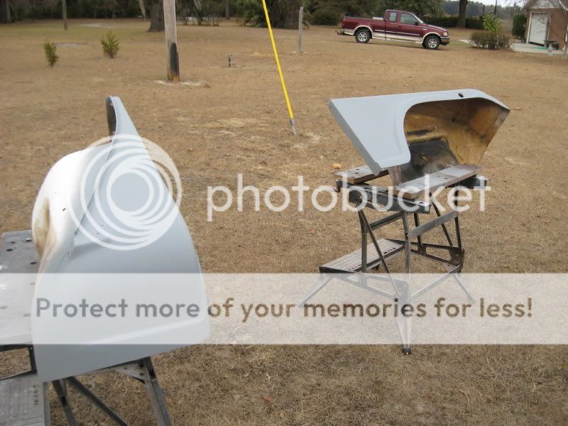

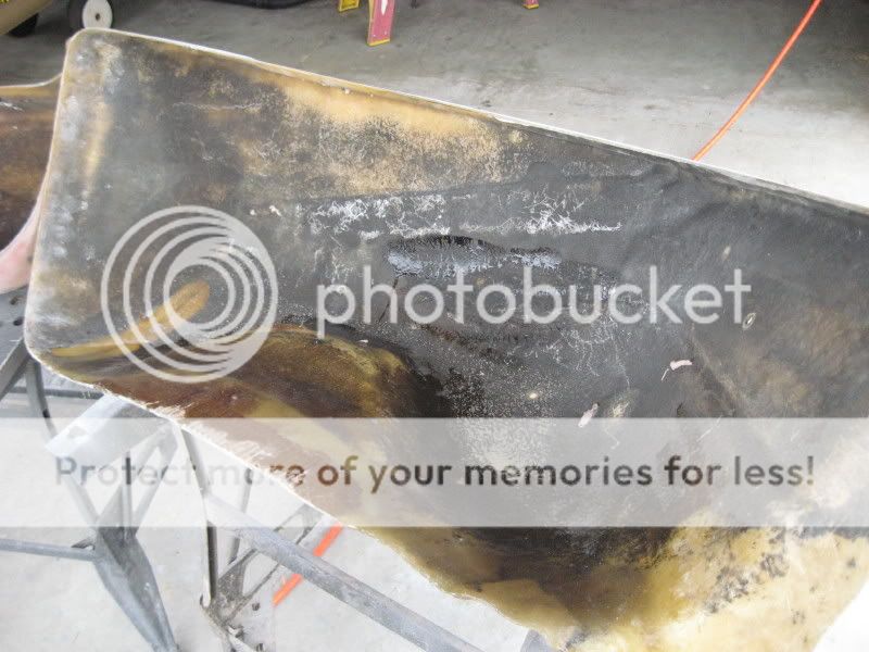

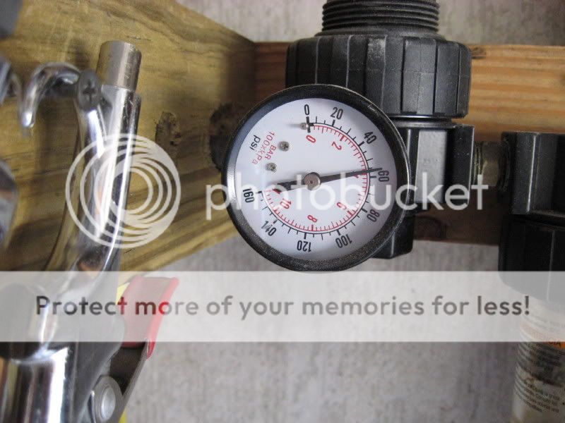

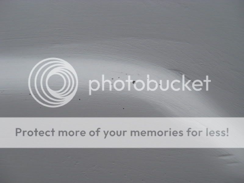

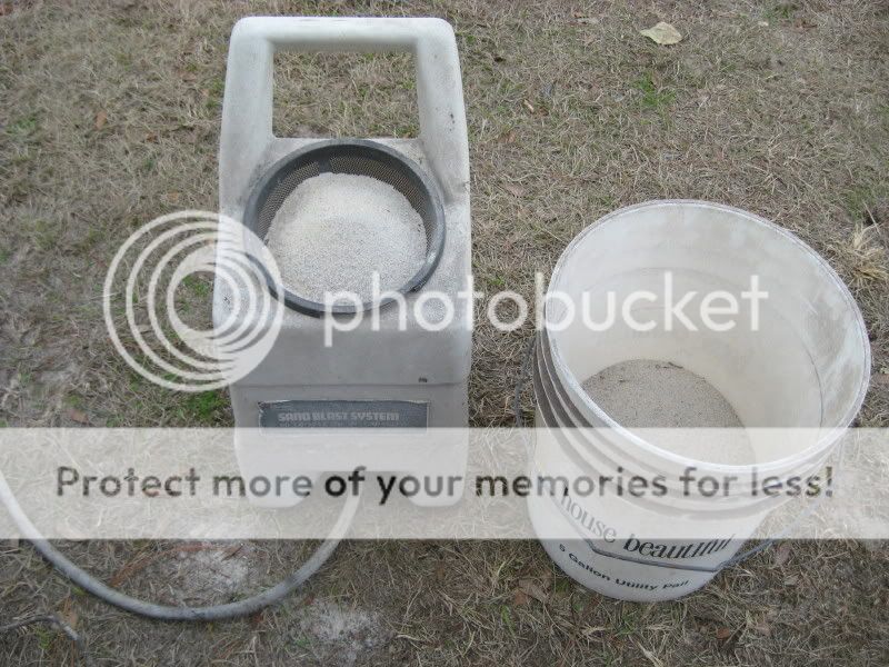

We managed to get Clay's fenders primed today. We also did a little sandblasting on them. I detailed some steps of the sandblasting, being the first time I ever sandblasted FG. Here are some pics of the process. If I had been REALLY intent on doing a great job, I would have sandblasted the fenders BEFORE we did all the glass work. As a result, the new resin covered over some of the old dirt, and those areas are prominent. I know now, in case I am ever in the position again. The SB was to clean the fenders in preparation for splatter paint. Here is the sequence...
The first couple of pics just show how dirty the underside of the fenderwells are. Who knows how many years of mud, dust, dirt, dead animals, etc got slung up there.
The next couple of pics detail the little SB unit that I used and about 55 PSI air pressure. The grime removed easily and it took about 10 minutes per fender. When you finish you just sweep up the dirt, screen it, and use it again!
Here is a completed fender and the next one to do. BIG difference!
If you can see this then you can see just how far the sand flies... even with only 55 PSIs. I had sand about 12' away in all areas.
It's not a great picture, but you can see that we actually DID prime the fenders!
And even though I worked hard, and I mean HARD, to make these fenders smooth, the truth is revealed in the primer. I took a few more pics showing the flaws but they weren't viewable... bad photographer! there's a lot to do!

I really tried to get a "fender zen" but it just didn't happen! I could not feel any rough spots or bumps, but the primer shows all. The scratches are nothing really... the glaze will take them out quickly. It's the smooth transitions that are getting me! Thanks for the compliments.
