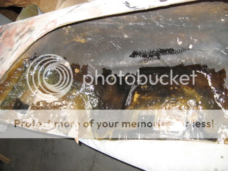

After reforming the fenders, AJ suggested we fill the void on the backside. Clay stripped the cardboard and got it ready. I'm not worried about the remaining cardboard... it is now part of the fender!

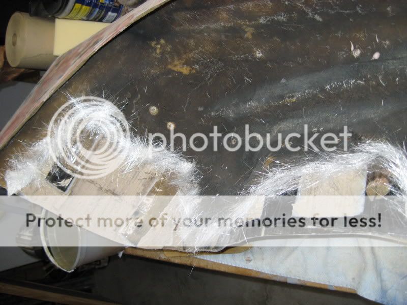

I pulled apart some 1 1/2 oz mat to stuff in the void, or groove. This will add strength to the repair.

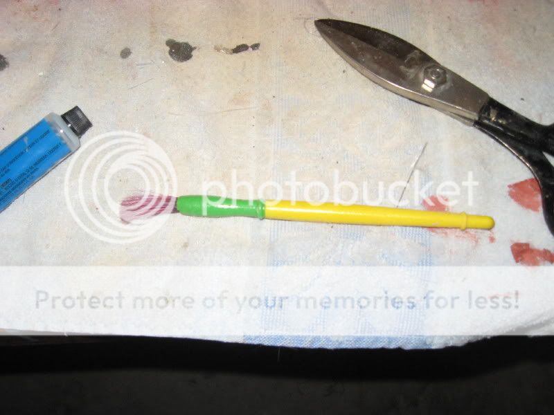

I'm using a little hobby brush to get the resin and fibers pushed down into the groove. You will want a cheap, throwaway 2" brush for the later strips.

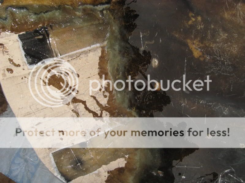

Here is a pic with some resin brushed into the groove and the fibers added to it. The resin will help hold the fibers in place until you are ready to coat it completely with resin.
Here's what it looked like after the resin was coated over all the fibers. My fender was tilted and the resin wanted to run down on the inside... made a mess!

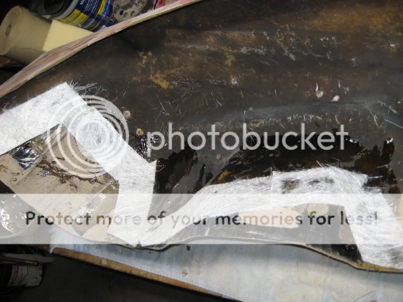

Then I cut strips of glass to cover over the fibers and the groove together. This repair will keep the original repair from separating from the old glass.

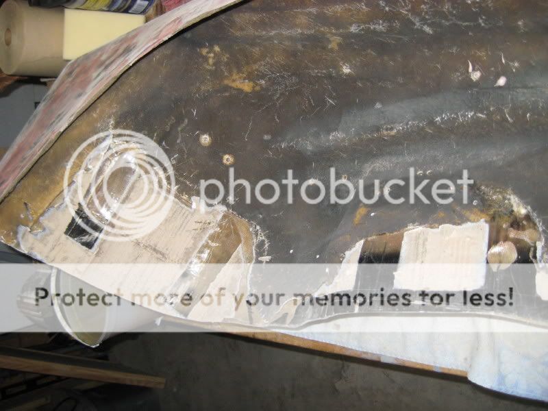

Here it is done. After it kicks off I will sand it quasi-smooth and get it ready for splatter paint.
