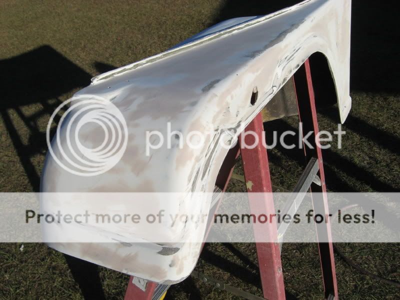

Clay got a PT job working on a guy's farm... that's where he is right now. I had the day off after my dentist appointment... so with Clay gone, and Mom gone, and most of the afternoon to myself, I decided to coat myself with Bondo and FG dust! I can't imagine anything I would rather do! riiight! This fender... I applied the skim coat. I put on too much! So keep in mind, when applying fillers, layer THIN layers. More is NOT better! You will have to sand it off. Don't make extra work. Many have said that Bondo has been replaced by more modern materials. I have never used anything but Bondo, and Bondo only for the first time with this Jeep. I have no problems sanding it. It does leave pin holes if you get it too thick. But it sands pretty easy IMO. So here is the left fender after 3 hours of sanding. It is ready for glazing.

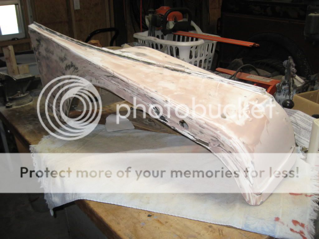

Just another angle. The curved portions of the fender are difficult and time consuming.

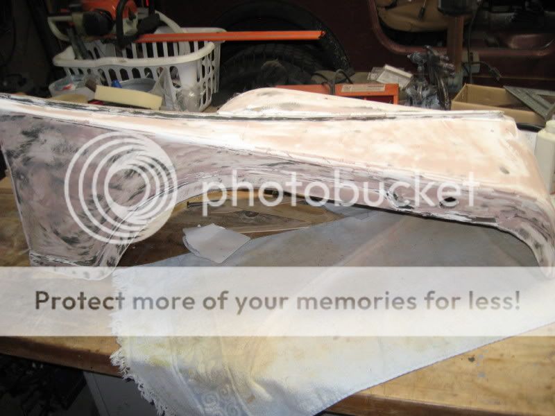

Last shot of this fender for now.

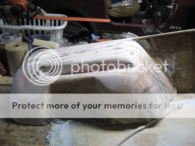

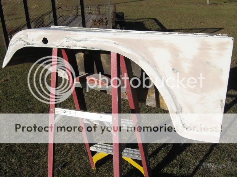

Here is Clay's fender. He applied the skim coat. He actually did a better job than I did... which stinks, because I am the BEST!
Bondo is applied to the areas you will see with the hood open. It will be "somewhat" smooth. Everything inside the engine bay, fenders, firewall, under the hood is getting Spatter paint (trunk paint).

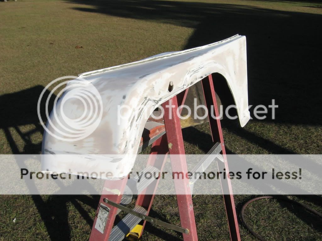

Last shot of Clay's work. Gotta go hunting!
