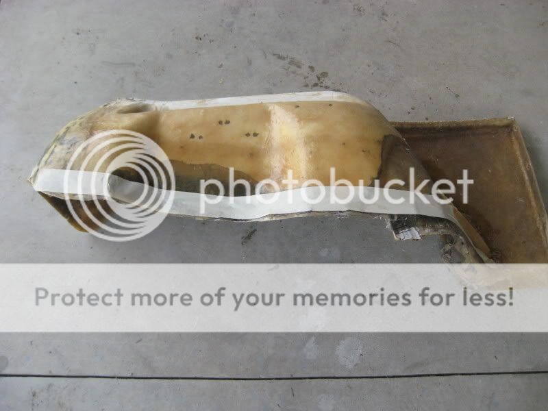

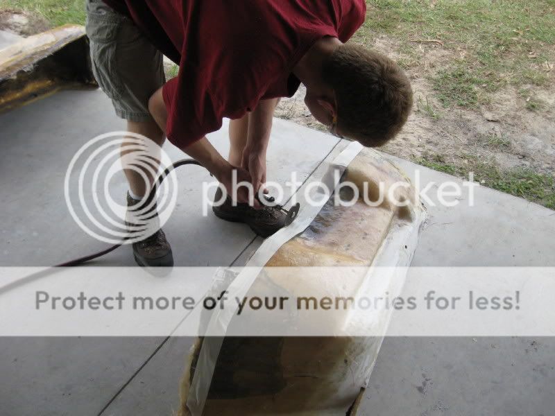

The opposite fender has been done for awhile. It is ready to trim. Here is the progression.
Clay made a guide line with masking tape.

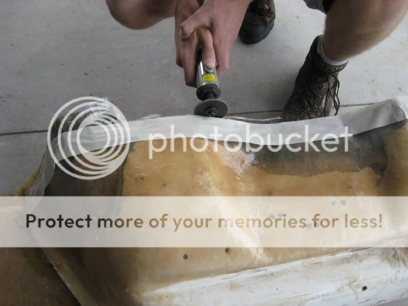

Removing the unwanted material with a cutoff wheel. I told him to wear long pants, long sleeves, etc... but he is like me. Born to suffer...
A little better angle. You can see the material coming off. It is important to stay square with the work surface. If you bind the wheel it will jump... suddenly! So keep your body at a 90 to the piece.
Cleaning up the edge with a DA.
Once we remove all the "slop" that Clay got everywhere (on the fenders... he just made my concrete a little more bullet-proof! ) we will prep it for Bondo. The idea here is to make it look "nice", not great. This area, too, will get the same finish coat as under the hood.

Thanks Guys. When I instructed Clay I never thought about the external front of the fender... in other words, the part of the fender that is visible when the hood is closed. there is a lot of resin slop to get off.

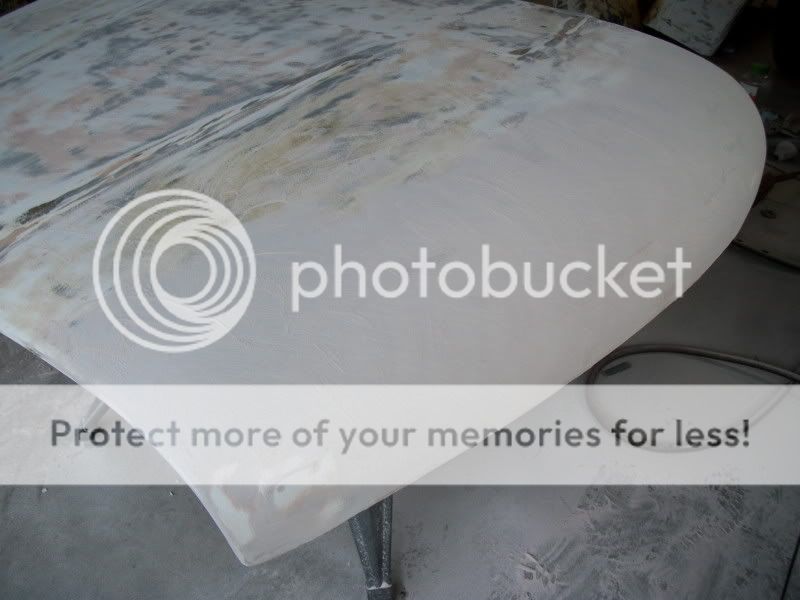

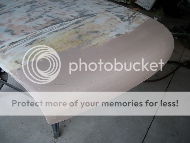

Well.... Guess what?? AJ came over!! I was thinking that we were ready to shoot primer. I told him I had wet sanded twice. He told me I wasn't anywhere near being ready for wet sand. AJ rubbed his hand over the hood and said, "This is like the ocean!" Huh?? "It's full of waves!" Shoot! I thought it was GOOD! So he ran home and came back with some file boards. He asked me if I had some plastic... I said "Sure... got a roll of it here." "No... I mean Bondo", says AJ. Yes, I have Bondo. "Do you have this?" "Do you have that?" Yes, yes. So he goes to work. He is amazing...
First, he made a rinse can from my Acetone jug. There was a little bit in the can... he dumped into a bucket! So long Acetone...
He put on a skim coat, and I mean a REAL skim coat... not a play one like I did... over the ocean waves! I couldn't believe how fast he was, how accurate he was. The man flat knows!
Skim coat sanded with 36 grit on a file board (I did that! ).

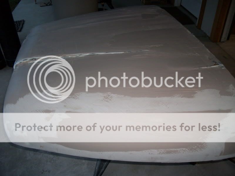

Skim coat over remaining hood. This is also my work. I understand better now!
Then Sonny, my next door neighbor, showed up with this... homemade Peach Brandy. "Happy 50th", he says! Work kinda stopped for a little bit. It was good too!

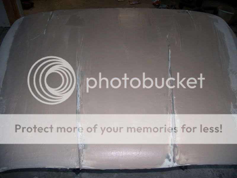

Finally here is a little more skim coat over AJ's skim coat. Gotta keep the ocean flat!
That's where we are right now. I need some more file boards to continue. AJ told me NOT to shoot primer until he comes back to look at it! This is going to be nicer than I expected.

Bodywork is hard to explain in words, seeing how AJ skimmed and then taking down the high spots with a sanding board should help you out.
Don't let the primer fool you! Flat primer will make most panels look great, once you spray it with wet paint, especially metallic it will highlight the smallest of imperfections.

Sonny made the peach brandy from 15 cups of peaches. He pulverized them, added some water, sugar, and yeast. Then it sat covered for a few weeks. If you want the exact recipe, let me know. Sonny LOVES to talk!! I mean REALLY loves to talk. So you can imagine the great sacrifice I will have to make on behalf of all you winos!!
Reagrading Bondo... I was expecting it to setup while AJ was mixing it. He mixed 10X the amount I mixed, and then worked it, and worked it. I was thinking that it would kick off and be wasted. But it didn't kick off. None was wasted, and he knew exactly what he wanted to do. He covered one side panel (above pic), cleaned the tools and made some more for the other side. Of course, I was finishing my 3rd little plastic cup of that peach brandy, and well... I was ready to shoot primer! Looked good to me! After a bit he showed me the "proper" way to use a file board. He had brought over two pieces of 36 grit file paper. I went to work and promptly tore in half both pieces!! DUH... So he put one on the block and let me go at it! Wasn't bad, but anyone can remove material with 36 grit! Shoot... I didn't even KNOW what I was doing. He would say something, I would nod and grin!
I didn't know that I wanted that much Bondo! I thought it was supposed to be a filler... I guess it is a filler, but we used it like a new skin. AJ said that with the paint we will use (Nason, single stage, Implement Red) we will see everything wrong when we're done. This is truly a very good education. I can't wait to get the tub on the frame.
